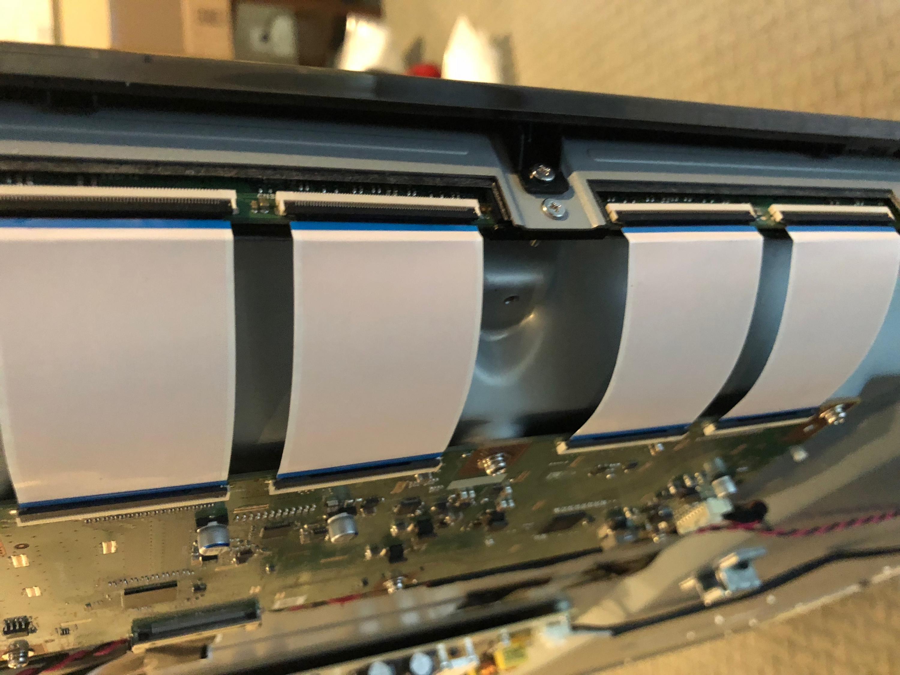

    Re: Vizio E70u-D3
    These connectors?
    • Michale32086
      • Nov 2011
      • 1453
      #42
      Re: Vizio E70u-D3
      Yep, those are the ones.. Inspect the ends and make sure they are clean and no broken traces.. Then re-insert them into their connectors..
      You can also further track down the problem by leaving one disconnected and powering up the TV... do that for each one..

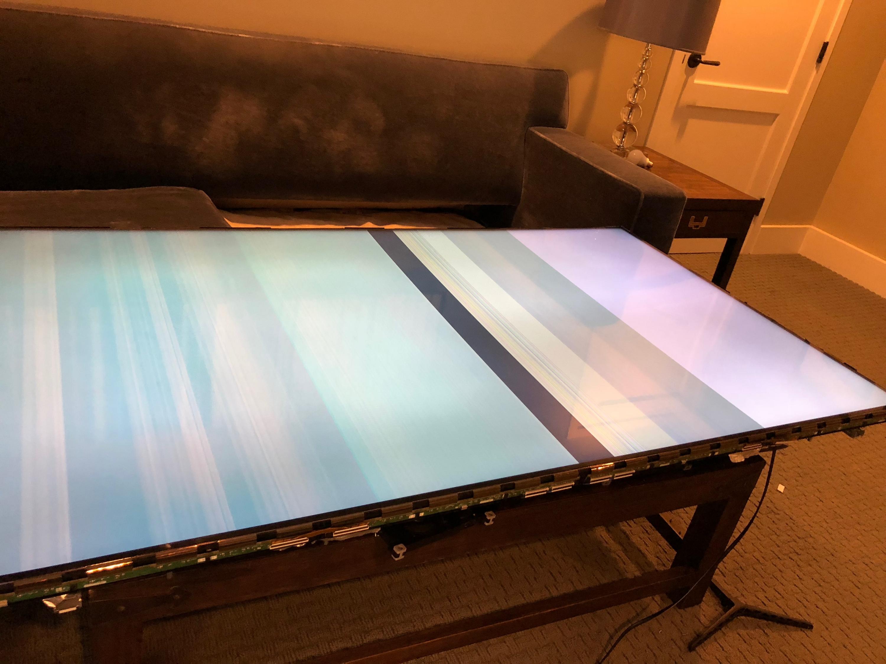

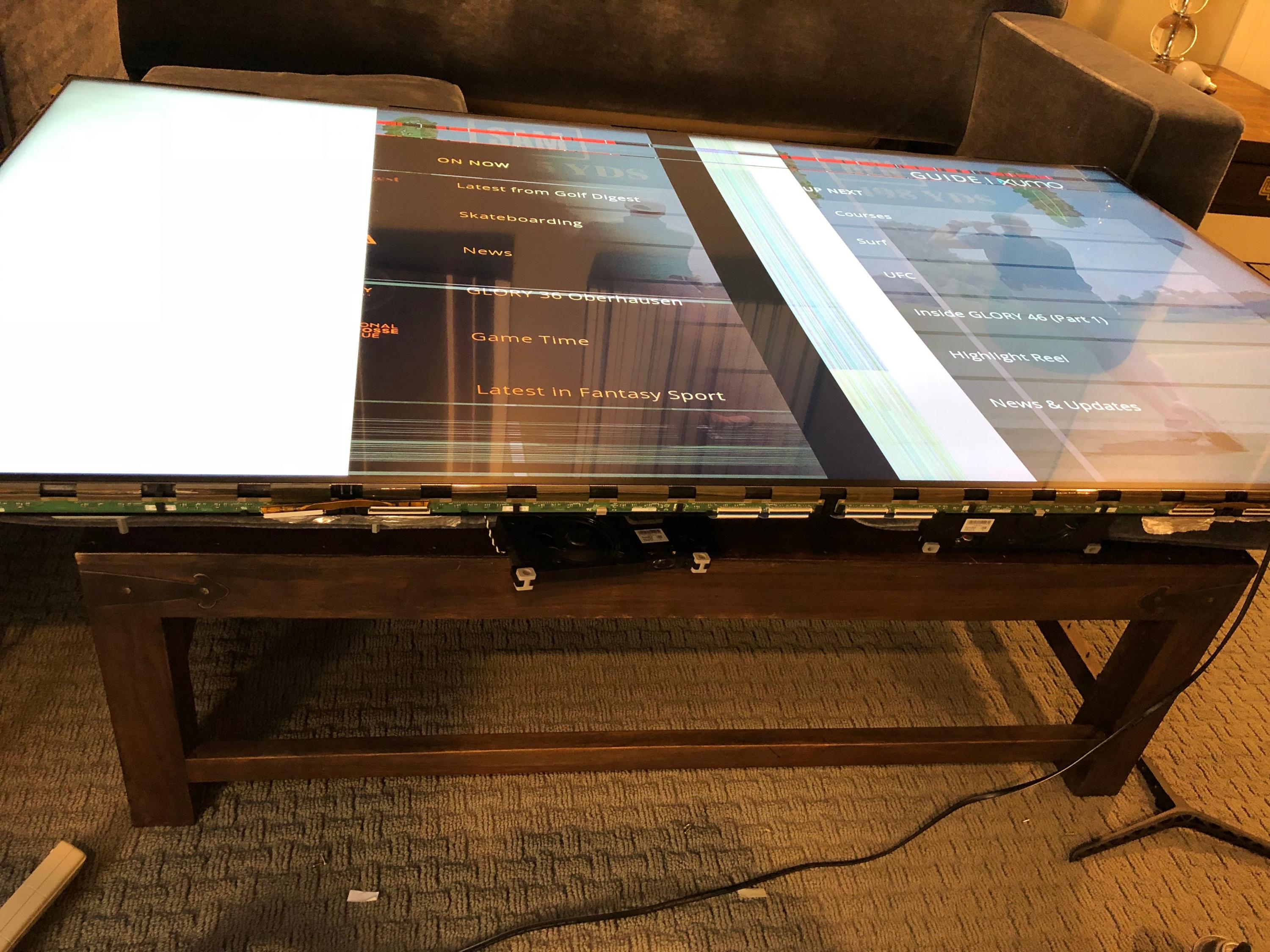

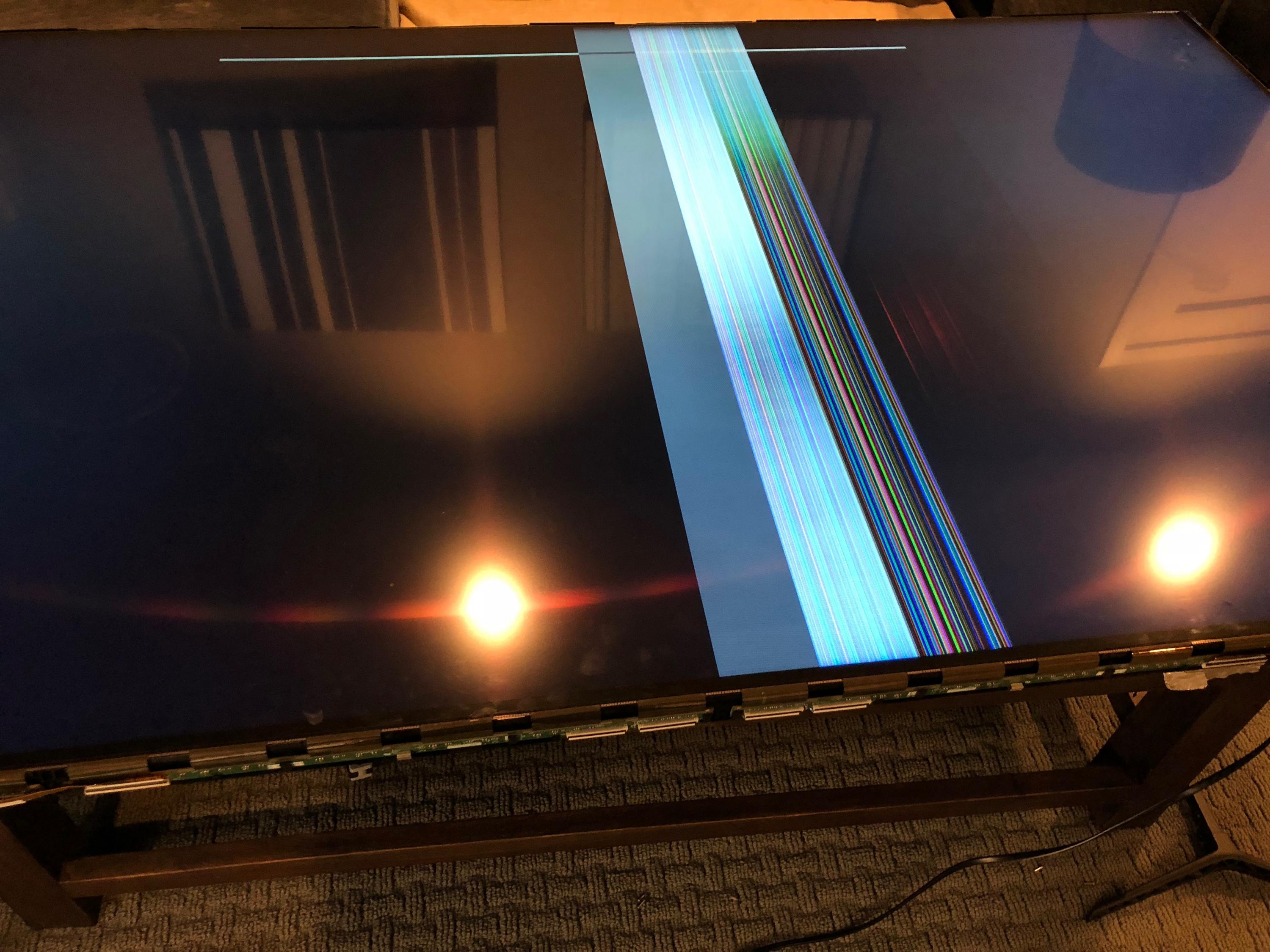

                    #49
                    Re: Vizio E70u-D3
                    Hi Budwich,
                    There are no cables in the bottom corners and no side edge boards, only 8 little tabs on each side that stick out about 1/3".

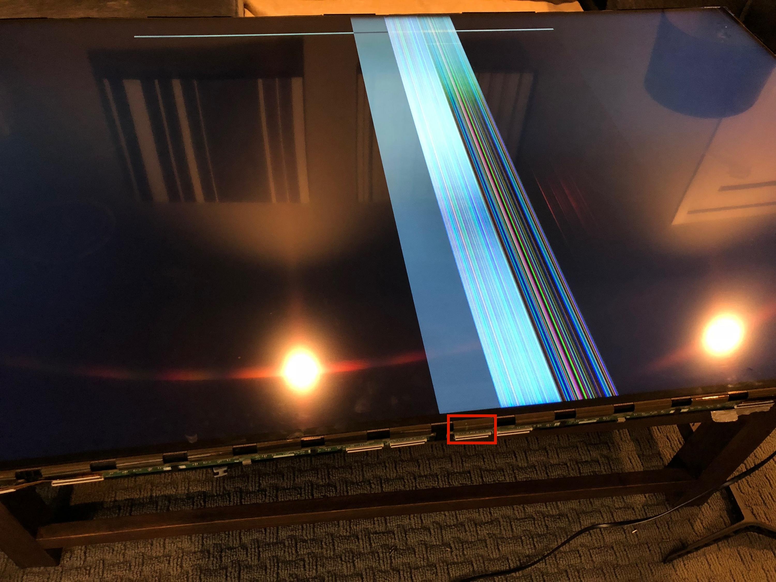

                    There are 4 boards along the bottom. Depending on which ones are connected to each other I get different effects, shown in the attachments. First one is boards 1 and 2 disconnected, second is boards 3 and 4 disconnected, third is both 1 and 2 and 3 and 4 disconnected.
                    Thanks,
                    Dave

                      #50
                      Re: Vizio E70u-D3
                      not sure if we are talking the same "language"... :-) you indicate earlier that you are seeing horizontal lines but in your picture I see only vertical lines.... some one is looking "cross eyed"... :-) but maybe the first one shows some horizontal lines... hard tell with the angle and not knowing what the actual display is supposed to be.
                      Anyways, IF your set has no edge boards along the sides, then the last tab on the bottom corner is responsible for providing signal (and stuff) to both the vertical portion of the screen (for that section) along with signals that go "thru" the panel up to the tabs along the side.
                      Your 2nd picture is kind of telling that there is a problem on the other side... as by disconnecting the 3/4 board, no signal is getting up to that side and the tv is relying on the signal going up the other side... BUT as you see nothing is happening.... because the other side has a problem.
                      The 3rd picture is somewhat telling that there might also be problems on the bottom on the side with the vertical colors.... is that the same vertical area that is showing no display in the first picture? Those might be an issue as the bottom tabs must remain in place. You might want to check the edge boards to see if any SMD components have failed (caps or resistors).... but I fear that this set is not salvageable because you have problems in both the bottom and sides.... but maybe I am not seeing things correctly.

                        Sorry I was confusing. These pictures are not really examples of the horizontal lines. I referred earlier to stuff I was seeing when I was only disconnecting the cables from tcon. In that case the thin boards were all connected. I got different results for each of the four cables. What I was referring to was that in a situation where pat of the panel worked and showed a decent picture there were horizontal lines. Those lines weren’t dark they actually showed a fainter version of the picture.

                          Now we have a REAL expert here..
                          I noticed something on one of the pics..
                          Can you post a close up of the area I marked??

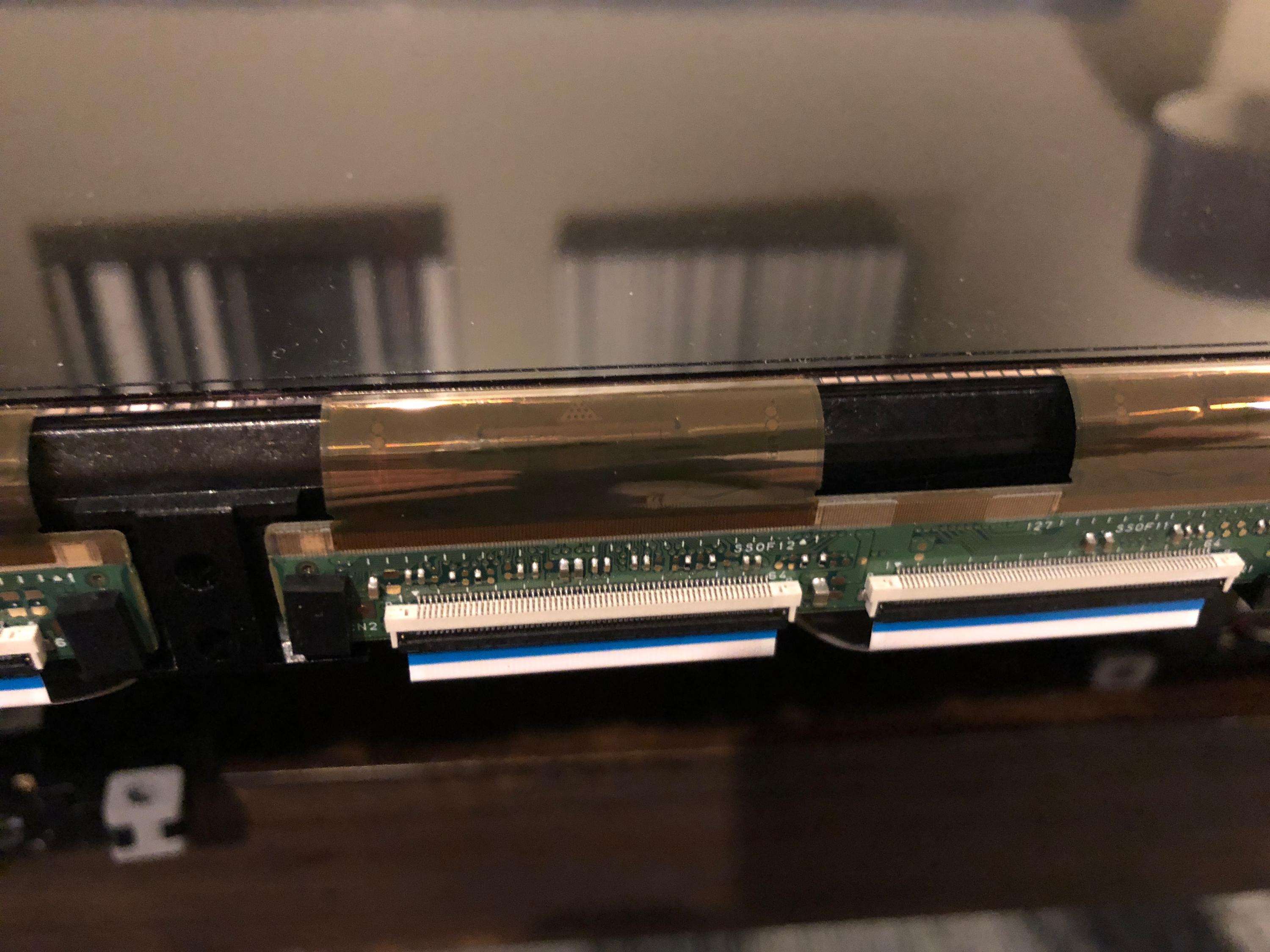

                            #53
                            Re: Vizio E70u-D3
                            Here you go (and, thanks!)
                            • budwich
                              • Jul 2015
                              • 3097
                              #54
                              Re: Vizio E70u-D3
                              you may want to double check the "unclampable" cables on those boards (ie. they go towards the tcon) to ensure that they are indeed aligned properly. The vertical lines do not look good and might be caused by those cables not being connected properly. IF you are ambitious you can try swapping the two cables from the other side and see if that changes anything (note: swap as in unplug BOTH ends and move the cables and opposed to "crossing" which won't work and will cause damage).
