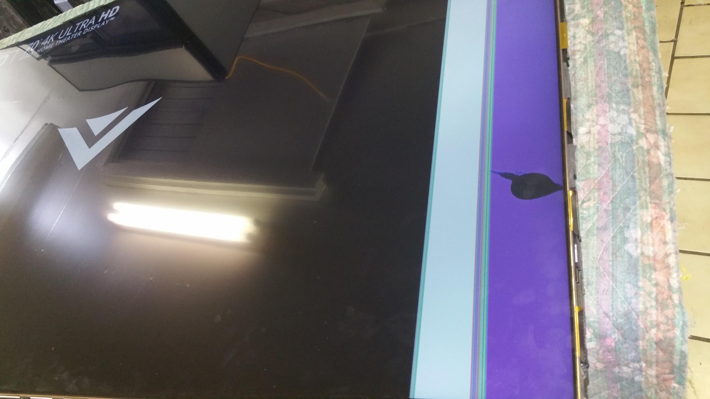

              Re: Vizio E70u-D3
              Yea, I think yer right.. I think it best to keep the panel where it is and gently move the assembled onto the screen...
              Helper couldn't get over here yesterday so we're shooting for today..

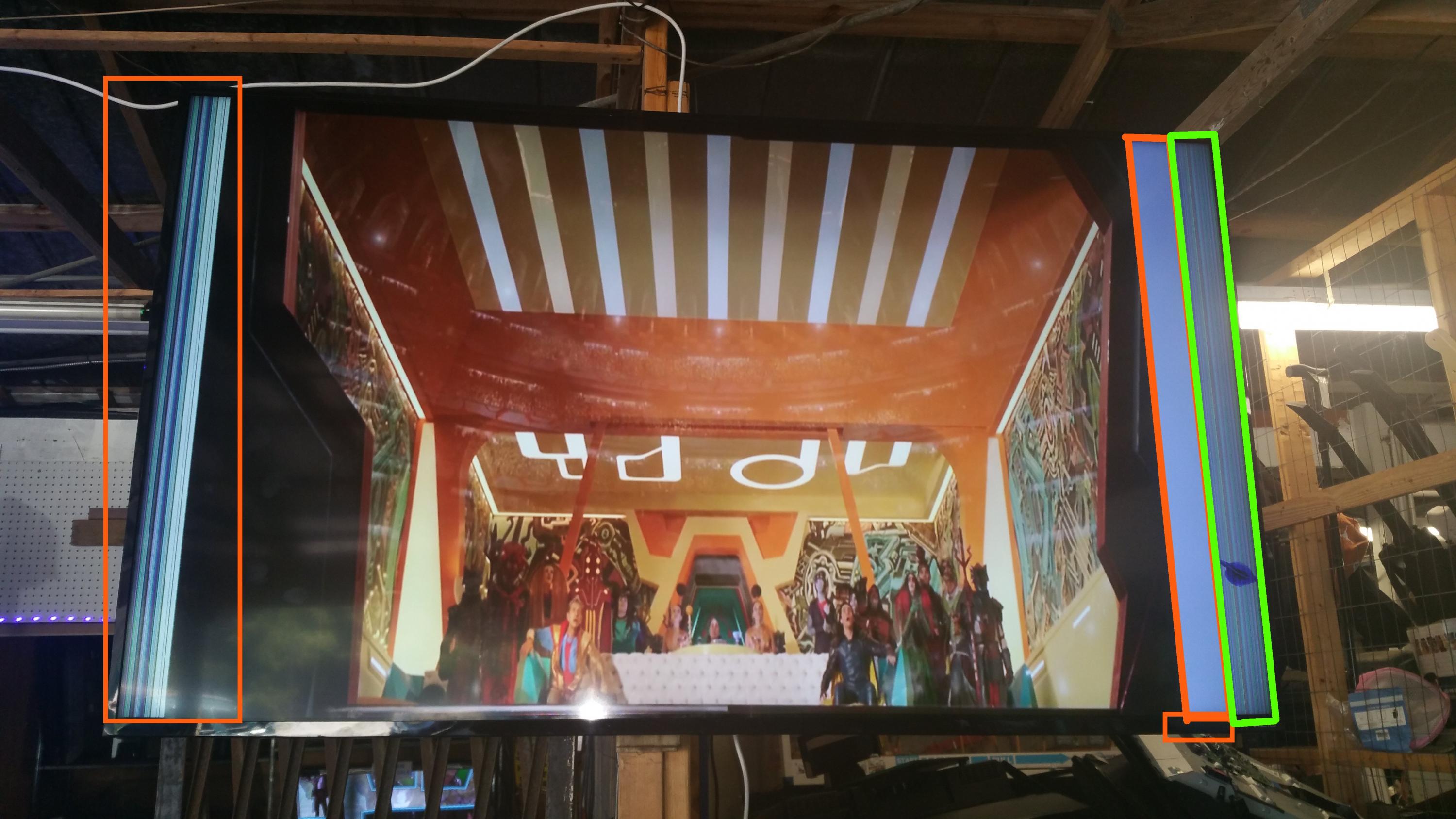

                    Re: Vizio E70u-D3
                    Thanx Andrew..
                    Now that I have gone thru the mourning period, things aren't TOTALLY shot..
                    As you can see by the pic, the main area of the TV is still there and is viable..
                    I am wondering if the small strips of scrambled-ness (marked in red on the pic) are the results of misaligned bond connectors rather than caused by the actual break (marked in green)...
                    Is it possible the small crack would affect the opposite side of the panel??
                    If I can fix those two scrambled areas marked in red, I would still have a viable TV that I can use at home... Instead of a 70", it would be a 67"

                      Final dispo on this..
                      As I mentioned, I was going to try to fix the bands that did not appear to be associated with the crack and then cover up the crack band and just use the TV...
                      I had the "brilliant" idea to get some strong tape and put it across the small crack in hopes of preventing the crack from expanding..
                      The theory was sound.. But I should have did it BEFORE I took it off the wall.. Cracked zipped all the way across to the other side...
                      Oh well, live and learn.. Hopefully..
