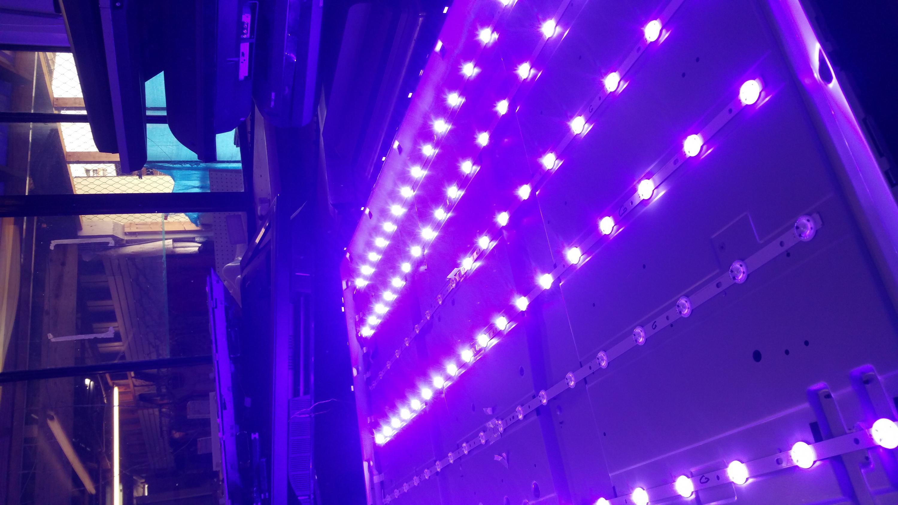

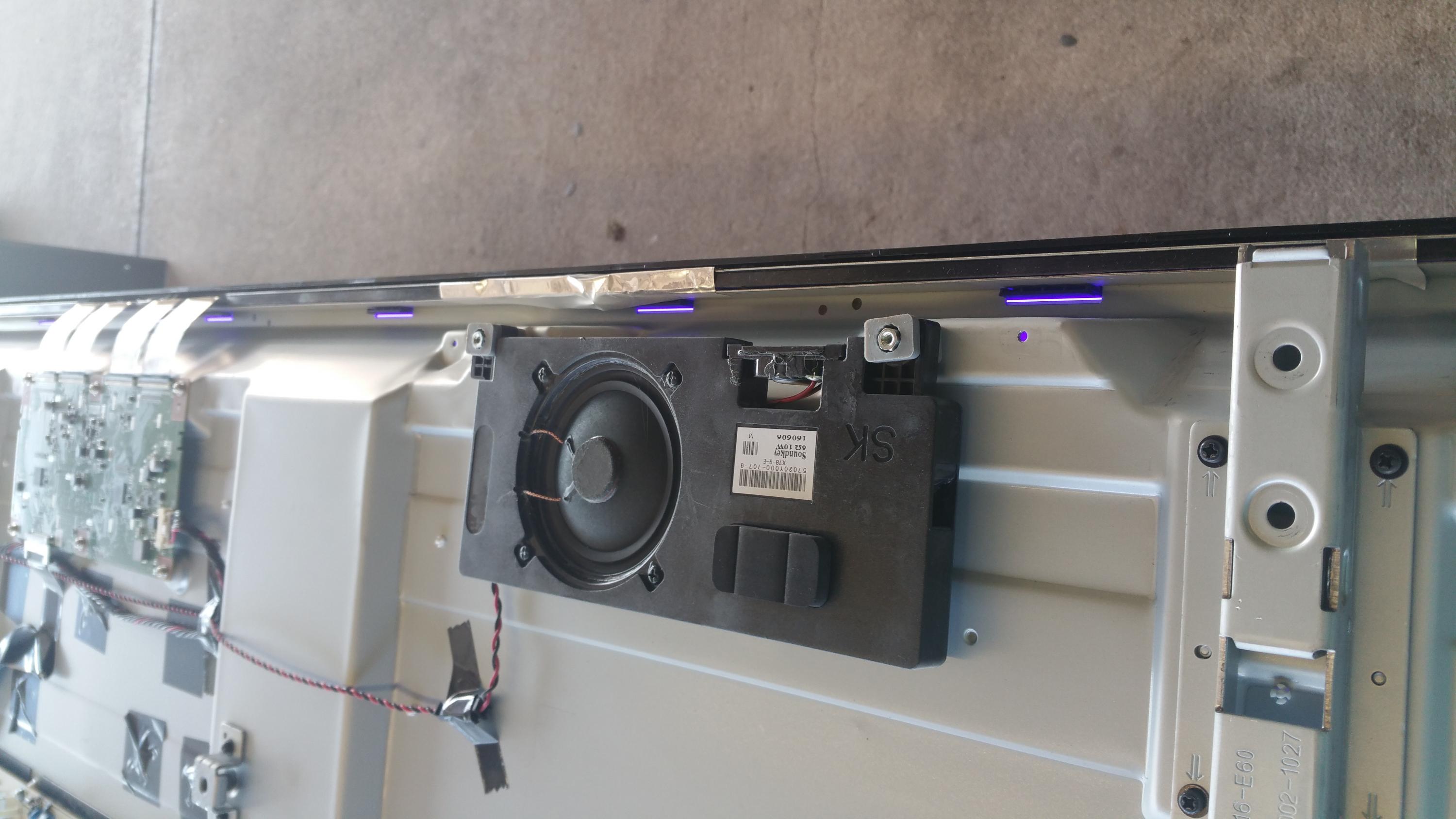

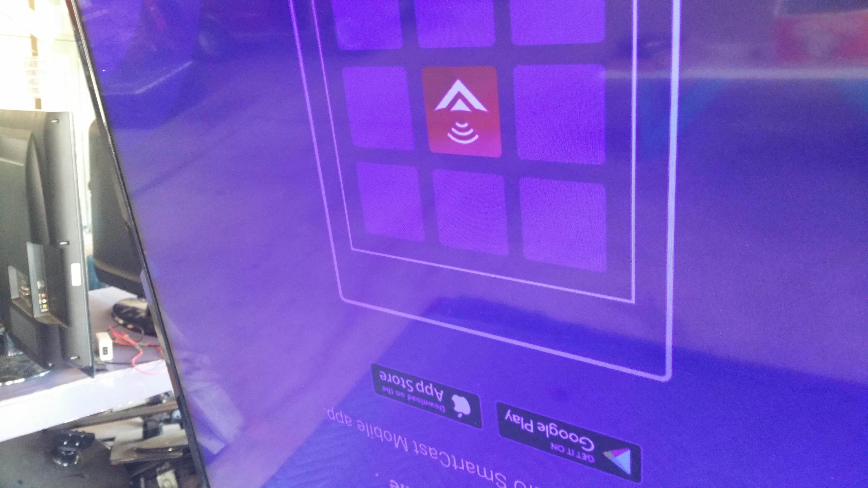

    Just got in a nice Vizio E70u-D3... Comes on, displays good, clear, crisp..
    Everything is purple.. All the white is a deep alien purple and all the colored stuff has a purple tint..
    OK, I say.. That's different..
    I am thinking a bad LVDS cable, maybe a misconnection on the TCON..
    Crack open the case...

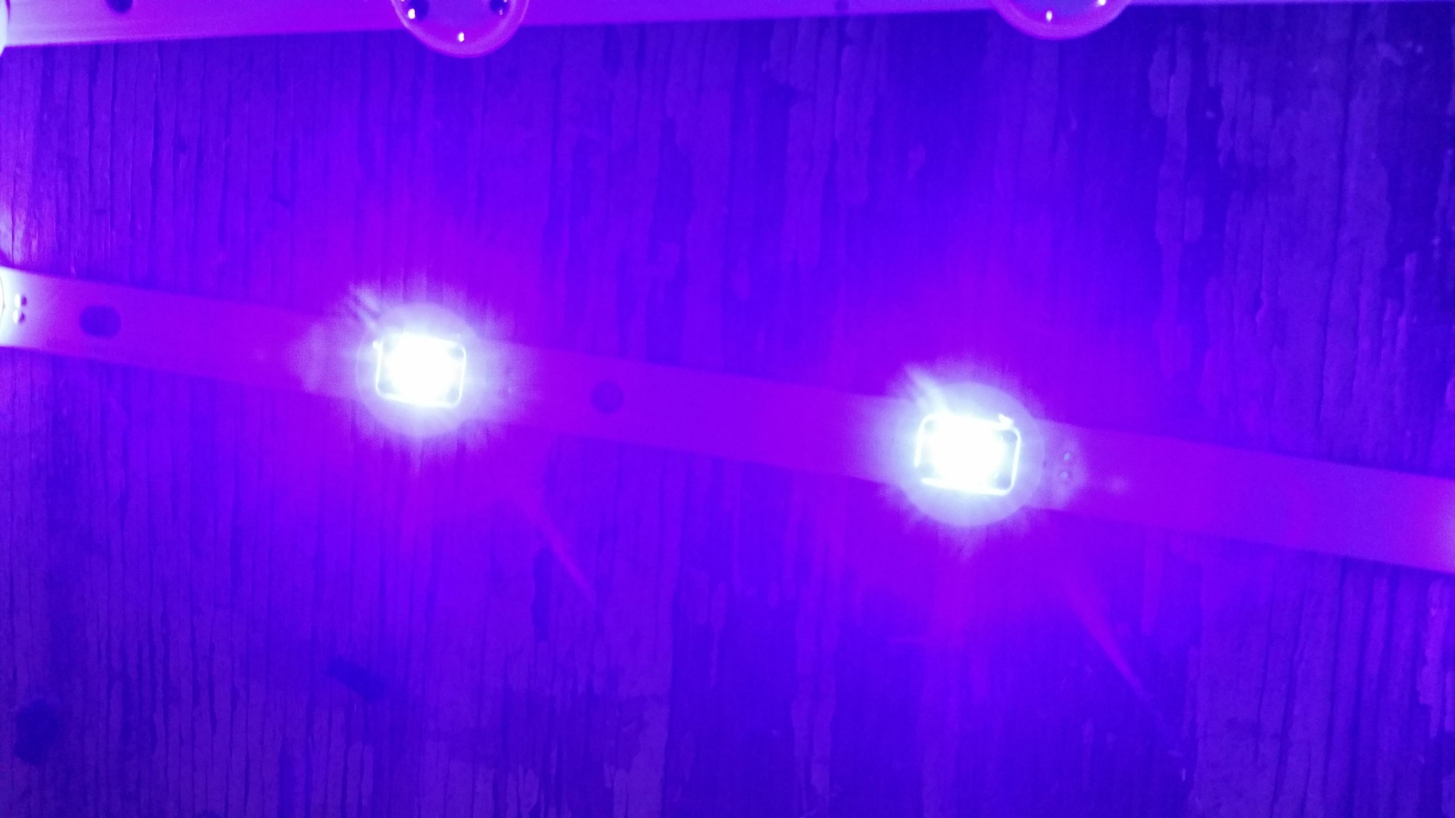

    The LEDS are purple!!
    I kid you not... A deep alien looking purple.. I felt like I just opened up Jackson Polluck's TV...
    I have been doing TVs for quite a few years now and I have never seen PURPLE LEDs...

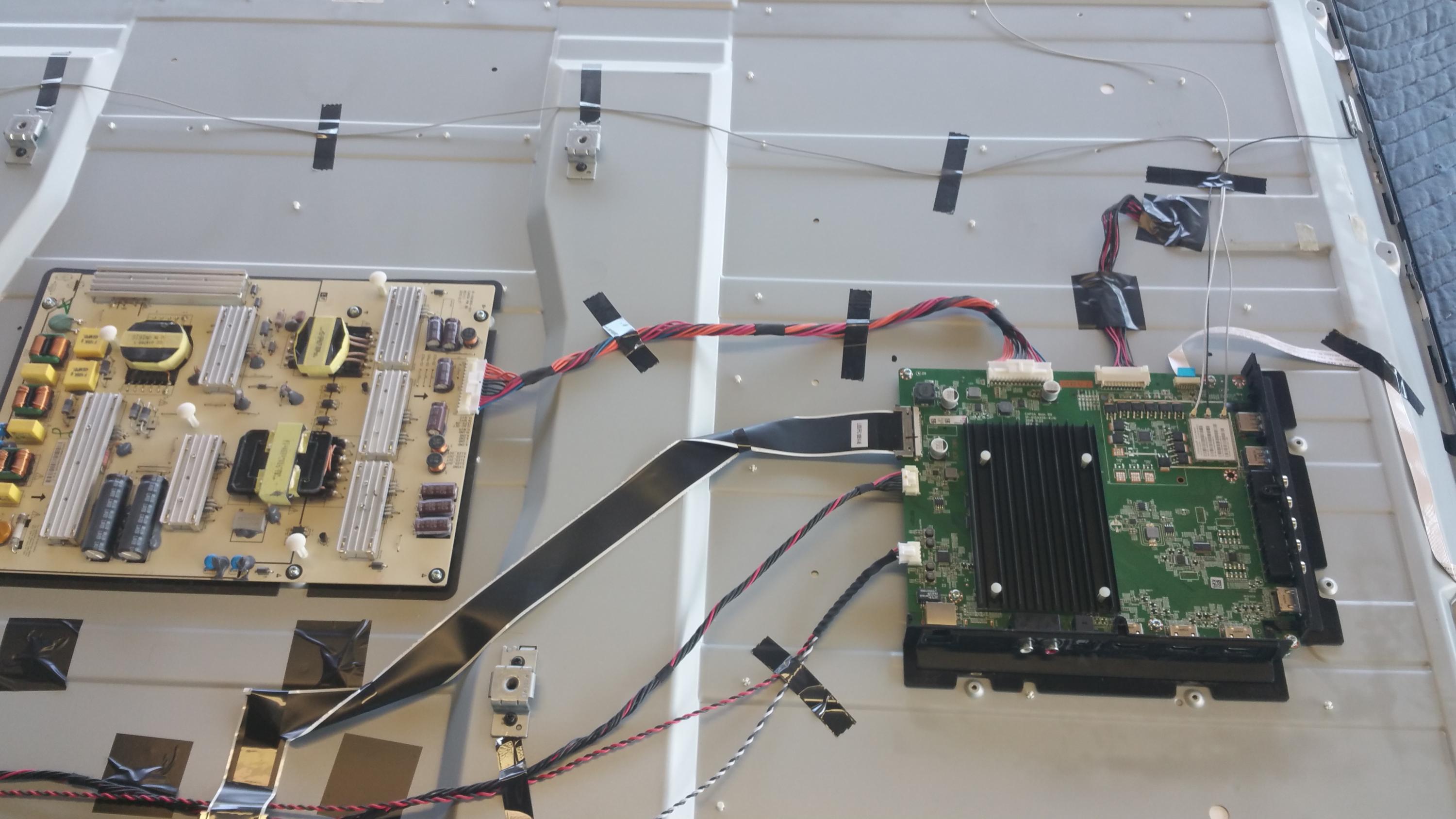

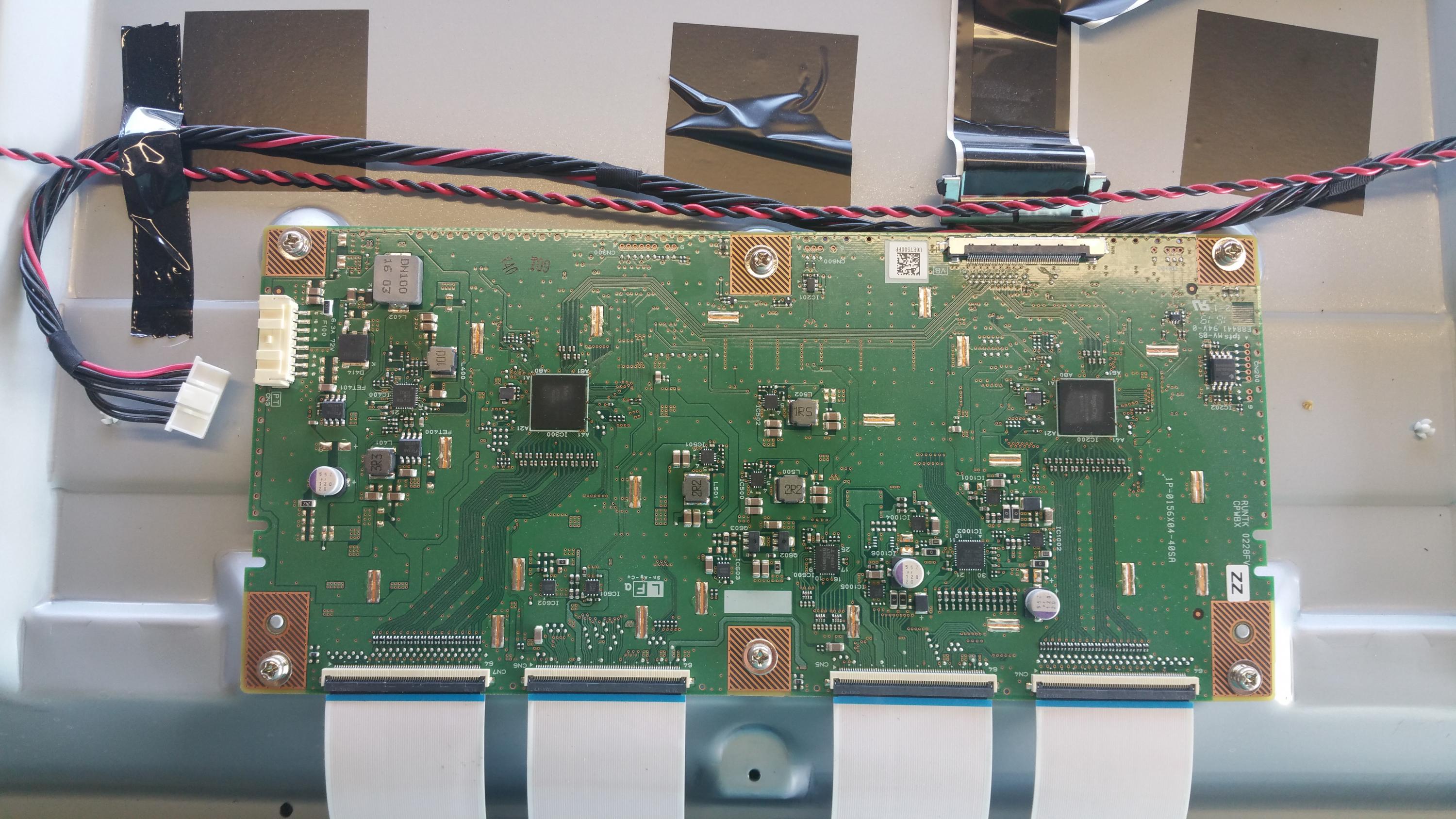

    As you can see from the pic, a cable goes from the power PCB to the main video board and another cable goes from the main video board to the LED ARRAY..
    I am thinking bad frequency on the power PCB?? Something screwy with the main video board?? The display is perfect, just purple tinted..
    Anyone have an idea???

    If you disconnect the cable from T-CON, will you see purple glowing screen?
    What is the LCD panel model number?
    • Michale32086
      • Nov 2011
      • 1453

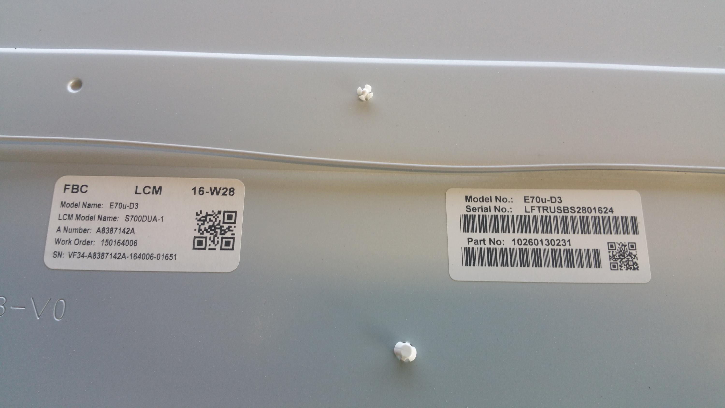

      Re: Vizio E70u-D3
      I completely disconnected the TCON as shown in the pic.. Still get the purple LEDs. There is no flicker or anything. It's like the LEDs are supposed to be purple..
      Panel stickers in second pic..

          That tcon board has Sharp achetecture. Probably the sharp selloff to Hisense

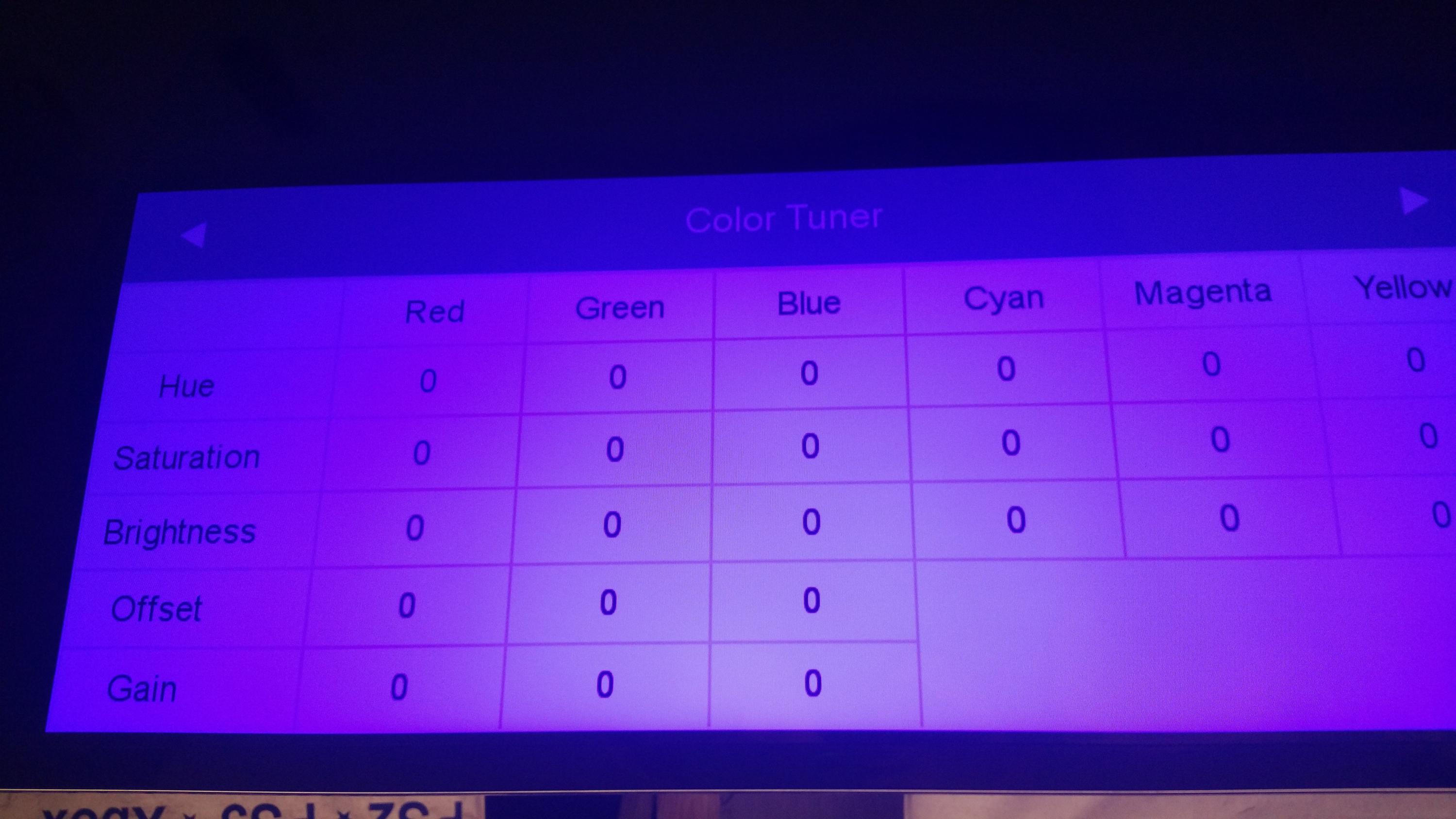

          Do you have any backlight adjustment in the menus?
            Re: Vizio E70u-D3
            May be the LED's are the RGB type?
            Have to look up LCD panel spec sheet.

                  Re: Vizio E70u-D3
                  OK Checked the menu settings..
                  Pretty extensive Color Calibration menu..
                  But no settings changed the purple tint..
                  I was able to "cancel" the BLUE and the purple tint on the display kinda disappeared. But the actual LEDs did not change color... They were still purple..
                  Is it possible that this was a manufacturer error.. I mean like they just put in the wrong color of LEDs???

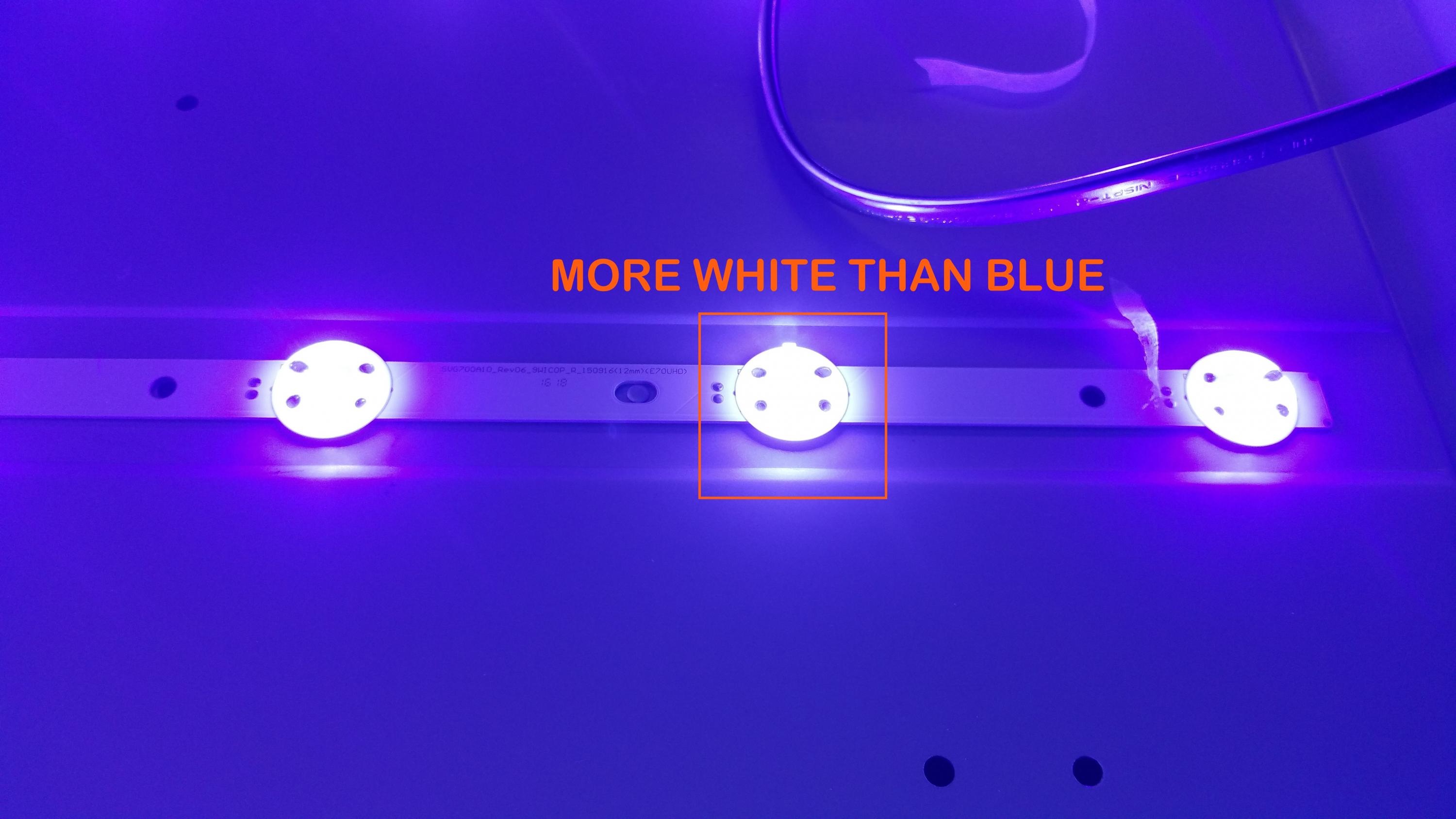

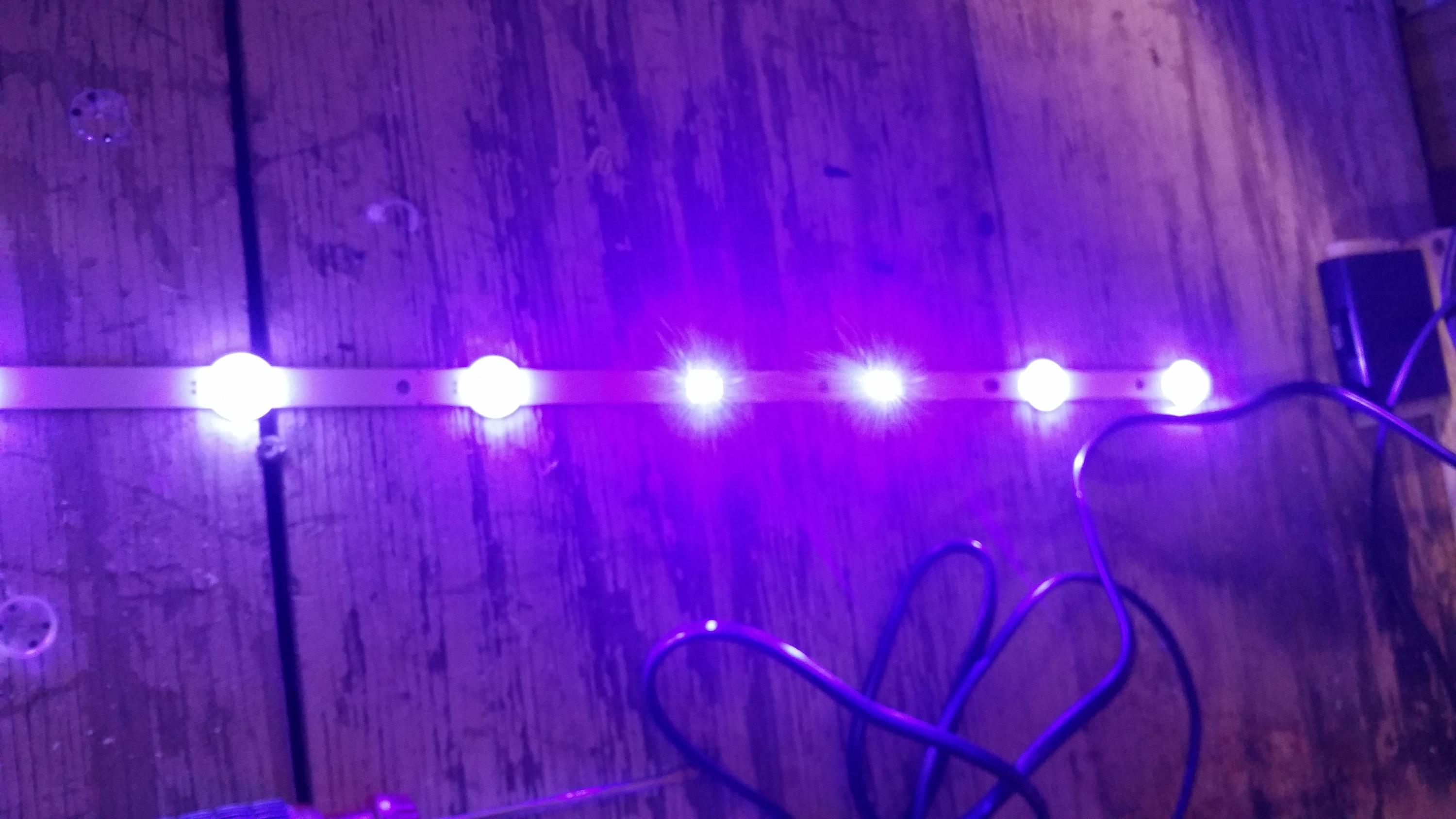

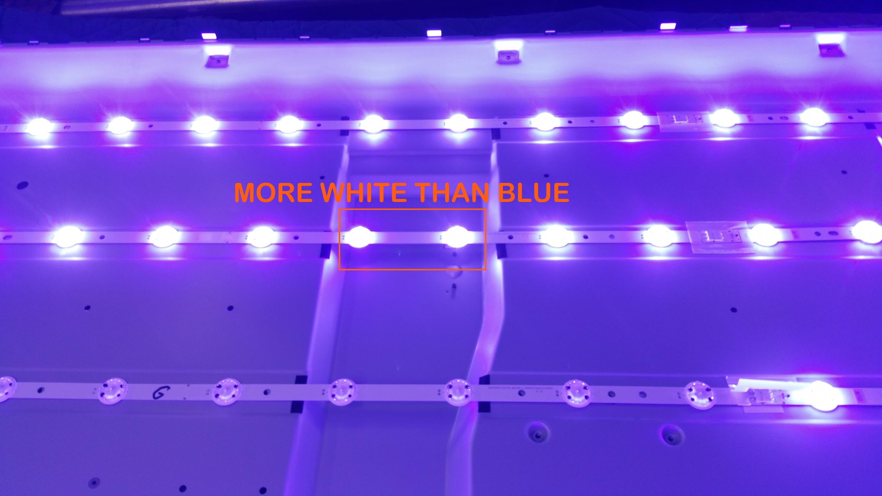

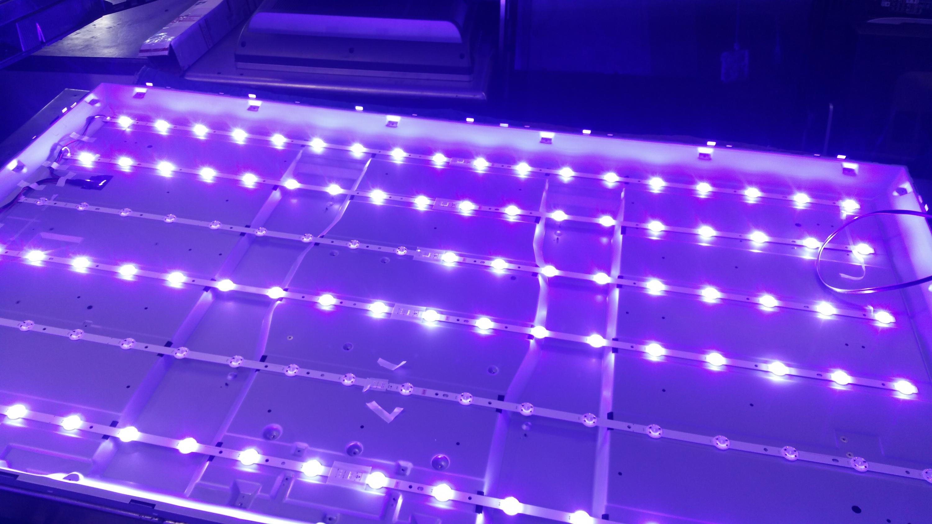

                        OK Update on this...
                        I am just going to throw a bunch of data out there in hopes that it makes sense to someone..
                        First off I got it disassembled down to the bare LEDs.. I am fairly sure I didn't crack the panel.. hope hope...
                        Once off, the LEDs throw off a distinctive blue-ish glow, rather than a purple.. But it's close enough that i can see how it could look purple under all the mylar sheets and diffusers and panel...
                        However, some of the LEDs are distinctly white, while the majority are definitely distinctly blue-ish.. The pictures don't show it properly, but the LEDs are distinctly blue-ish, not purple... And a handful are distinctly white..

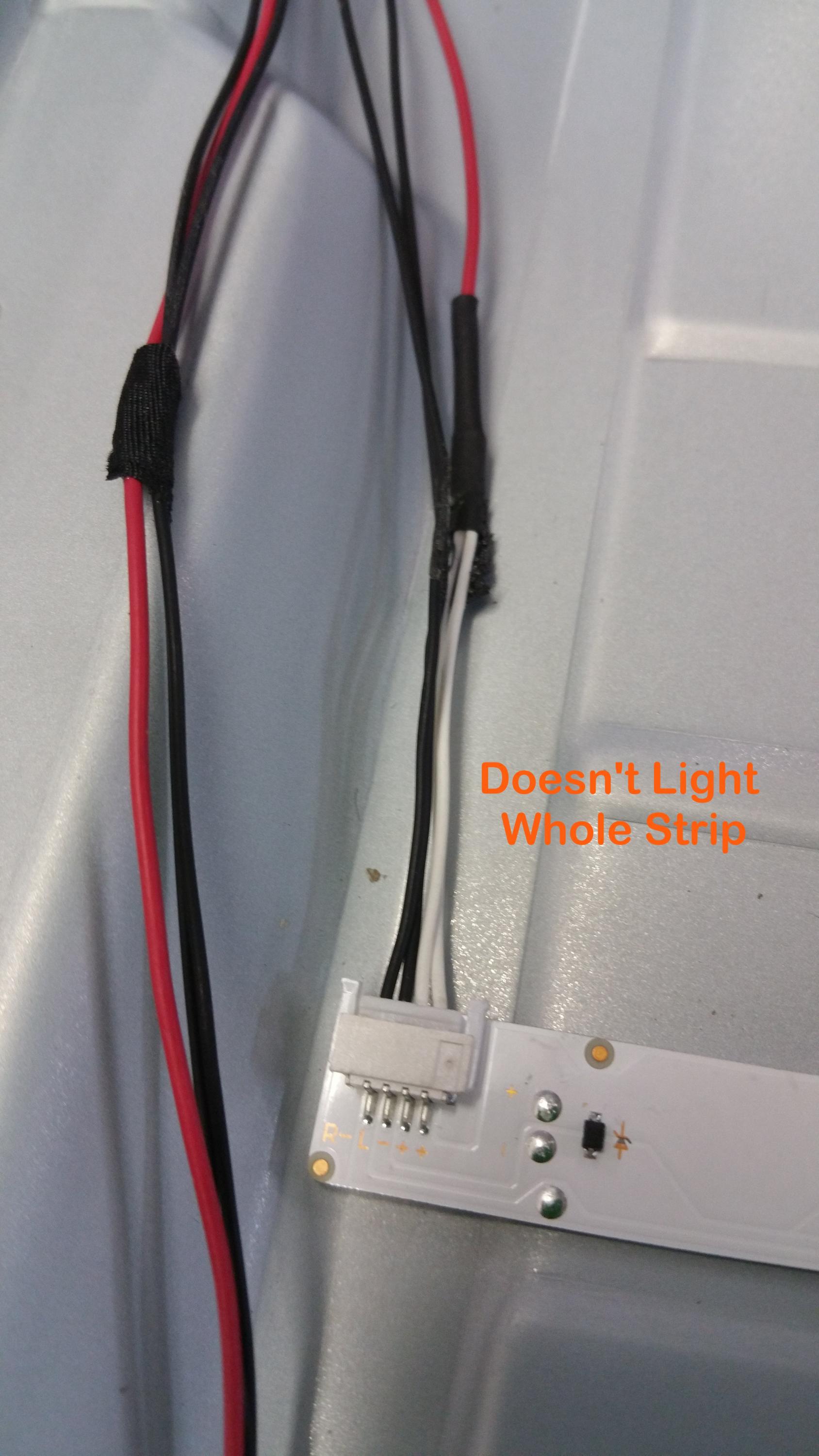

                        As you can see by the pictures, one full strip is off and another half strip is off.. but I DID swap those strips out for others that are fully working so I know the strips are good.. It must be in the Power PCB or PCB to Strip connector...
                        That's what I got so far..

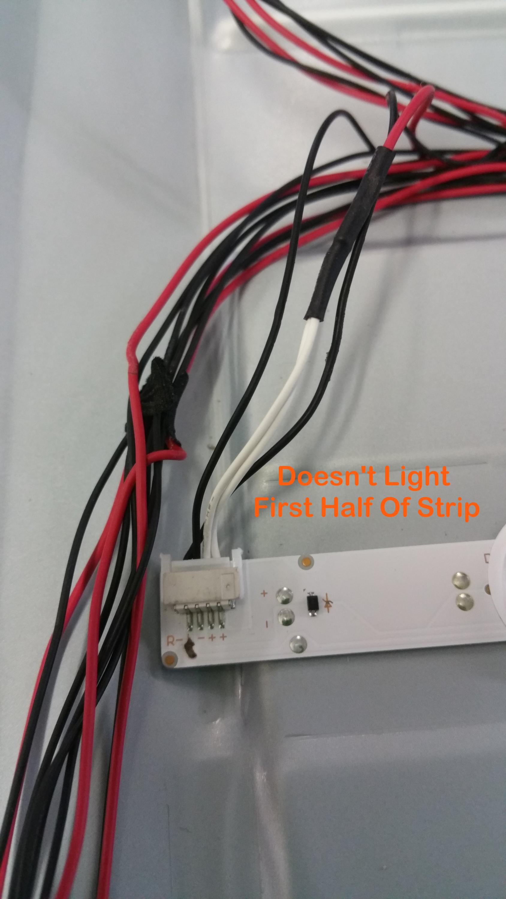

                          Closeups of the connectors that don't light up full strip and half strip..

                            Change out the LED strips for the COOL WHITE type. This will fix your problem. You could probably use the PURPLE LED strips as decorative lights.

                                OK I figured out the issue with the LED strips that don't come on.. Turns out when I was using my LED tester before cracking the unit open, I enlarged the connectors so they are not making a good connection..
                                Crimping them back into shape solved the not coming on problem..

                                  OK I ordered another set of LED strips.. Seller was kind enough to throw in the LED power PCB connector...
                                  Hopefully, the LED strips was the issue....
                                  I'll update the thread when they arrive...
                                  Thanx to all for all the help..

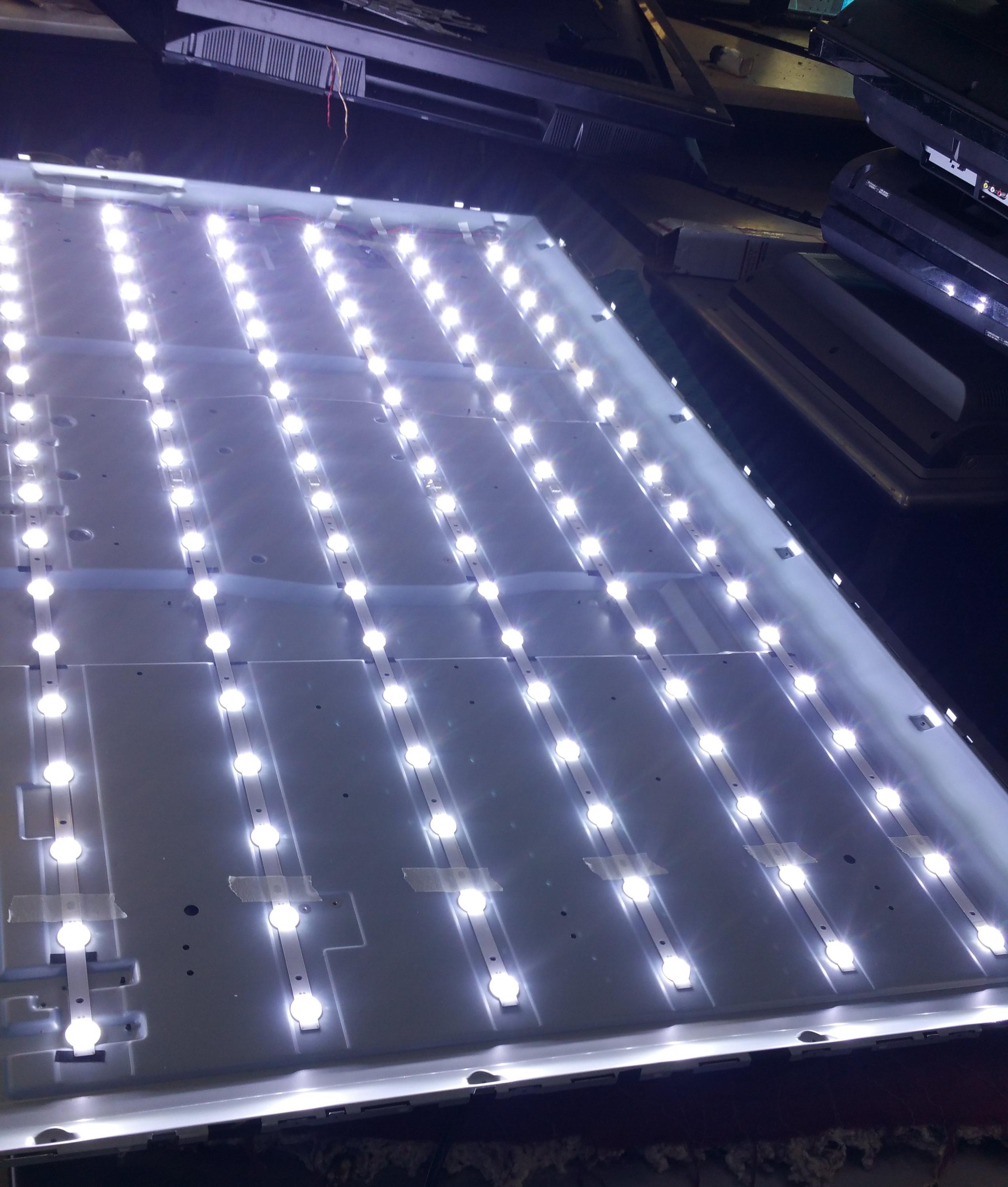

                                  • Michale32086
                                    • Nov 2011
                                    • 1453
                                    Re: Vizio E70u-D3
                                    Taaa daaaaa!!!!
                                    And no cracks in the display panel.. so far.
                                    I have to admit, I was skeptical of the idea that I could have an entire set of LED strips the wrong color...
                                    What could have possible caused that?? Is there a market for a set purple/blacklight LED strips??
                                    Anywhoo, we're cooking with gas now..

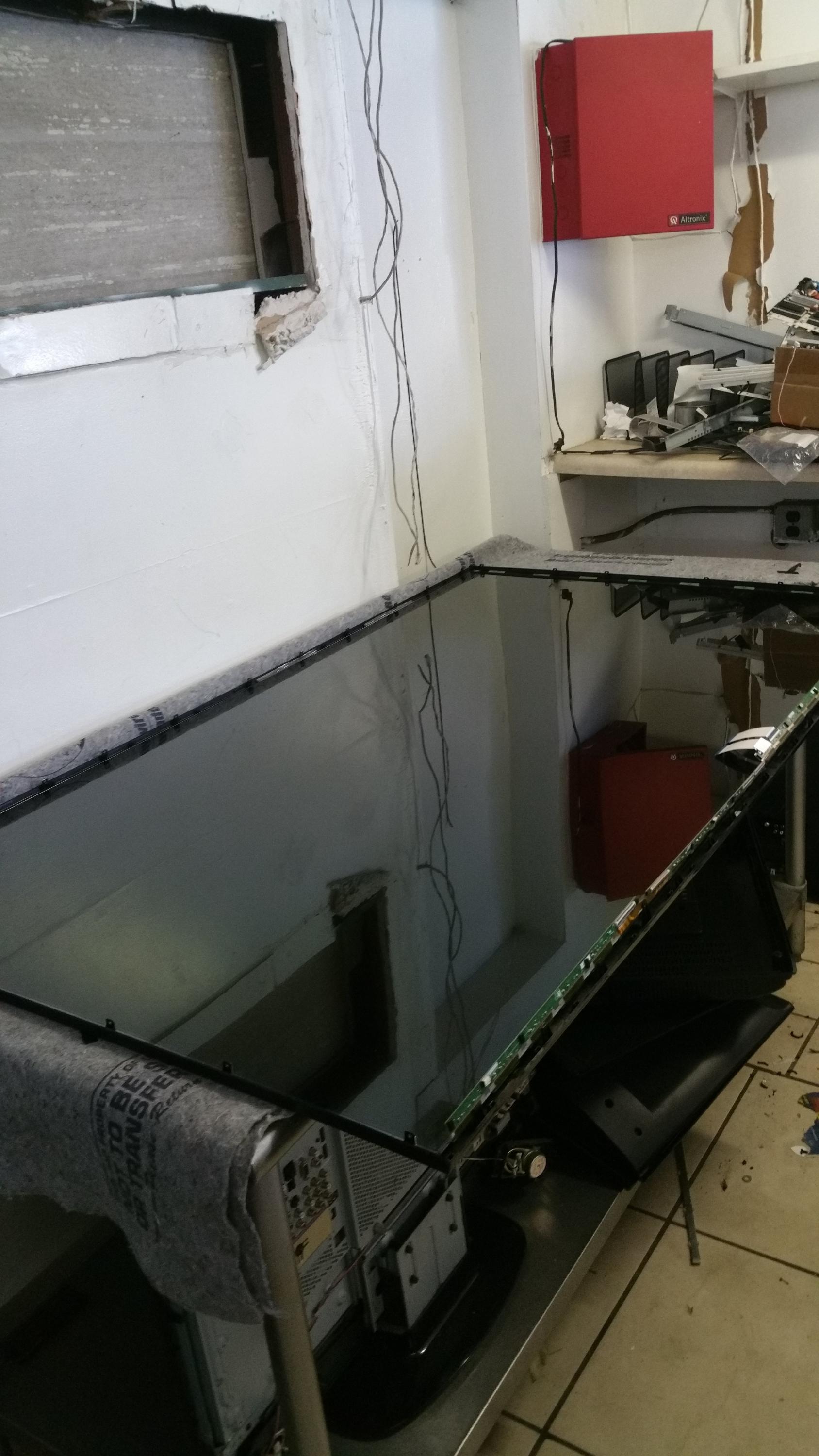

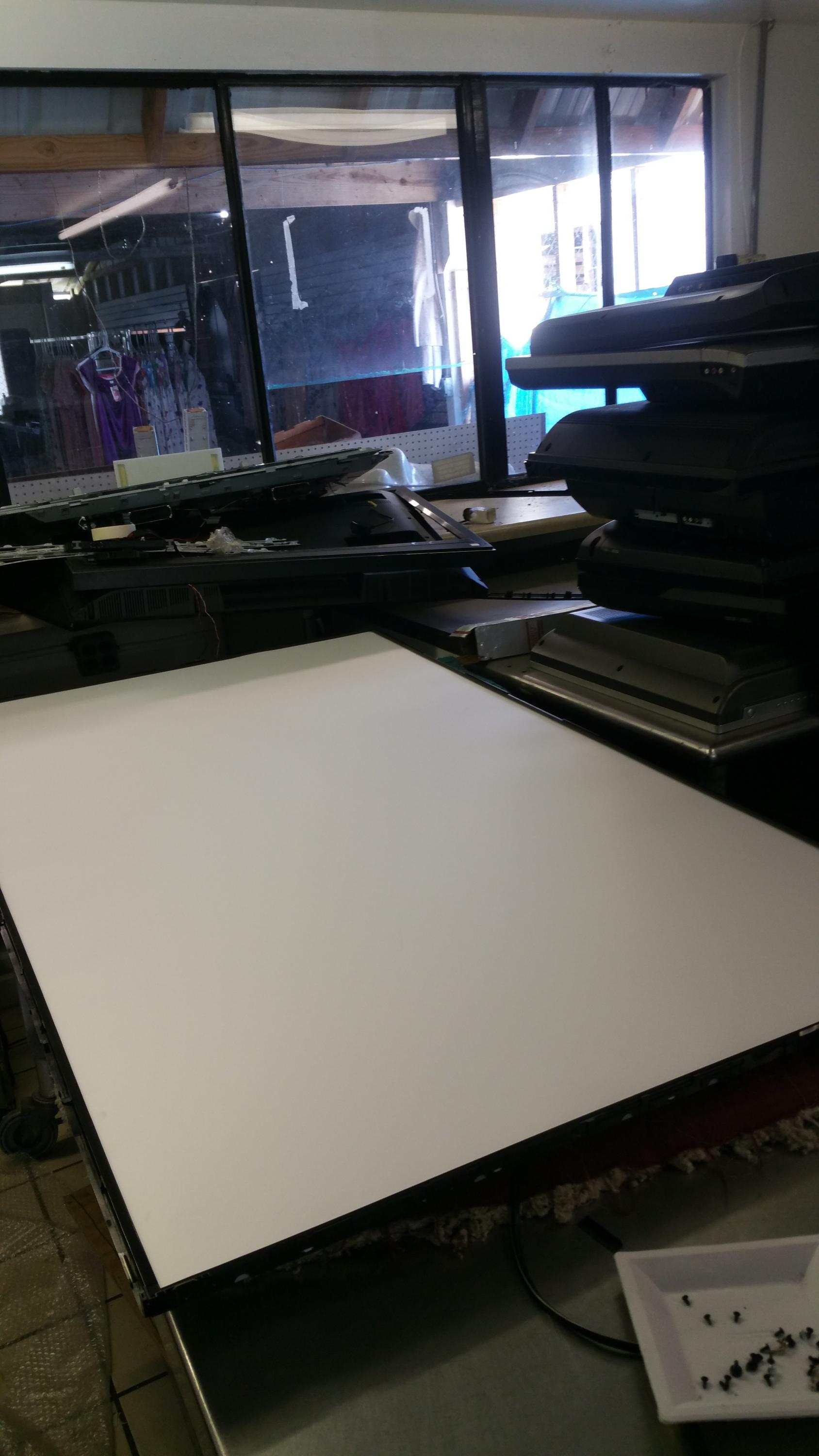

                                    One last dilemma..
                                    When I broke down the TV to the bare panel (I am a one man operation) I laid the TV on a flat surface and then proceeded to remove all the screws and fasteners that held the metal back of the TV to the panel and diffusing sheets... I then lifted the metal back off. Not an easy task, considering I have two bum shoulders..
                                    My original plan was to simply reverse the process.. Unfortunately, that plan did not survive contact with reality.. When I took the metal back off, the plastic frame that holds the diffuser sheets in place and forms the support frame for the display panel came off in pieces.. Not broken, but designed sections..
                                    So, being nimble on my feet, I took the diffuser sheets off the display panel and placed them onto the metal back of the TV (LEDs facing up)... I then proceeded to re-affix the panel support frame on top of the diffuser sheets and secured to the metal frame back...
                                    So, now I am left with this... The assembled metal back and the display panel facing downward...
                                    I am THINKING that my best bet would be to flip the metal back of the TV and, with the LEDs and diffuser sheets facing downward, place the assembled unit onto the display panel very VERY gently.. I can probably get my daughter to come out and help me lift it and place it..
                                    The only other alternative is to take the display panel, flip it front side up and then place it gently onto the assembled back part of the TV... At first I was thinking that's the worst possible way to go. But, as I typed it out and visualized it, it didn't seem to be as bad.. Especially if I have a helper to help me maintain the integrity of the panel without any major bends...
                                    What's ya'all's thinking???

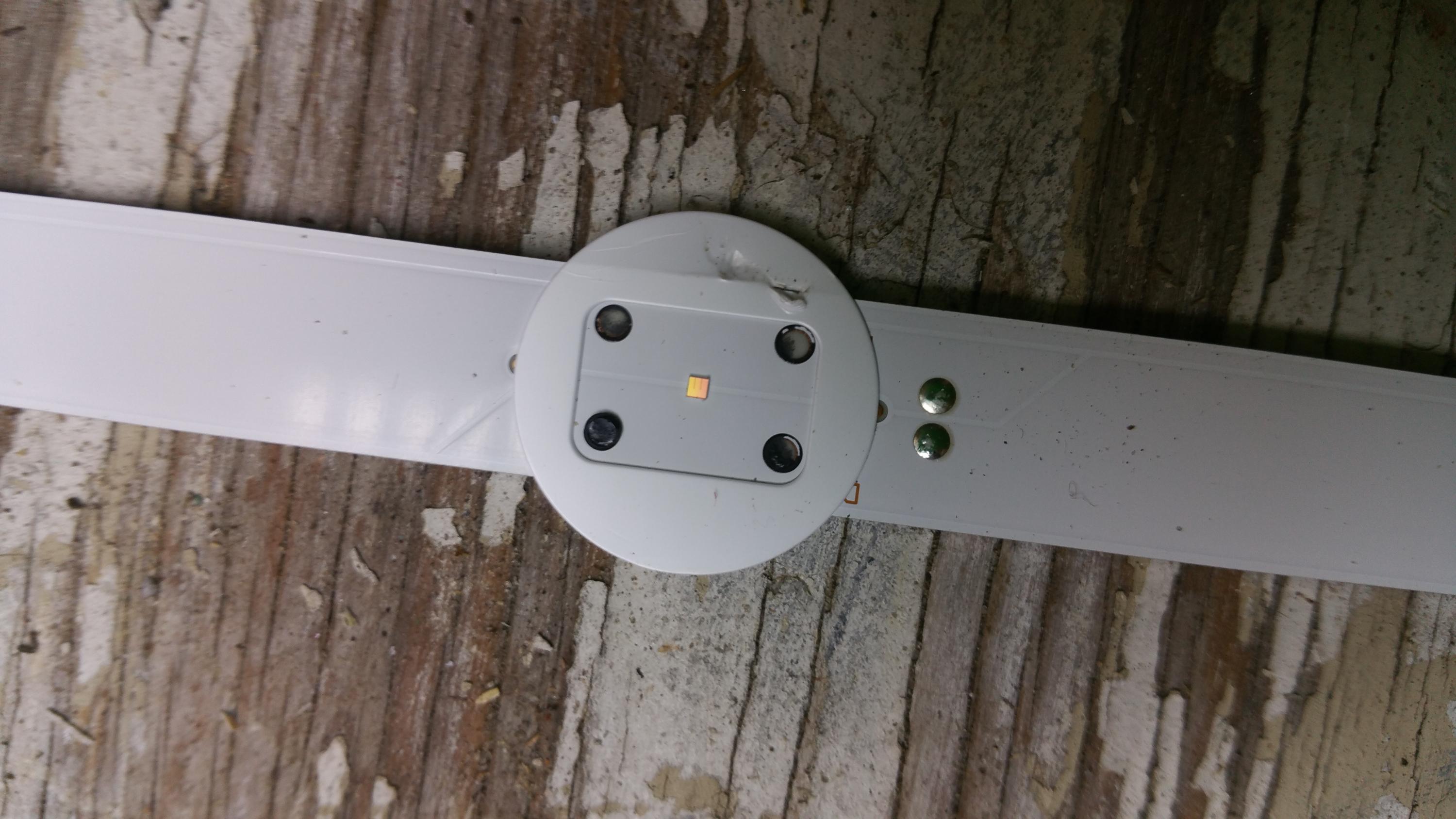

                                      Re: Vizio E70u-D3
                                      Can we see the pictures of the old LED with the LENS removed?
                                      • Michale32086
                                        • Nov 2011
                                        • 1453
                                        Re: Vizio E70u-D3
                                        Do you need them powered???
                                        Went ahead and did both powered and unpowered..
                                        Although the pics make the LEDs look purple, they are a definitive blue...
