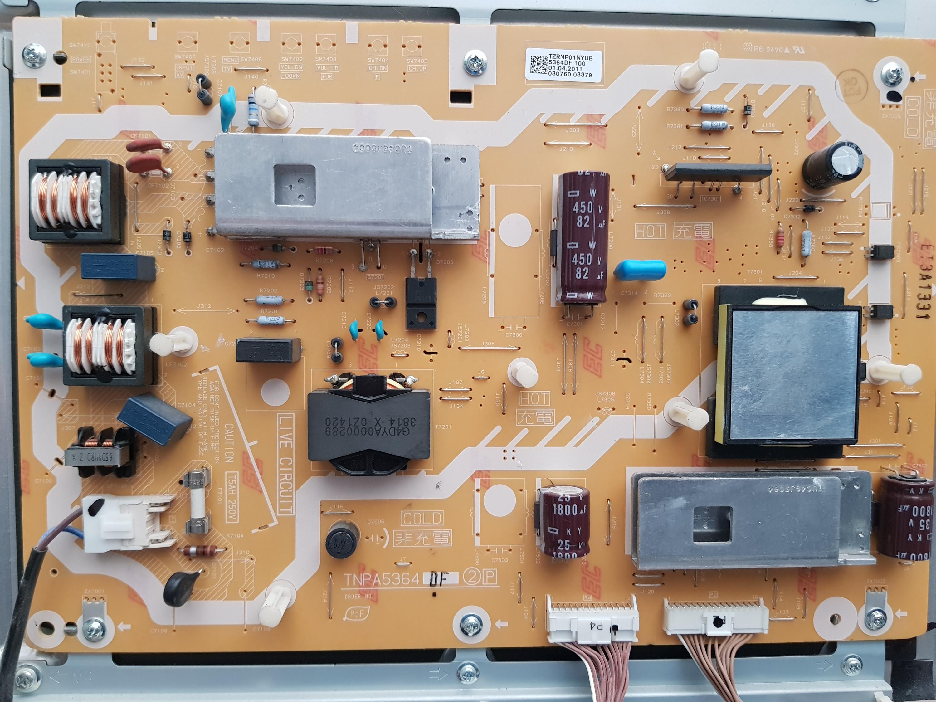

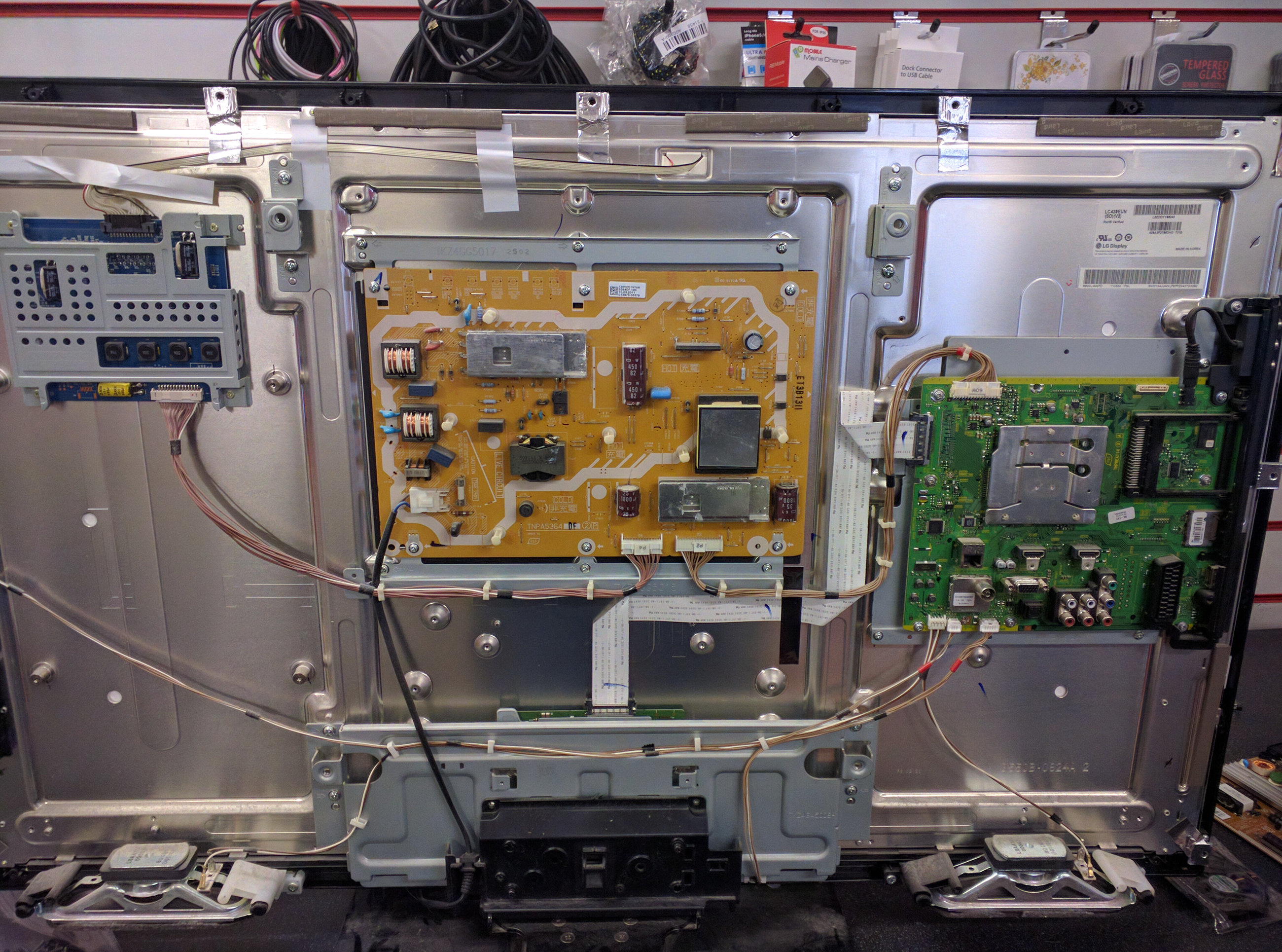

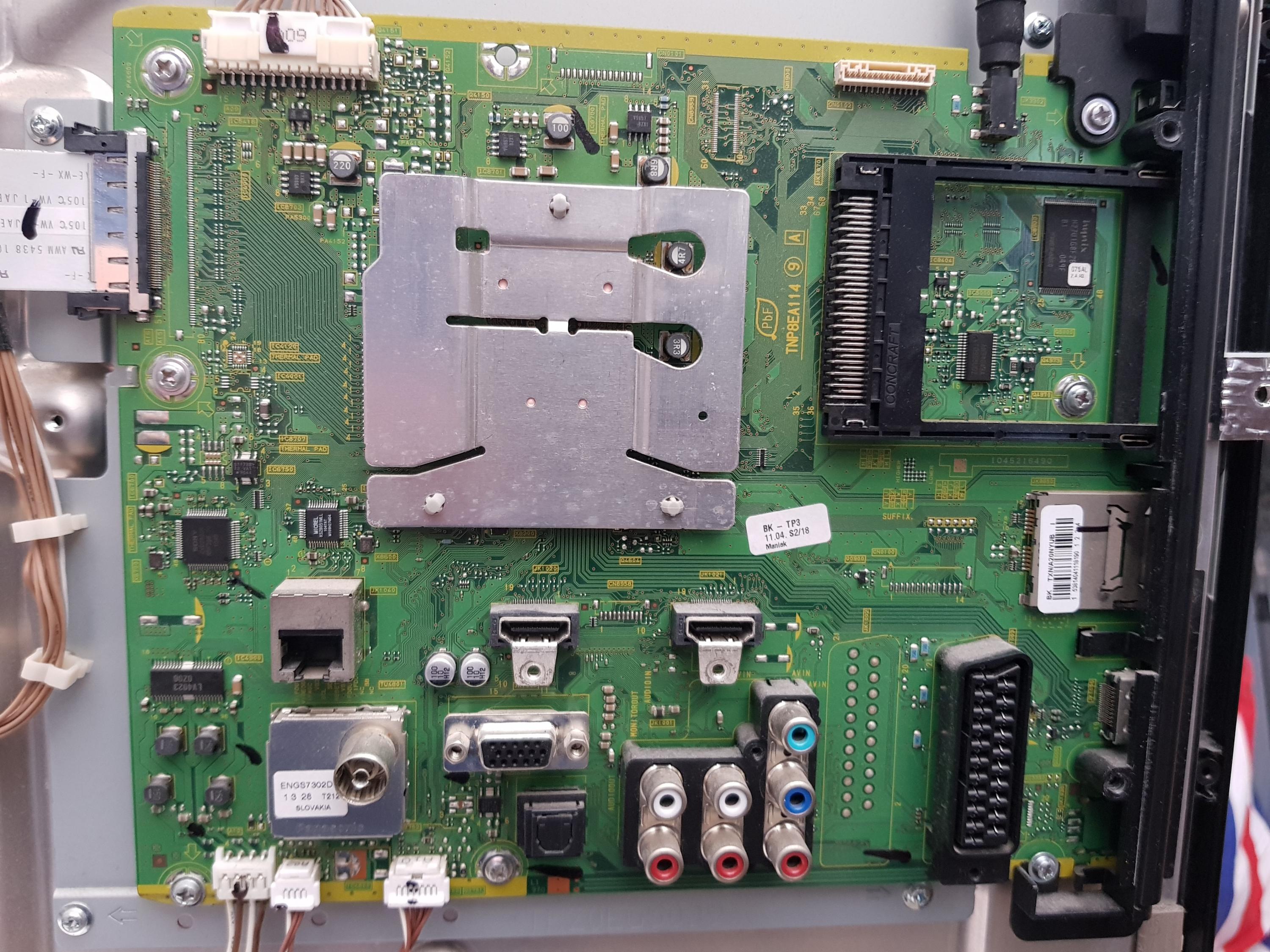

    Do you have any photo's of your circuit boards. Nice and sharp. Also any voltage readings taken when refusing to come back on?
    • ageman
      • Oct 2015
      • 45
      • united kingdom
      Re: Panasonic TX-L42E3B flashing red LED
      Here are pictures of the top of boards. Will get voltages when at fault, but ok at the moment. Think maybe main board issue.

        It could also be worthwhile checking the solder joints on the underside of the power supply board and redoing any that don't look so good.

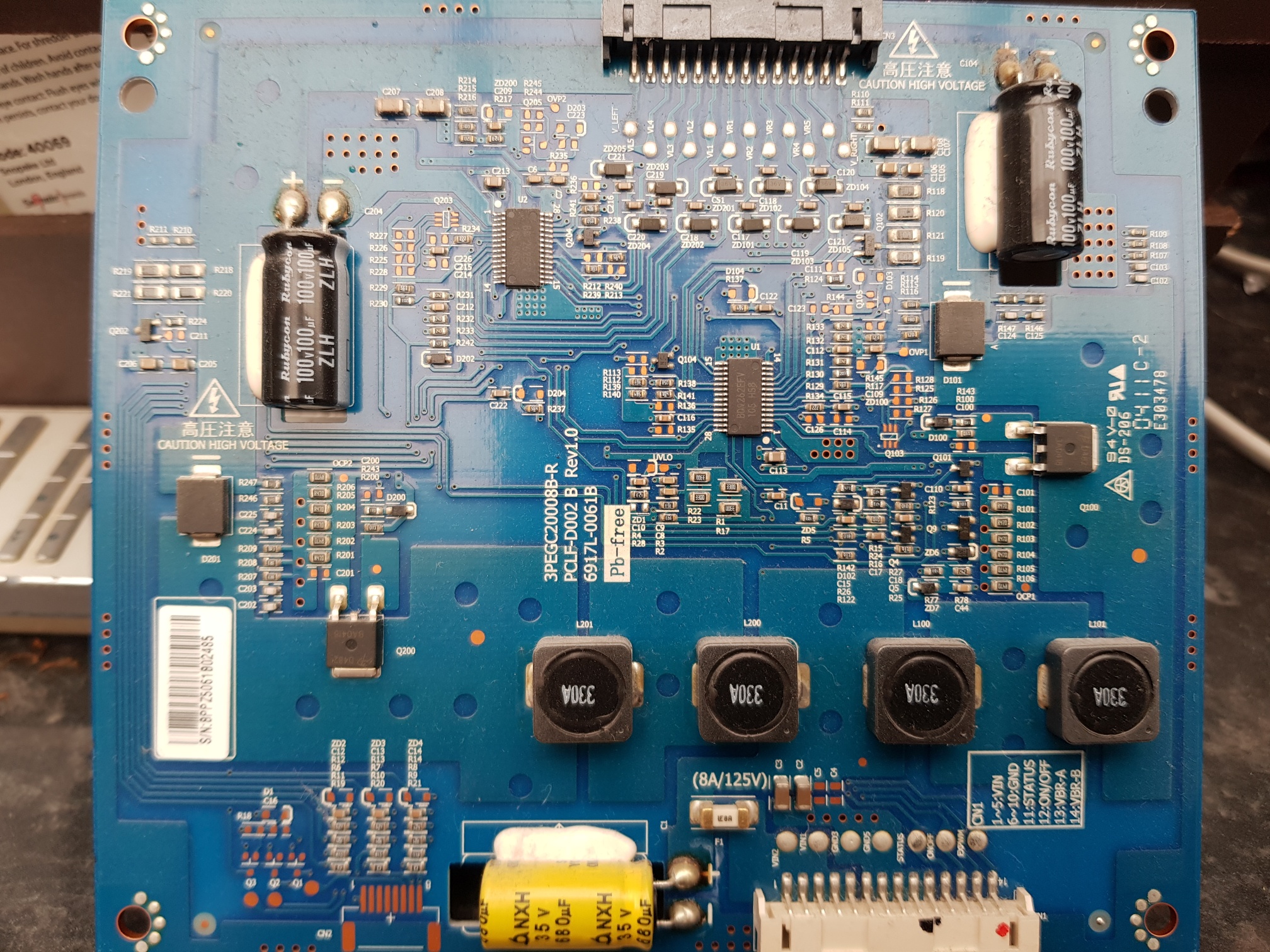

                        Found a picture of the complete sets circuit boards after searching this site.
                        You either have bad leds or possible led driver board.
                        Can you post a picture of the blue circuit board with metal shield removed so that any text on the board can be read.
                        • ageman
                          • Oct 2015
                          • 45
                          • united kingdom
                          Here is the led board
                          • thoma
                            • Sep 2012
                            • 268
                            WAIT UNTIL GET MANUAL APPEARS!!!!
                            • ageman
                              • Oct 2015
                              • 45
                              • united kingdom
                              Thanks dick barton and thoma. I have taken the tv apart and checked all the diodes, some are a bit iffy. I have managed to get some from a tv with broken screen awaiting arrival. Have also checked the LED board, andit looks like D100 has failed short circuit. It is marked UF 36. Assume it is a 36 volt diode, but not sure as cannot find a schematic for this PCB

                                      Sorry meant to say led's were iffy not diodes. Only had a quick check on the led driver board and found diode no 100 was short circuit. Got another led driver board for £11 fully tested. So not going to check out any further
                                        https://www.badcaps.net/forum/attach...2&d=1524588829
                                        D100 is connected in series with LOW OHM R143, that R/D NETWORK is then connected in parallel with R100 (about 10 Ohms) so that is why the diode shows conduction in both directions; that whole R-D/R network is for the Gate discharge circuit for that MOSFET Q100. It has the exact same setup at the Gate of Q200 (R243, R200, D200) for the #2 Booster circuit.
                                        Q100 is one of the two Voltage booster circuits, Q200 is second booster circuit.
                                        So the question is what Voltages do you have on all the pin of that white connector CN1 on that LED power supply/driver board when TV is OFF and when power switch is activated?
                                        What Voltage do you have when measure between the two legs of C1 (680uF 35VDC) when TV is off and when power switch is activated?
                                        What Voltage do you have when measure between the two legs of C104 and C204 when TV is OFF and when power switch is activated?
                                        BTW, you have 10 strings of LEDs: VL1 ~ VL5, VR1 ~VR5.
