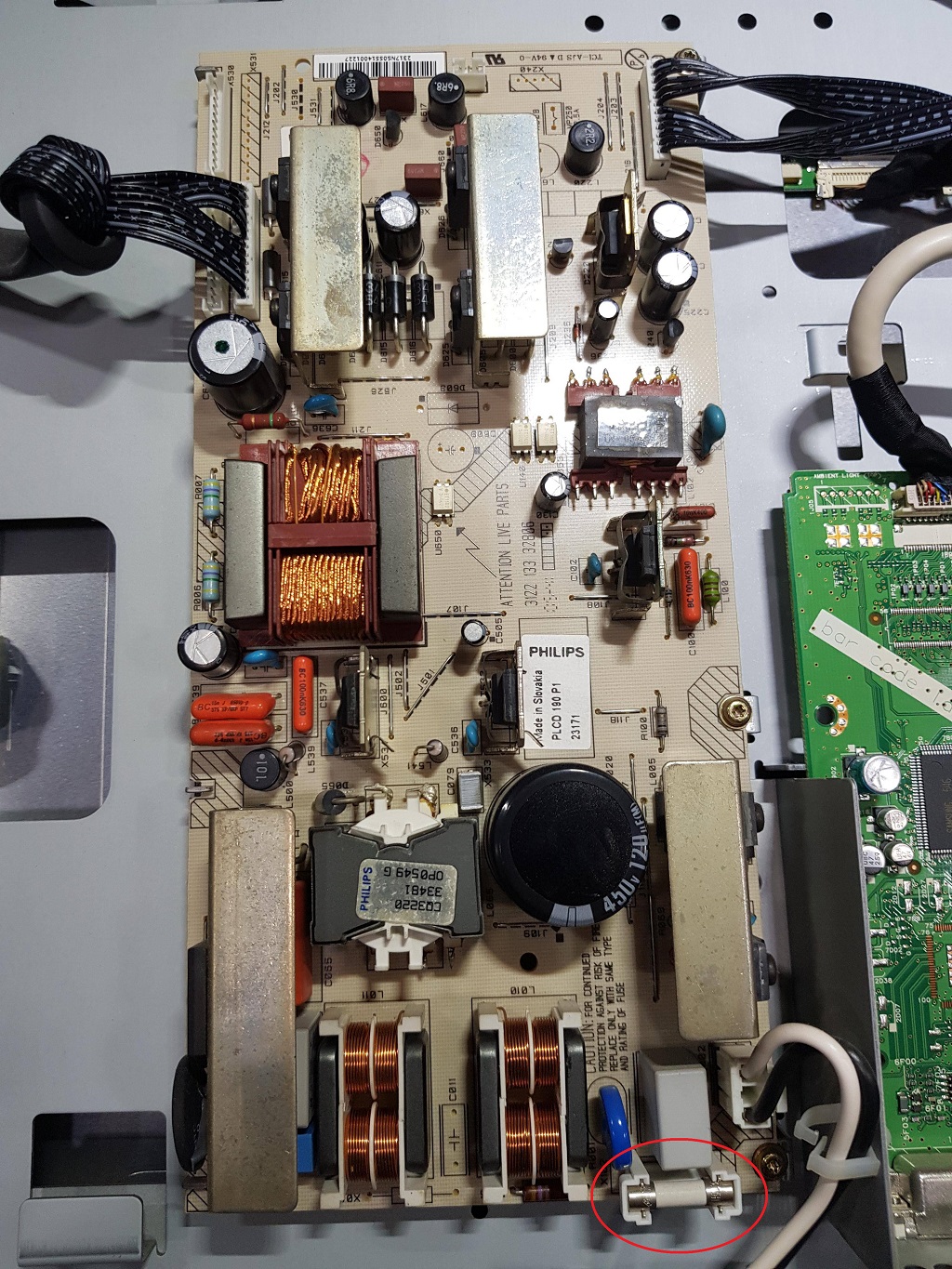

    This TV does not turn on even in stand bye.Does nothing.It is the Philips model 32pf5420 / 10 chassis with lc4.3e aa.As a power supply brings the model PLCD 190 P1 23171 and I have not found the scheme to be able to measure the voltages that come out to the main board. One help please.

    Maybe I don't understand the problem correctly but from what I make of your post, the TV does not even make it to StandBy mode, ie. no LED lights up, nothing. Am I right?
    If yes, did you check the very obvious fuse?
    (the one in the circle)

      Hi,yes, you right-No led lights up and the first things,it´s check the current cable and that fuse.It´s works.

        So do you have any DC Voltage on the connector that goes to the main board? All 0V?

          My problem is that I do not know what voltages and which wires from the connector that goes to the main board have to carry them.
          In other occasions you have the tensions and the name of each cable painting on the board, this time it has nothing and I can not find the scheme of the power supply.
            Re: PHILIPS 32PF5420710 not power on
            Right now we just need to know if there are any DC Voltages at all at the connector, so please just report what each pin has, that is what I will do if I have the board in front of me.
            BTW, sometime they print pin names on the bottom side of the board.
              We also need straight shot high res pictures of the whole bottom side of that power supply board so I can trace out the circuits.
                          Here is a partial schematic of the power supply

                              Thanks to the pdf of the source uploaded in this post, I have removed the power source from the tv and I have connected on pin 10 a voltage of 3.3v through a 1k resistor. After that I have measured the voltages in the connector and I have obtained these measures:
                              Pin 1:24,7v
                              Pin 2:0v
                              Pin 3:3,3v
                              Pin 4:3,3v
                              Pin 5:0v
                              Pin 6:0v
                              Pin 7:0v
                              Pin 8:11,9v
                              Pin 9:3,3v
                              Pin 10:3,1v in+with external source
                              Pin 11:0v
                              Pin 12:0v
                              Well, I think the problem is on the main board. What do you think?
