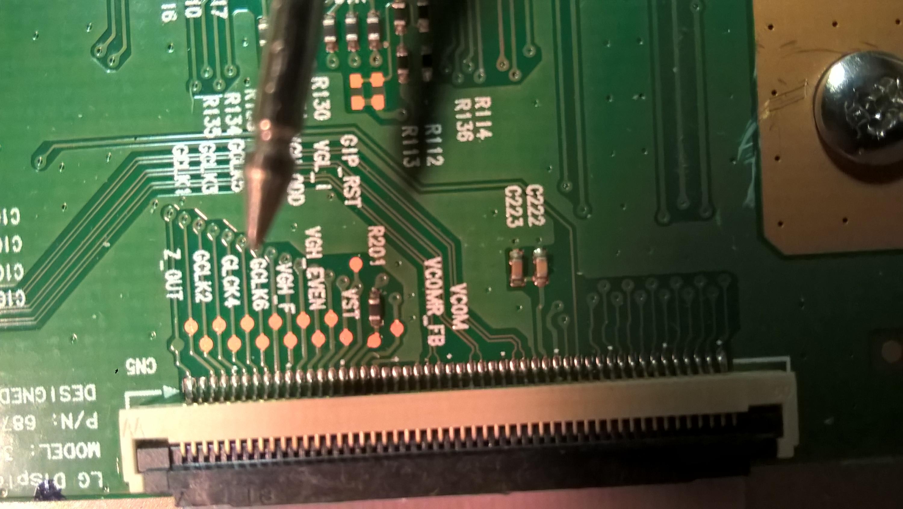

    Originally posted by nosugartonight View Post
    I'll check the other mlcc's . About the tcon I assume you seen that I posted the voltages on the outside. Is that right? 6 volts. Also I didn't check other side because there no test points. The side I did check was side going black. And wouldn't the screen side that goes black when tcon ribbon is disconnected, where the problem is..
    So do you have 12VDC feeding the fuse on the T-CON board?
      Re: LG no picture

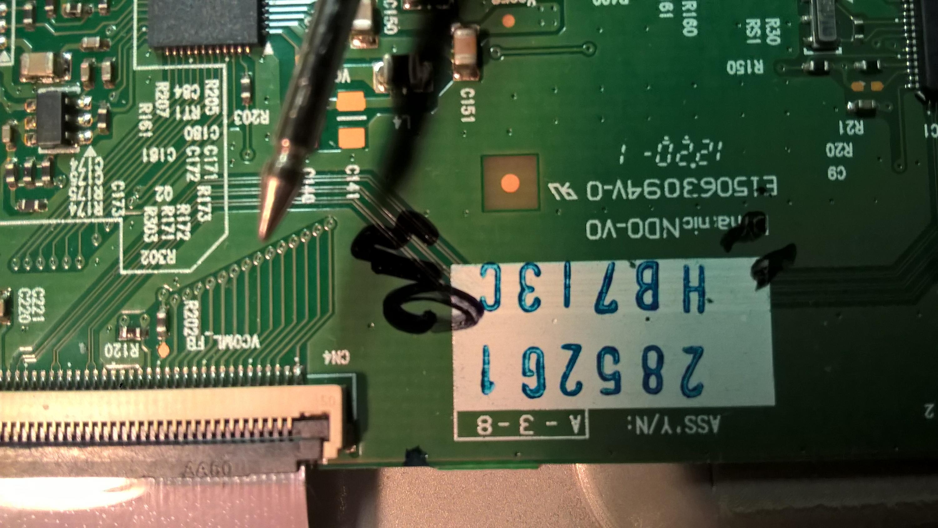

      Hay, take a look at these two pics. See where the probe is pointing. Where the test points really stand out. "first pic" This is where I get.698 on all except the last two on right. Ok the second pic where the probe is. Should I get the same reading here. I checked several and can only get.698 on one. Others are around .7
      Could it be the tcon.

          Correction 6.98 not .698
