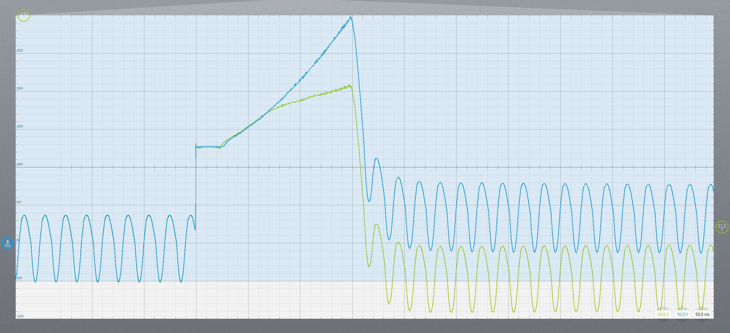

    Hello guys,
    I got this 65 inch TV from eBay.
    At startup the sony logo flashes shortly on the screen, after that the backlight turns off (I still can see the sony logo a short time) and the TV starts blinking 6 times with the standby LED.
    Has anyone the service manual for this TV?
    Thanks!
  • Hauke
    • Jan 2017
    • 77
    Re: Sony KDL-65W855C blinking 6 times - service manual?
    I did some basic measurement now:
    The TV has 2 connectors on the PSU for the LED backlight. They are rated for: 173.6V - 250.3V at 740 mA.
    I measured them with an oscilloscope at the moment of the short backlight flashing. One rised up to 203V and the second rised up to 296V. After that the PSU shuts down.
    So I think one LED strip is damaged. I will check this now.

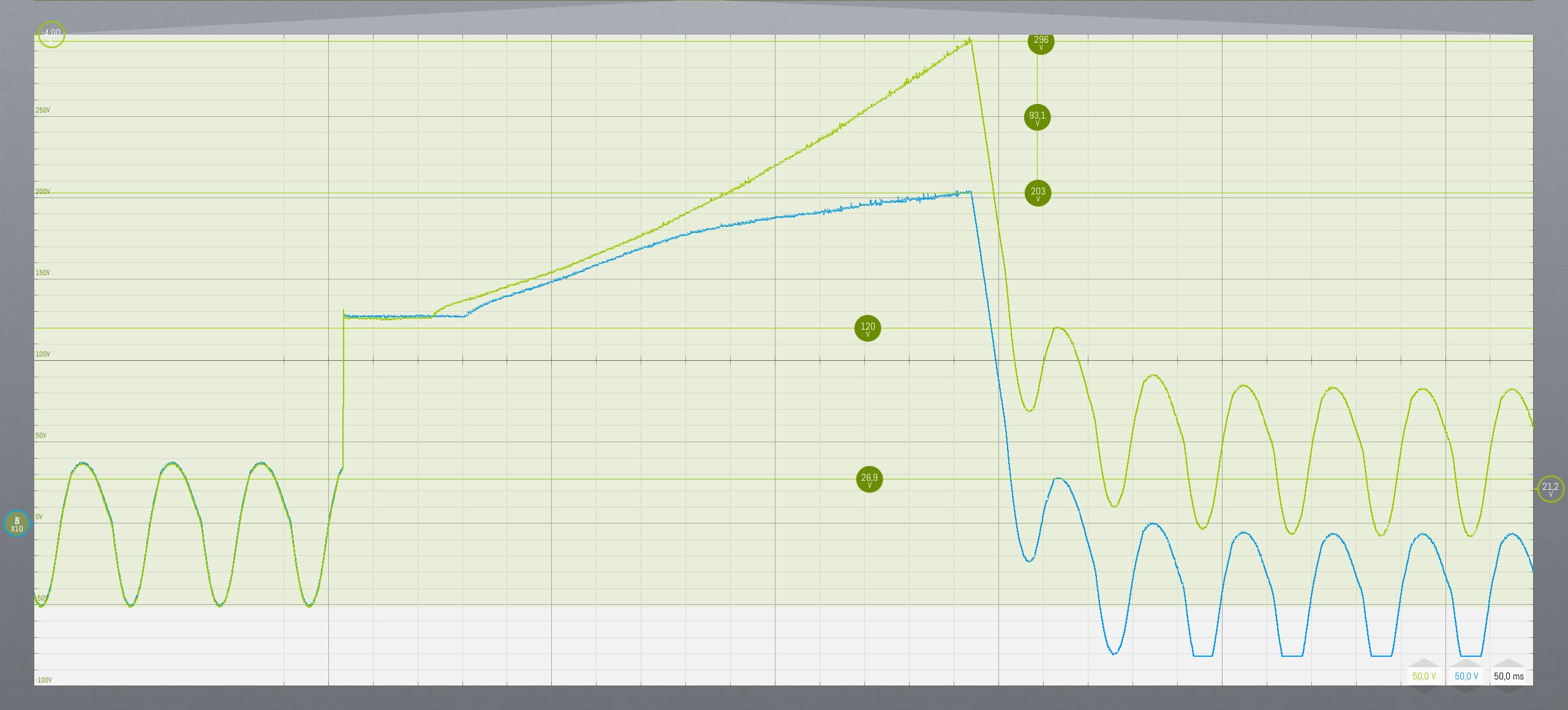

      I swapped the two pins on the LED Strip connector.
      Now the other channel of the LED Driver rises up to 296V.
      I think now It is clear, that the error is in one LED Strip.
      I will keep you updated, if you want.
