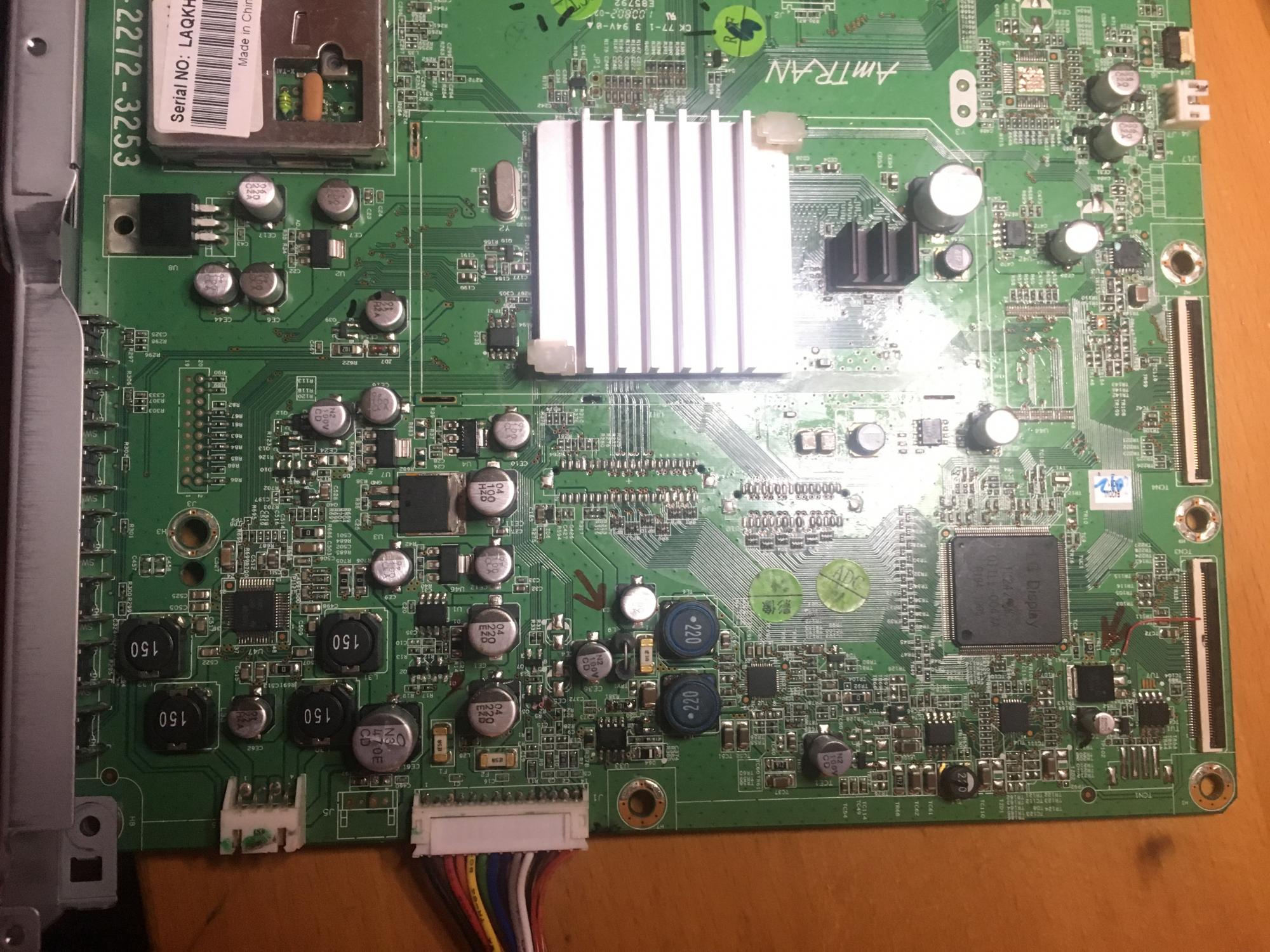

                      POSTING UPDATES TO THIS THREAD REGARDING NEW FINDINGS
                      Thanks to all who have taken the time to review the previous discussions adding their input, I appreciate this so very much.
                      The model of this set is E420VL not the original one stated which was a mistake in my part. Focus has been on the System board over the last several days checking voltage regulators, and chips containing dual MOSFETS. Since I have no schematic it's the only thing I can do for troubleshooting.
                      ORIGINAL ISSUE: no start, set dead with 5.0sb, & 12v, no BL no video no audio.
                      Testing system board alone using dual power supplies to provide 5.0 and 12v, with PSON 3.3, LAMP 2.58, no DIM or on/off voltage present on power supply harness pins connecting system board.
                      U33 and EEPROM replaced sourced from SJ SUPPLY.
                      Note the attached picture specifically the area of the two 220μh coils. This area is contains a red arrow on the board. U33 has sources voltages for both MOSFETS but no corresponding drain voltages on either. This is a new part from SJ. The fuse in this area also measures continuity but no voltage. I feel this could be a major part of the issue but with no schematic, it's diffucult to trace the supplying sources but it appears to be U33. Could someone with a schematic or familiarity with this circuit please comment as to the missing Drain voltages.

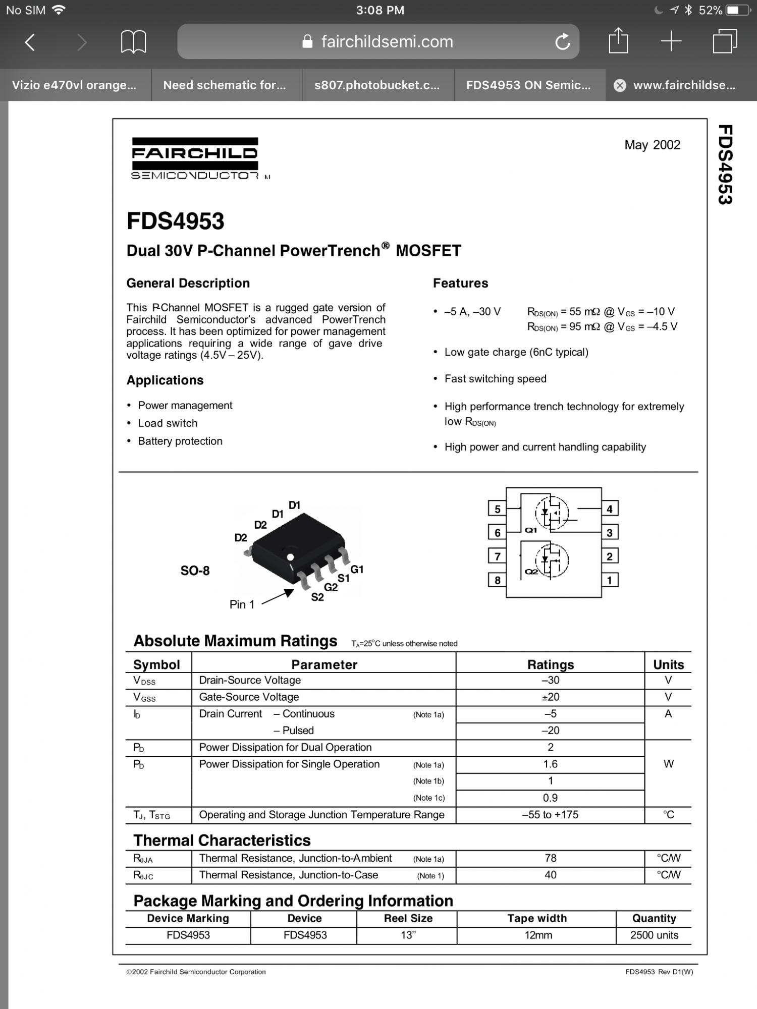

                            So what is the P/N of U33?
                            The spec sheet of the IC may have application notes circuit showing how to use the IC.

                              hi Bud, I will set back to you on that in just a bit it's a dual MOSFET good suggestion though.

                                Bud, U33 is a Fairchild FDS4953 P channel requiring -5v to -10v for the source to drain resistance to be 55mohm. Don't believe the gate voltage source is present.
                                  #36
                                  Re: Need schematic for Visio LC420
                                  OK, it is P-CH and the + Voltage is fed to the Source pins as expected, so for the MOFETs to be on the Gate Voltage has to BE AT LEAST 3V less than the Source pin.
                                  So what is the Voltage on the Gate pin with ref to the circuit GND?

                                          Bud, the dual MOSFET U33 is connected in parallel on the board. The gate is driven by an NPN the collector, the base is fed from the main processor chip. A positive going pulse or high would cause a low st the gates. This is obviously not happening since the drains are showing 0vdc. Just an update at this point but the main board is NIT connected to the power board, instead the 5.1v and 12v Raul's are being supplied by two separate P/S connected to the same point as normally supplied by the power board.
