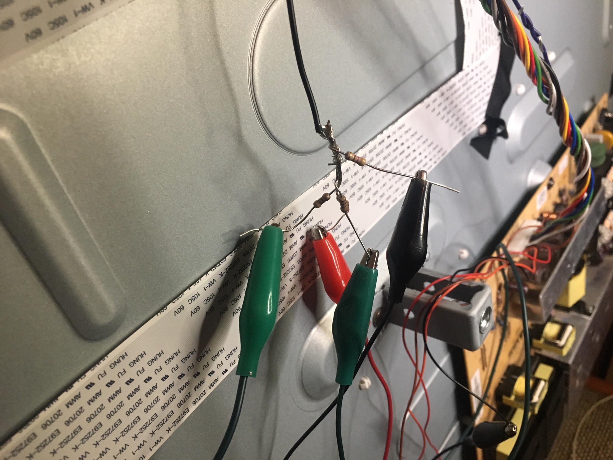

                      I tested the connections suggested using 470 ohm resistors to feed the three pins as stated. With the system not connected, as stated, there is no power from the supply except the 5 ST. There is also no 12v from the supply either and there is only 100vdc on the 160Mf cap on the power board.
                      When the system board is connected with all connections restored as normal, the high voltage DC used to power the chopper on the power board returns to 385vdc. Something is causing the power supply to shut down if disconnected from the supply. I am not aware of any supervisory or shutdown from the system board if not connection but there must be.
                      Can you please assist as to why this is occurring. Someone with your experience and familiarity with these sets would likely understand the issue without a schematic in hand. I did manage to find another power board on ebay the seller claimed was good, and having no previous repairs, after a detailed inspecting I saw no reason to doubt the seller and installed it. There was no change in the original symptoms of no audio or back light.
                      Your input would be so much appreciated, as I feel I must have over-looked something critical.
                      Thanks so much!!

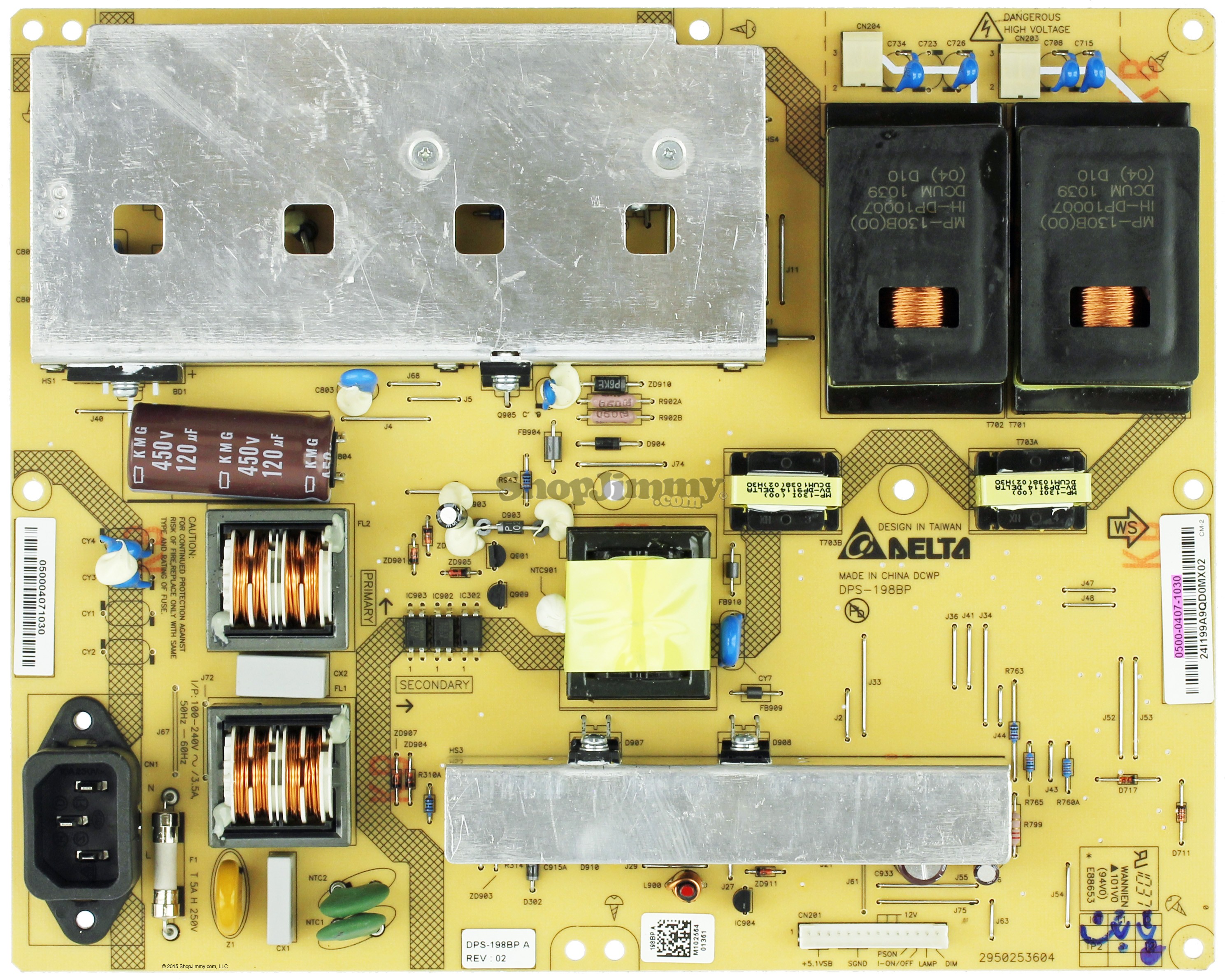

                        It sounds like you are not getting the connection between PS-ON pin and the 5VSTBY pin to simulate the the PS-ON signal, we know that the PS-ON is being sent by the main board when the cable is in place so all we doing is to simulate the PS-ON signal using the resistor. Please recheck your work.
                        "and there is only 100vdc on the 160Mf cap on the power board." That must be an error because that cap get it Voltage from the bridge rectifier (as you can see how it is connected on the bottom side of the board) the minute you plug the power cord into the AC outlet, it should show around 165VDC right between the two legs.
                        BTW, did you count the pins of connector CN201 correctly? Can we see the pictures as how you have those 3 resistors connected?
                        Vizio 0500-0407-1030 Power Supply/Backlight Inverter E3D420VX E420VL E420VO
                        http://www.shopjimmy.com/vizio-0500-...pply-unit.htm#
                        Pictures provided by shopjimmy.

                          I think i misunderstood your instructions above simple as they are. There are four isolation resistors required for this test since there are 4 forced line to the 5vSB rail.
                          This time I did not leave out PSON which I had previously and all voltages appear normal except the PSON voltage which was 3.9vdc compared to the other leads all at the 5v SB rail. Still no BL on screen.

                            The 5vsb from the power board is cut so as not to feed the system board and where there are (4) 470 ohm resistors each connected via jumper from the four pins you specified and as just reported have the correct voltages but still no BL. Again the PSON lead is being pulled to 3.9VDC by the power board but the HV DC on the main cap has returned to 335vdc. I am using the other power supply I purchased. I cannot use my original supply since removing a switching diode marked A6, a MOSFET marked RNW03 (I think its a MOSFET) for measuring and managed to accidentally discard them for bad components I intend to replace these as soon as someone can identify a replacement I can get from Mouser or Digikey. Hopefully you can help me identify these so that I might determine if my power board was indeed the cause but so far, it does not seem that way.

                              You have to remove the cable that go the main board so it has no connection to the power supply board, we are tying to test power supply board as a stand alone.

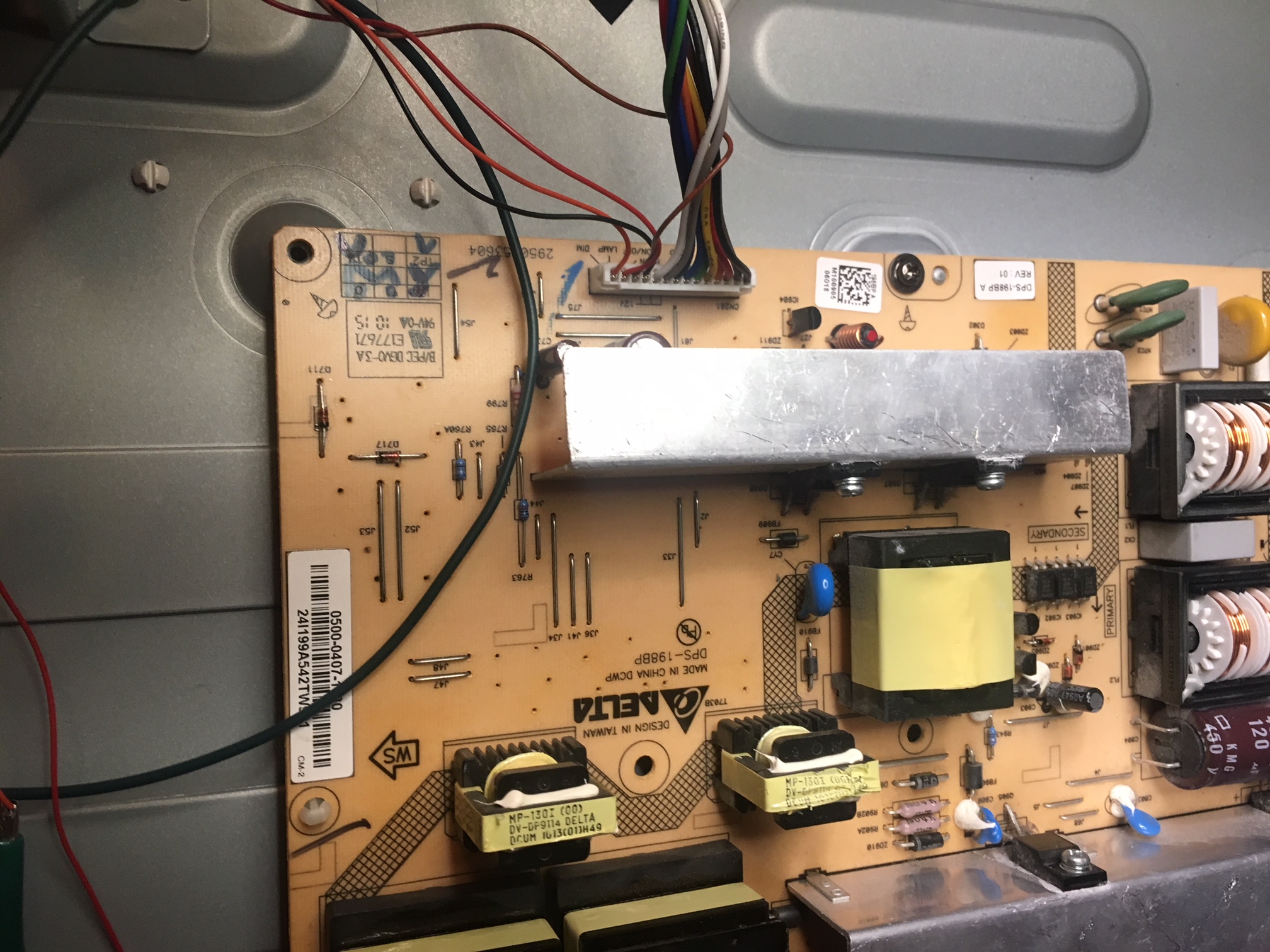

                                  I was improperly metering the 160uf C804 cap when reporting its voltage. I was referencing chassis ground on the secondary side not the primary side which is ~53v above the secondary ground. The true voltage is 390vdc as you stated.
                                  Wanted to measure the BL voltage using a voltage divider composed of 1meg resistors the drop across each would be within the range of digital multimeter.
                                  Would that at least give me a reference to determine if the BL Anode voltage is within range to provide some BL indication. I want to eliminate the power supply with this one test. Then I can proceed to check the lamp circuit for an open or other obvious default. Your thoughts please..

                                    If the main board is not connected to the power supply board, the BL-ON is present and the CCFL lamps connectors are in place, PS-ON is present, Dim is present then when you plug the AC cord in to the outlet you should then see the backlights come on and stay on if power supply, inverter, and backlights are good, if the backlights flash on for seconds then you may have inverter or lamp/s problem. Ii will only take one bad lamp to cause the inverter to go into shutdown AFTER the good lamps come on.
                                    No need to use resistors on those high Voltage (~2000V high frequency AC), the value has to be correct to draw the minimum current otherwise the protection circuit will also kick in, so watch the panel in dark room to see if the backlights even try to flash on or not.

                                      There is an LED under the power board themat comes on and remains illuminated for about 4 seconds the goes out. What is the purpose of this LED? Could it be a fault indicator?
