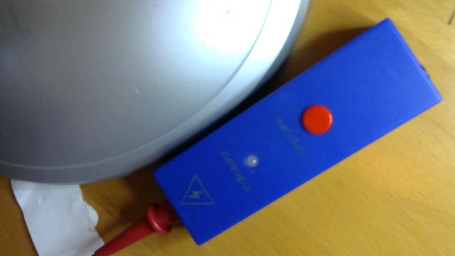

    To answer your question about the tester I have a cheap HV generator sold on Amazon and other places for checking CCFL's. No model number on the case attached is a picture.
    This lights up the low wattage <14 watts you suggest using as test fixtures for checking inverter output and it performs nicely for that purpose. That is what I am using to test my CCFL bulb as a tester confirming that it will detect HV.
    Given the two HV outputs on the PS which is connected to the TV lamps, when testing these output points would the test CCFL not need to reference the common point or ground point of the Primary side in order to make an accurate check? I did not do this when testing the CCFL test buld and it the strengt of the HV was sufficient to light the bulb at least medium brightness or possibly full brightness given its low wattage.
    The results of the CCFL test bulb on each phase of the HV lamp drive is NO LIGHT and as far as I could see, no noticeable flash for protection circuit to check the load. I then attempted to check the lamps in the set however only injecting the HV from the tester into each leading to the lamps. Saw noe of the lamps light. But is that test truly valid since the lams need both phases of the signal to even flash, and I can only supply one phase at a time?

      There 1 pair of high Voltage wires.
      The lamps are driven out of phase that is why there are two transformers due to the length of the lamps, inside the panel there are ballast cap for each lamp so the lamps are not connected directly in parallel, unless the lamp are EEFL type then they they can be connected directly in parallel and not need for the ballast caps.
      "Please recall this set has a combined inverted power board and this is the second board with the TV same symptom" bur we already know that it has problem with the bad main board, right now you are trying to verify if the power supply/inverter and lamps are OK or not.

      In order to isolate any power supply issues from a lamp issue, when testing with CCFL test lamps, would I not have to use two test lamps, one for each phase connection from the PS? Otherwise, would I even see a blink on a single test light?
      Testing the lamps in the set, again today with the HV test fixture in the picture from my last post, only one set of lamps on the set were seen to light through the holds in the back panel but no light on the screen. The other set of lamps in the set were no illuminated. It seems obvious that I have either no connection to those lamps in the panel or something more.
      I think this needs to be corrected in order to go further, do you agree or am I drawing the wrong conclusion from these test today.

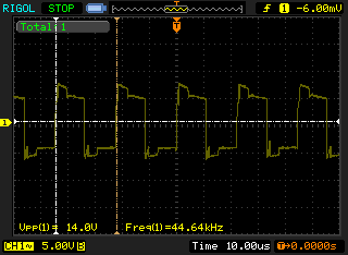

                  Thanks and please advise when find the pinouts, I’ll continue the search as well. I’ll report back on the voltages measured as suggested. Also have a little info on ringing of T703A/B probing at the inverter output using a 12v source current limited <1 amp. Not all that revealing but something..

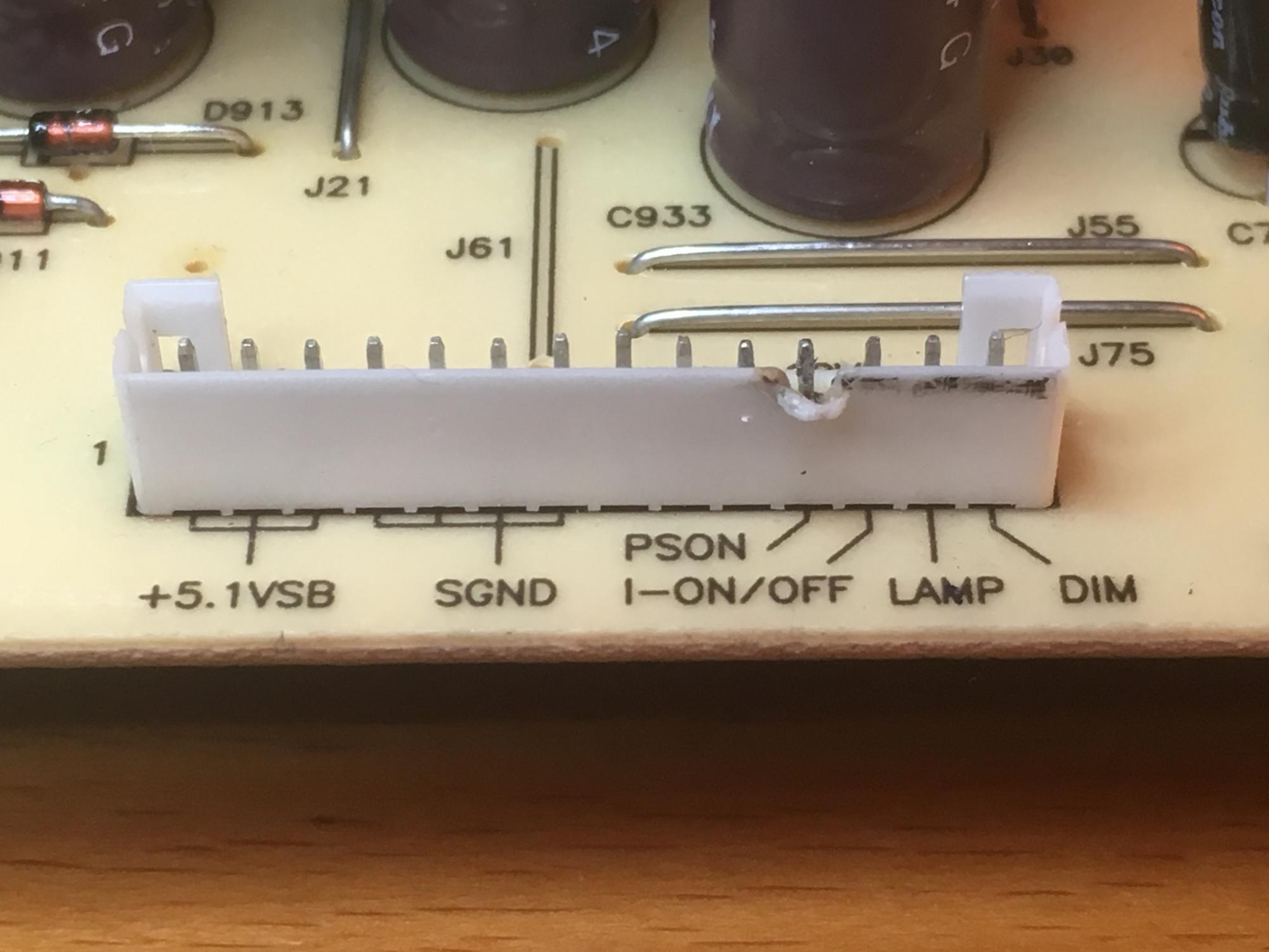

                      Do not trying using any other power supply, just run the power supply board by itself with all the forced on resistors in place, the board does have 12V present when PS-ON is present. I have you check the those Voltages at the resistors is to find out if the I/ON/OFF (BL-ON) gets all the way to the switched transistors (Q729, 730)or not to give 12V to those resistors.
                      If you power up the board and still there is no 12V at those resistors then it means you did not make good connection with the forced on resistor to the I/ON/OFF (BL-ON) pin or the BOTH switched Transistors are bad which I doubt that both of them would have gone out.

                          Probing secondary of T7037A&B pins 8&9 45Khz measuring with freq detector on multimeter.

                            OK, so the switched Transistors are turned on and supplying the Voltages, one end of those two resistors should go to the VCC pin of the PWM IC.
                            It sounds like the IC is working, you can disconnecting the the BL-ON force on resistor to see if the 45Hz will go away or not, I actually expecting higher frequency than that.

                              Measured at T703A

                                  Will check. The drive at T703 scope capture suggest things are normal to this part. You agree?

                                        Panel model is LC420
                                          Re: Need schematic for Visio LC420
                                          So does the signal go away when you remove the BL-ON resistor?
                                          There isn't a BL on pin, there is a Lamp pin but I thought that was not for turning on/off the BL but used to monitor the lamp? Is that incorrect?
