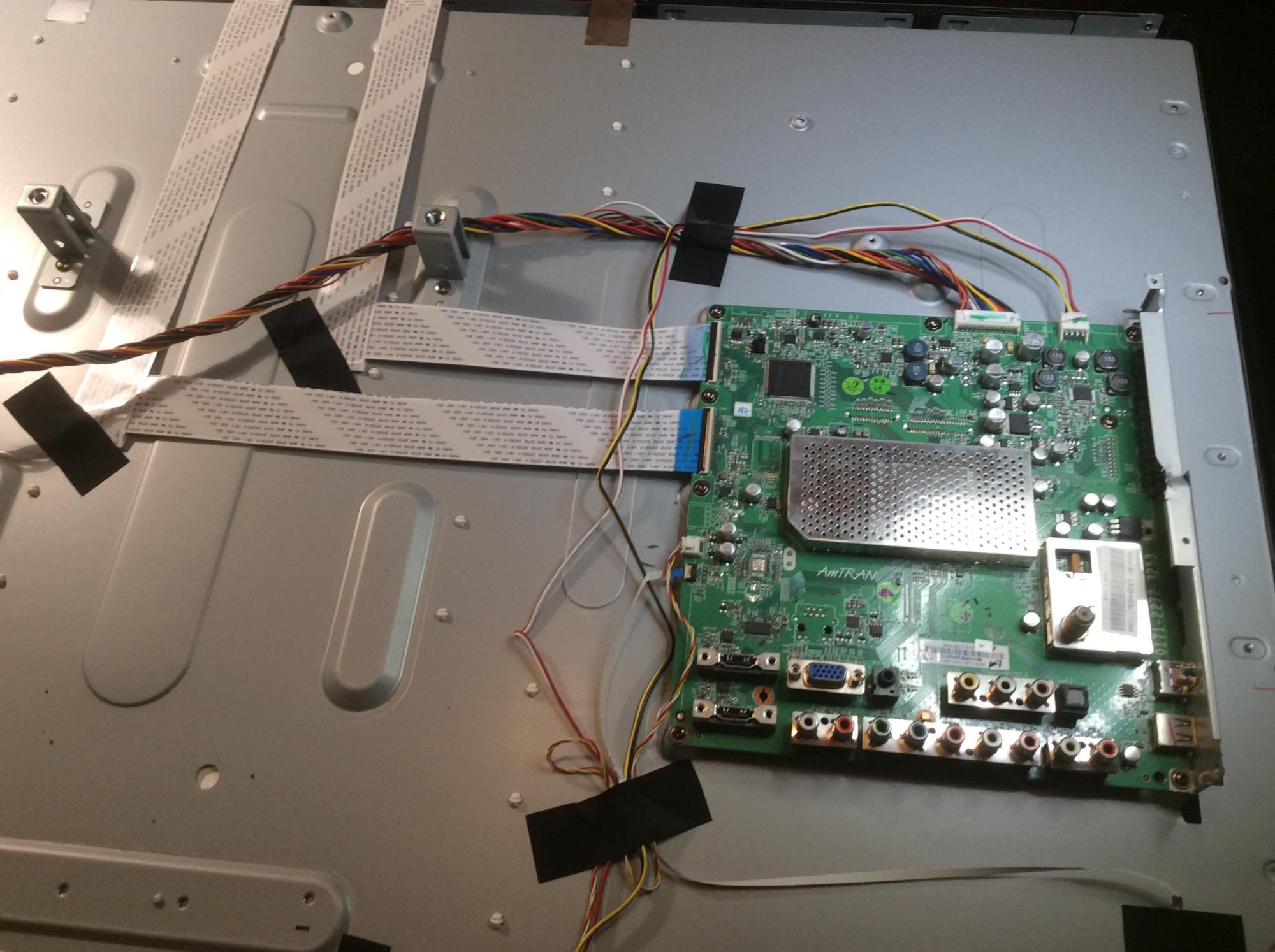

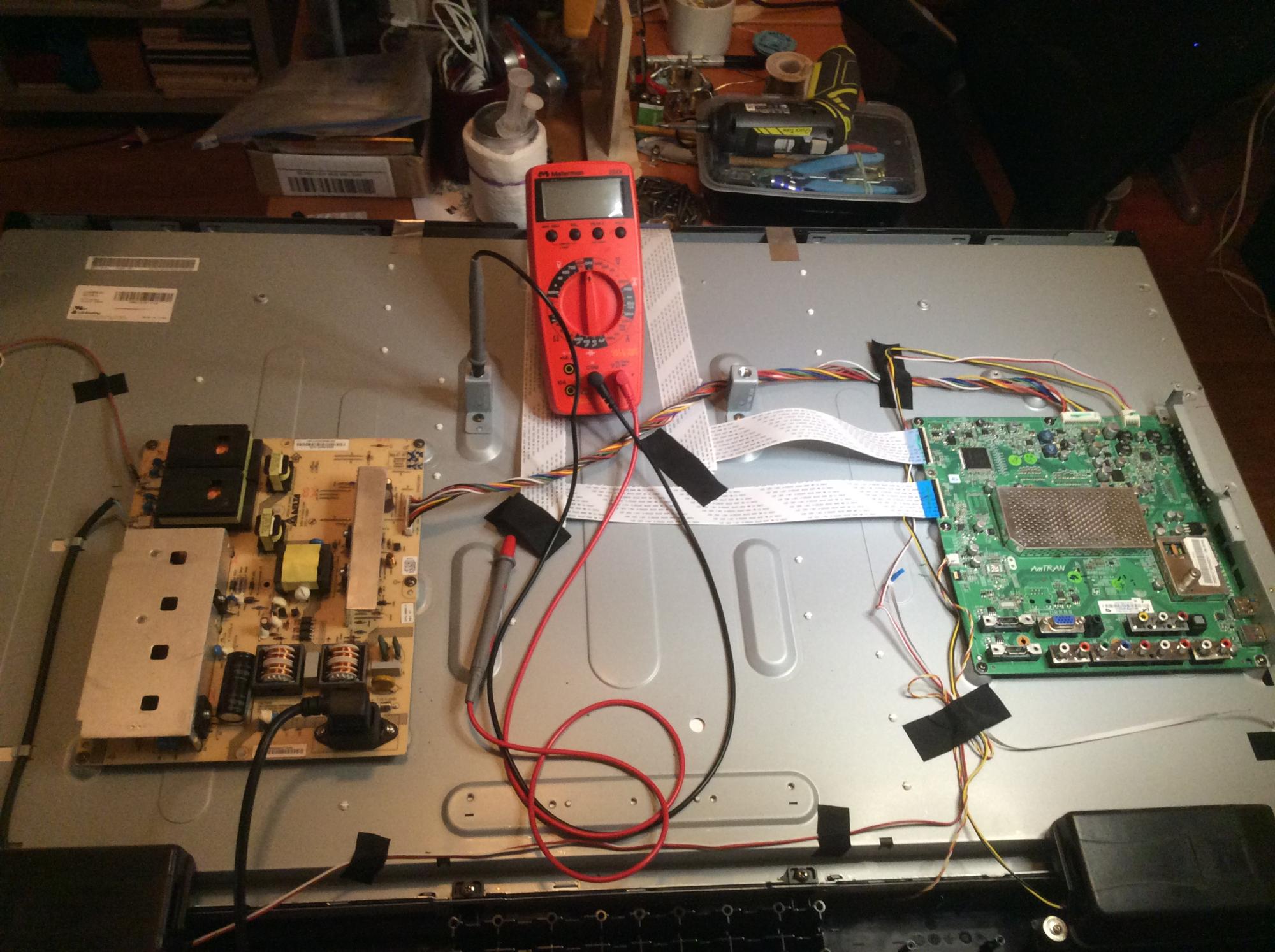

          It’s an LED E series E420 VL
          Have 5v SB, 12vdc. No 24vdc. No switched PSon 5v.
          Going to take photos and post. Fron Visio light is amber and not changing to white, confirming no PSON 5v. So no PSON SIGNAL FROM system. Have not connected a load to PS check 12vdc but do not believe I have a 24v rail to test. Would love a schematic to do further troubleshooting but happy to have your valuable input and assistance.
          I have reviewed the excellent document you authored as a basis for proving the above.

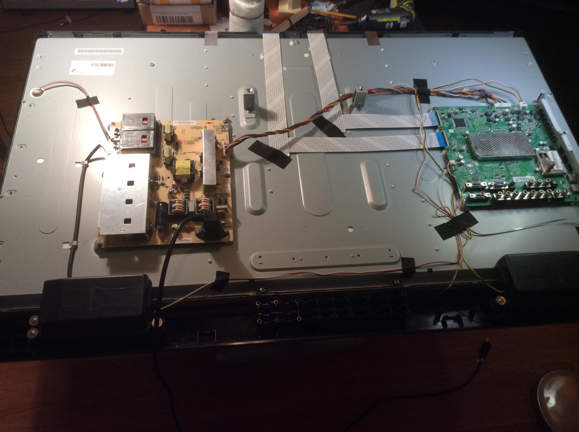

              [PHP[/PHP]
              Please advise if these photos contain sufficient detail for assistance.

                Originally posted by jetadm123
                I believe the E420VL uses ccfl backlighting and not LED. You might want to provide some good photos of the boards and how they're all connected.
                Just uploaded please advise regarding detail.

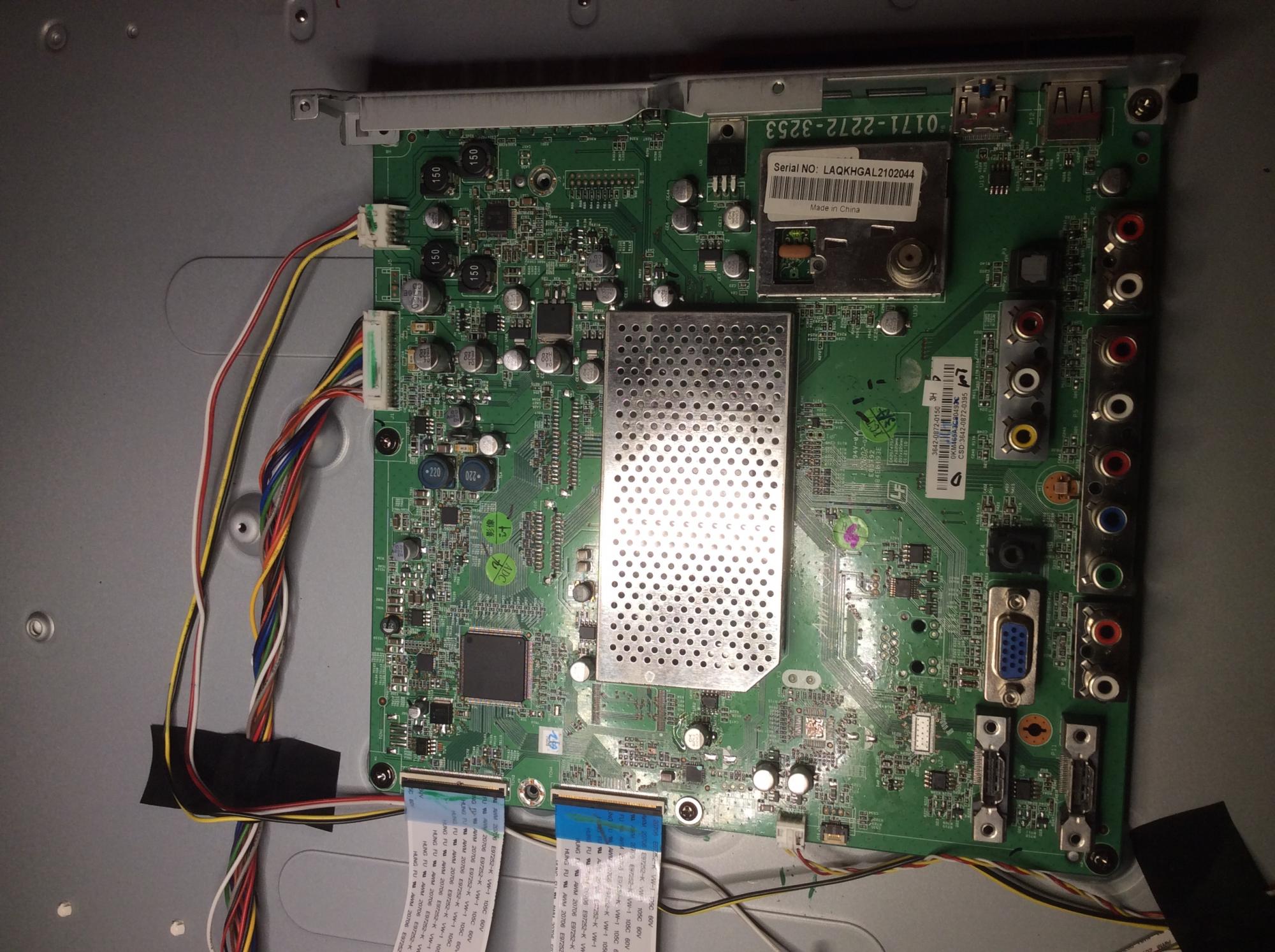

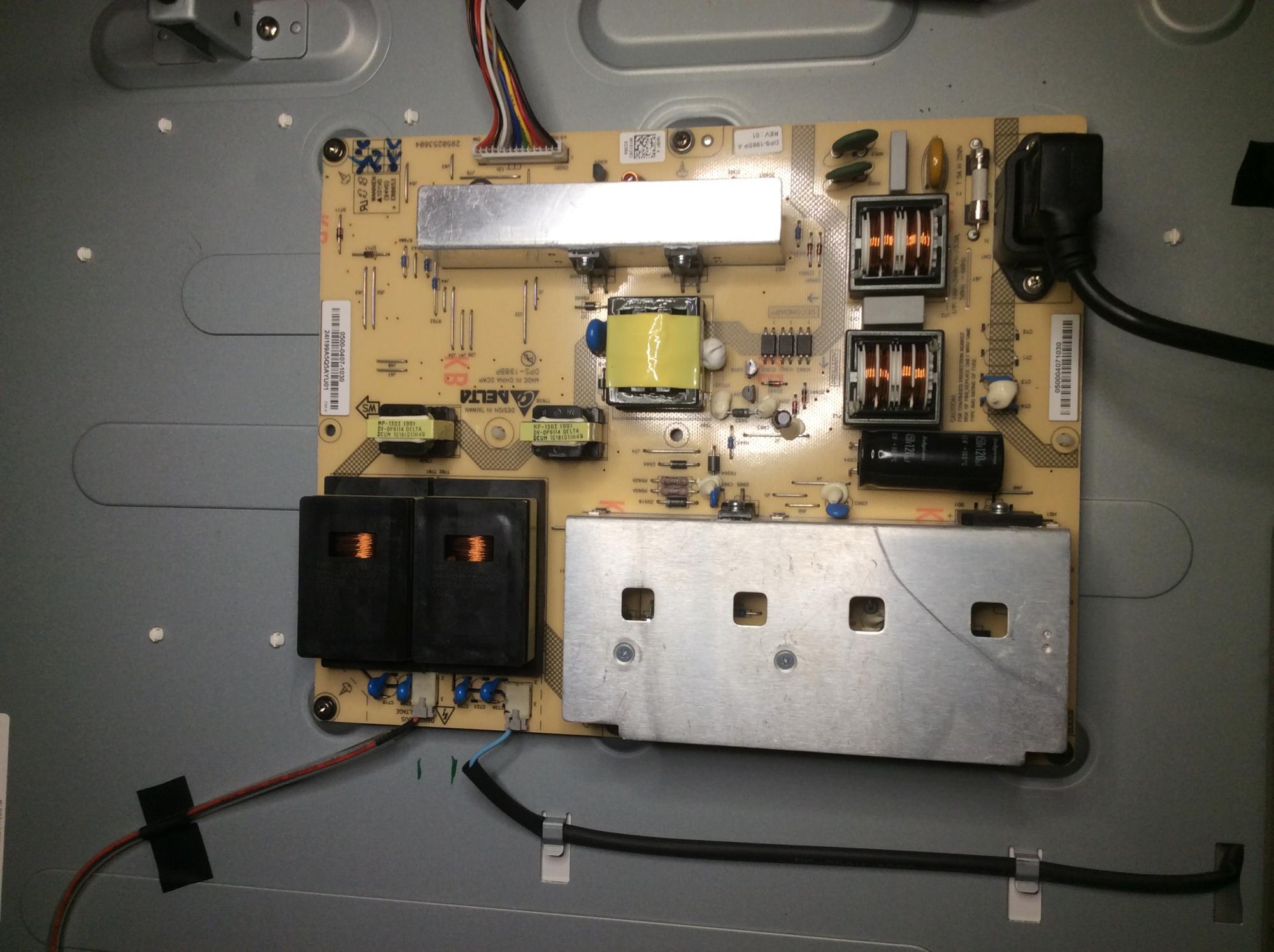

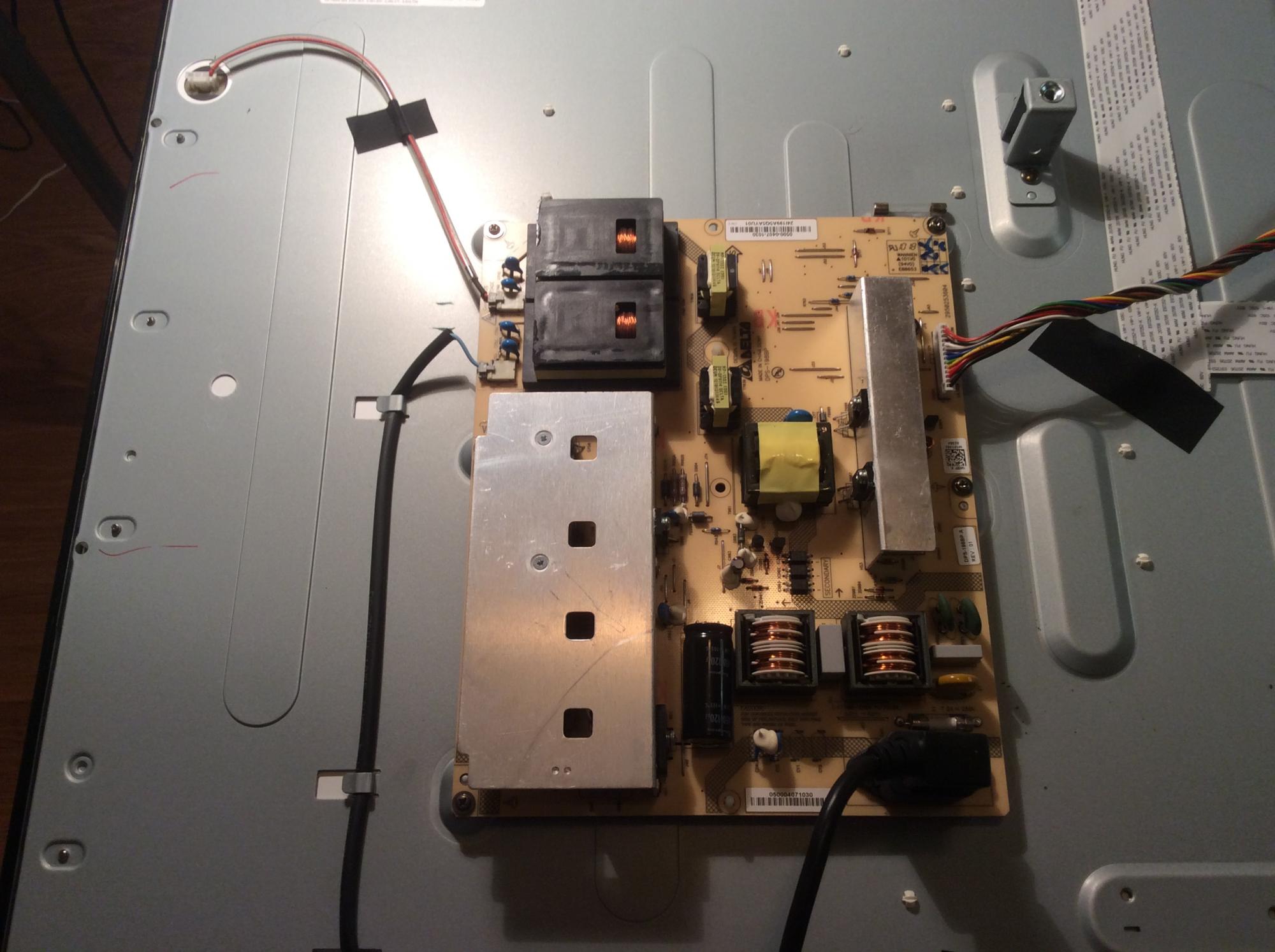

                      Re: Need schematic for Visio LC420
                      You have power supply/inverter board combo for CCFL backlights.
                      The connector on the power supply that goes to the main board has lable for each pin, can you please provide the DC V readings for each one of those pin.
                      You also have to fuses on the main board close to the connector that goes back to the power supply board, please check the DC V at both ends of the fuse with ref. to the chassis GND, one should show 5V and another one is for switched 12V.
                      You also have some LDO Voltage regulator IC's on the main board that you should check.
                              Did you look at shopjimmy to see if they have EEPROM for this model?
                              Burn,
                              Per the above attaching picture of power board connector to system board.
                              Pin 1 3vdc
                              Pin 4 1.6vdc
                              Pins5-7 12.2vdc
                              Pins 8-11 0vdc
                              Pins 12-15 5.2vdc
                              160μf cap on power board 325vdc
                              All fuses on system and power board good.
                              Removed HDMI chip since customer reported no working HDMI ports before set set died, thinking possibility the IC MIGHT BE SHORTED.
                              Please let me know if I have provided you sufficient information to continue your assistance

                                  It's that BUT more over it's a good close up pic. of the board, these are what you need to post, front and back.
                                    One of the pictures I attempted to post shows the power board to system board connection and labeling of the connector. However since none of these will post for some reason. Beginning with Pin one, the pins are labeled:
                                    5.1VSB PIN1-3 measured 5.2vd
                                    SGND PINS 4-7 measured 0vdc
                                    12V PINS 8-11 measured 12vdc
                                    PSON PIN 12 measured 1.17 vdc
                                    I-ON/OFF PIN 13 measured 0vdc
                                    LAMP PIN 14 measured 0vdc
                                    DIM PIN 15 measured 0vdc
                                    PLEASE DISREGARD THE EARLIER VOLTAGE READINGS POSTED, very sorry for being so sloppy in my reporting. I am still trying to figure out why no none of the pictures are being posted. Thanks so very much. My system board is not available at SJ.

                                      Now posting picture of power board connector to main board as a supplement to last post and previous from Budm.
                                      • jkb242
                                        • Mar 2012
                                        • 175
                                        Detailed views of power and system boards and inter connection. Please advise if additional informational information is required. Working without a schematic is more difficult for me as I am not that familiar with this set and really appreciate the assistance I am receiving!
