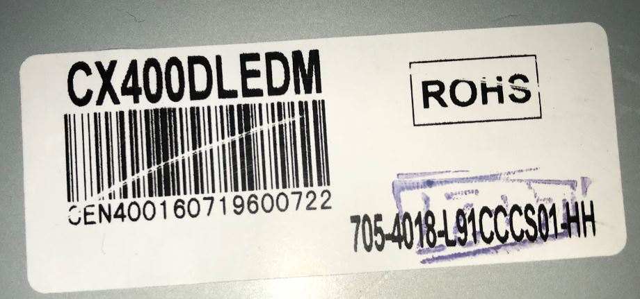

maybe whilst the chip is on the programmer freeze it then read it again and save it reload that onto a replacement ic if needed and re try tv you have nothing too loose, failing that maybe time too look for a main board for your set what lcd screen number is used in your tvComment
Re: ESTAR LEDTV40D2T2 Firmware
Freezing or heating of the chip makes no difference at all. The chip cannot be erased at all... Will look for the same chip from donors.
LCD screen number:Attached Filesif you find these attachements useful please consider making a small donation to the site
