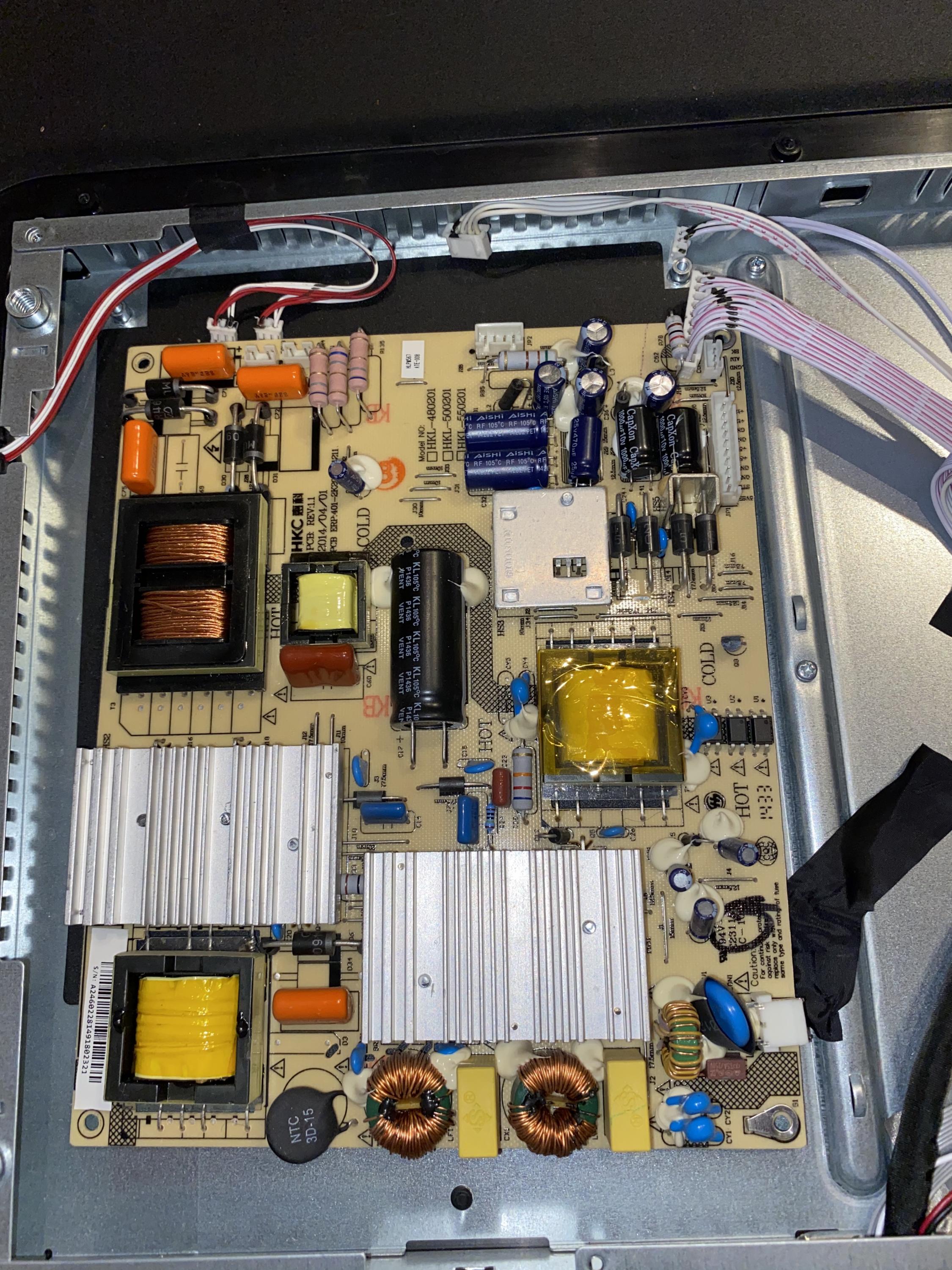

                  I have a Haier 50" LE50d3505b television that is "dead." No image, no standby lights, no sound, no nothing. The power supply board is HKL-500201A.
                  I have tested diodes 10/11 using the "diode setting" on my multi-meter. I got .000 readings for both. For diodes 13/14, I got .177 for both readings.
                  Do you think diodes 10/11 are the issue and to replace them? If so....would these be the correct diodes to replace them with: https://www.ebay.com/itm/11376729897...QAAOSwDw9bLDvU
                  Thanks!

                    pic

                      Can confirm, D10 or D11. Had to take them both out of circuit to test though.
