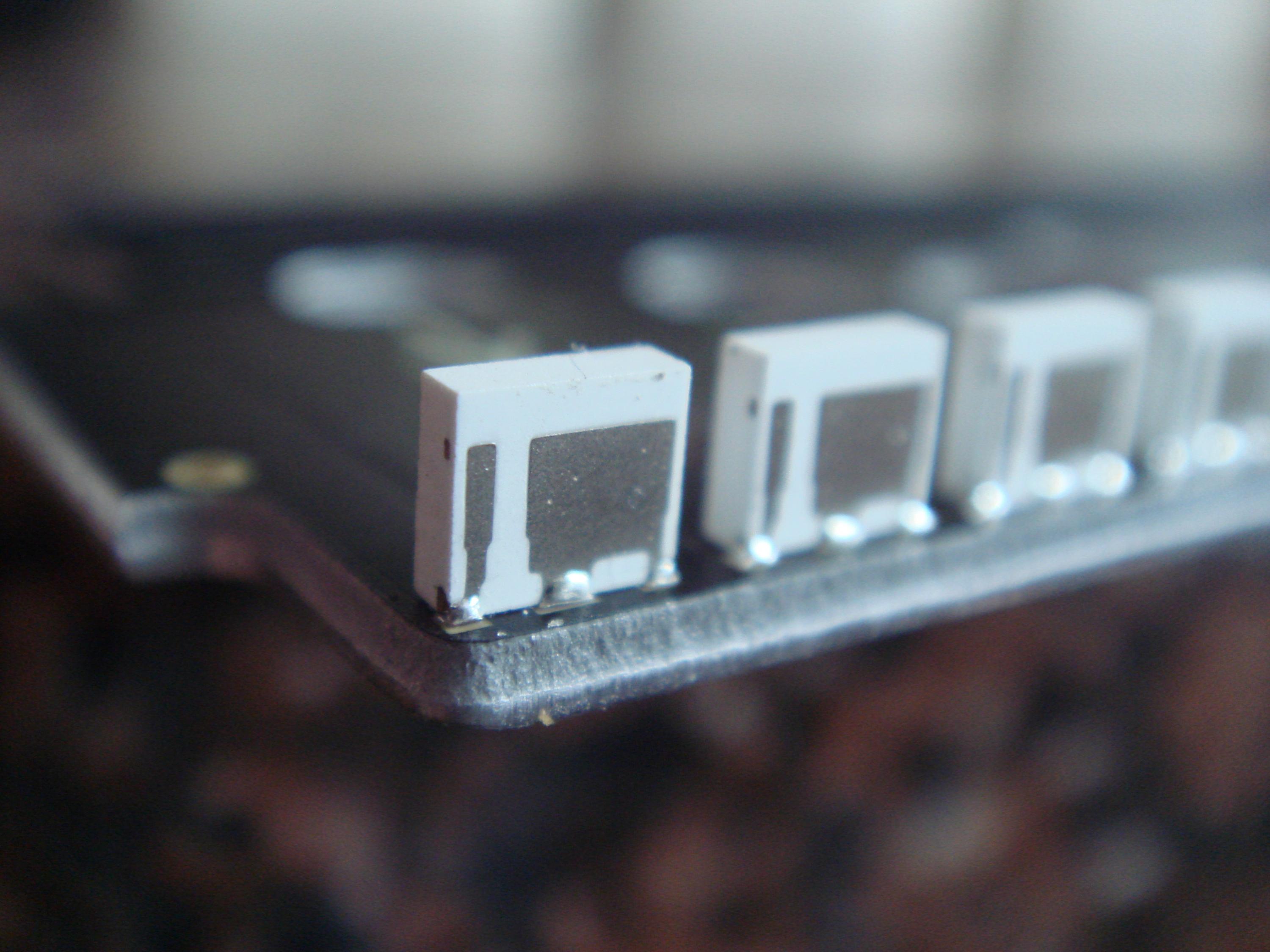

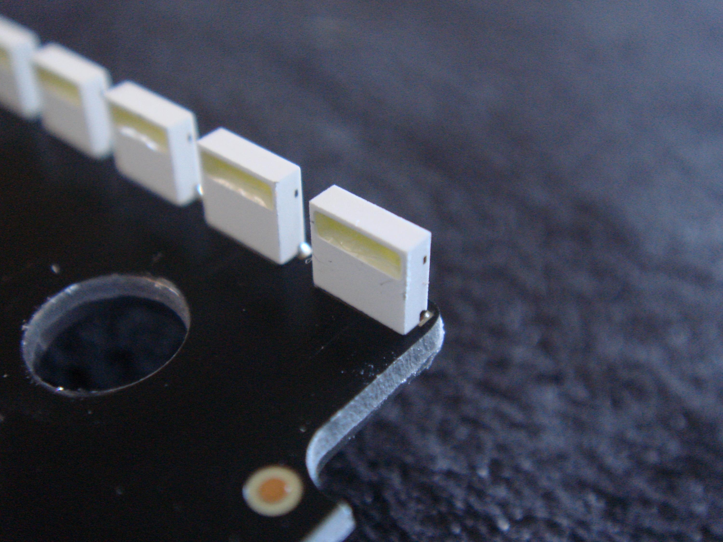

        Do your LEDs look like this ?
        Photo taken of an LED on a Sony strip I have here and also the replacement 5630 I was going to use if it was a failed LED.

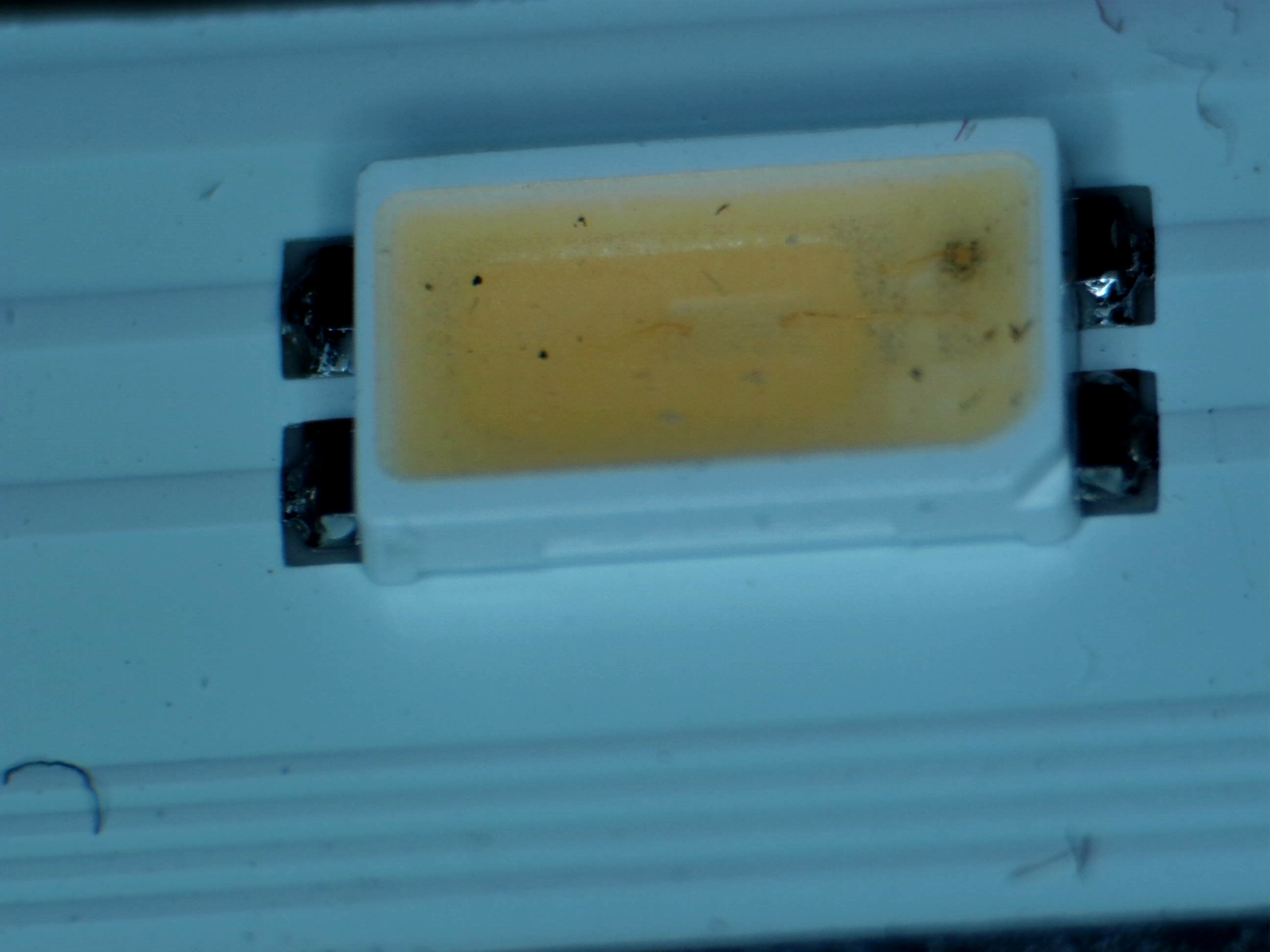

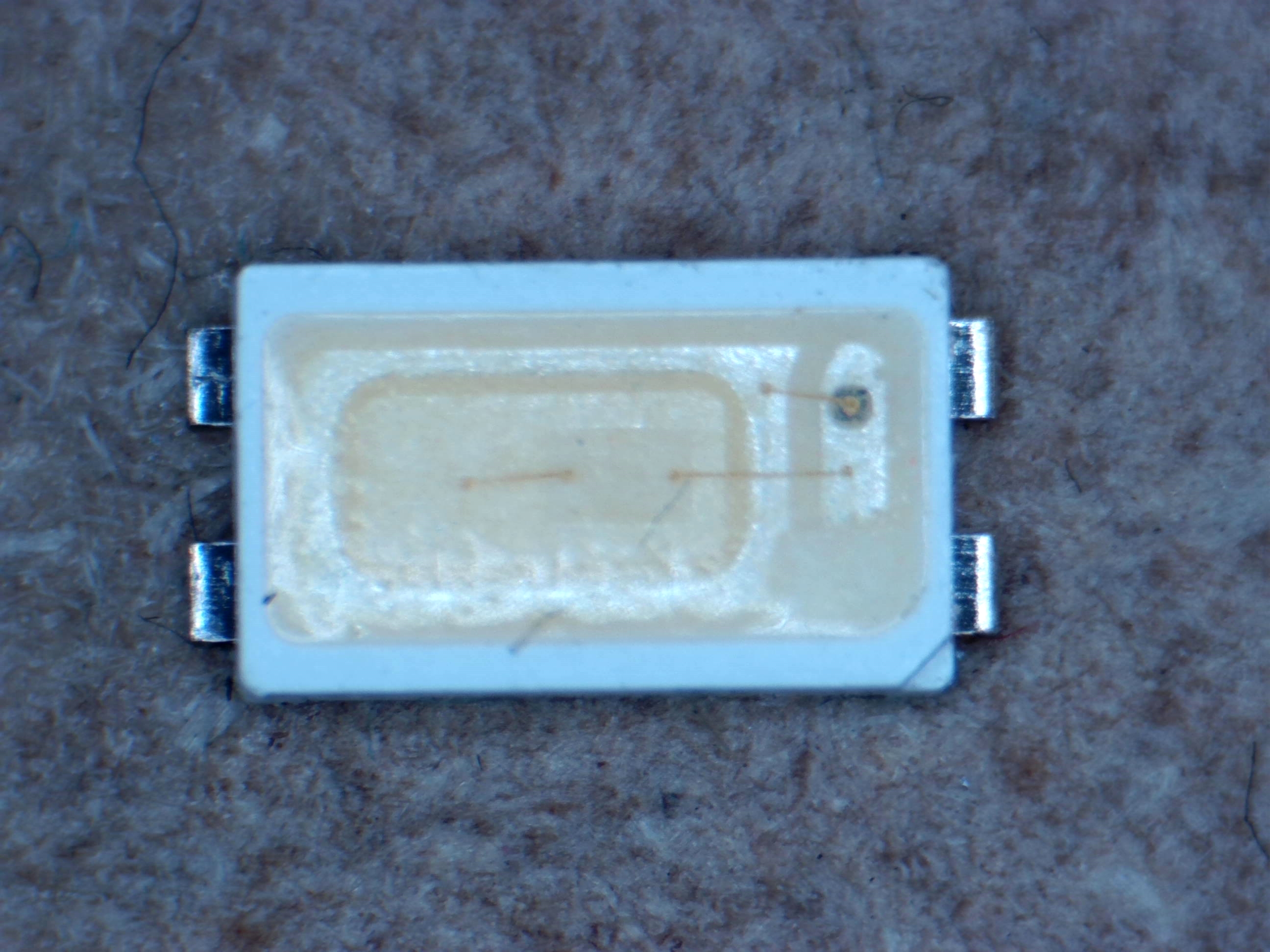

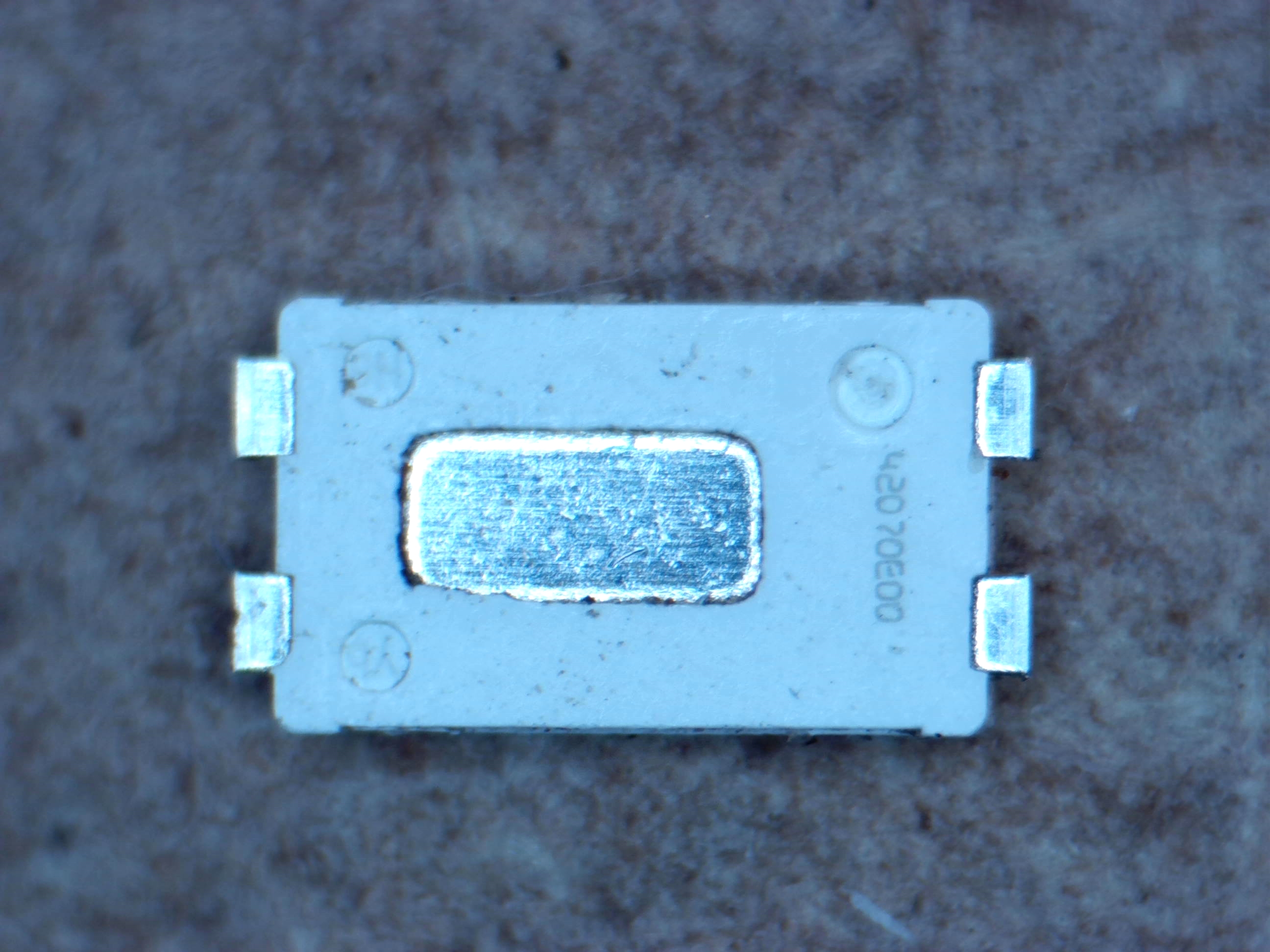

          Hi Diif,
          Unfortunately the images you have kindly posted are not similar to the one's on the led boards in this telly.
          I have (hopefully) attached two piccies of the offending components...
