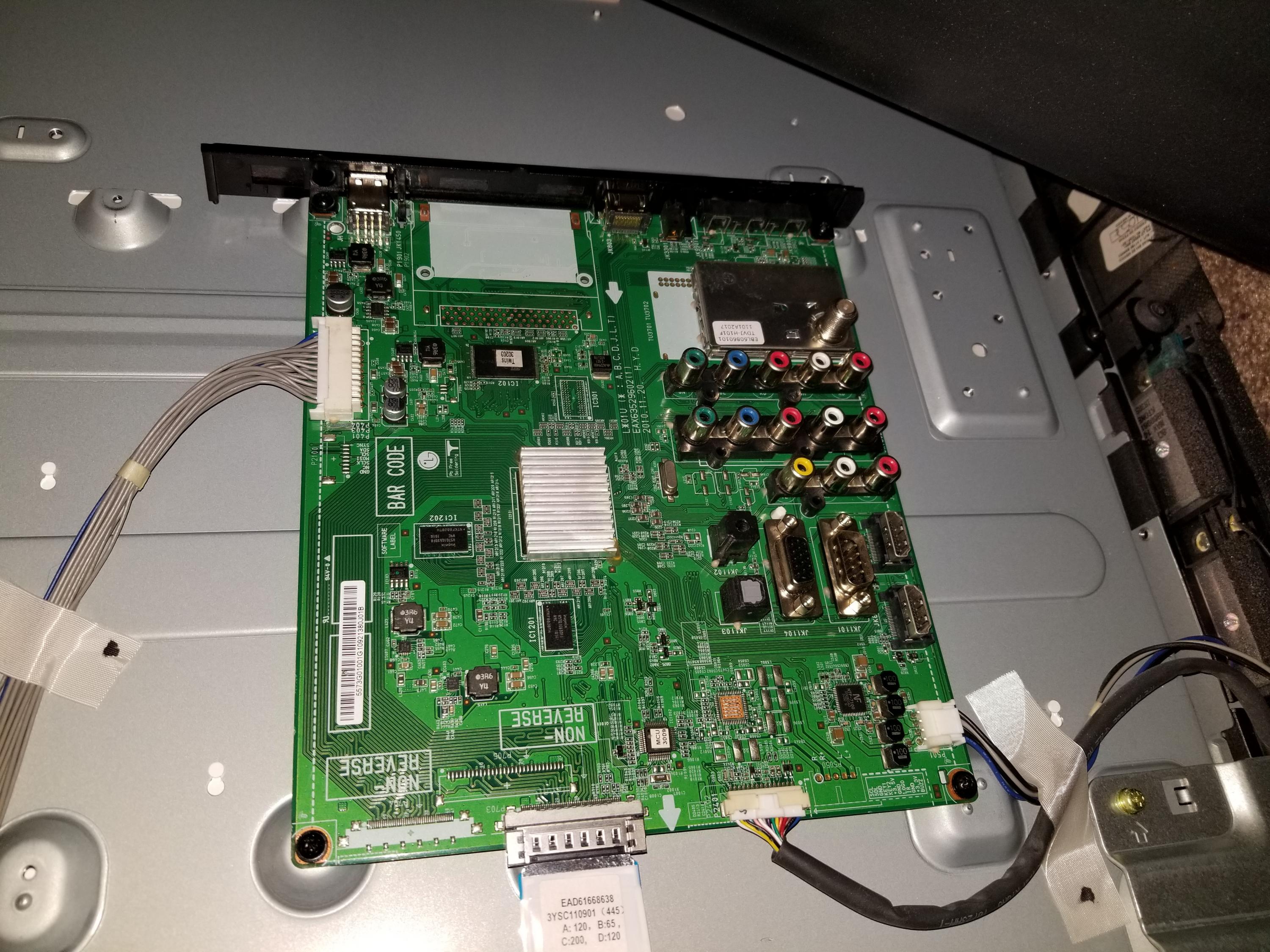

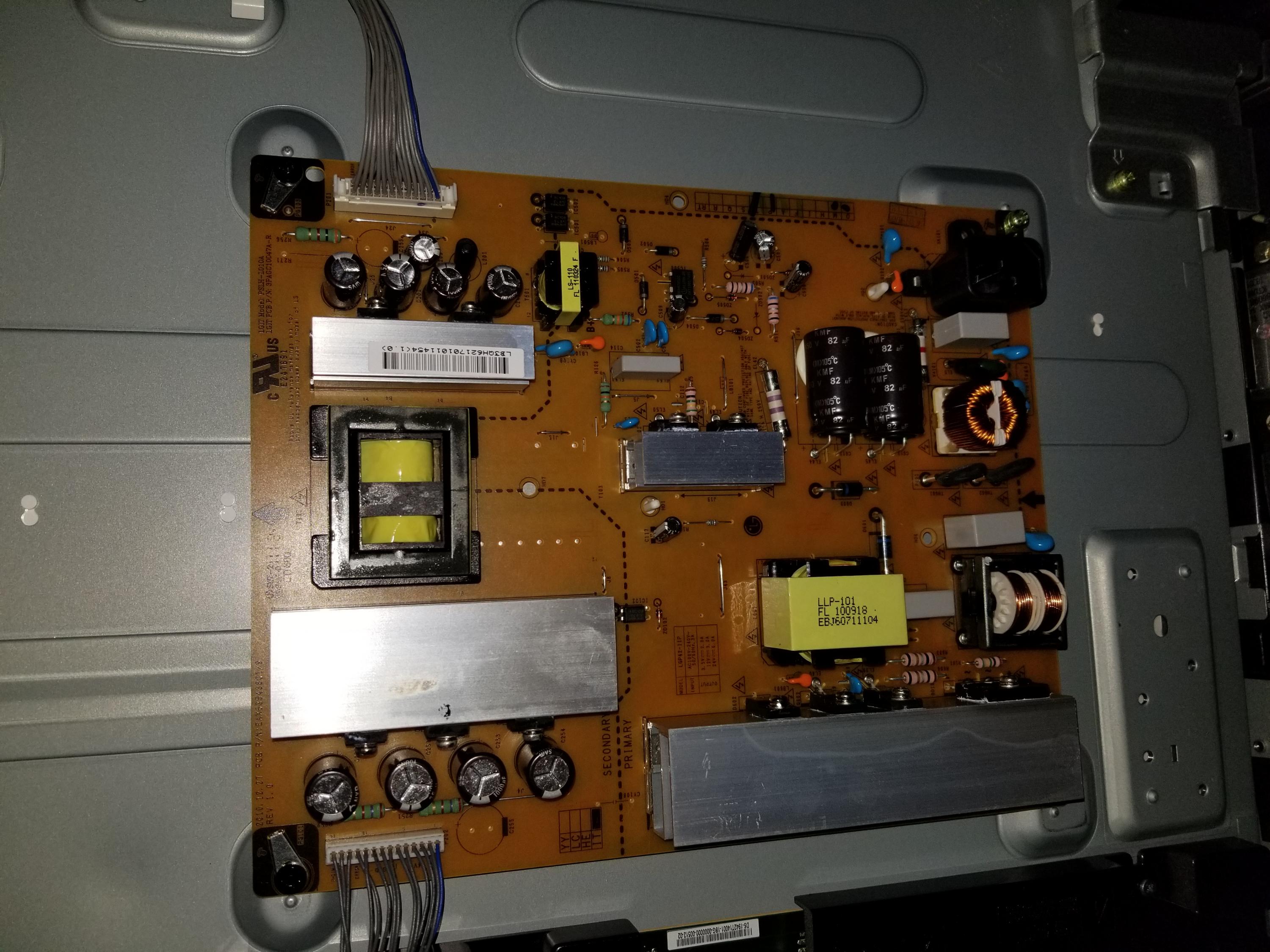

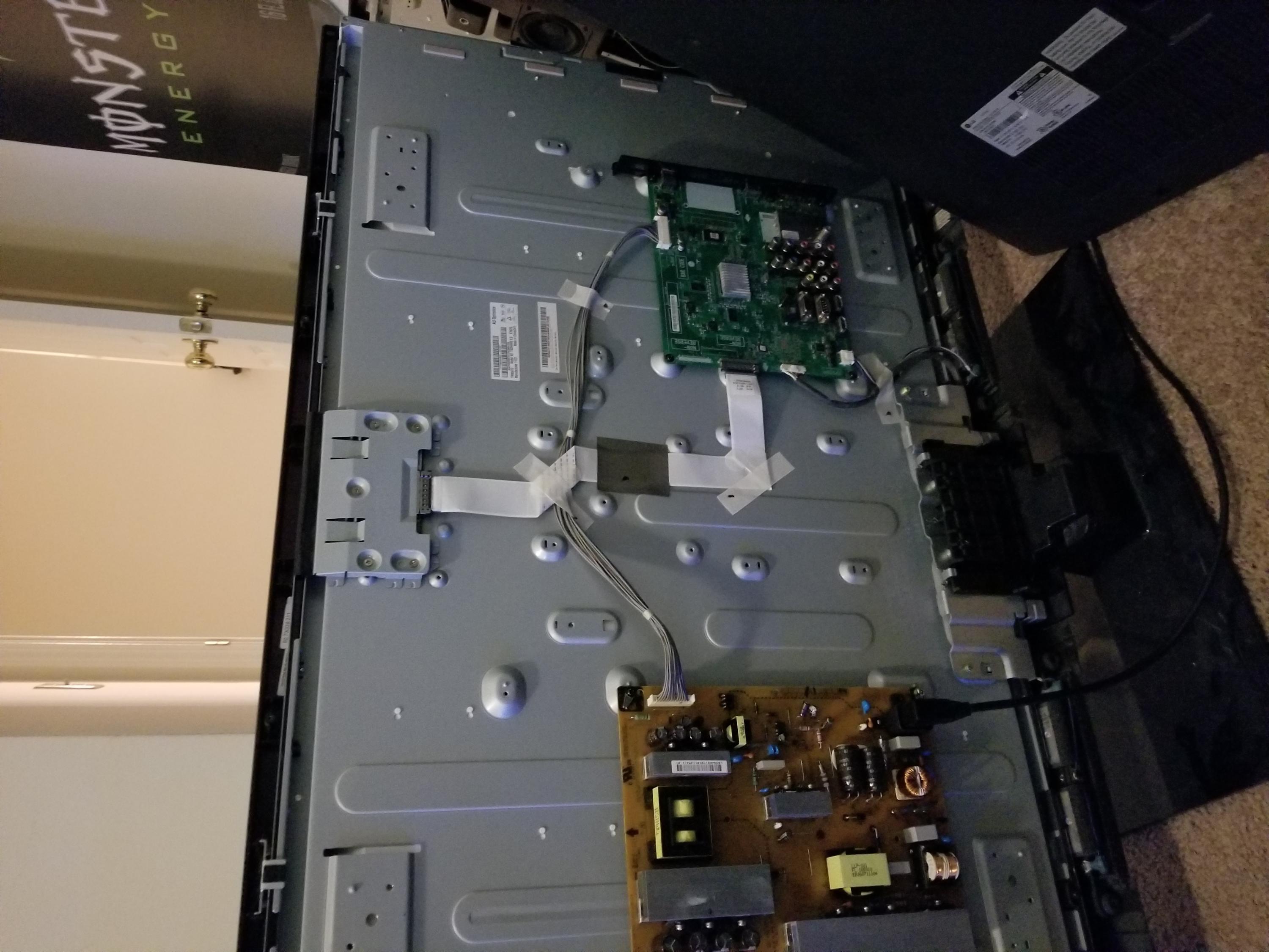

    How about the pictures of the whole back side of the TV showing all the boards?

        I guess my newer question would be, how does one check these pins? and i already have the requested pictures, as well as a picture of the pin voltages from the PSU.

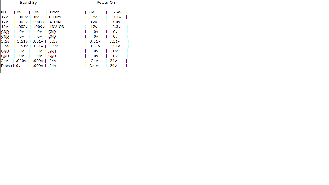

            Re: 42LK450-UB Noob question
            Alright got it all squared away. I test the pins in both stand by and in the on position. Being as the TV would only stay on for a few seconds really made this fun. So as in the pictures i posted the pins i was testing off the PSU, check out my picture to see my pins
            Any ideas what i should do with this now?
            Or, what else should i do? I like the previous idea of a bad main board (defect) because thats what i thought in the first place. But im sure if i try to return it as defective they will want proof.

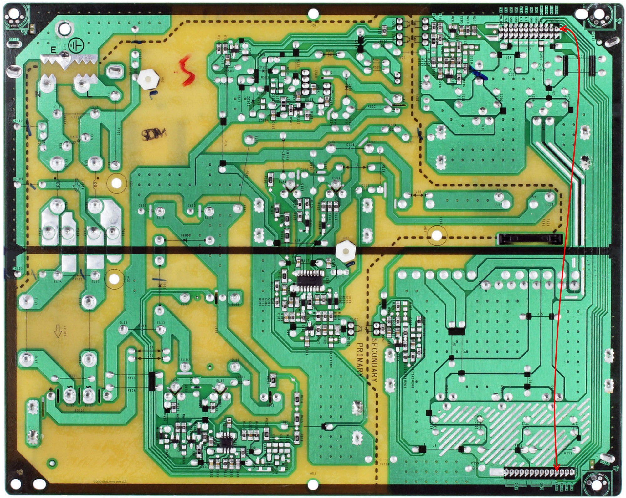

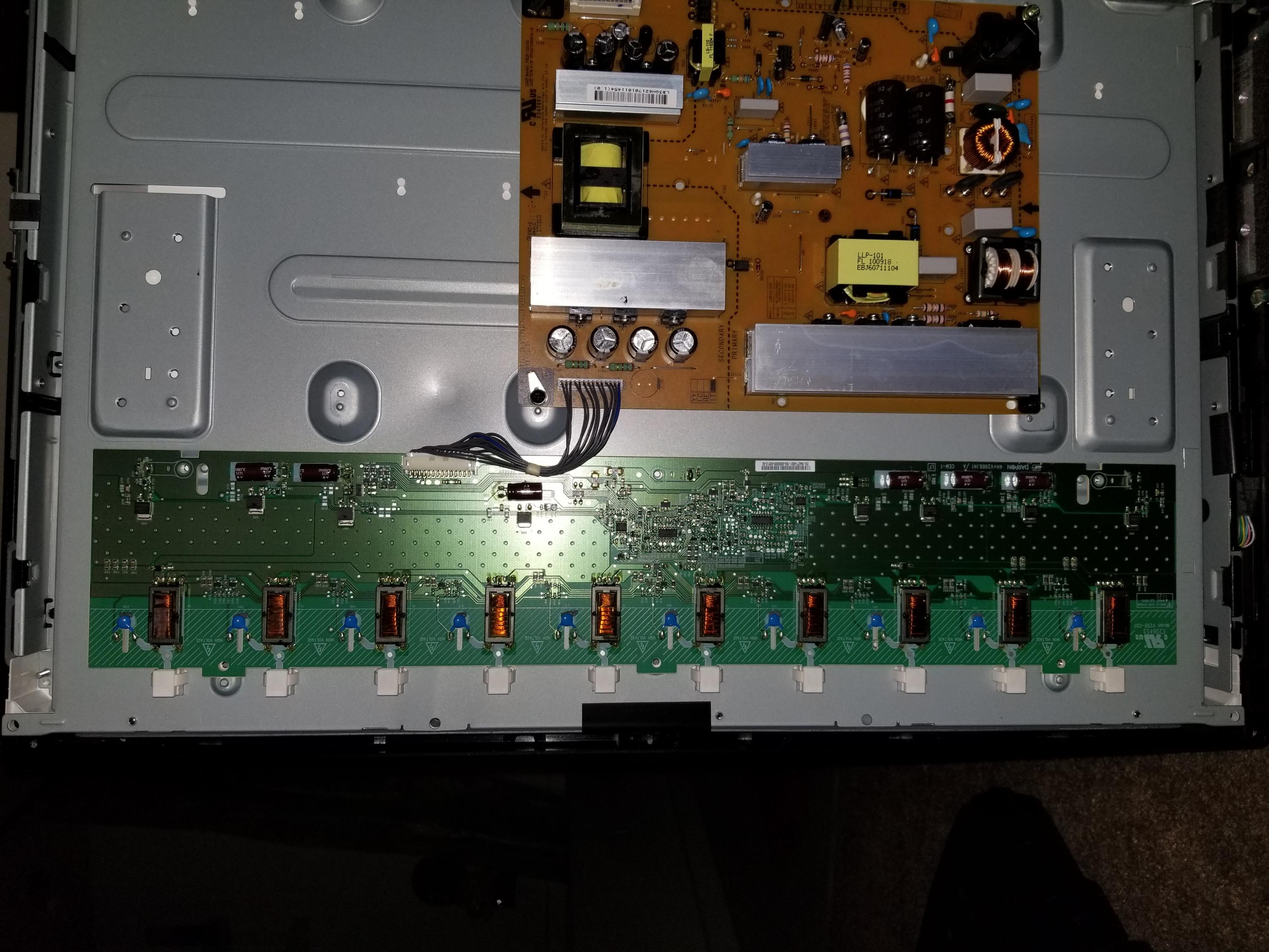

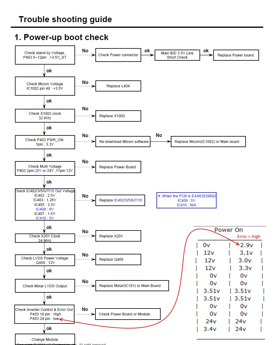

              The problem may be on your power board. See attached photo. It depends on the microcontroller code, but a LOW signal is usually below ~0.7V.

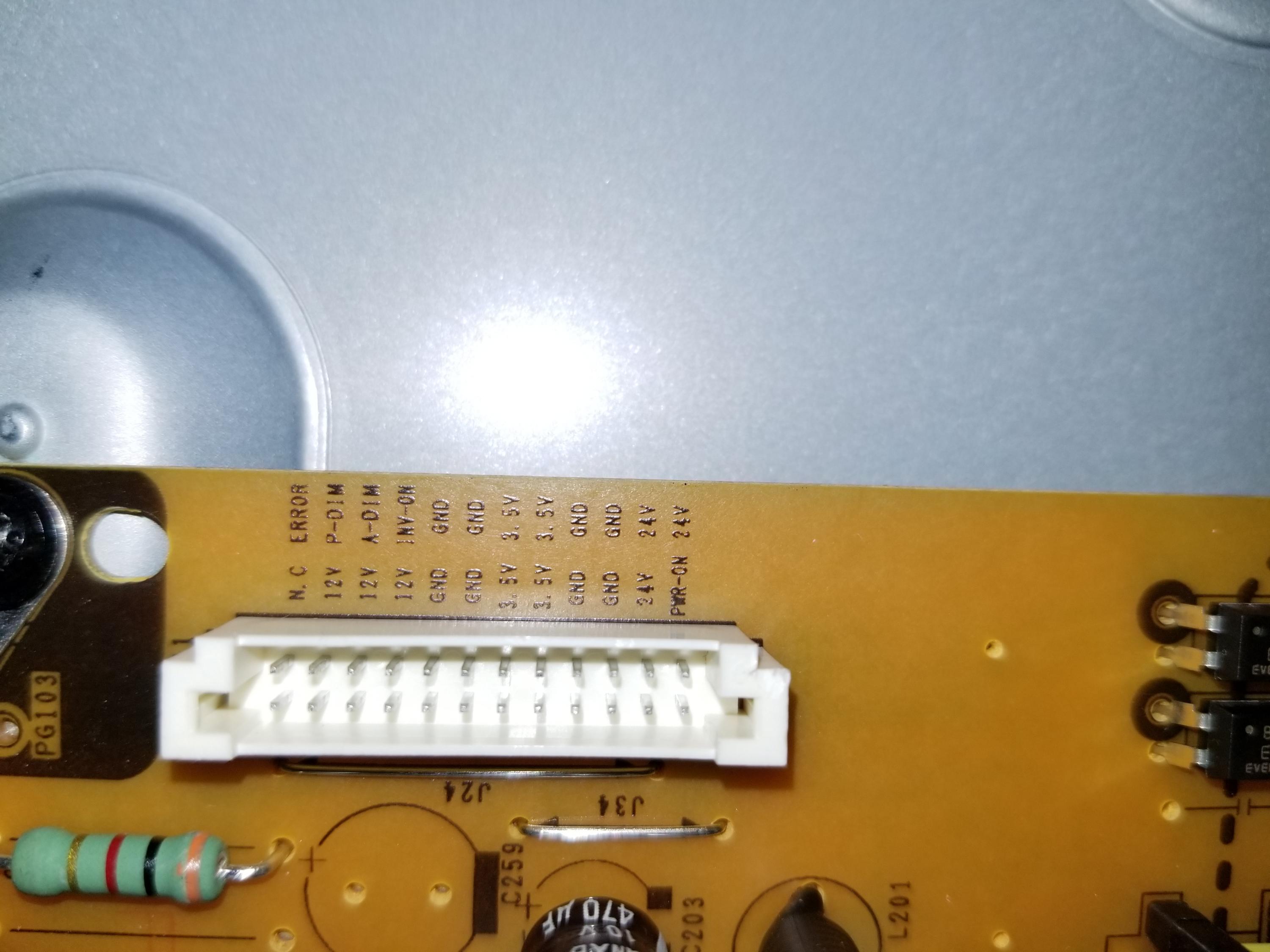

                        I have replaced this board as well, but being as that voltage is rather high, what can I do to narrow it down?

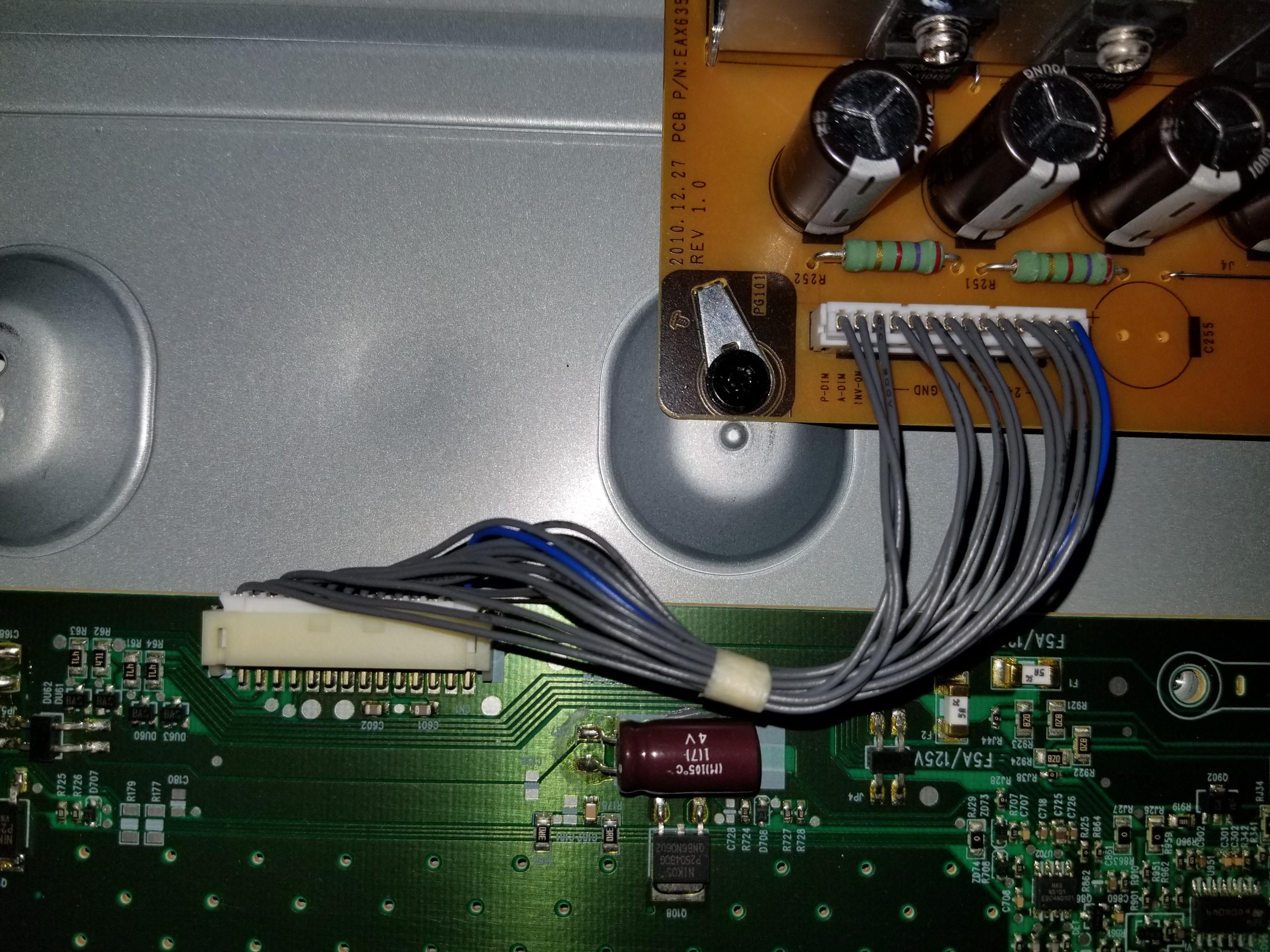

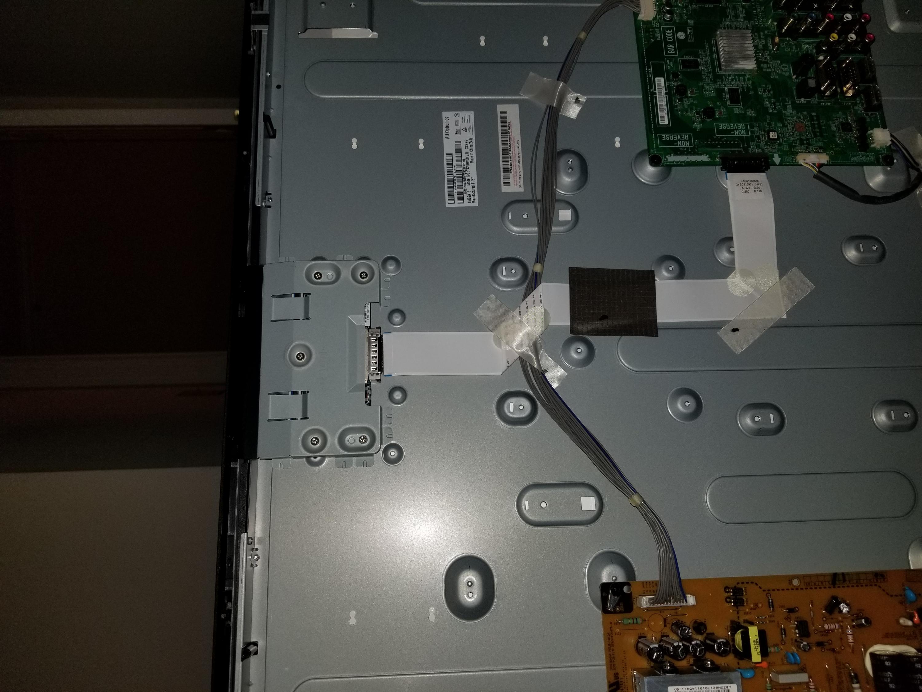

                          on your second picture where does that bottom wire connector go too?
                            Looking a little further, it's not the power board. The error signal just crosses the board. As vinceroger69 mentioned above, problem could be inverter/ccfl.
                              Backlight inverter board
                                  can you upload a picture of that board so we can see whats fitted as you may be able too run some tests on it
