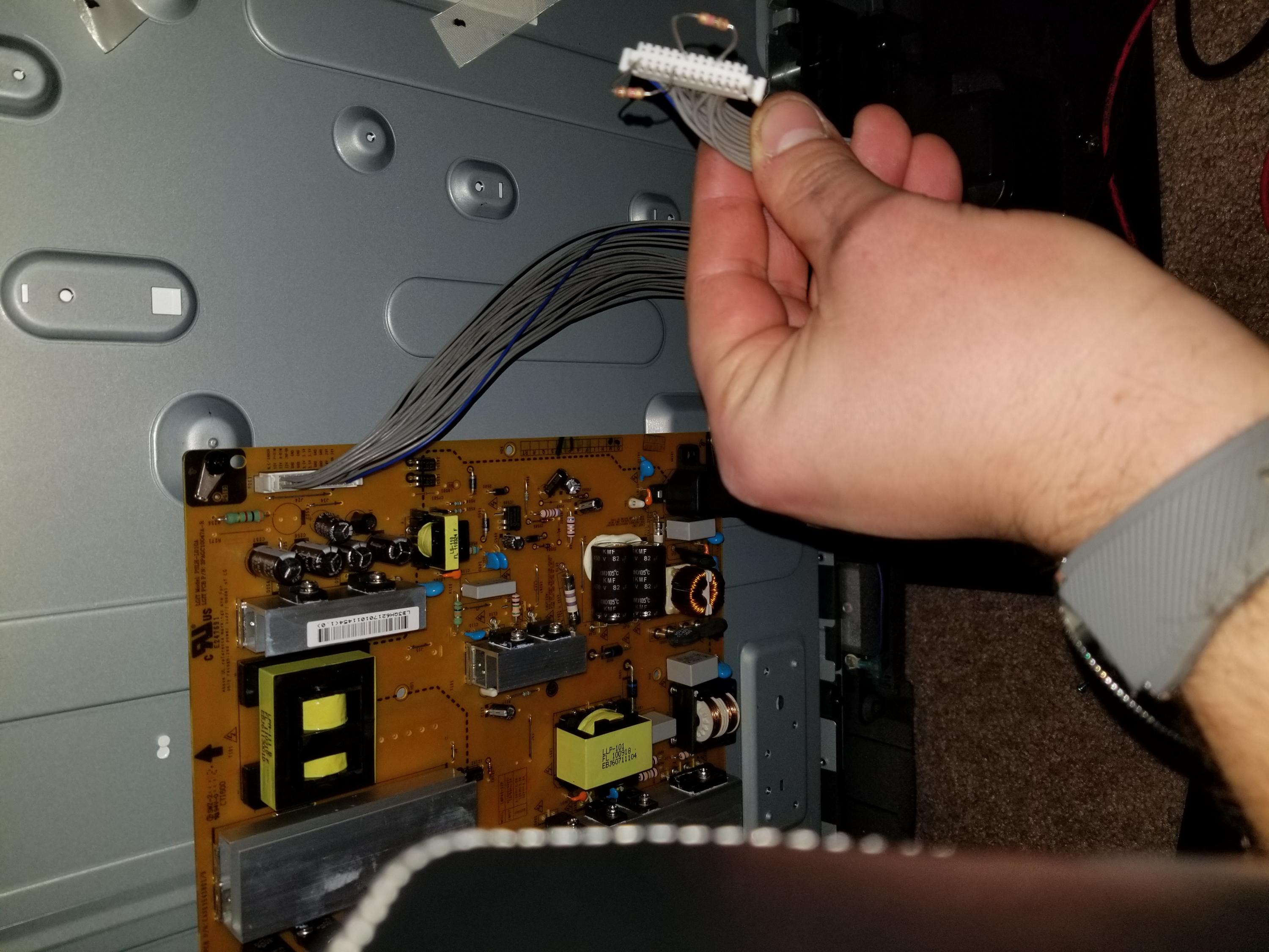

                        Re: 42LK450-UB Noob question
                        If the backlights stay on then it means the power supply board, inverter board, and lamps are good.
                        You must do the test WITHOUT the main board connected, the backlights should come on right away when you plug the power cord into the AC outlet and stay on as long as the power cord is plugged in.

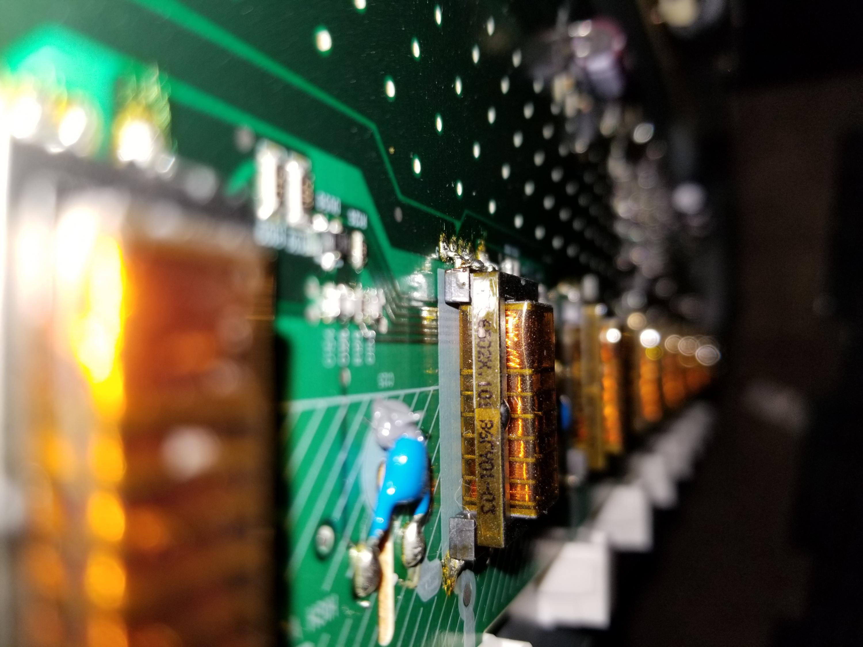

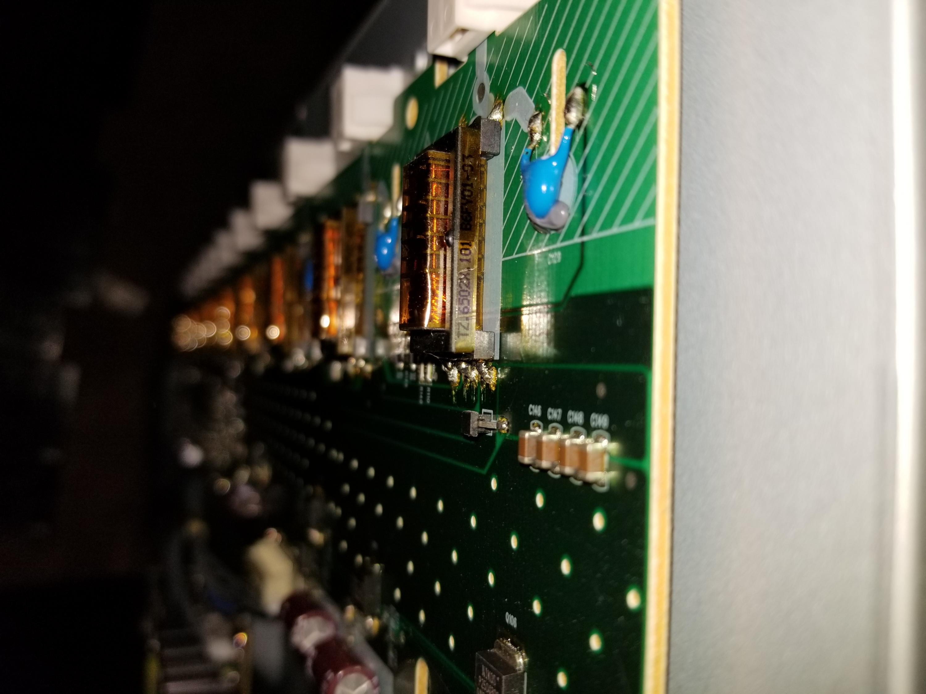

                          Ok, sorry for the delay. I have no electronic hobby stores near me at all so i had to get resistors shipped in........
                          So i jumped the pins on the opposite end of the connector from the power supply (just unhooked it from the main board and added resistors where needed, while not having the main board attached to anything)
                          The screen will come on for about 2 seconds then turn off again never to come on again until i pull power away and give it back (toggle the surge protector)
                          So if what im reading is correct, I have myself a bad inverter board? ill send a pic of the jump so you see what i did, to make sure its correct.
                            You've got a 50-50 chance that it is the inverter board, and not a bad lamp. Do you want to go ahead and order a new board, or keep troubleshooting the shutdown?
