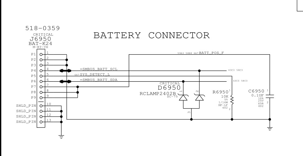

                SMBUS_SMC_BSA_SCL and SMBUS_SMC_BSA_SDA
                measured in diode mode, 223 both
                thanks for your help

                  1) What chip was soldered in @ U7000 ? It has to be the ISL6259.
                  2) Desolder D6950 and remove all power (no adapter / no battery) and check the diode readings again on the battery SMBUS_SMC_BSA_SCL and SMBUS_SMC_BSA_SDA lines.
                  Post the results.

                            desoldered D6950
                            SMBUS_SMC_BSA_SCL and SMBUS_SMC_BSA_SDA 223 measured in diode mode, 223 both as when d6950 is soldered

                              but the q7030 123--4 10 Ohm is normal?
                              Sounds low to me. Desolder it and check the resistance again on this mosfet when it is out of circuit.
                              Source - drain ?
                              Source - gate ?
                              gate - drain ?
                              Likely it needs to be replaced.
                              The diode values may be ok on the I2C lines but internet (Louis' forum) - states it should be about 0.4 - 0.45. For now, do not worry about these values.
                              The mosfet @ Q7030 is of concern.

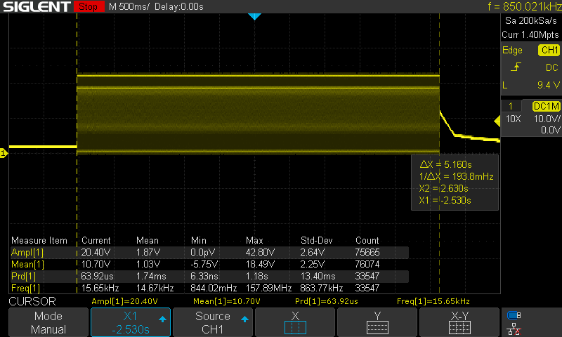

                                  Hi! I have the same exact problem than you!
                                  Low resistance between Ugate and phase of U7000. (Like 4 to 10 ohms)
                                  Also "Looping" every 5 seconds in PPBUS_G3H with charger only.
                                  With battery works fine. Already replaced Q7030 and U7000 with brand new chips. Same problem
                                  This is PPBUS_G3H readings.
                                  I'm suspecting SMC but I want to discard everything before changing it.
