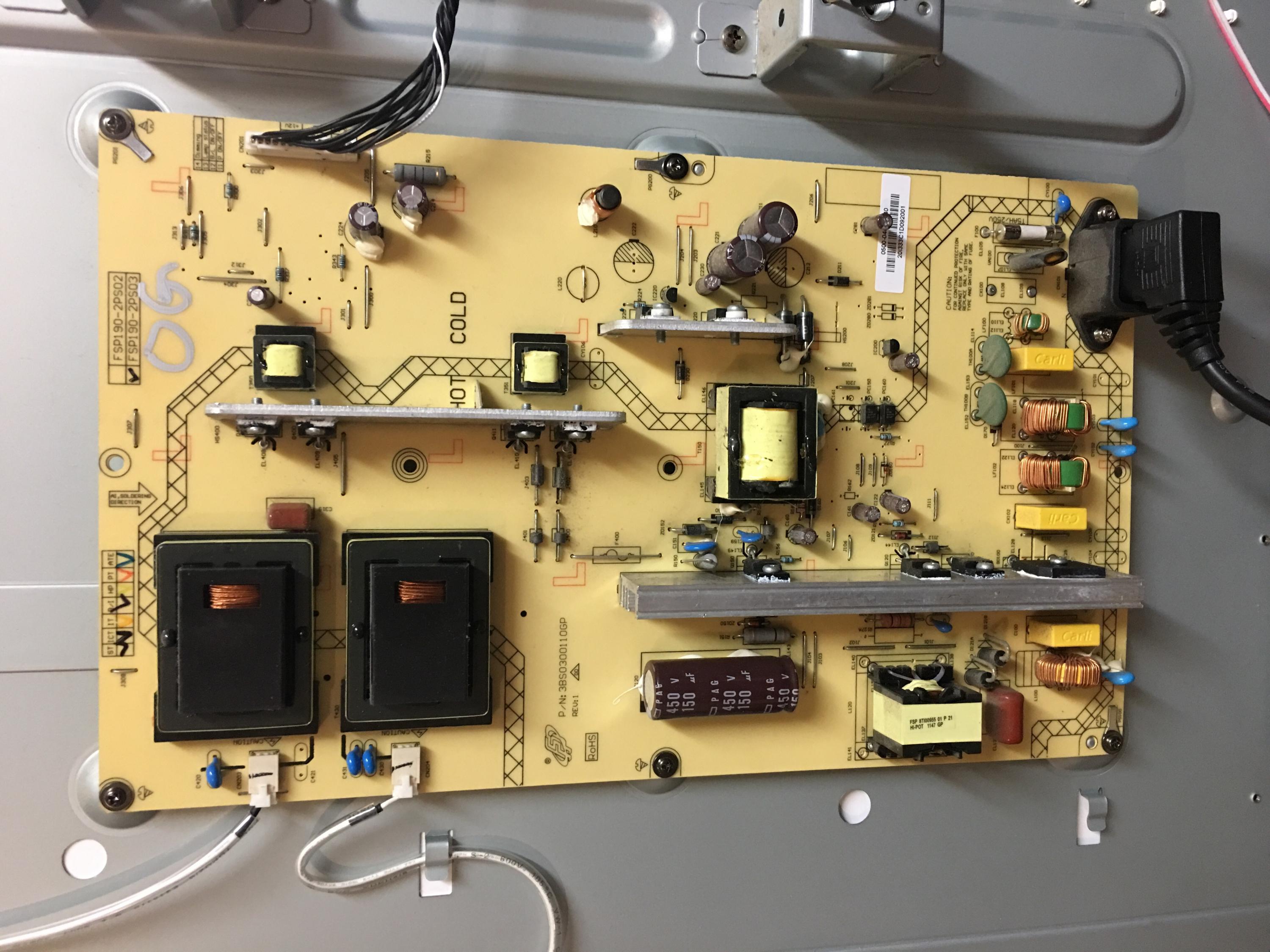

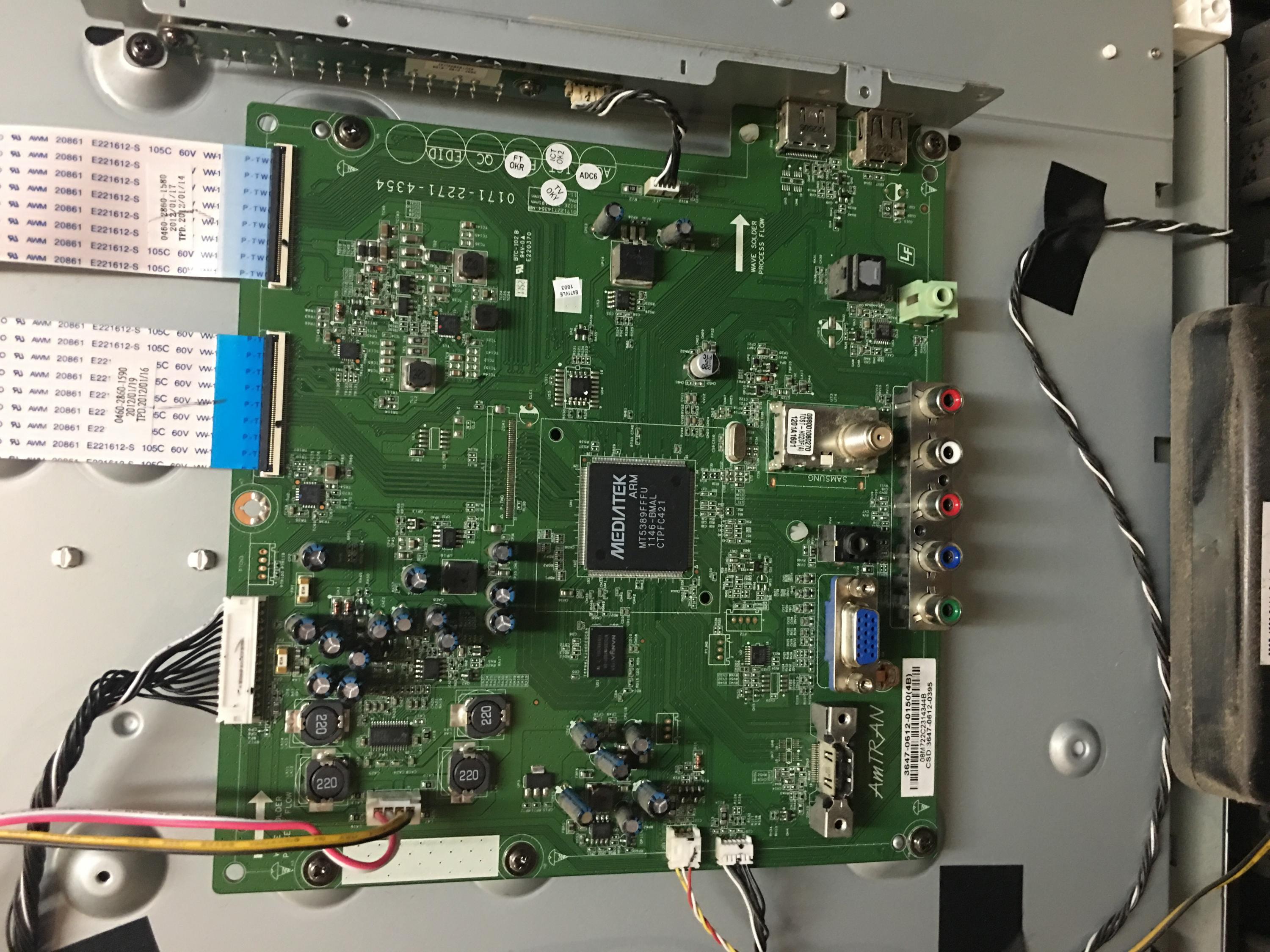

              Sorry for bringing up and old thread I have the same set with exact same issue as the OP. I have 5.2 v on 1-3 @ cn201, the rest of the pins nothing. Fuses test good and 60 volts on both sides of f100, cx101 & cx102. Purchased a replacement board from shopjimmy based on diagnosis followed here and exact same issue. So either I got a bad board having same issue or I would assume it is my main board that was the failure.
              I did the jumper test discussed above and all backlights come on.
              L220 has almost 16 volts(15.86 to be exact).
              Any further input on diagnosis?

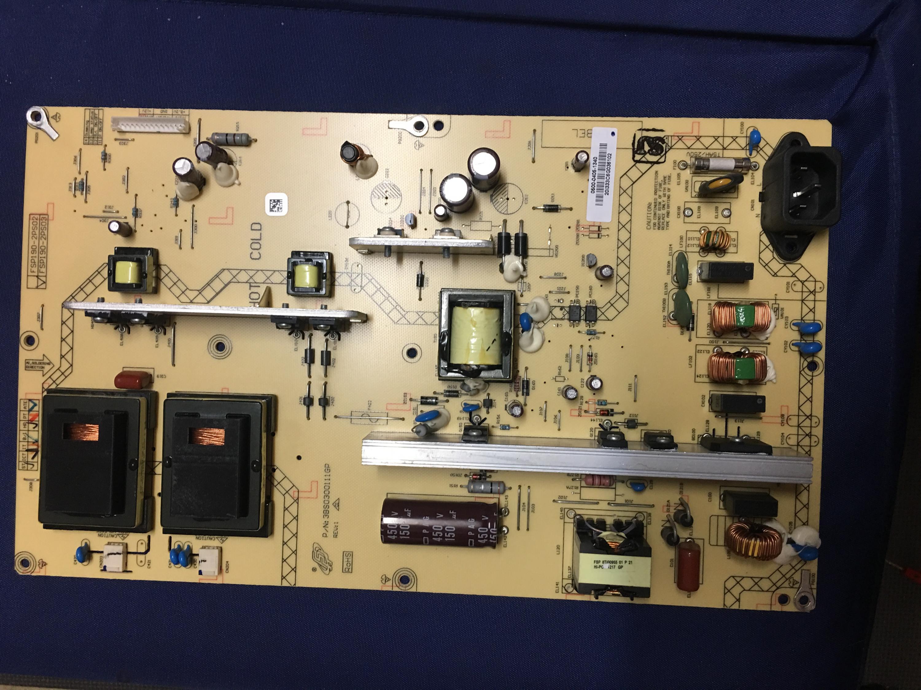

                Re: Vizio E471VLE No Power
                Another pic, power board

                  Shop jimmy replacement and exact p/n board.
                    I suspect you have a bad main, If you have +5.2v going to the main board, that should allow the main micro to operate, If it IS working properly, when you push the power button, the P ON/OFF line should change. L220 line could read high when it is not loaded, once the board is turned on, Q410 (switch) will turn on and supply the 12 volt line at 12 volts
                    I see two fuses (fp1/fp2) on the main board, check them.
                    It may be an eeprom problem on the main causing the micro not to operate

                      Fp2 has 0 volts at all times, fp1 has 5 volts at all times

                        F2 seems blown, simple way to check a fuse, put meter in diode mode, put a probe at each end of fuse, should beep if meter has beep function or read 000. Check both fuses and any other fuses you might see. Fuses if labeled will start with a Fxxx, sometimes they may not look like a typical fuse you might expect to see.

                          You are not going to have switched 12V on that FP2 fuse, that switched 12V will be present when Main board sends PS-ON (P_ON/OFF) to turn on the switched 12V on the power supply board.

                                Well replaced the eeprom with no luck. Eeprom came from shopjimmy.com. I now have no voltage on 1-12 on the power board.
