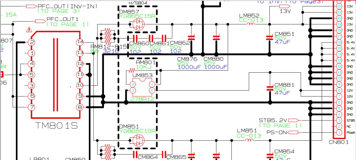

    hello. i have the famous samsung clicking on/off problem. no bulging capacitors , no cold joints or any visible problem. i replaced all the capacitors on the cold side, i replaced the eeprom with new one but none of them solve the problem.
    im getting steady 5.2 standby volt but because of the clicking problem i could not measure the other voltages so i disconected the mainboard and i jumber the standby pin with ps_on pin . that trick turned on the psu and i managed to measure all the other lines voltages
    at line of 12v i was getting about 10.5v
    at line of 13v i was geting same.. 10.5v (seems strange to me)
    all other lines 5.4v and 5.2v(standby) was ok.

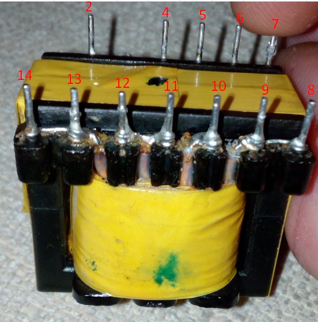

    After searching why i was getting low voltage i noticed that from the tranformer (TM801S) i was getting no volts from pin 10 and also was shorting with the ground pins. i desoldered the tranformed and checked again pin 10 and still shorting with the ground pins 8,9 .
    Anyone knows if this is normal ? i have attached photo of the transformer and a part of the schematic that shows the tranformer TM801S.
    thank you

    The transformer is fine, you are measuring the dc resistance of the wire in the transformer. What is the BN44- number of the power supply board
      Re: samsung LE40N87BDX - power supply tranformer
      The DC resistance of the transformer windings will be very low, they are normal for DCR to be low, you need ringer to test transformer, I doubt that it is bad. The 12V and the 13v are not regulated, and there is no feedback from those output to be used to regulate those two outputs, the circuit regulate by sensing the 5V output which is used by the main board to run the Logic circuits, the 12v/13V are for audio which is not critical so it doe not need tightly regulated supply. So did you verify that those filter caps for the 12V/13V do not have high ESR and still have correct capacitance.

        thank you for info and sorry for late reply.
        i thought that maybe was the transfomer but as per your information must be ok.
        Since the low voltage problem is difficult to find myself i though to gave up. So i soldered the transformer back to the psu so i can check that everything was the same as before desoldering the tranformer but when i pluged the cable to the tv.... BOOM..!! one resistor 0.3ohm (RM808) exploded. I replaced it but same again ..exploded. i checked the back side of the psu to see if anything else was burned (while the cable was on the psu) and i saw sparks from smd resistor (RM807).
        So again your help. can you check the attached schematic (page1) and suggest why the two resistors explode ? (RM808 & smd RM807) .

          I suspect, Qm801 will be shorted and UM801s could also be bad, I would also check the diodes and resistors in that section, like rm802, dm801,dm802,zm802 etc.
          Did fm802 fuse blow also?
