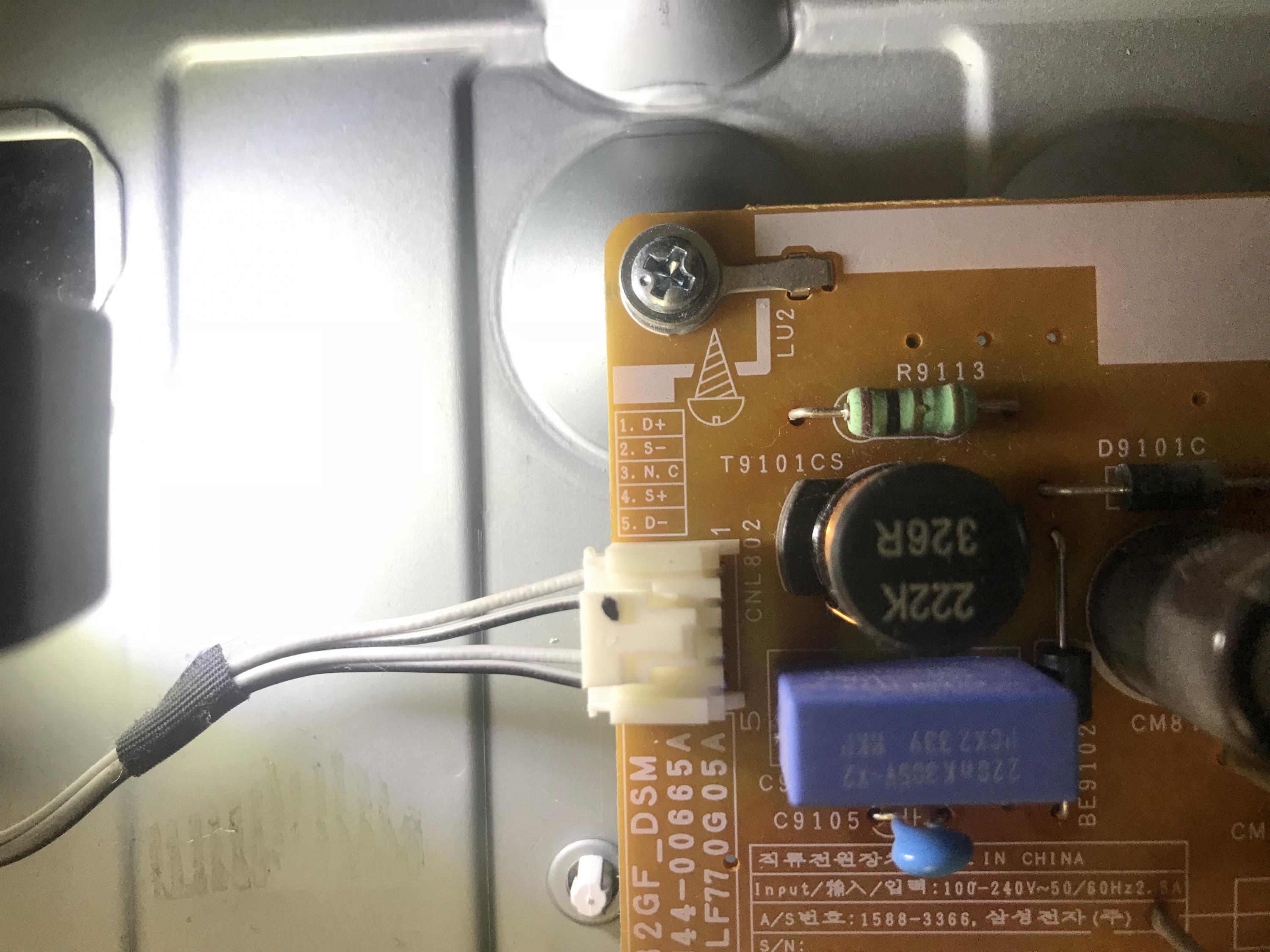

    Samsung un32eh5000f No backlight Can see picture with flashlight.
    I'm new to working on LED's fixed plenty of other stuff already.
    Powers going to LED
    CNL 802
    Pin 1 149.5 VDC
    Pin 2 128.2 VDC
    Pin 3 Not used
    Pin 4 128.2 VDC
    Pin 5 0.343 VDC
    What should I expect ?
    Any way to test the LED strips ?
    Thank You
    Chris
    Re: Samsung un32eh5000f No backlight.
    You have open LED sting that is connected between pin 4 and pin 5.
    Samsung BN44-00665A (L32GF_DSM) Power Supply / LED Board
      I was thinking open circuit with the readings.. Is there anyway to bench test them ?
      What voltage should I expect, I couldn't find a schematic or service manual for it...
        Right now you are getting 149.5V on pin 1 which is the Anode of the whole LED string, pin 5 is the Cathode return of the whole LED string.
        If you look at the Voltage chart as printed on the board, you will see LED Voltage of around 90V with load.
        You will have to open up the LCD panel assembly to get to the LED strips to test each one to see which one has open circuit. You will have to test each LED on the failed strip to find out which one/ones is/are bad.
        There are more than one version of the LCD panels used in this model, so you must verify what you have.
        http://www.shopjimmy.com/catalogsear...ng+un32eh5000f
        Fail LEDs are very common failure, when you get it fix make sure you turn down the backlights level.

              Thanks for the explanation on the voltages, I had the feeling it was the strips... Disassembly was a bit of a pain, thank god it wasn't a bigger panel... There might be firmware update to address the LED life issue, but I will turn them down....
