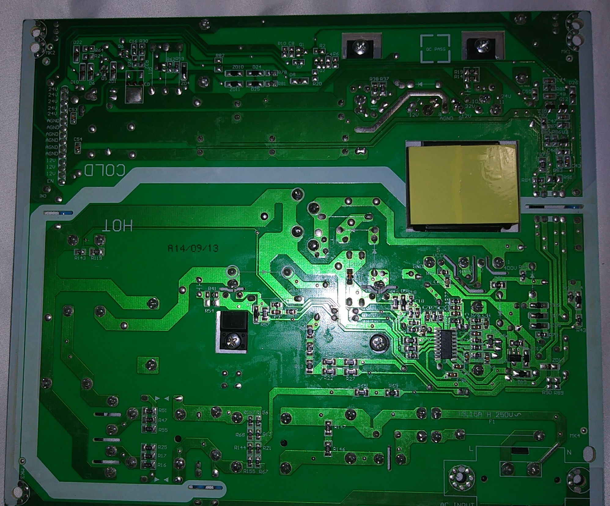

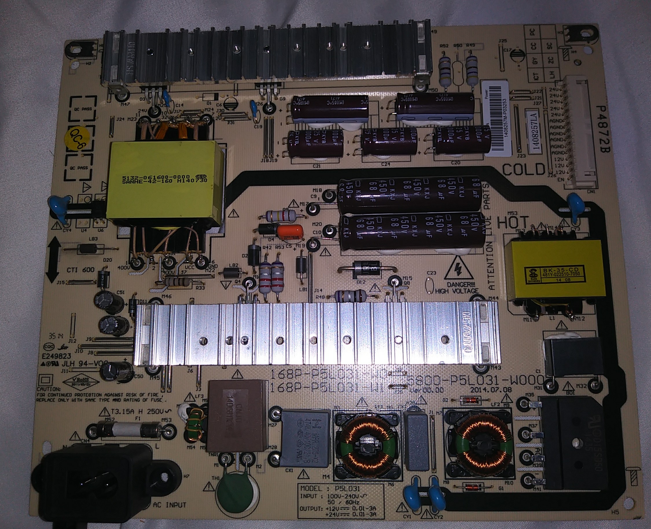

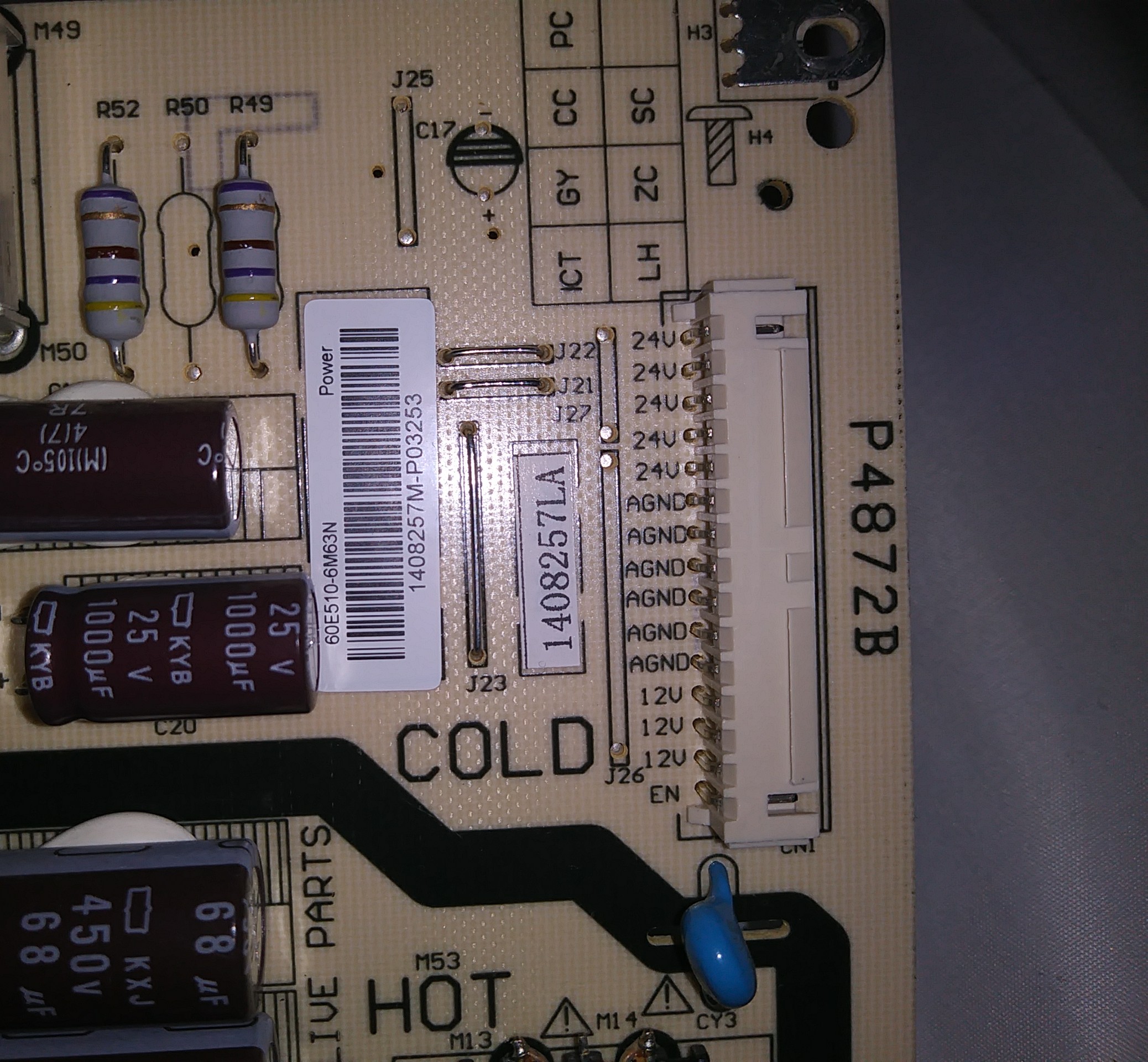

    Hi. Just bought a repair project. LG 60lb5200 has no standby light. I've tested the pin voltages on the power supply and get nothing on any of them. The symbol on the bottom pin reads 'EN'. I assume this is the standby voltage out? I've searched other posts, but can't find this abbreviation mentioned. I tested the main transformer outputs and got nothing. The fuse is good and reads normal AC voltage across it. Can someone lead me in the right direction with narrowing down the problem component? I'd rather not have to pay $100 for a new board.
    I've included pics.
    Thank you!

      Re: LG 60lb5200 LCD TV - No Power - No Standby Light
      Can you check the main primary side capacitors? Negative lead black positive lead red to each side of the capacitor while it's plugged in on DC voltage you should be reading about a 170 V DC.
      Location C9 or C10
        Check D3 and D9 for a short on the secondary. One of them is for 12V, the other for the 24V rail. What is written on U1?
          Ok, I checked D3 and D9. Those are the three terminal voltage regulators on the DC side, right? I'm getting 0 volts.
          Also, I noticed when I move the board that I hear something rattling in one of the components. Sounds like little pieces of loose glass or metal. Could that be from the transformer?

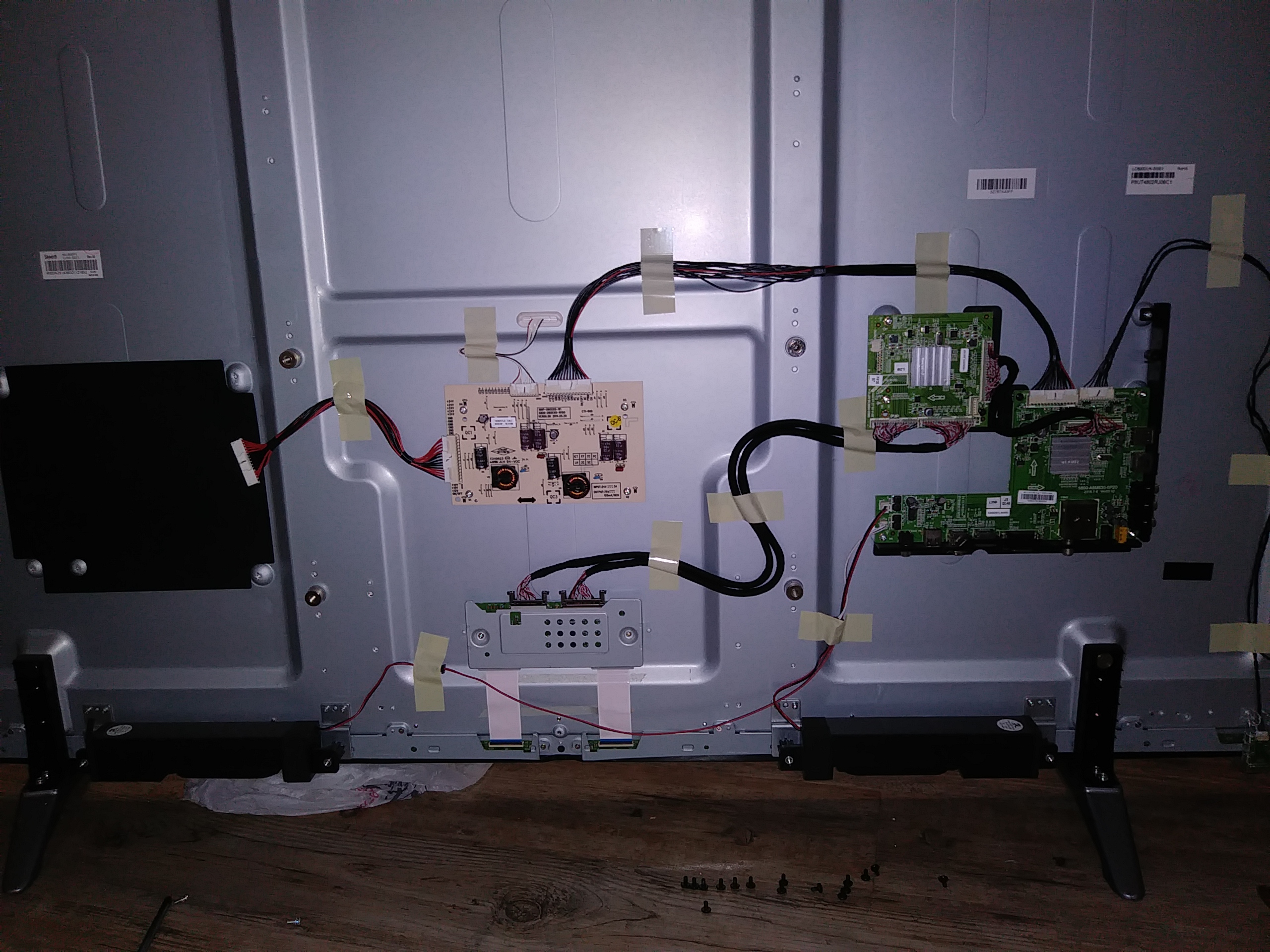

                    This is an always on power supply to supply 12V and the 24V, it also has PFC Voltage booster.
                    What is the resistance reading of R33?
                    Can we see the whole backside of the TV showing all the boards and how they are connected together?
                    More likely the AC feeding this board is done through a switch.
                      Oh wow... I just noticed that the board is burnt underneath that resistor. The ohm reading is 11, 700 Ohms. I can't tell what colors the stripes are, though.

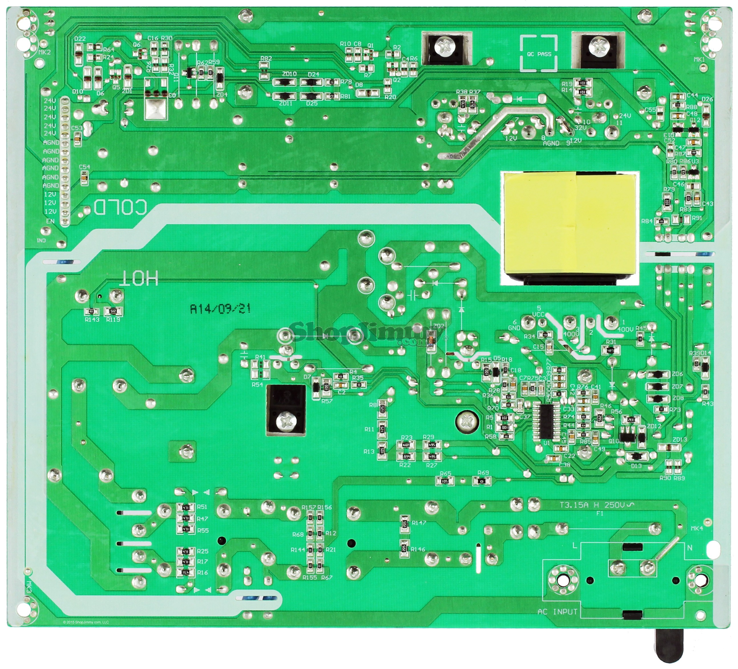

                          http://www.shopjimmy.com/catalogsear...?q=LG+60lb5200
                          LG COV32809701 Power Supply
                          http://www.shopjimmy.com/lg-cov32809...wer-supply.htm
                          R33 looks to be 10K resistor based on the pictures from shopjimmy.
                          Pictures provided by shopjimmy.
                            Ha, it looks nothing like those colors on my board, but it's reading 10.6k. So, even though it looks burnt, it seems to be reading within tolerance? And... I don't see any IC chips on the power board. Do you mean on another board?

                              The IC U1 is right on the bottom side of that power supply board. I hope you do have the tools and know how to do SMD repair.
                              10.6K is good enough, but something is drawing too much current through that resistor.

                                Man... I'm really having trouble reading it. Might need to find a magnifying glass. If I can determine that it IS the IC causing the issue, I might be able to get it fixed. I don't have the tools for soldering something that small.
                                  Without the IC P/N to get the specification sheet of the IC, then there is no way to find out if the IC is getting the VCC to run or not, and that 10K resistor looks to be connected to one of the IC's leg.
