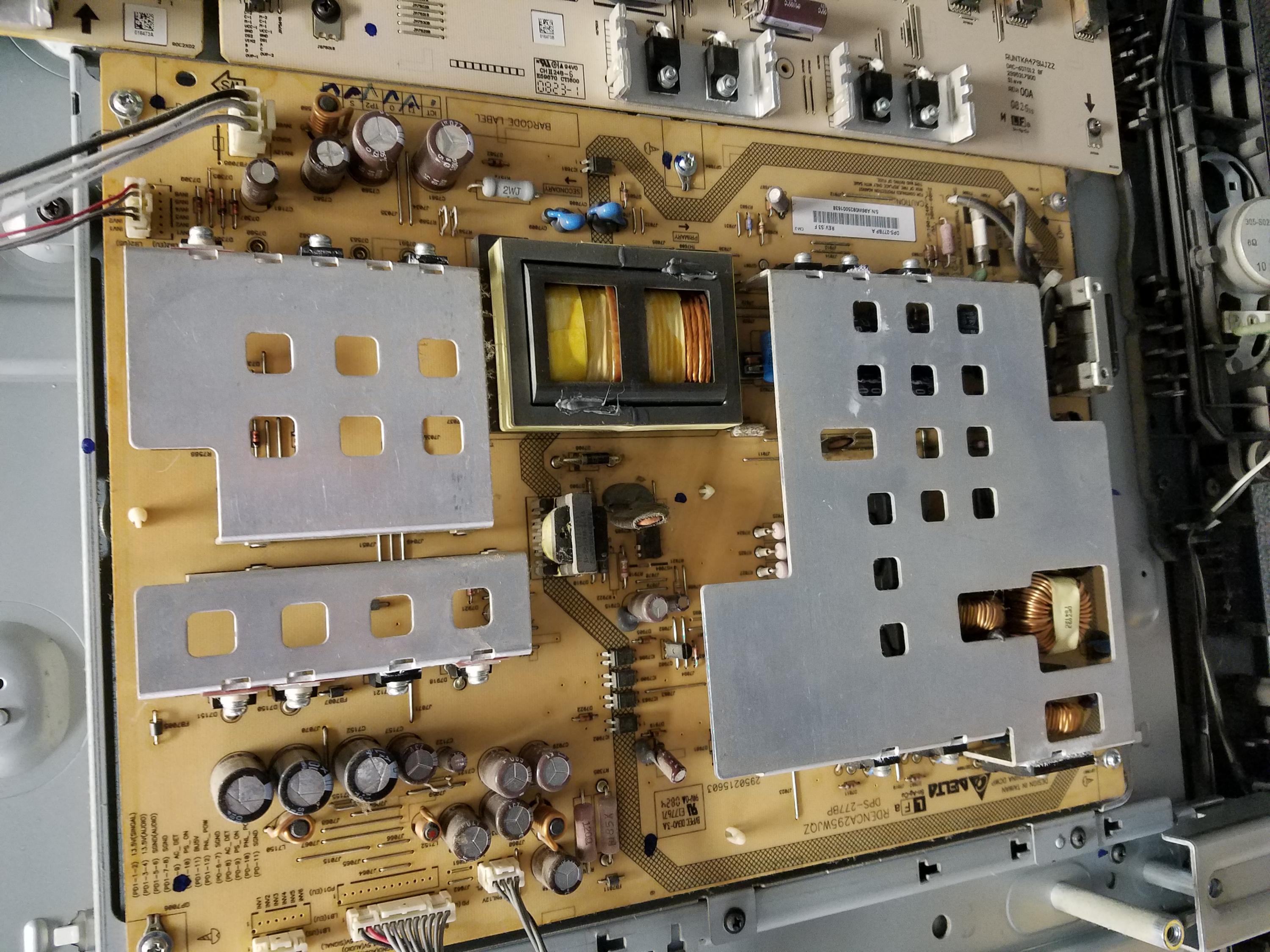

    You will need to force power board on and check voltages

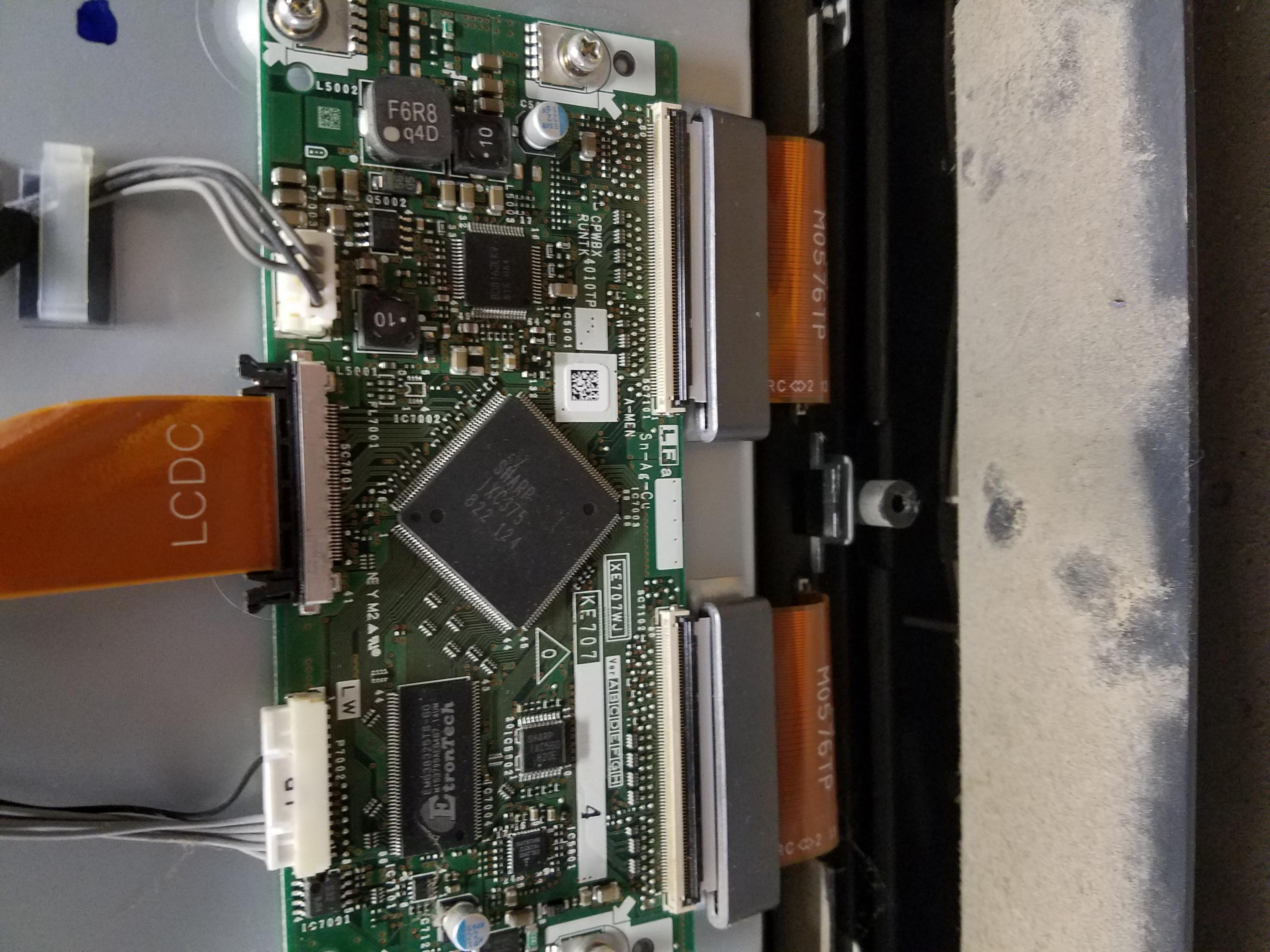

      or... disconnect one of the tcon to panel cables and power up and see if you get something happening... then try the same thing with the other cable.

          Remove connector from main board to power board. Jump from ps-on pin to standby voltage pin
            Re: Aquos LC-C5255U
            How about the pictures of the power supply board and the Voltage readings of the connectors?
            I.E. PNL-POWER command signal and PNL12V output to the T-CON with and without T-CON connector connected/not connected.
            There are more than one versions.

                On the T-CON Bd look for a tiny fuse near the connector that comes from The Main Bd. You should see 12Vdc on both sides of the fuse wrt chassis GND and you could do a continuity test on the fuse with the TV unplugged from the wall ac outlet.

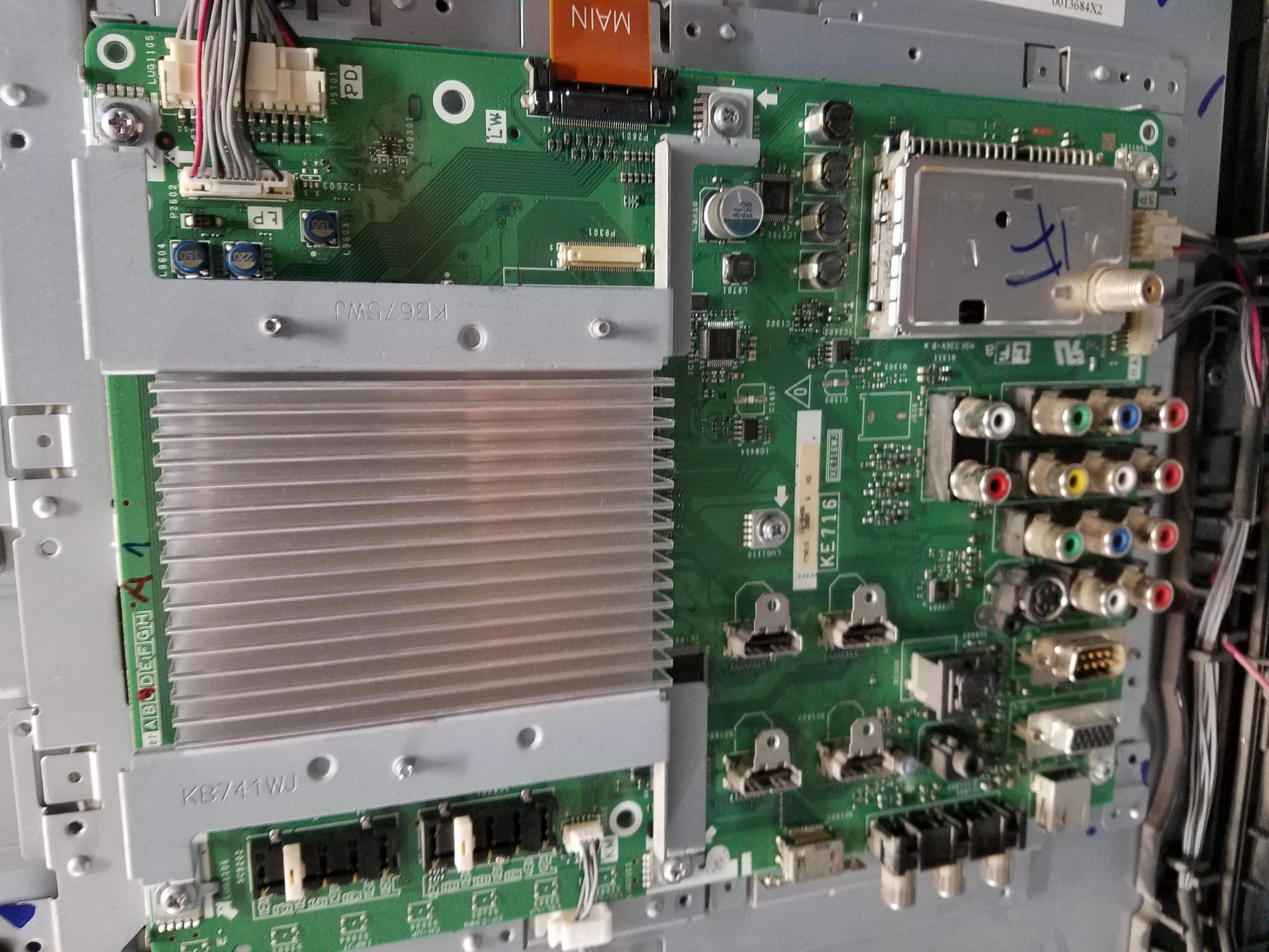

                  OK, will do. Here are pictures of power, tcon, and mainboard
                  *update - I do not see this fuse on the TCON anywhere.

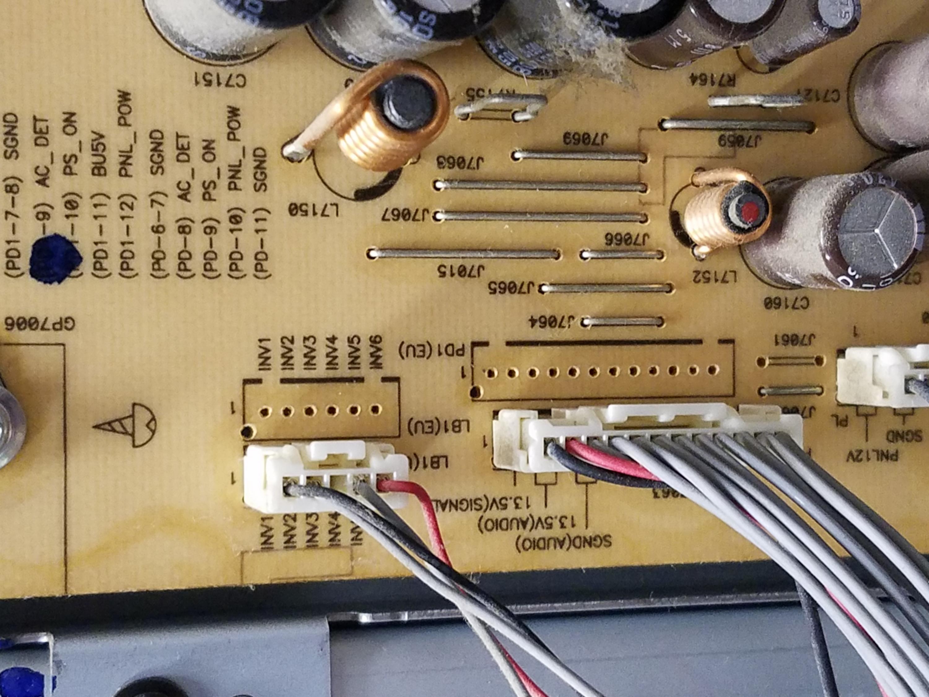

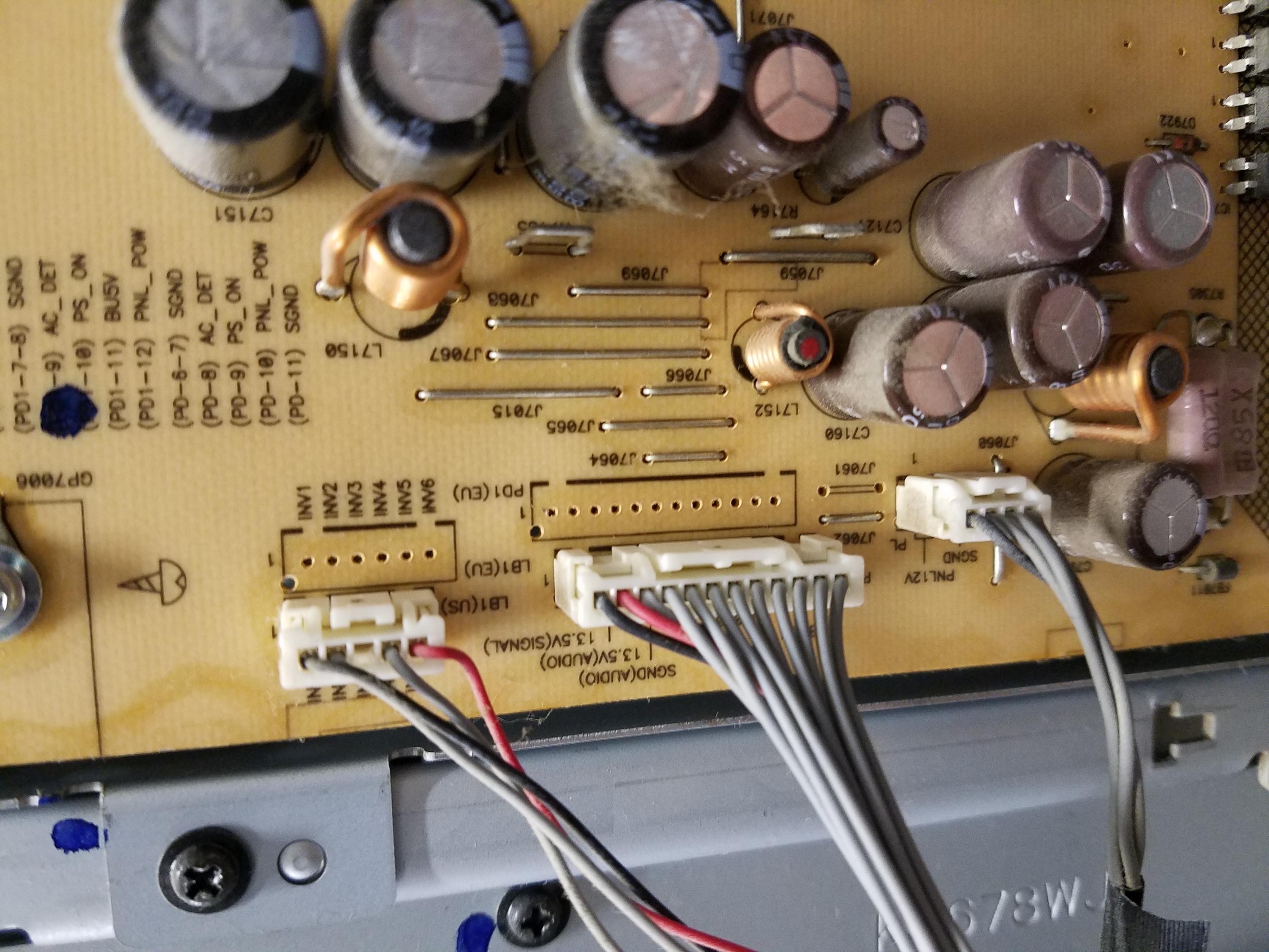

                          OK - if I am doing this correctly I am getting no voltage. I grounded my one lead on the metal of the tv (tried a board mount screw also) and pushed the other down through each of the wires one at a time on the lower jack I have pictured below. I believe the set is on I am getting the blinking pattern i stated earlier. I also tried to get a read by touching the contacts on the bottom of the jack where it mounts to the board with no result either. Let me know if I am making a mistake. TIA

                            The picture that was supposed to be attached...

                              In addition to what I posted above, we did this. We forced the TV into bypass mode which lights the backlights. Here are our pin results;
                              Pin 1 12.8
                              Pin 2 12.9
                              Pin 3 12.8
                              Pin 4 0
                              Pin 5 0
                              Pin 6 0
                              Pin 7 0
                              Pin 8 2.9
                              Pin 9 2.9
                              Pin 10 0
                              Pin 11 0
                              Pin 12 0
                              The backlights will stay up until TV is unplugged and re powered
                              TIA

                                I do believe you need to be a little more "precise" in your reading procedure. You need to monitor the test point (12v pin) for power all the time from attempting to power up because if the set is "errored", then powering is removed fairly quickly.
                                IF you never see the 12v on the pin, then as suggested by budm, you need to then monitor the pnl-pwr to see if it gets any voltage (something more than 2v).
                                Further, the "blink pattern" is TOO LATE... by that time, the system has determine an issue and has removed powering from various areas.
                                Passing ships on the internet.... :-) your new post indicates 12v is there.... maybe not... what are pin 1 ,2,3 on that connector... your picture is cut off.
                                PNL-POW is 0 still.

                                  BTW: Always put down the pin name so we can easily know what each pin function are.
                                  Those 12VDC Voltages are not the PNL12V, PNL12V is on the other connector.

                                      OK, I tried again this morning I hope I got it right. I plugged in the TV, measure the PL pin and get .3 v until it clicks and dives to zero. Same thing happens with same procedure on PNL 12v .3v to zero after click.(relay or just tv switching off?)
                                      Be patient with me if I am once again incorrect. I can repair any computer you put in front of me and have done it for 20 years, but the TV thing is new to me and I would like to learn it. Thanks for the continued help.

                                        "OK, I tried again this morning I hope I got it right. I plugged in the TV, measure the PL pin and get .3 v until it clicks and dives to zero. Same thing happens with same procedure on PNL 12v .3v to zero after click.(relay or just tv switching off?)
                                        Be patient with me if I am once again incorrect. I can repair any computer you put in front of me and have done it for 20 years, but the TV thing is new to me and I would like to learn it. Thanks for the continued help."
                                        Since that last post I now realize the PNL 12v is on the lower jack and gave you that measurement of .3v to zero before it died,(2nd pin named PNL 12v) and the PNL power is on the upper jack and it measures a 2.9v (8th pin named PD1-12 PNL_PWR ) I hope this helps
