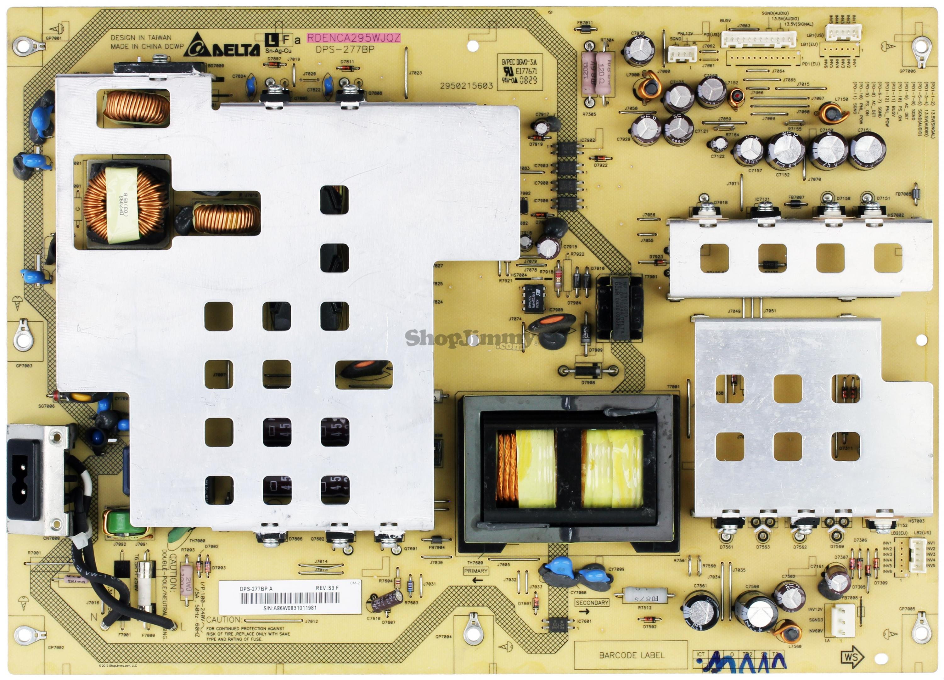

    IF you have done things correctly both in terms of "statement" and "procedure" (that's a big IF... :-) ), it would appear that you have lost the 12v supply in the power supply....

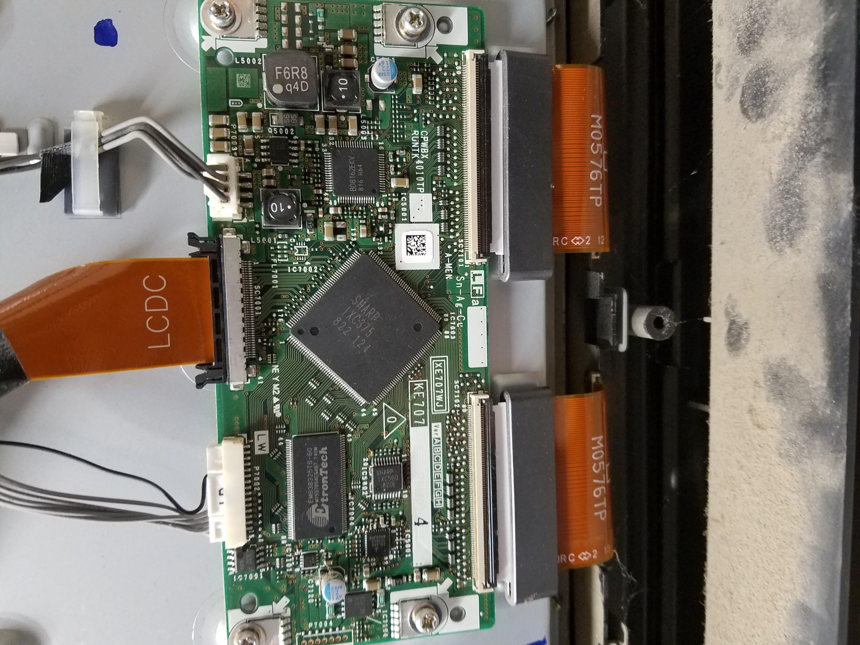

    You can check things further by disconnecting the 4 pin cable going to the tcon (from the power supply) and repeat the power up test and measure the output on the now disconnected cable at the appropriate pin in the cable connector. This test will help to see if you have some form of "loading" on the 12v supply coming from the tcon / panel. Go from there.
      Re: Aquos LC-C5255U

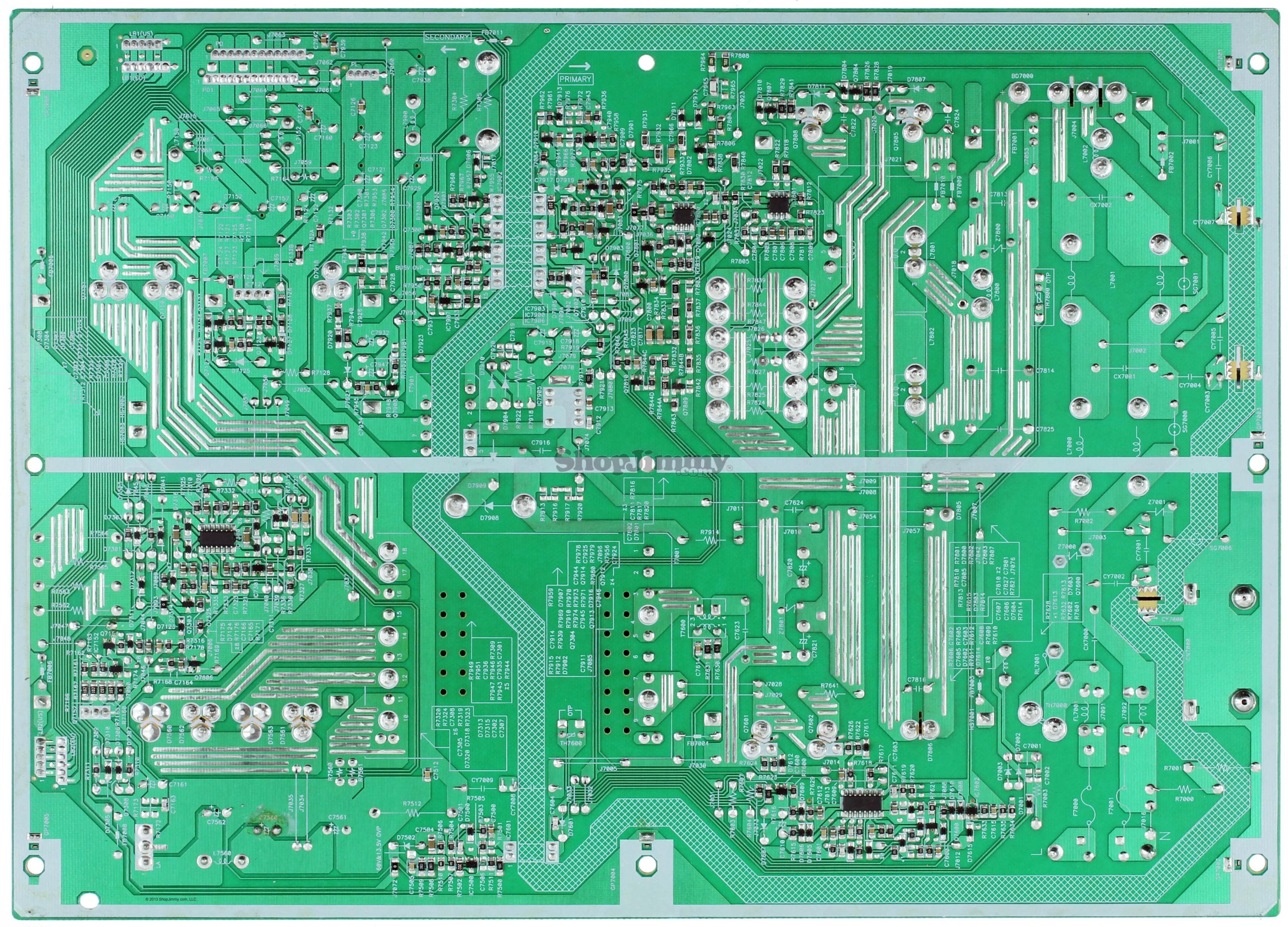

      If you disconnect the T-CON and monitor the PNL12v and still do not have PNL12V then more likely the IC7121 is bad.
      Sharp RDENCA295WJQZ (DPS-277BPA) PS.
      What is the P/N as printed on the IC7121 (Switched 12V LDO regulator).
      KIA??????
      Pictures provided by shopjimmy.

            OK here are the results. With the 4 pin disconnected from the TCON I measured the voltage on the TCON end of that cable on the PNL 12v line I have .3v , it stays there until I hear the click and then spikes up to about 11.6 and then drains to zero. The IC 7121 is a Sharp PQ30RV31 29h W2 Thank-you
              Re: Aquos LC-C5255U
              Do the EXACT same test with cable connected back in place and give us the result.

                :-( no looking so good. My guess is you have a panel issue which is pulling down the 12v supply. You might want to check some of the capacitors on the edge boards at the bottom of the panel. You might get lucky and find a "weak one" that is replaceable "in set"... maybe.

                          so whether the power to tcon cable is connected to the tcon or not, the voltage "response" / characteristic is the same.... at power plugged in, you see about .3v, then with power switched on / activated, you get a click and see 12v then it goes to 0v shortly thereafter.... flashing code ???? :-( please confirm the code flashing with the power cable connected and disconnected test (ie. no code, same code, different code).
                          Highly likely a panel fault but not totally sure. Can you retest the tcon to panel cable disconnect test? (ie. disconnect one cable from the tcon to panel, power up, what happens on the display / flashing code). Do same with the other cable.
                          Finally, look / provided pictures of the lower edge board of the panel. Some have found cap issues there that might be "on-set repairable". There are at least two lower edge boards so you can compare "looks" and measurements if need be.
