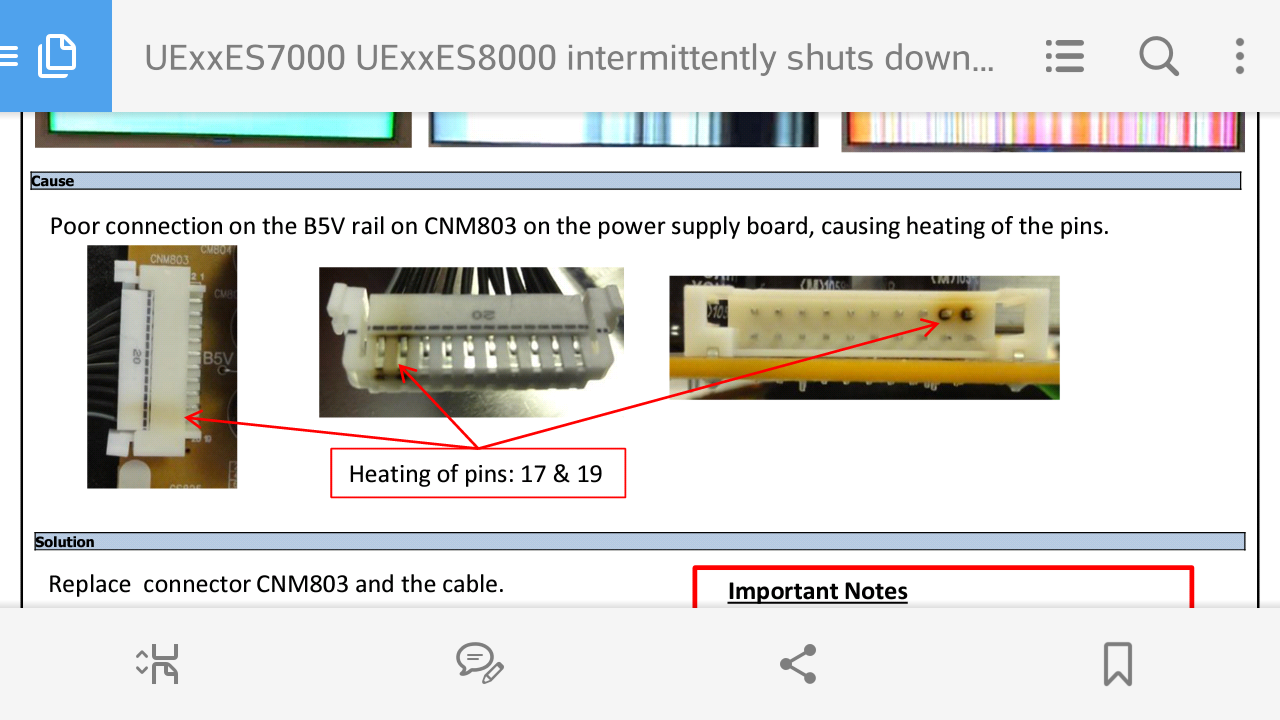

    Does the connector look like this?
      Re: Samsung un65es8000fxza turns off after 15-20 seconds
      Another poor quality connector failure similar to this bulletin.
        yes it looks like that. Not quite as bad though.
        For what it is worth i took the wire in question (the browned 5v) and soldered it directly and confirmed a nearly 0ohm end to end. No change.
        I don't mind soldering all wires directly if it will help.

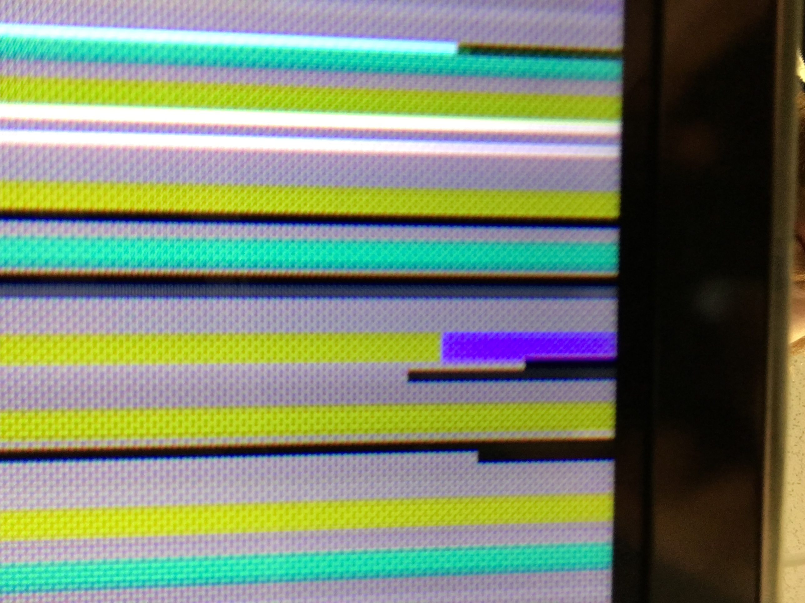

                                    Well, the board is definitely holding down backlight enable. 0ohm to ground at times, 5ohm to ground at times. would think a legit high signal would be in Kohms at least (agree?)
                                    With that wire removed and ps on removed i get some wacky pattern on the screen. Not sure on sound yet.
                                    Backlight is massively flickering suggesting that the PWM is not working correctly either. Im now hopeful that there is a closed diode or cap somewhere on mainboard causing the holding down of the backlight. I suppose its time to trace from blu_on backwards.
                                    Image remains a mystery. Should be attached.
                                      The pictures should be normal if the only problem you have are the control signals.
