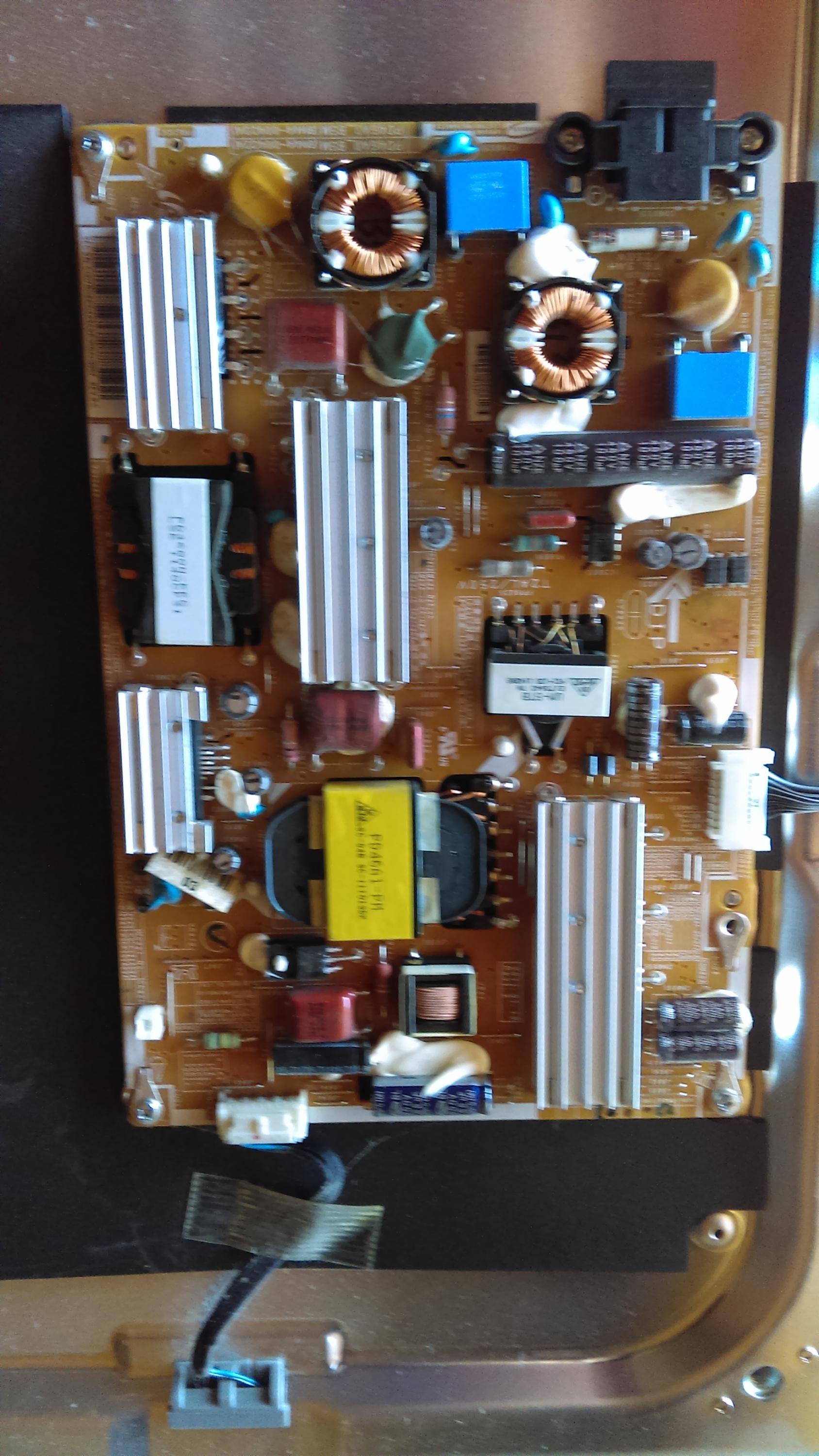

    Does it still have standby when it turns off? test all voltages coming out of the power supply while the TV is on and after it "shuts off".

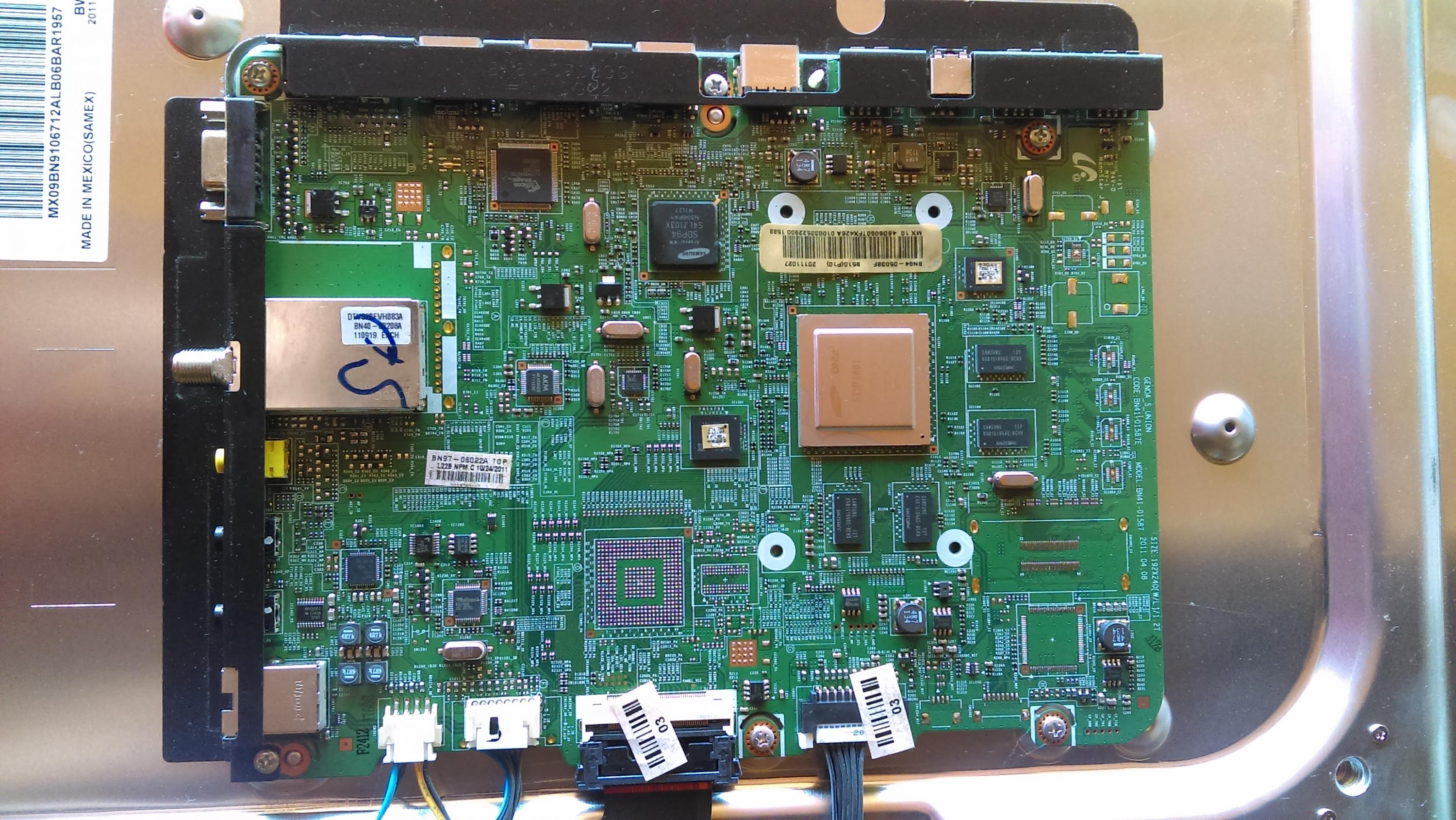

      The problem with this chassis and motherboard BN41-01587 (reboots every 30 sec.) is a problem with eMMC.

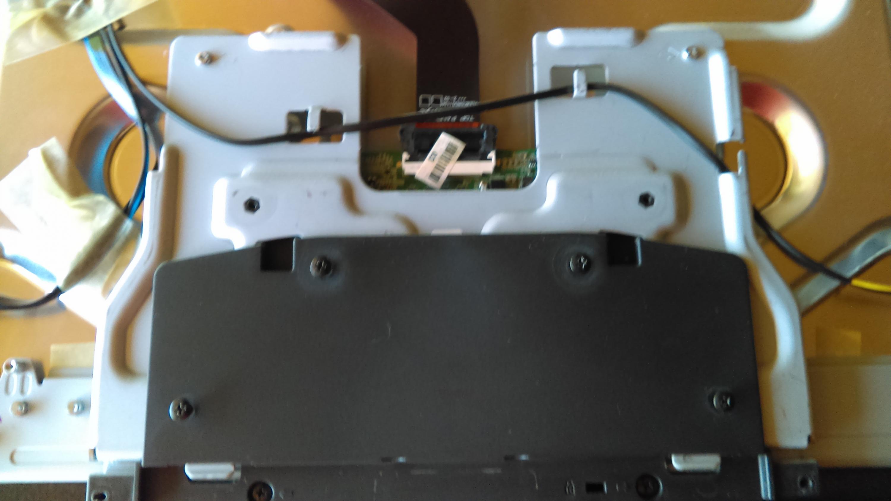

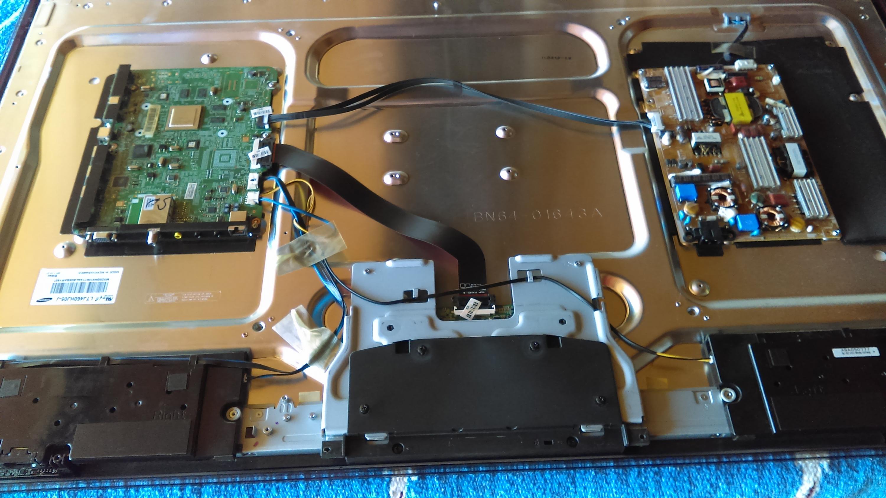

          Okay, I'm really green when it comes to this. I took the stand and back cover off to reveal these images. I've attached some images as my first next step: back, main, ip board, & tcon(?). As the power cord attaches to the ip board, is that where the voltage readings want to come from? I don't know which component is more or less significant that the next...

            Re: Samsung UN46D6050TFXZA turns itself off 30 seconds after start
            Since they said shut down, I assume it did not reboot.
            If it is turning on and off in loop, it is as lotas said.

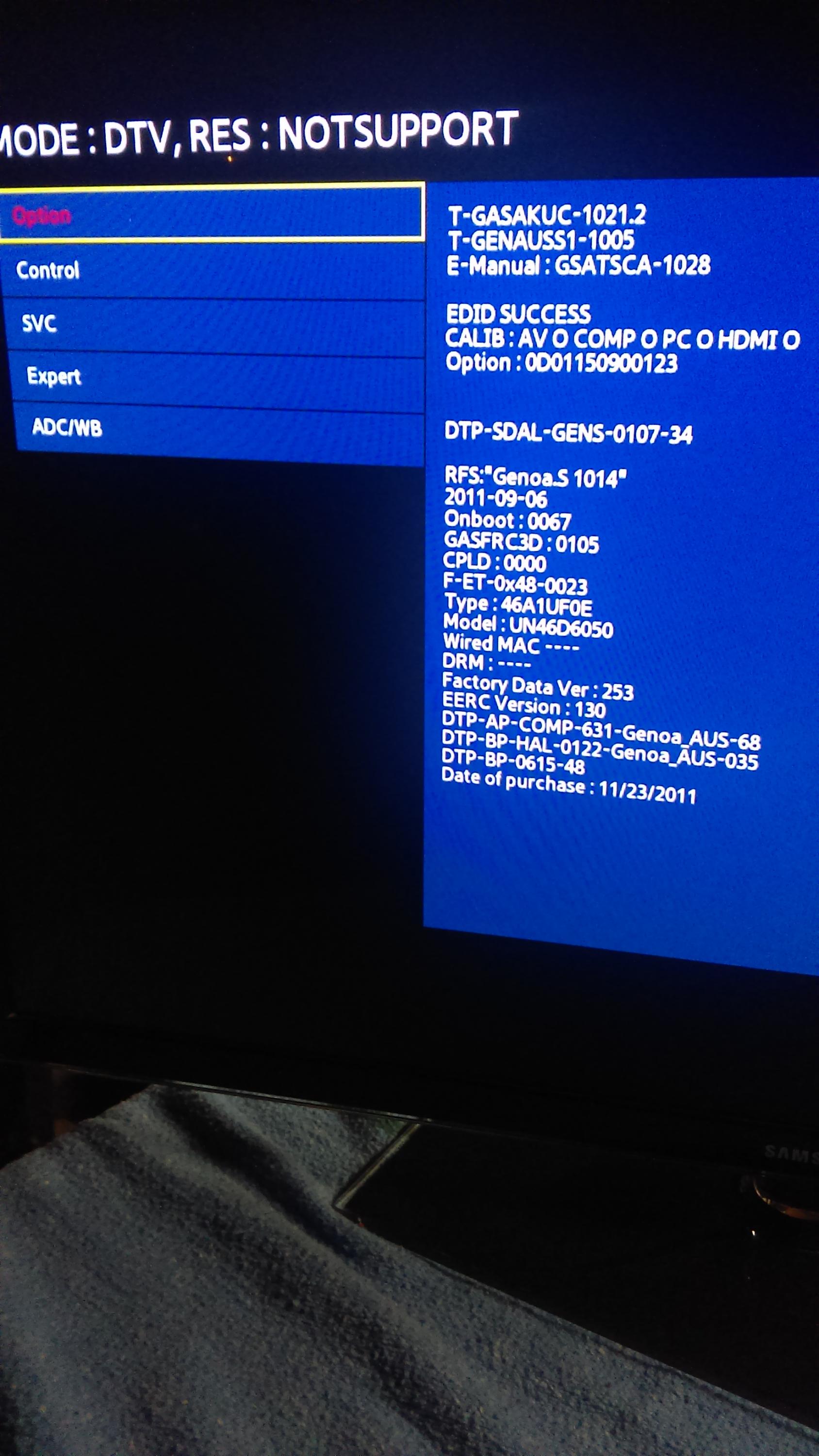

                It may still be the memory corrupted, try starting the tv in service menu by press on the controller remote:
                Mute + 1 + 8 + 2 + power on
                Then doing a factory reset there, it should take 10 seconds at most.
                This command has worked for all Samsungs I've tested.

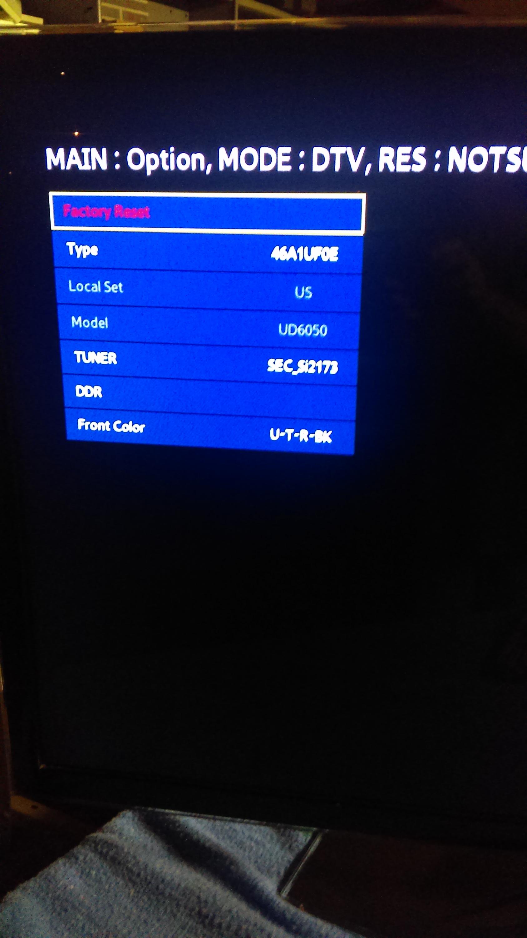

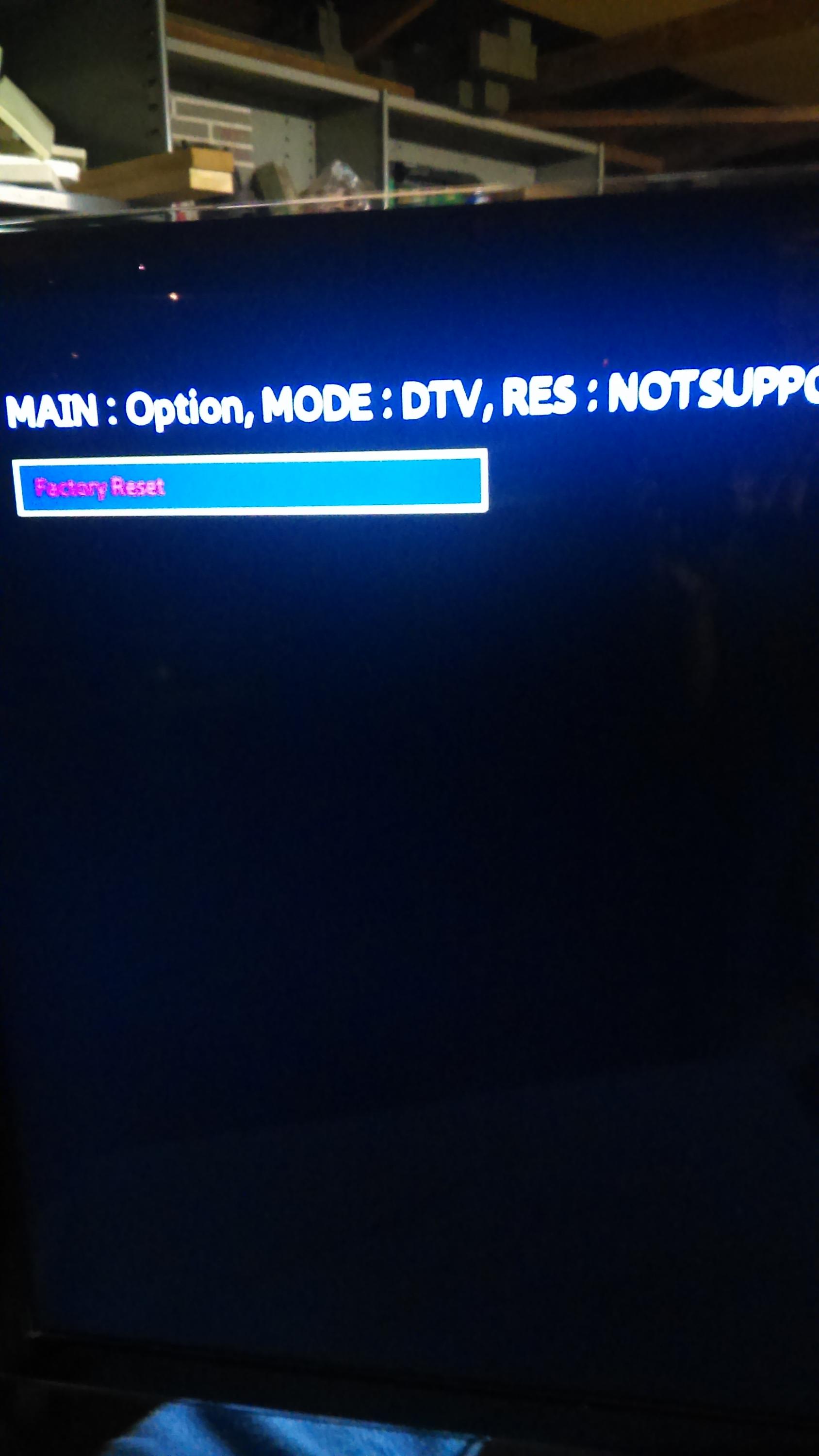

                  Okay, I've now started in Factory Mode multiple times. Finally, got the Option menu to load and selected Factory Reset. When I get to the Factory Reset button/page, nothing seems to happen when I select it or use the arrow keys on the remote. What more do I push to activate the reset process? OR How do I know that it has started/been run?
                  With the splash screen, it takes about 10 seconds to get the Factory Menu up. And maybe another 10 seconds to get through the Option Menu to the Factory Reset page. Then nothing happens and shut down after 10 more seconds.
                  Today I am getting better at navigating these menus which I don't recall being able to move through when I originally tried, and which led me to find these forums for help.

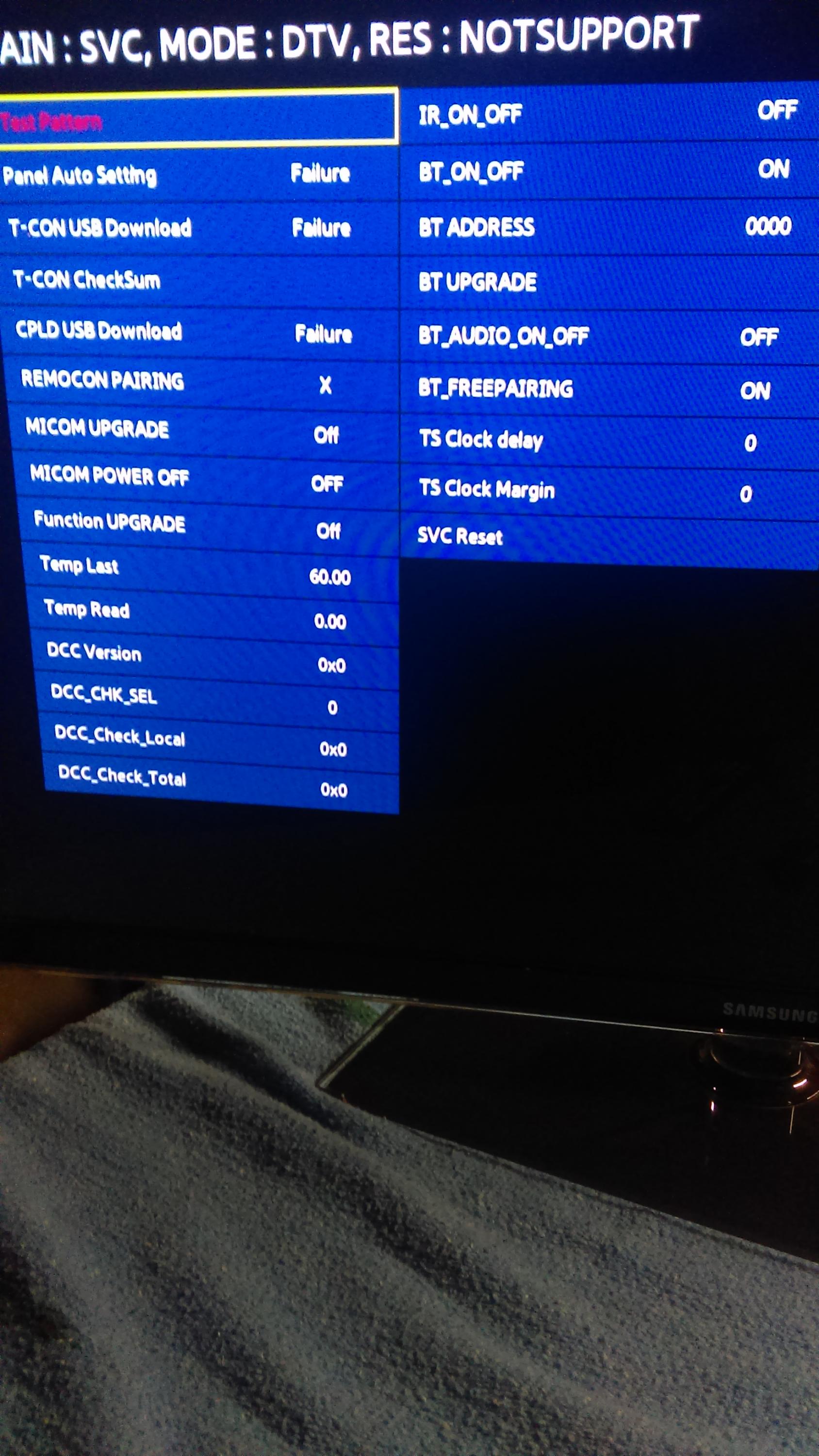

                  I've also attached an image of the SVC Menu which includes three items marked as "Failure". Not sure of their significance. I have always gotten my TV signal from a rooftop antenna. Also have a DVD player connected via the included AV Adapter and have watched various MP4s downloaded to a USB drive then attached to the TV.
