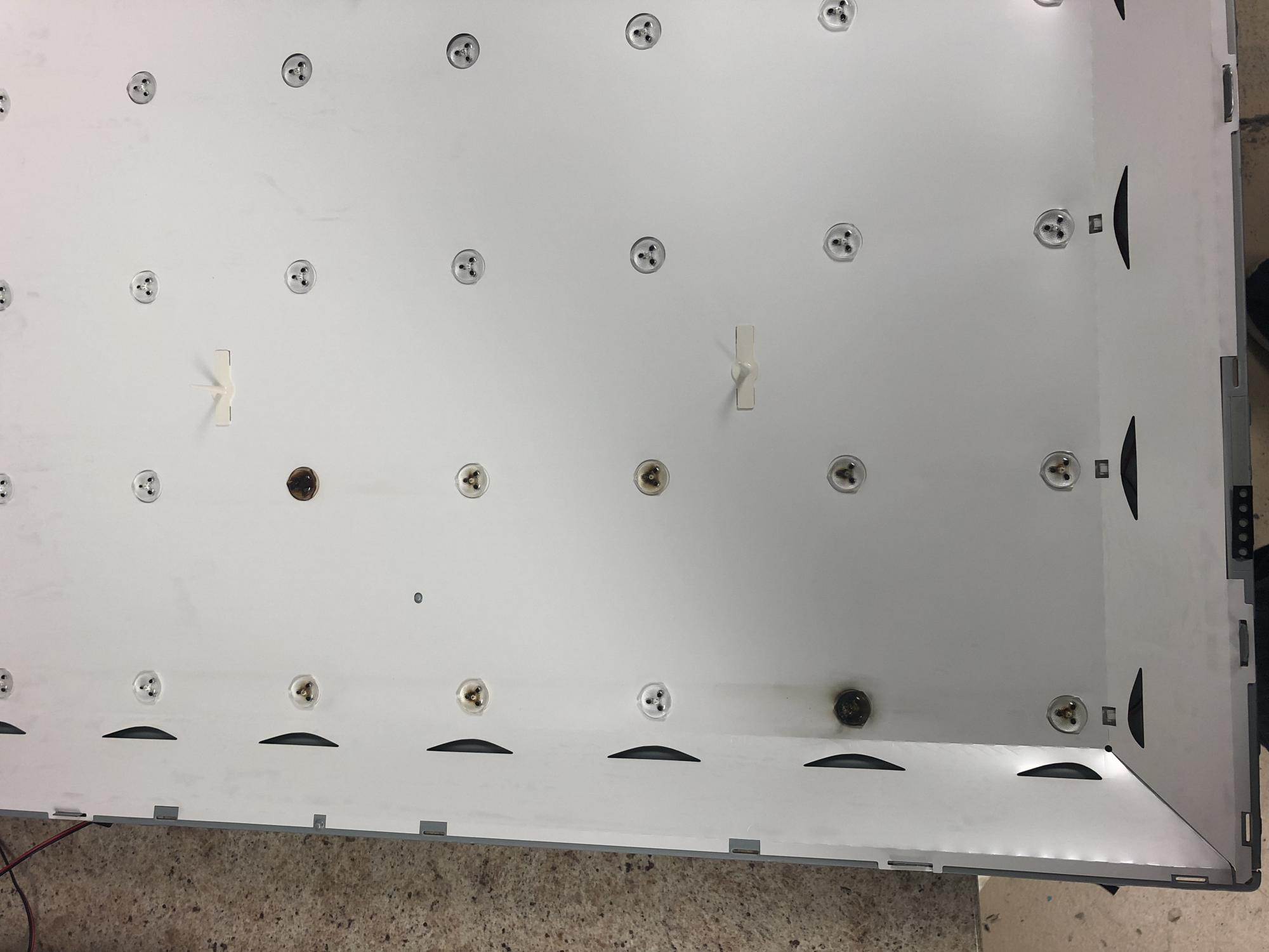

    hisense 55K20DG no backlight
    Hey guys. So no backlight at all. not even a flash. I'm getting 330 volts at the connector for the back light. Would mean I have a problem with the strips themselves correct?

    Pictures of the boards with the back of the tv off may help you more with fixing your fault

      Re: hisense 55K20DG no backlight
      Here is picture of backlight strips. Burned out but why
        They drive those LED to the max and with poor heat management.
        Once you get it fixed you should then turn down the backlights level to as low as you can.
        Yours is not as bad as the one in LG TV's.
        https://www.badcaps.net/forum/showth...ht=LG+47LN5790
        • freakaftr8
          • Oct 2012
          • 3743
          I had a Samsung 40" about a month ago that the led's got so hot it and shorted it caught the white diffuser sheet on fire
          • Jtroutt19
            • Aug 2011
            • 164
            wow thats nutz! Thanks for the pictures. Time to order some parts.
