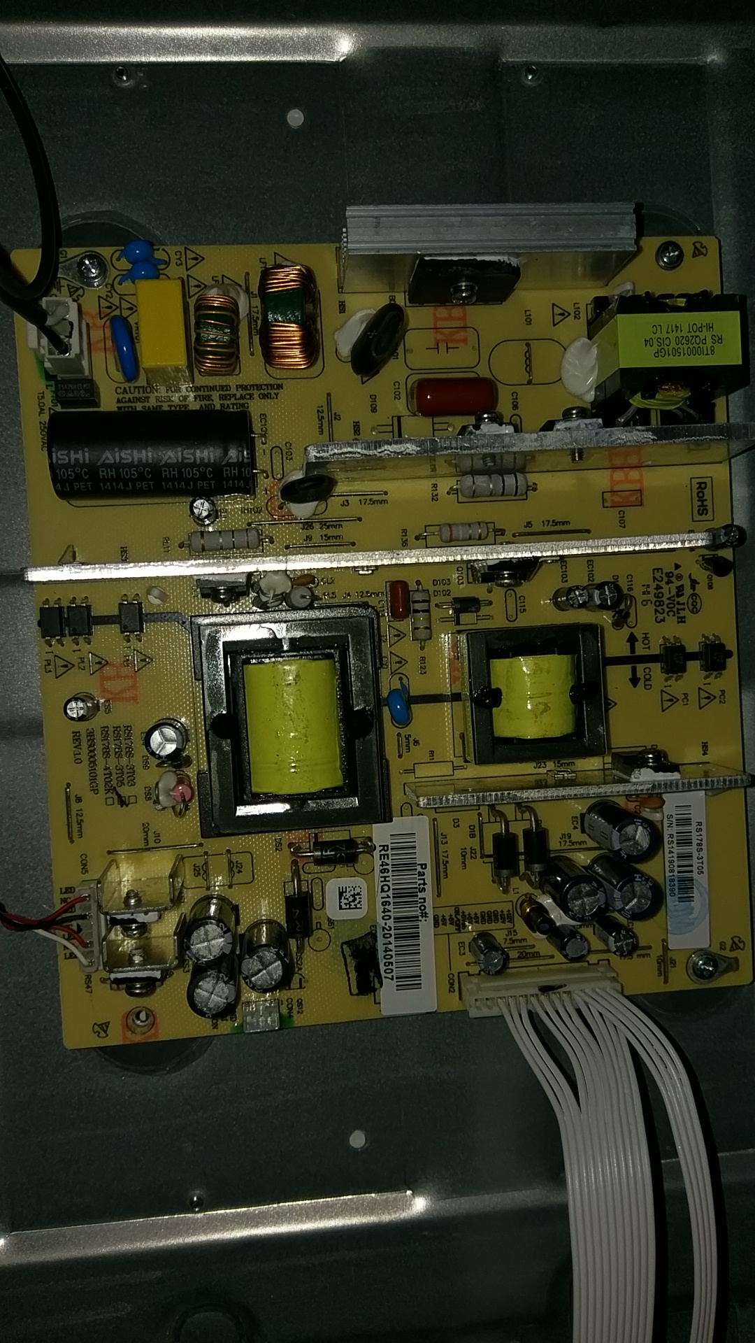

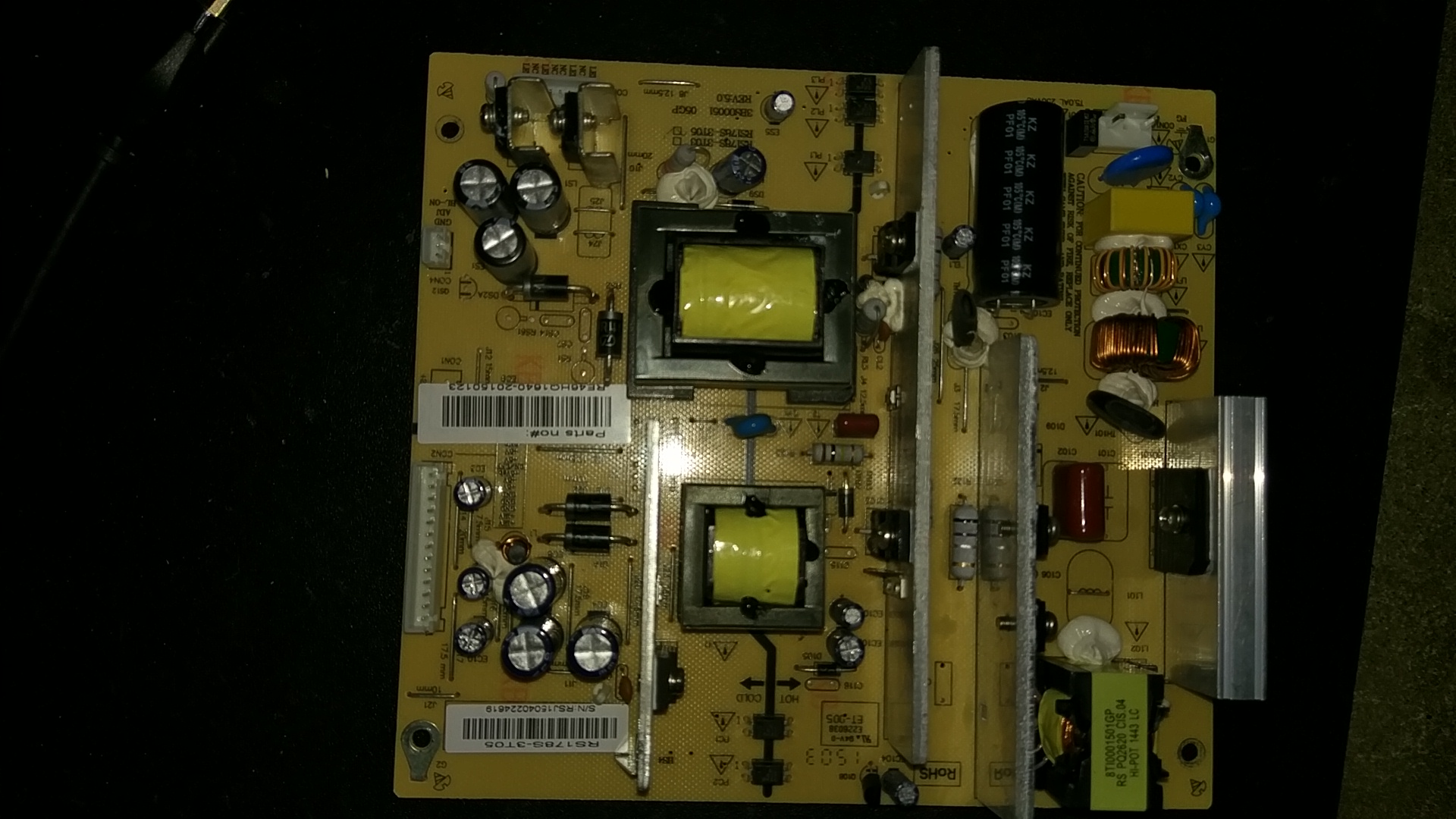

    I have tested the backlights with my LED tester, LEDs are working. Tester shows 146 on both leads to lights. No voltage coming from the LED connector on the power supply. What would cause the power supply to not output voltage to the LEDs connector?
    All other voltages on the power supply are correct same on a second power supply I just got in from shop jimmy. New power supply is an Rev. 1 board, old board is Rev. 5 not sure if that makes a difference results are the same. Can see the picture with a flashlight and I get audio.
    I use to be able to get the lights to come back on by unplugging the TV for a bit and holding the power button, it's not working anymore since I removed the power supply and mainboard. The old power supply is the one not attached.

    I made a mistake plugging the wires back in so now I am getting the backlights to come on again when unplugging from the outlet and back again. As long as I don't try to change the input I'm using like HDMI 1 or something the tv seems to run flawlessly. After an hour or so changing the input will cause the backlight to go out. Also when I attempt to turn off the tv after this has happened the red standby light doesn't come on. The voltage shows that the tv has powered down. Anyone know if the mainboard has an inverter controller on it?

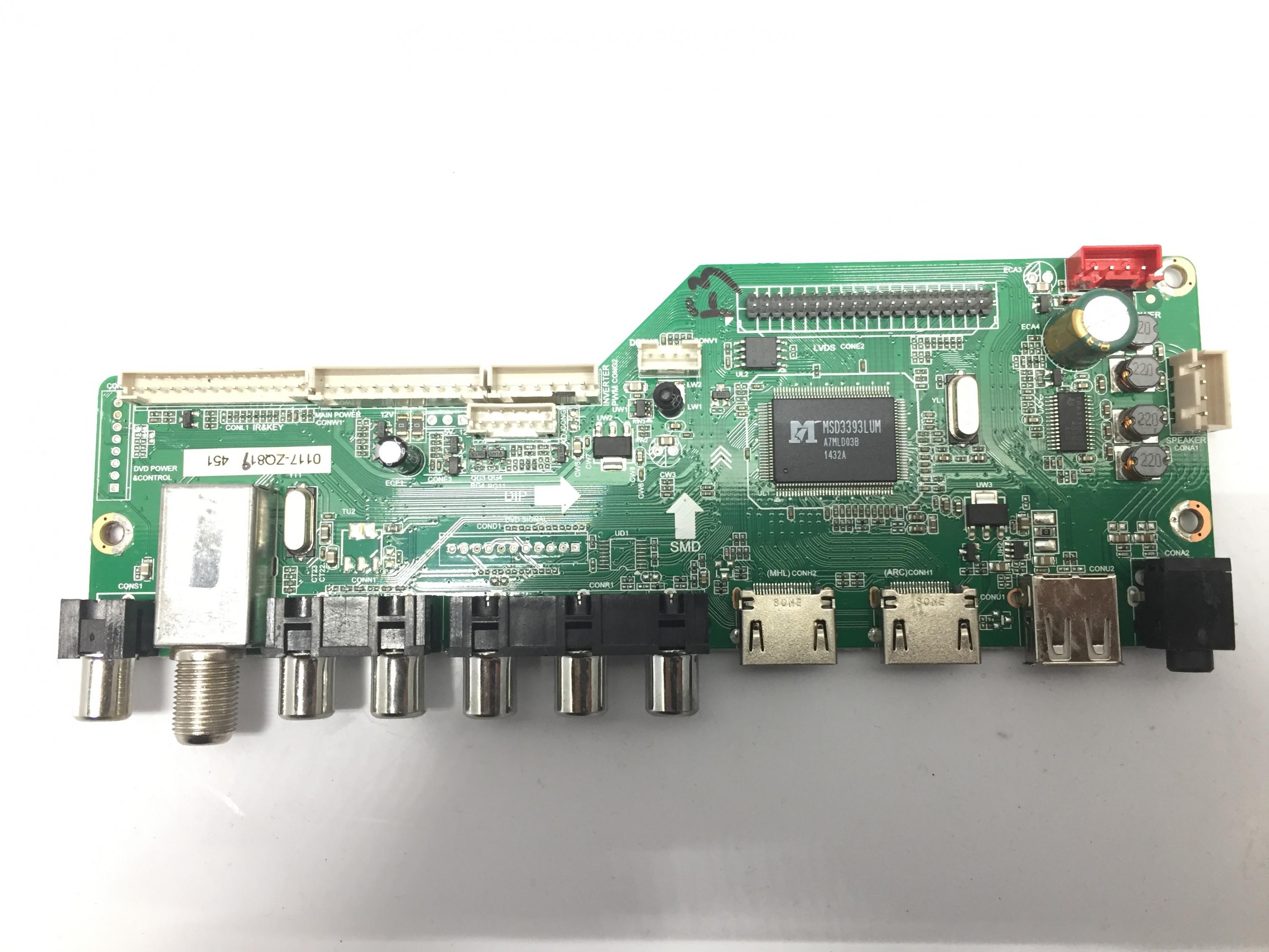

        Thanks for the reply, I had ordered a mainboard it got in yesterday, I've run the tv all day changing inputs even cut it off and on a few times. So this morning I changed inputs and turned it off and on. Decided to do it one more time just for the hell of it and the backlights didn't come on. Of course unplugging it and back allows me to turn it back on. So the new mainboard allows it to stay on for more hours than the original. I also tried it with the old power supply and new mainboard the lights will go out with it just sitting on for a hour or so. Could the FRC Board have anything to do with it?

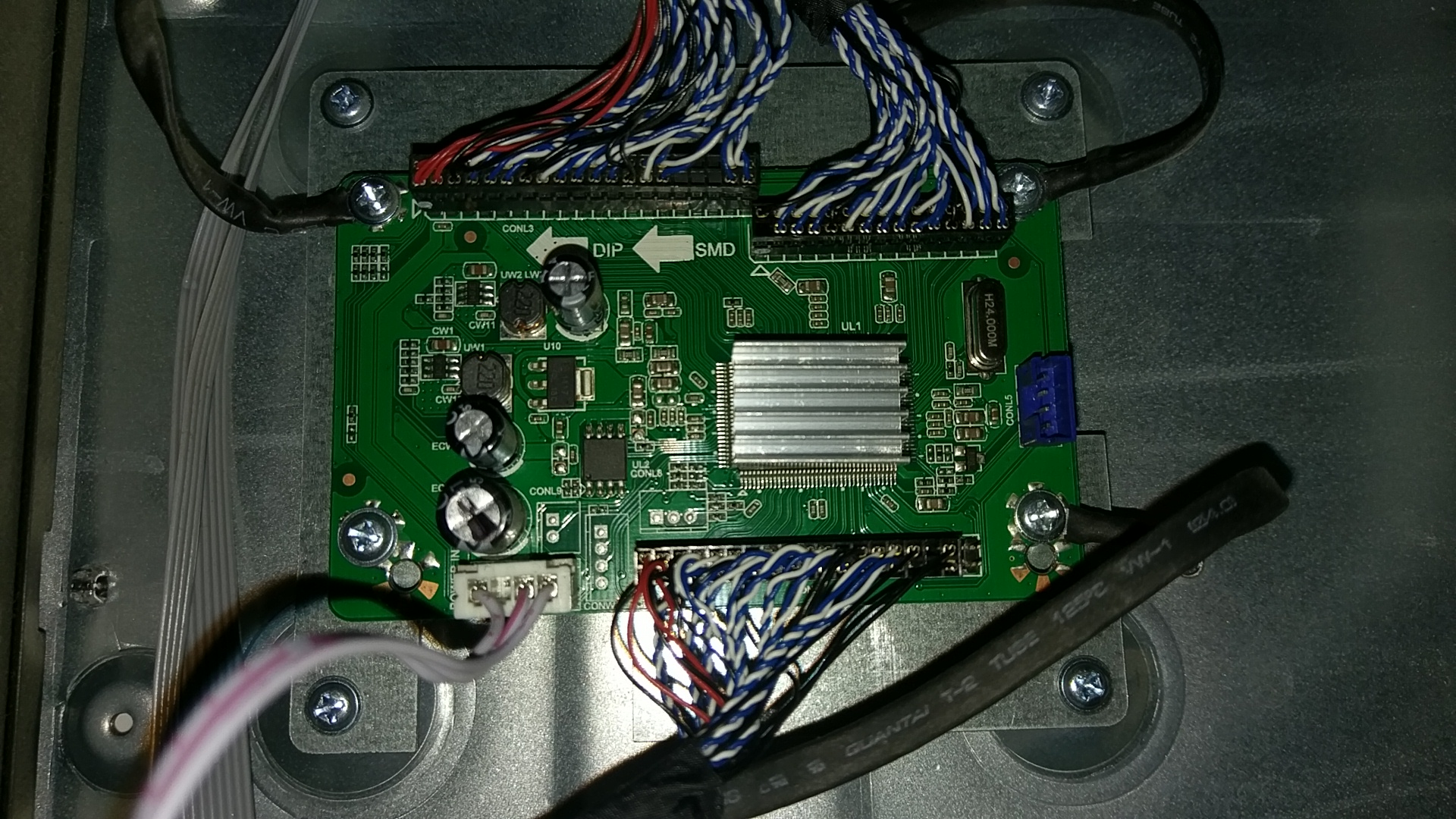

            Ok, latest update, I understand how everyone feels about the company but it's a clients tv so it would be bad customer service for me to kick the panel in...lol. I installed a new FRC board a day ago and the tv ran close to an entire day turning it off and on, and changing inputs so everything seemed fine but I still didn't trust it. Turned it off and on a few times this morning and Bam!!! The lights flashed and that was it, the sound is always there and as I've stated if I unplug it then plug it back in it will come back on without any problem. The lights have never gone out without me using the power button or changing to another input.
            Where could it be losing power?
            Could something be overheating?
            Is there a way it could be the backlights even though they are working?
            Also is there any way it could be the T-con? It's the only board I haven't changed.

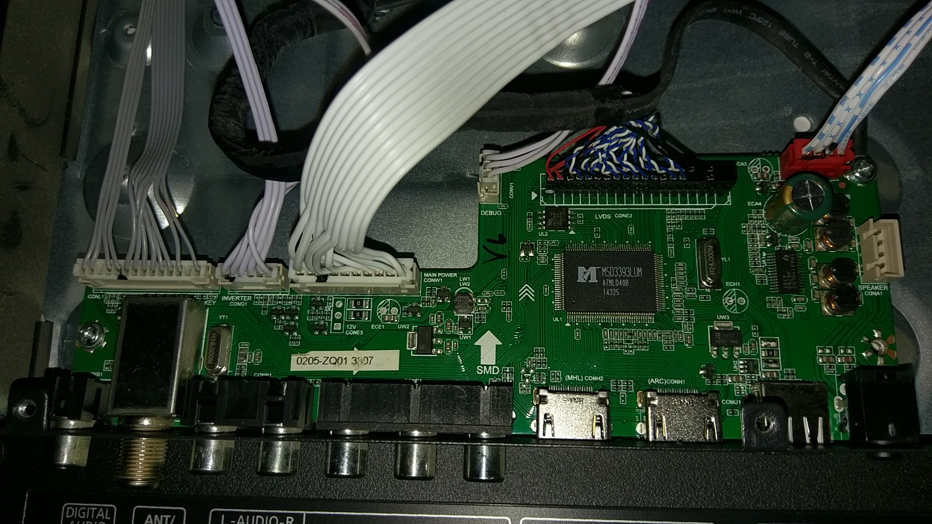

              I am a bit confused here. Do you have no backlights when the screen goes of (audio is still playing), or are the backlights on and have a black screen?
              Can we see your Main and TCon?

                  Re: 55" RCA LED55G55R120Q no backlights
                  @capleaker
                  The TV works as it should, backlights are on everything works. After maybe an hour or more that's were the problem comes in. If I turn the tv off and back on the backlights might come on or they might not. If they do not I have to unplug the tv and hold the power button. when I plug it back up the tv will power up again and work as it should for as long as I leave it on. I've had it running a whole day no problem. There is a random issue with the backlights losing power somehow. The picture is still there if I take a flashlight to it or use my led tester to power the backlights. The sound is still there as well.

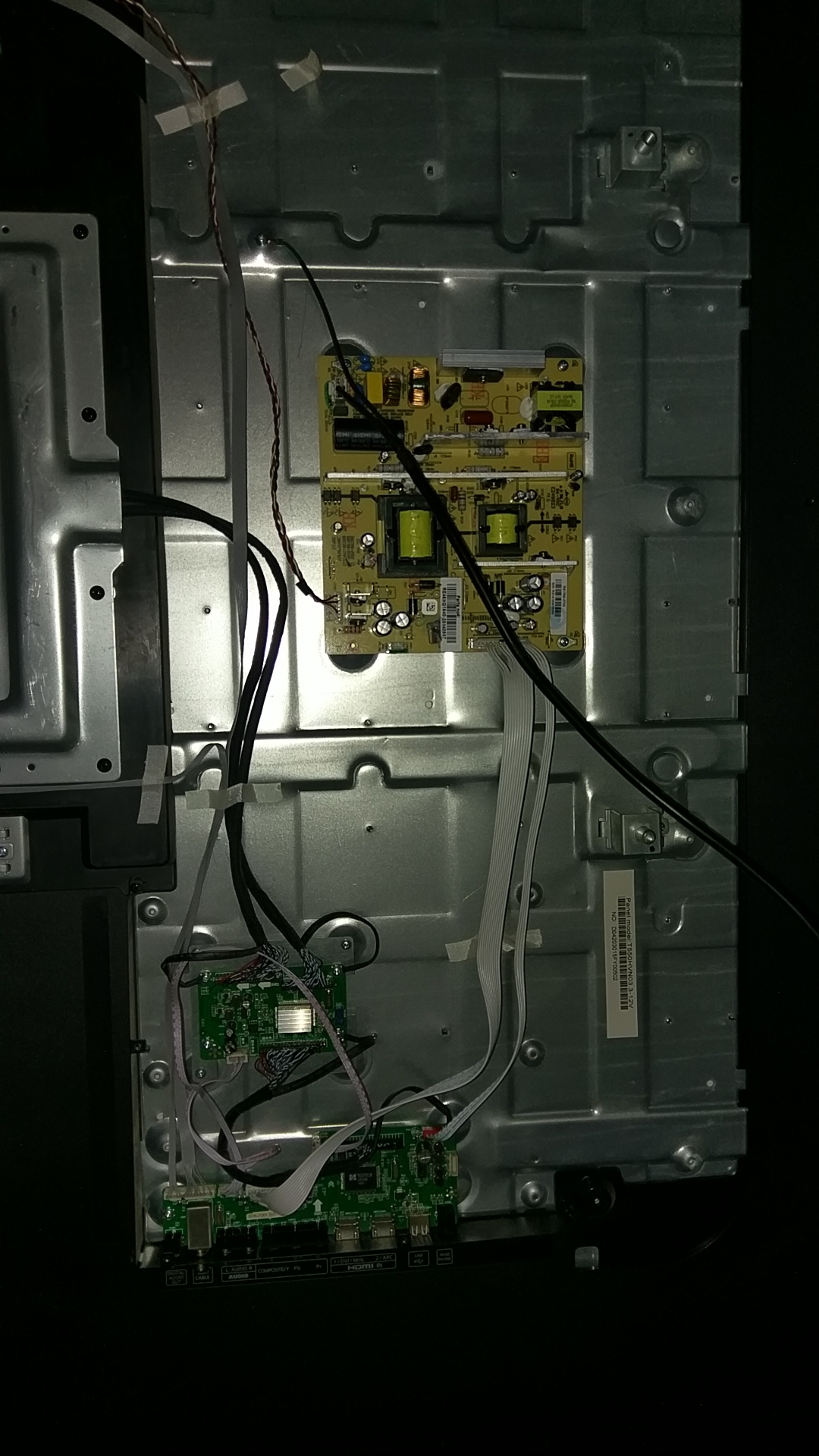

                                So long story short I have the 65 inch version of this TV, when I first diagnosed it. I did so without taking anything apart. I had image no lights so automatically assumed it's back lights. I bought the lights took it apart tested the lights to see which strip or led was bad. Literally all strips were good, but still didn't power on when the TV was turned on. Being the optimistic loser I am I replaced all the LEDs and that did it for me. Not sure wth the issue was but the TV is fully functional and I regret ever fixing it because the TV is not the greatest quality not to mention its so bulky.
