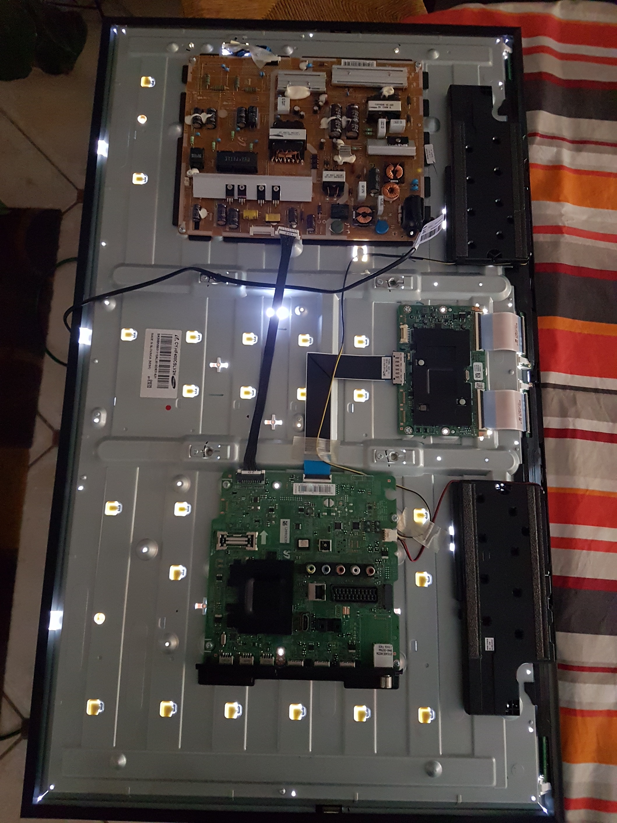

    Hi guys
    I have a a EU40F6400 TV and when I was watching a movie suddenly image became black, but sound was ok. After restart, same problem, and I noticed that the power LED was blinking 5 times at startup before shuting down (but sound still present when I press the remote control).
    Then I have open the TV to look at the PSU, ref BN44-00622B.
    Both fuses are tested ok. Relay is ok.
    No traces of any damage on both board faces.
    All the capacitors seems like new !
    I get the schematics here :
    For the moment, I have checked the voltages on the backlight connector (and directly on the output caps). This is what I measure :
    C9154 : 40V (schematic specify 43V)
    C9254, C9354, C9454 : 95V (schematic specify 85V)
    Same measurements with either the backlight cable connected or not.
    I'm not sure if I should order a new PSU (100 euros) or not. Since caps are ok (voltages measures on all others caps seems valid, approx 5V and 12V respectively), what kind of failure could I suspect ? Would it be possible that the error come frm the backlight ? It should be wired because it seems to have 4 backight power lines, all the sections failing at the same time is unusual...(but I'm not sure of backlight composition).
    Thanks !
    Aurelien

    Plug in the backlights to the PSU and unplug the main board from it. Plug the PSU into mains and the backlights should turn on.
    IF they don't:
    Check the LED voltage on EACH string at the PSU and report the voltages measured. I think you have a backlight problem at the LED's. I am not convinced (yet) that the PSU is at fault. Also upload some high resolution, straight shot pictures, please.

      Re: EU40F6400 startup failure
      Hello
      Thanks for the advice.

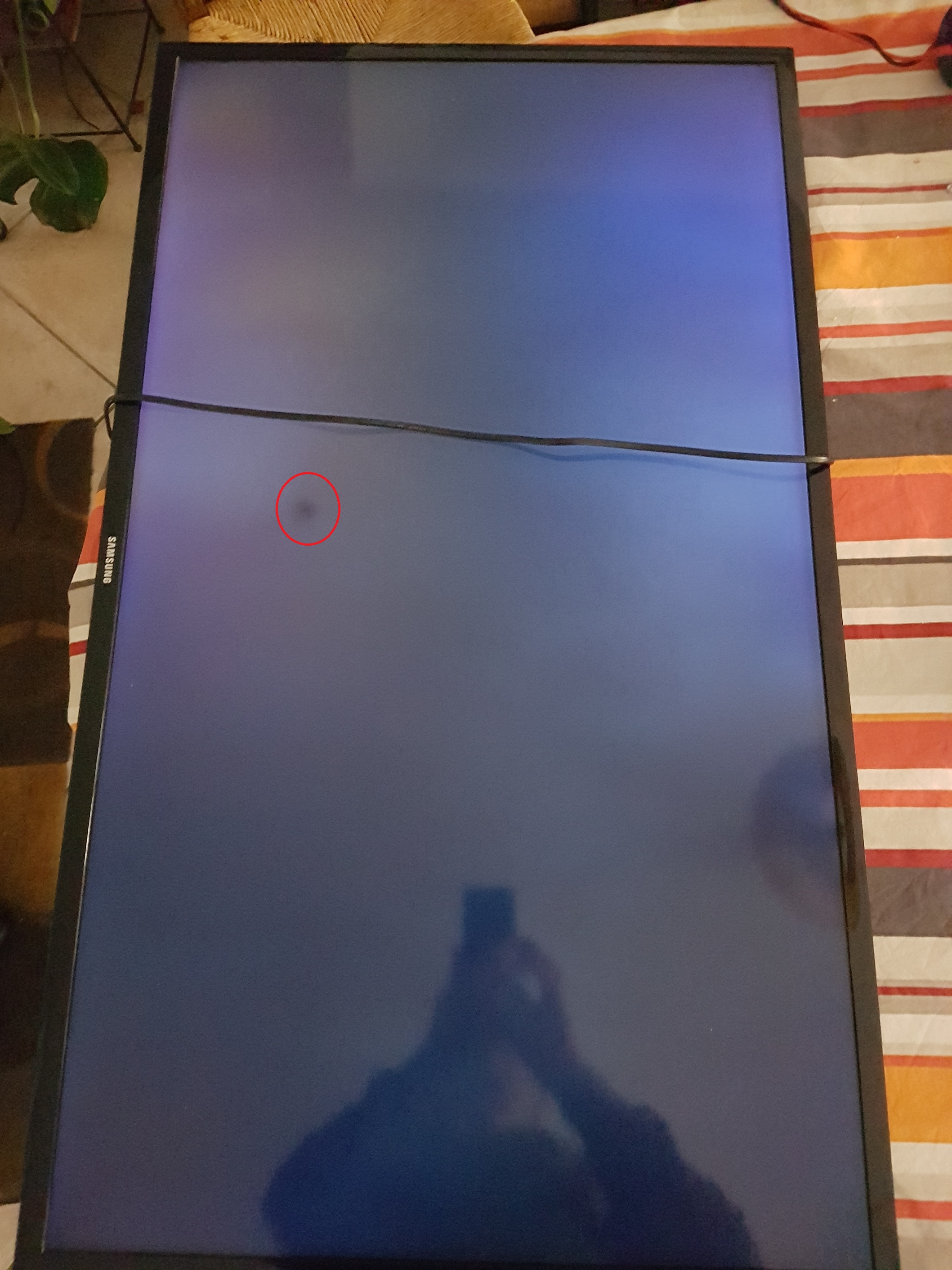

      I made your test and backlight is on, as you can see on pictures.
      However I noticed a small black round on the screen (circled in red on the photo, the other shadows are myself and a lamp), but since this is an edge LED backlight, I don't think it comes from a LED failure ?
      EDIT : maybe the circle shadow come from a small plstic piece that falls under the matal plate (you can see a high light spot where the piece was placed)
      Tell me if you need more pictures.
      Aurelien
