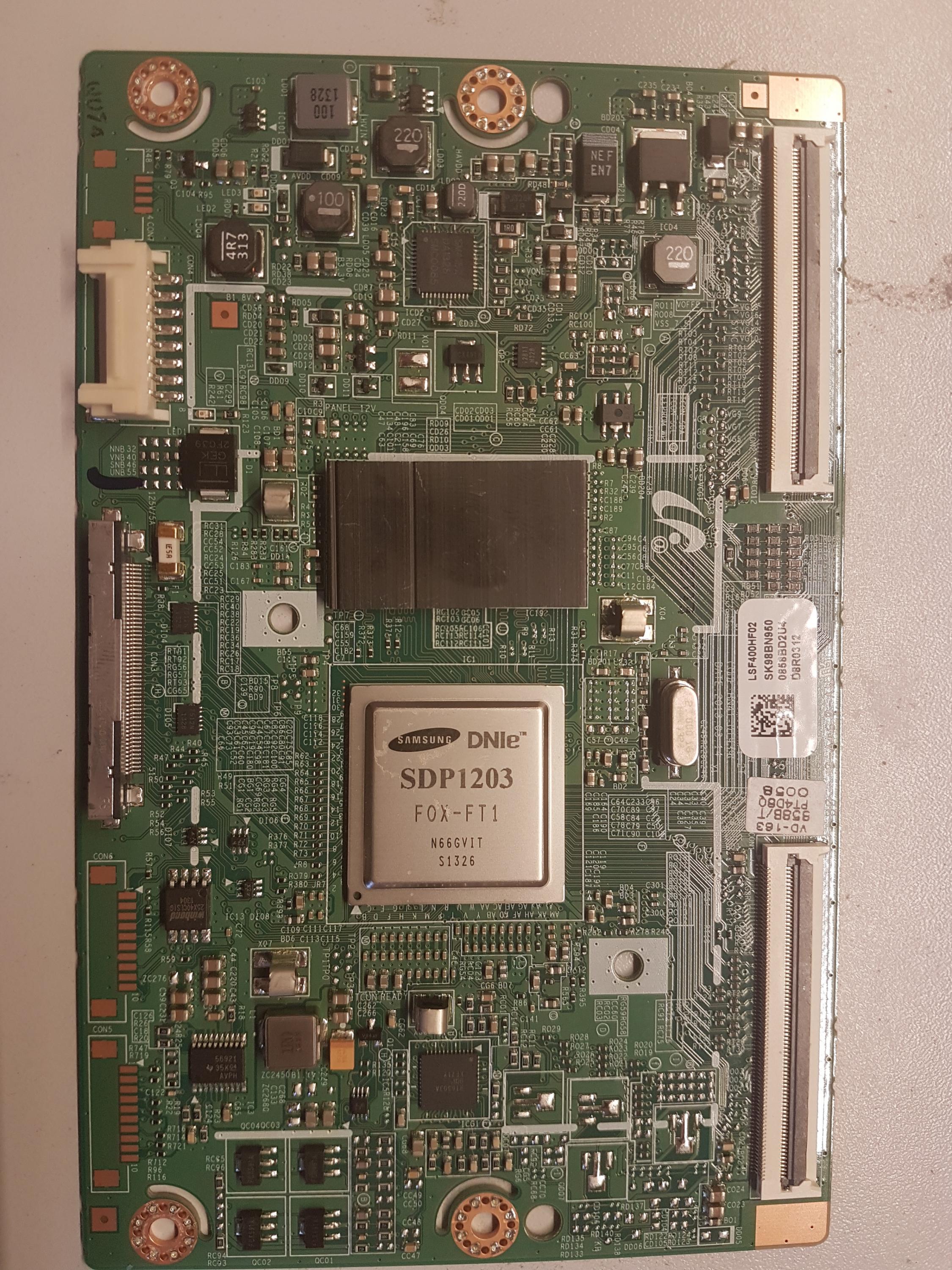

    No picture, no backlight....but sound works and I ear I can scroll into the menu with the remote...

          I check the tantalum caps (that often fails by creating a short), the black one on the top (marked NEF/EN7) is in shortcut. I could unsolder it to check if this is really the cap of another part that is in shortcut...

            In a previous post I said that The LED3 was off and on the PCB I see that it is connected to the AVDD plane. It's likely that the cap I measured in short is connected to this plane, explaining why LED is not on. If fuse does not trigger that means there is either a current limiting device (but I did not detected any overheat on any component), or simply that the AVDD power is disabled in software for any reason (short protection for example).

              I ordered a new cap, I will test it tomorrow...if nothing change, I will try to find a replacement board...

                    I have unsoldered capacitor, it is not in shortcut. But on the board I measure a resistance of approx 3 ohms between AVDD and GND. Since you told me I should read about 12V on this plane, that would represent a 4 amp current, I don't think it is a normal current for this board (especially if it comes from the LVDS cable) !
                    I think I have found a Tcon board for repairing for 30 euros, I will try...

                        I changed the Tcon...still no change, same bug....

                          It's so sad.. maybe this Tcon has something new from older ones that i don't know, maybe some voltages on tcon lacks due to no colour data and/or i2c comm sent from mainboard?

                            Not 100% sure of new Tcon functionnality, was sold as functionnal but I can't be sure (only 40 euros on ebay).
                            The screen is really blanck since, as I said before, I cut one of the PWM line of the cable between MB and PSU, so that the internal pull up resistor on the PSU force one part of the backlight to be on (and it works, but nothing displayed).
