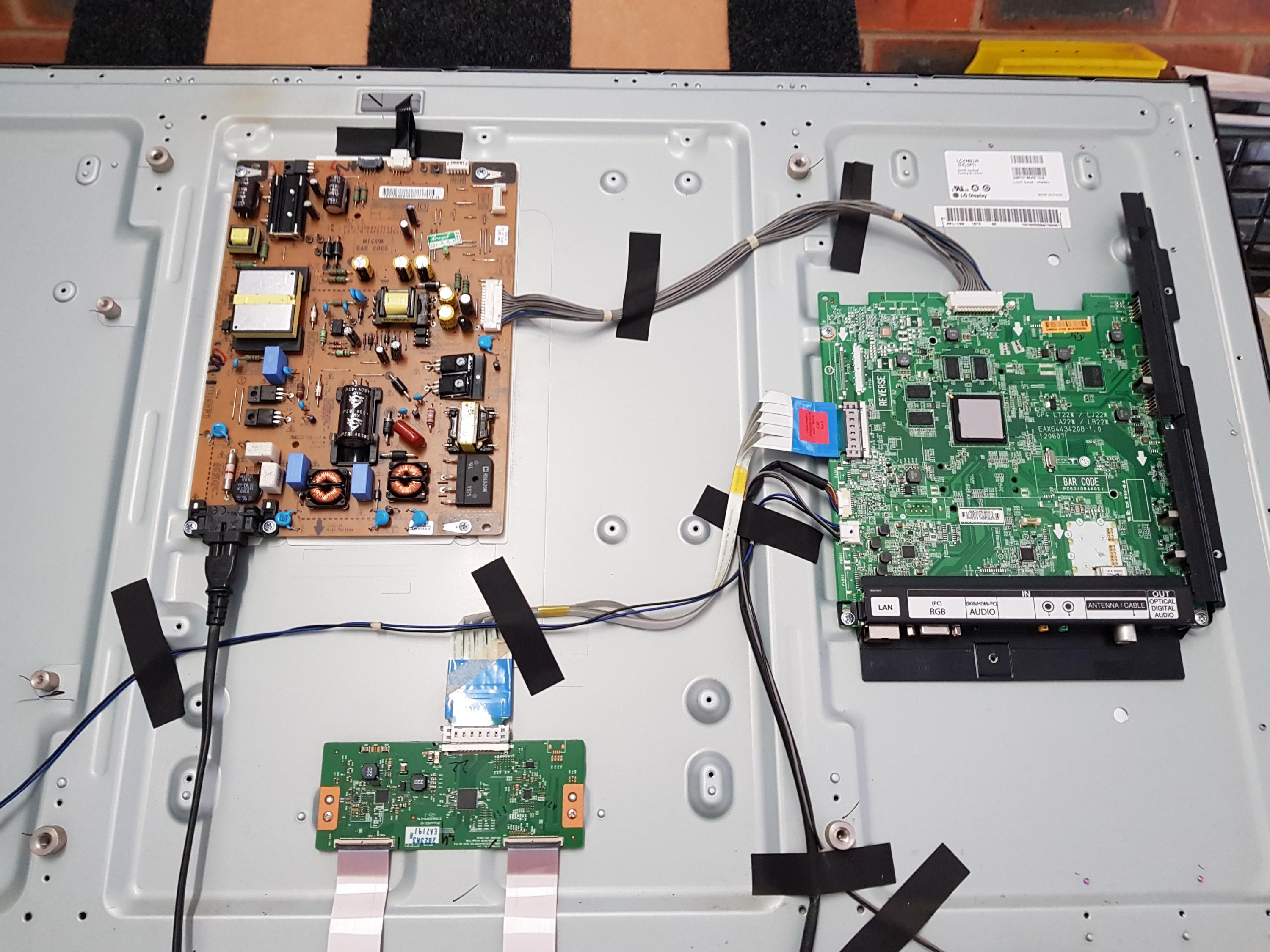

        We also need the pictures of the whole backside of the TV showing all the boards.

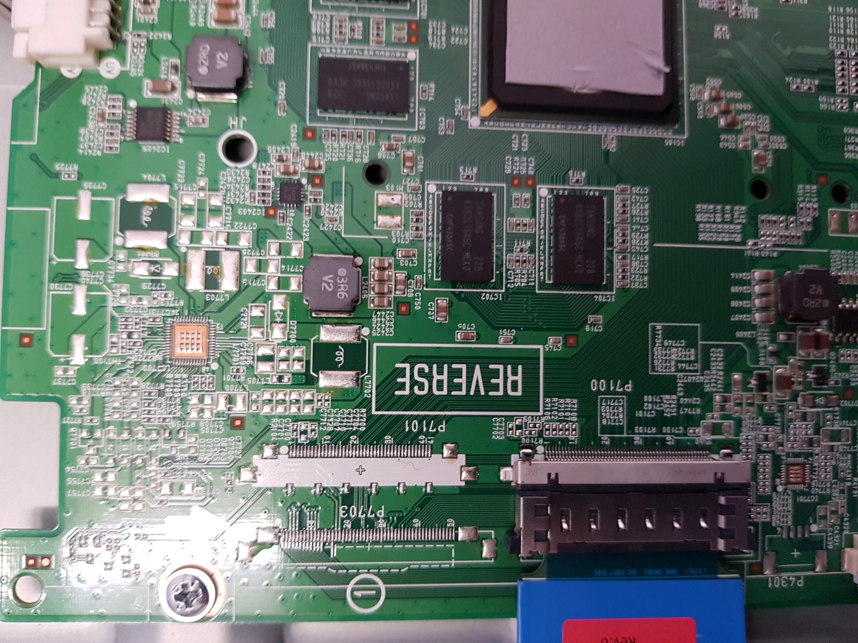

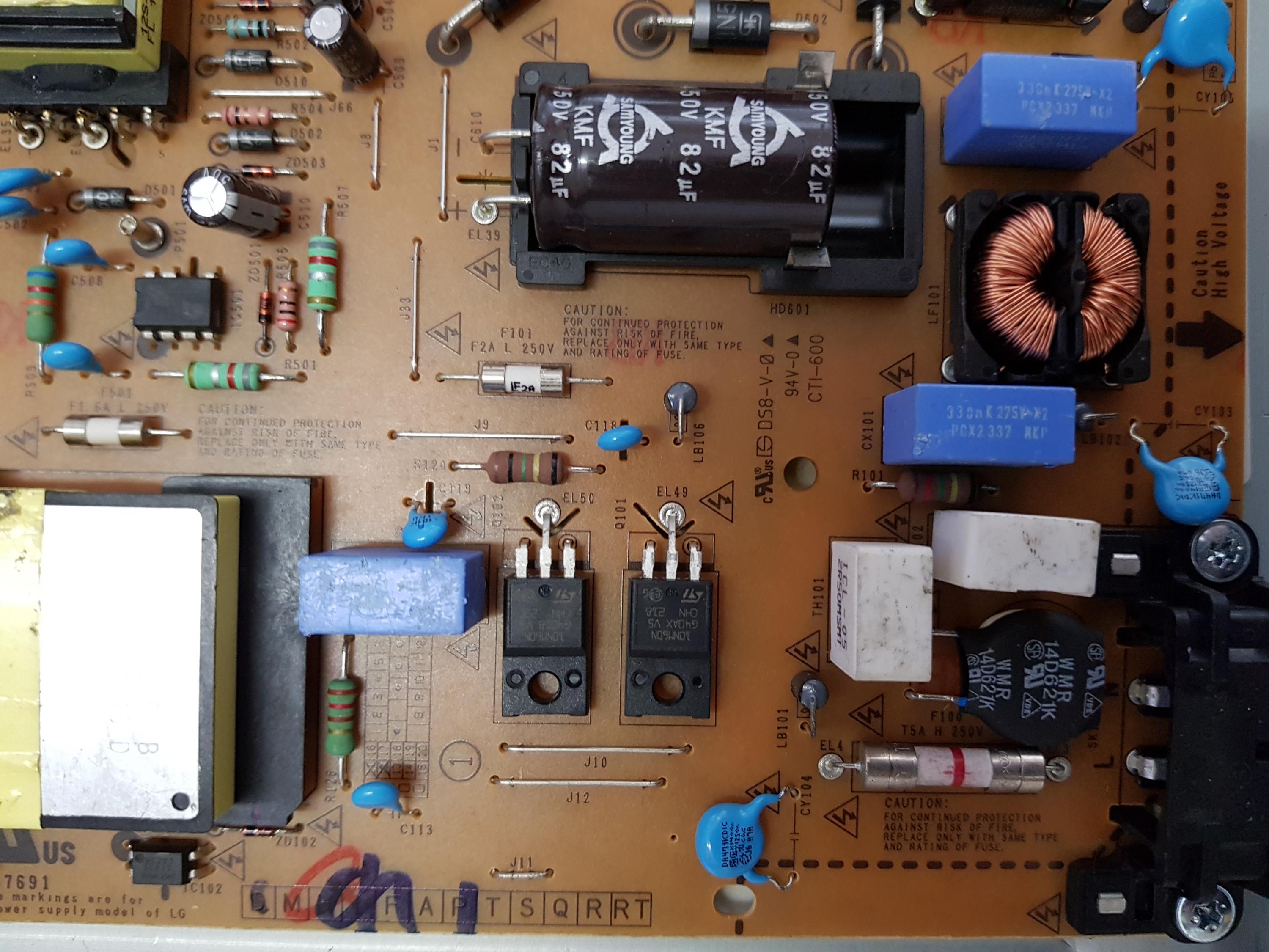

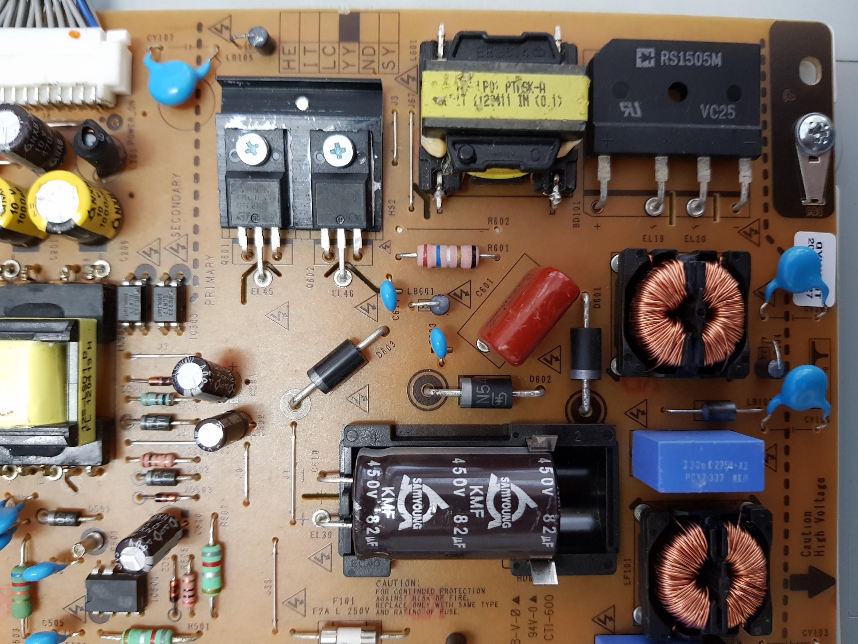

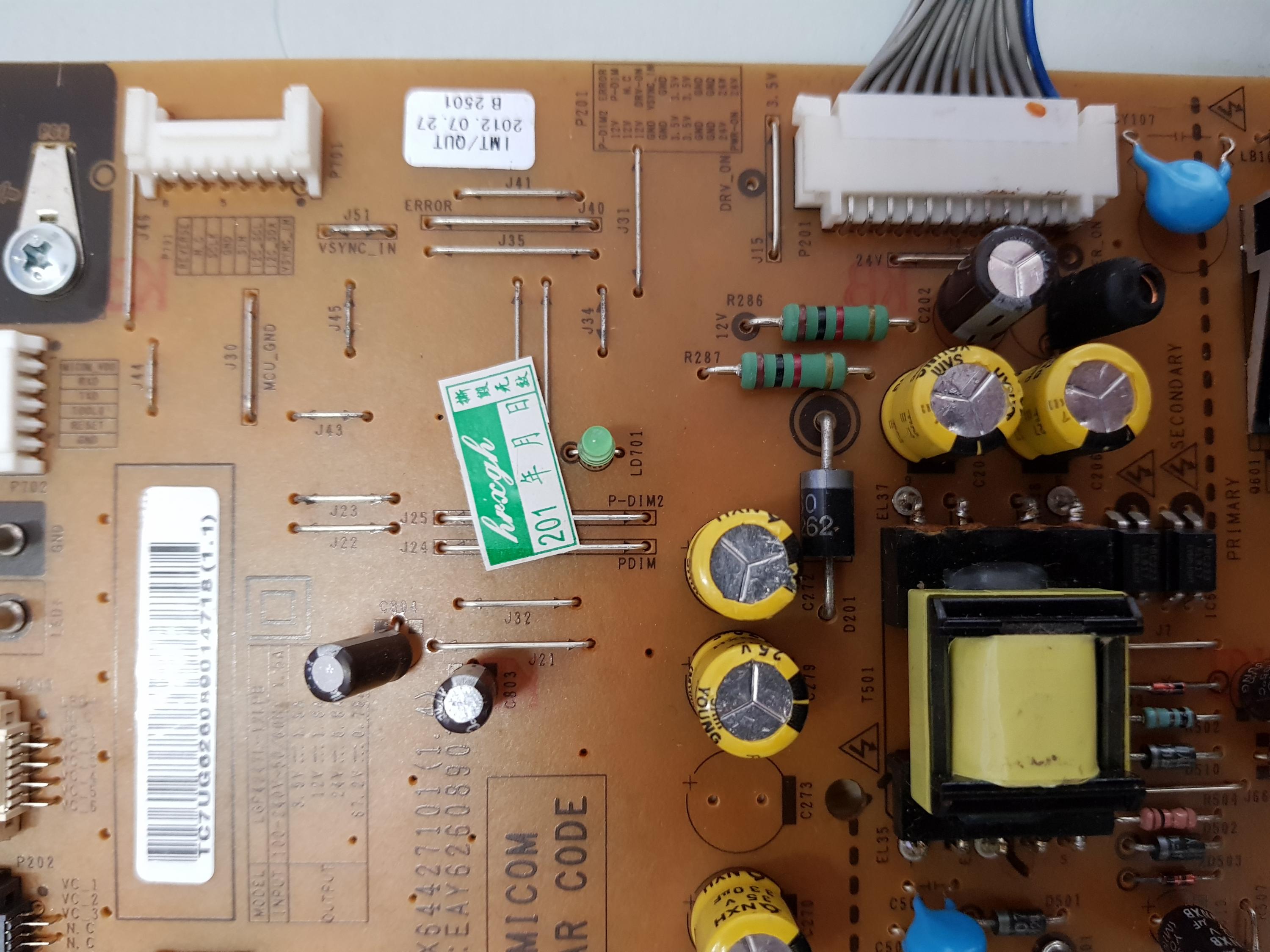

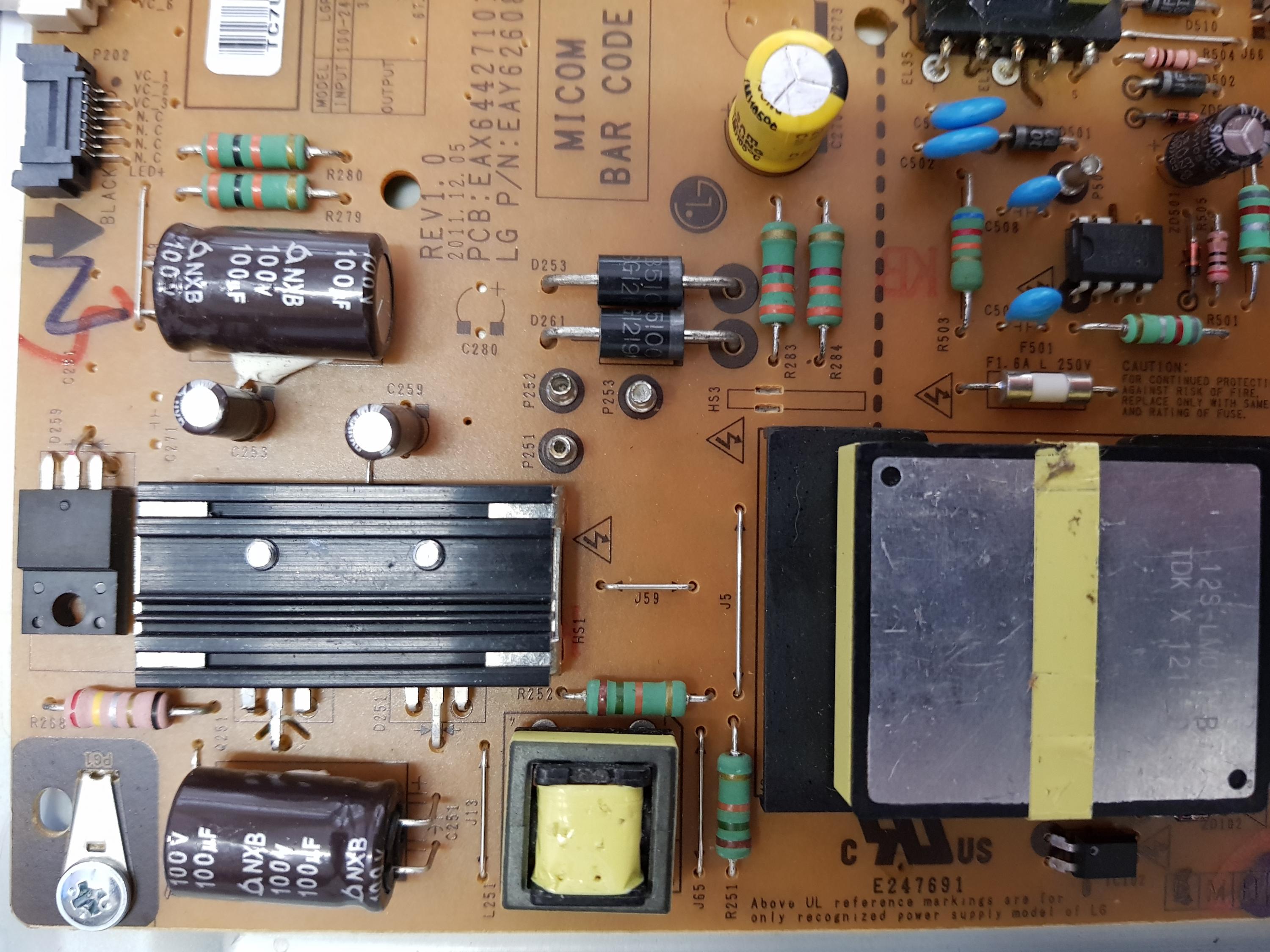

              Back in the shop and am including pic's of the boards as requested. Have included the pics in segments so visibility will be accessible.

                  Hi Guys , thankyou for your kind assistance as per requested please find attached pictures of the rear of tv and the boards in question
                  please refer to previous posts on issue with Standby power supply circuit not switching on the tv
                  Have checked the Main PSU board connector {P201)
                  have the following voltages on the following pins
                  Note pin 1 is the blue wire bottom to top (pin 12) of connector on back of connector
                  Sorry dont have voltages on bottom of board at this time

                      Per picture,
                      Pin 1 is the PWR-ON PIN, not PO. that is the PS-ON pin.
                      Pin 3 = 24V
                      Pin 5 = GND
                      Pin 7 = GND
                      The exposed pins that you can see from the top side board are ODD number pin, the EVEN number pins, you will have to use probe with skinny tip to probe from the back side of the connector where the wires go in.
                      If you are getting the switched 24V and switched 12V then the PS-ON is working, but at this point we need the Voltages of ALL the pins.

                                Re: LG 42LV5700
                                Please find attached Photos as requested
                                ON a NOTE i have noticed a discoloured brown area on the top of the back of Panel and all so under the PSU board where it is mounted
                                Could this have been a possible liquid spilled in to it EG COFFEE STAIN view Photo zoom in or is it just Burn hot area from board
