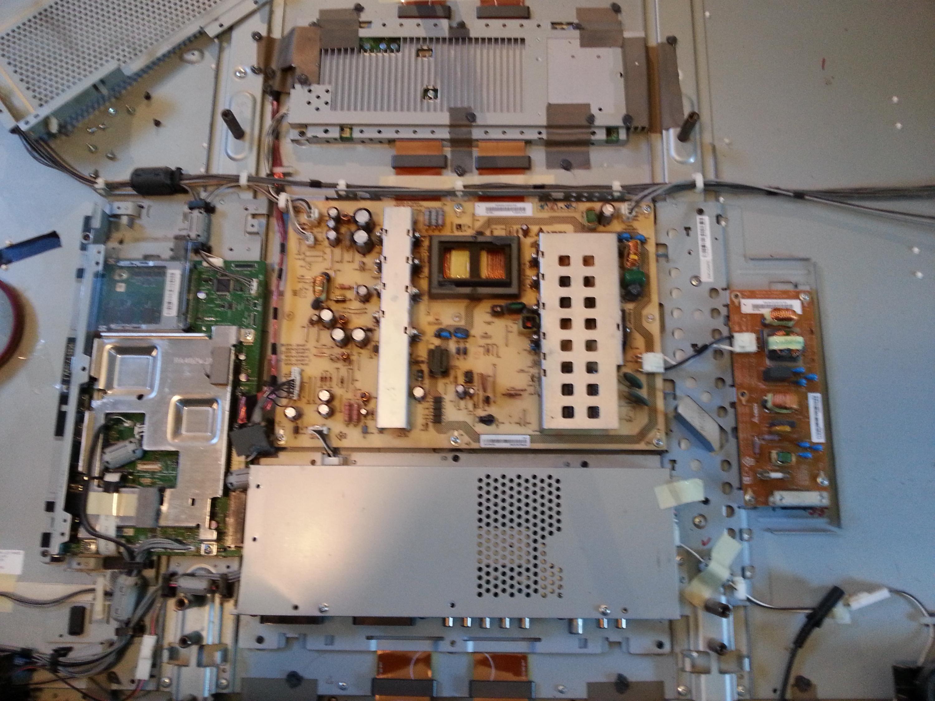

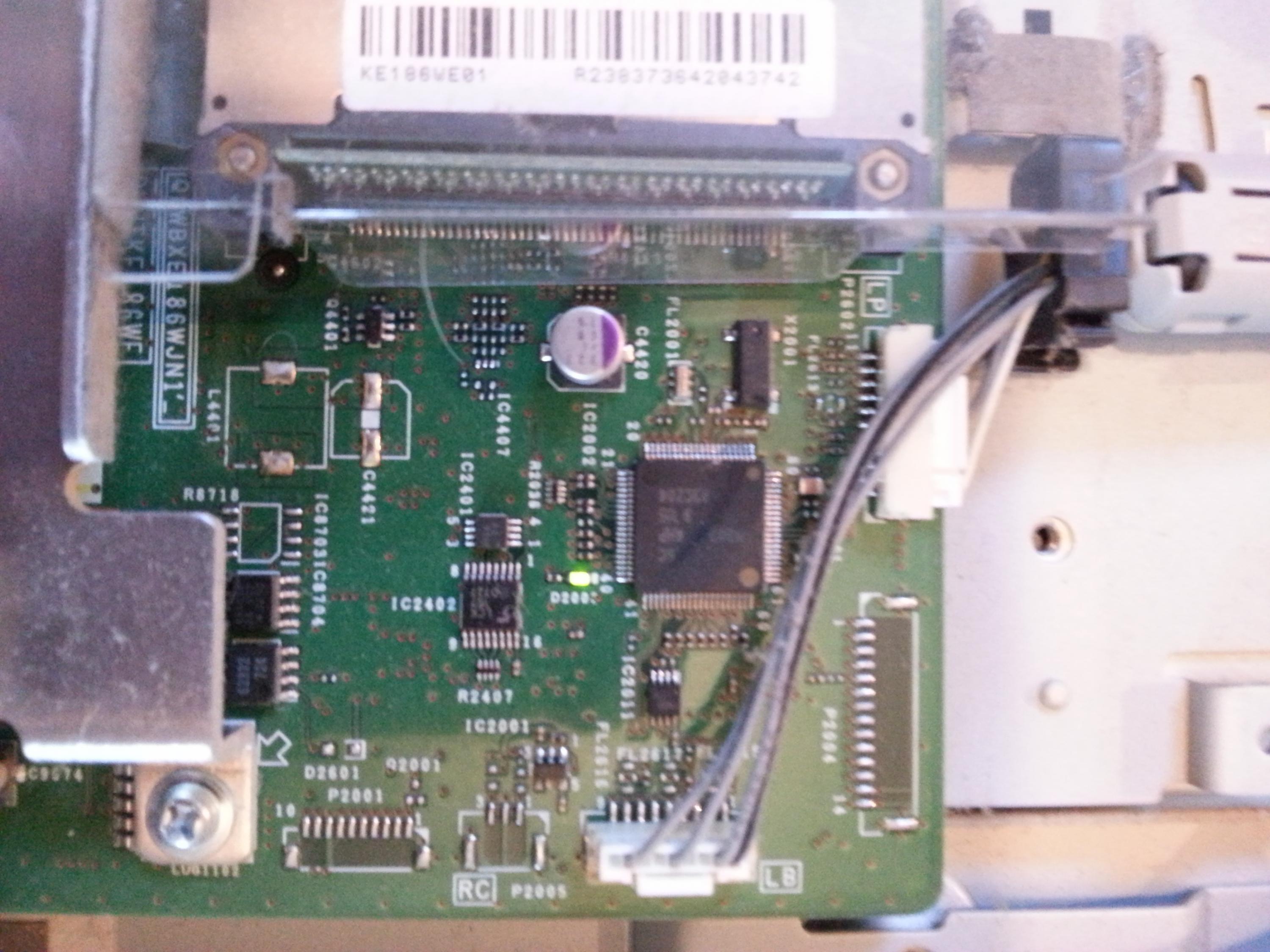

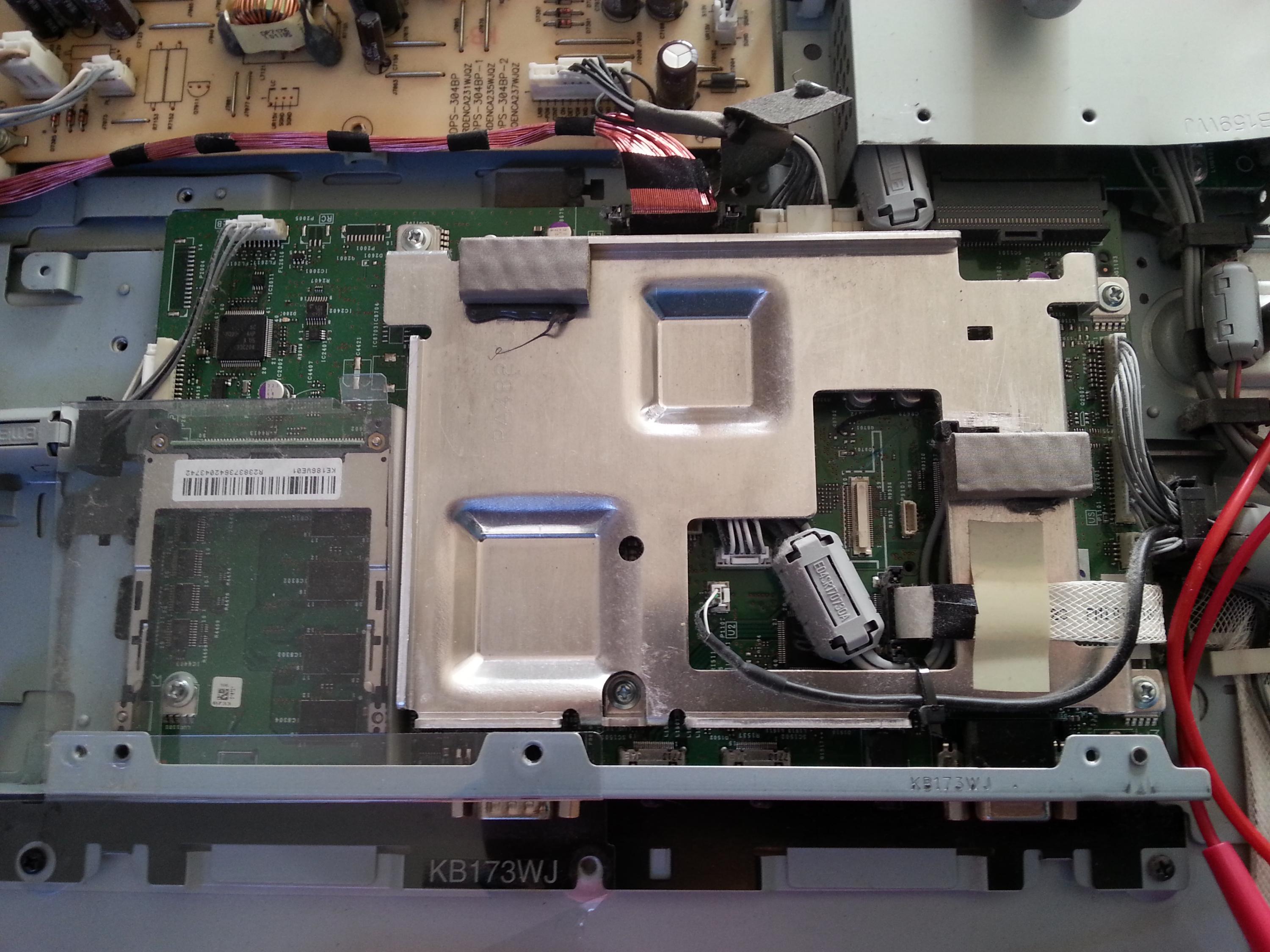

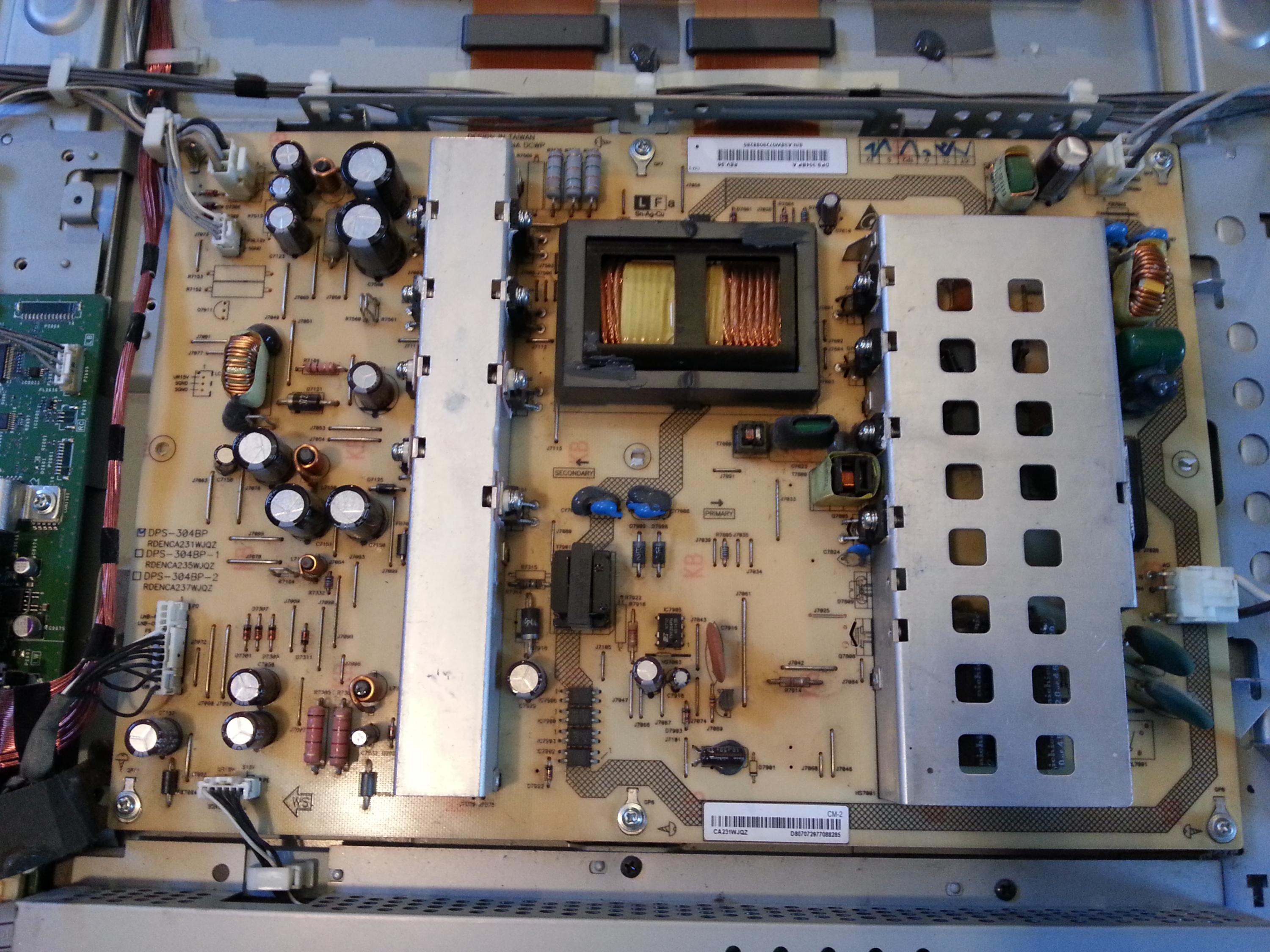

                    #29
                    Re: sharp aquos lc-52xl2e wont power on
                    opened the cover on the main board and found a green light on the main board it flashes for 5 seconds when i plug tv in then stops see picture attached added some other pictures too
                      I should add the tv does come on briefly 5 seconds when plugged in

                                    #37
                                    with tv unplugged unhook cable from powerboard to mainboard, leave it off, plug powercord back into powerboard, retest and see if voltage is steady, will probably only get standby and acdet.

                                          #40
                                          Ok, you have a problem with powerboard, you will need to fix the standby voltage or get a new board.
