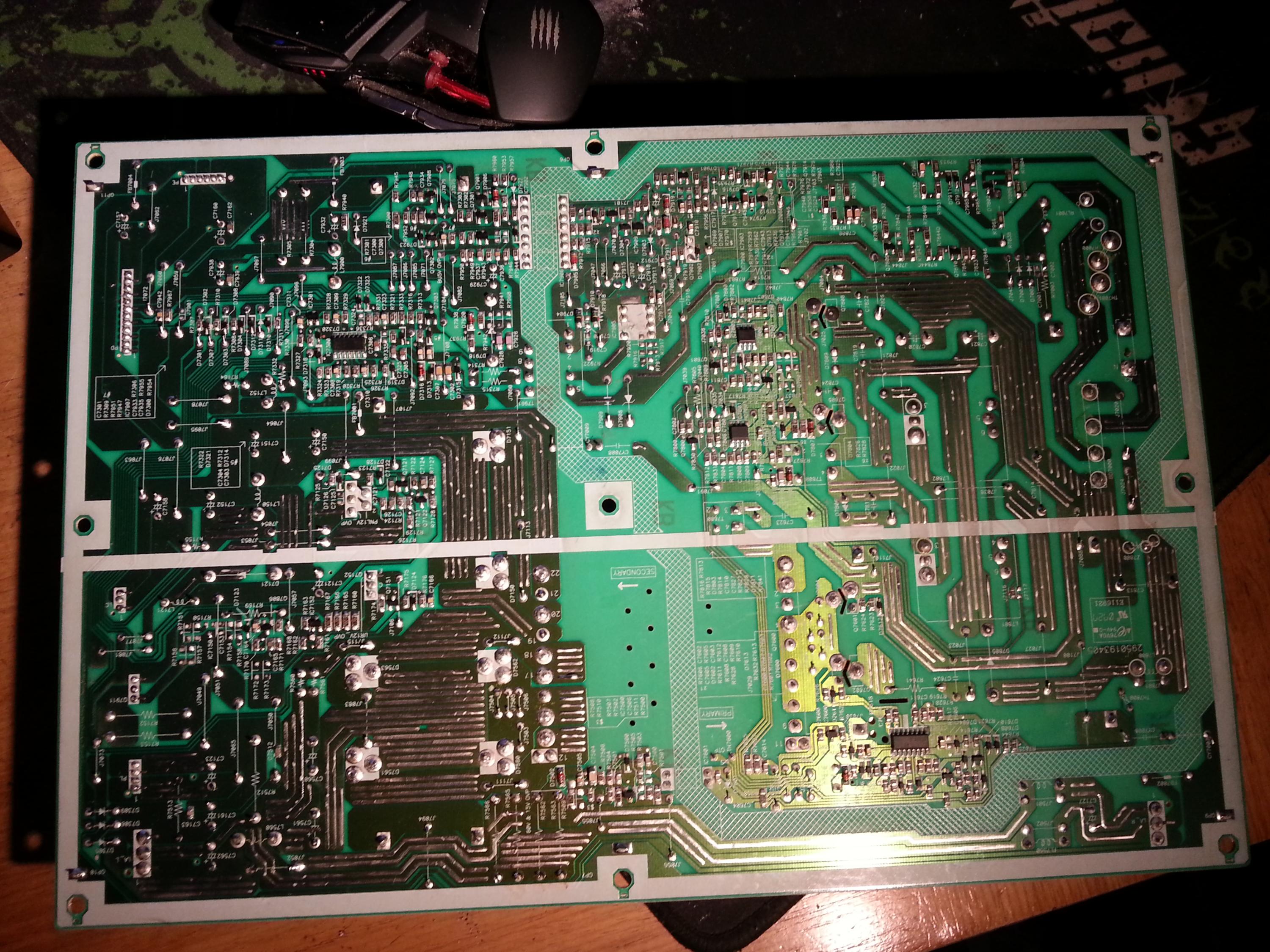

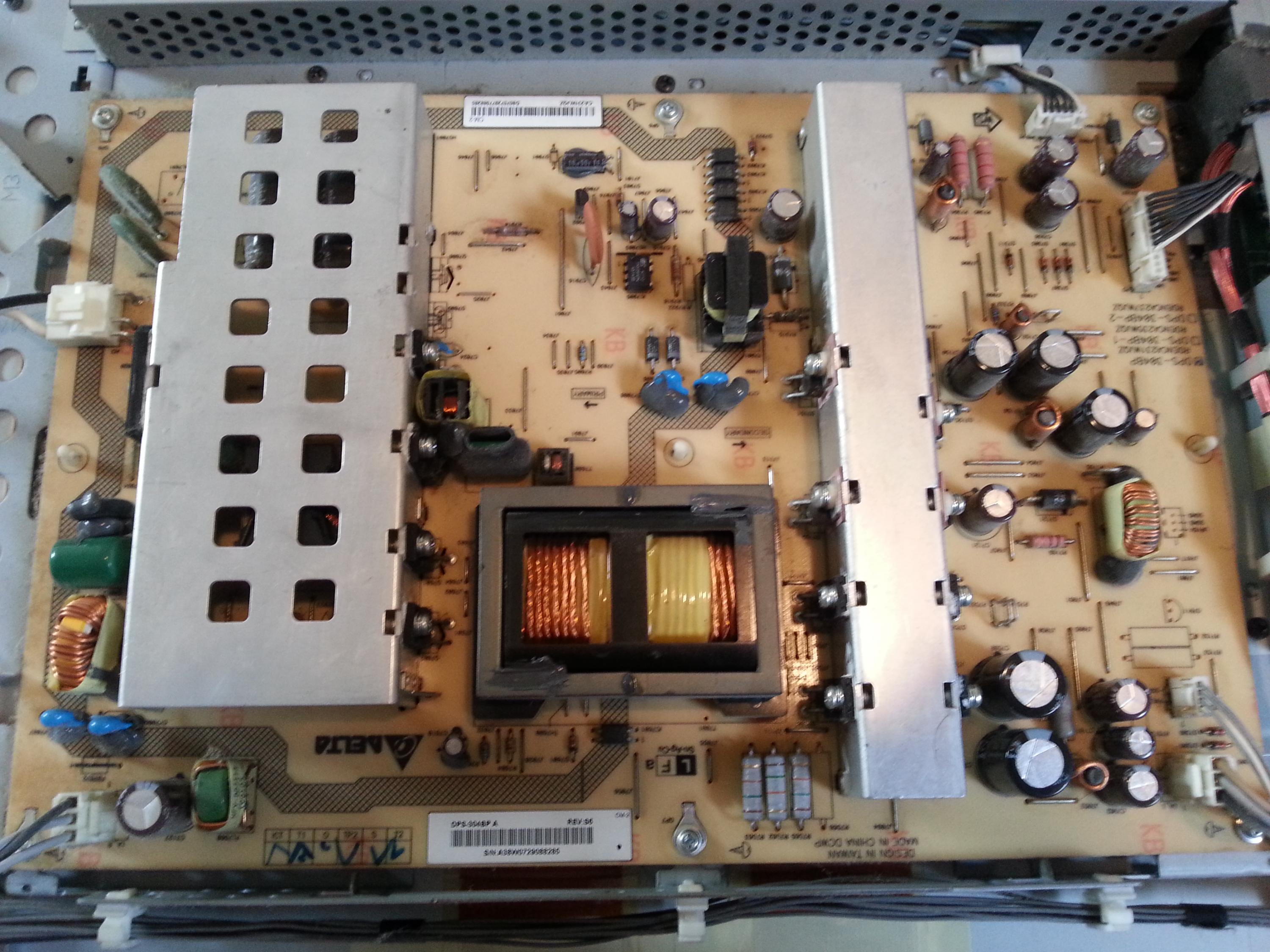

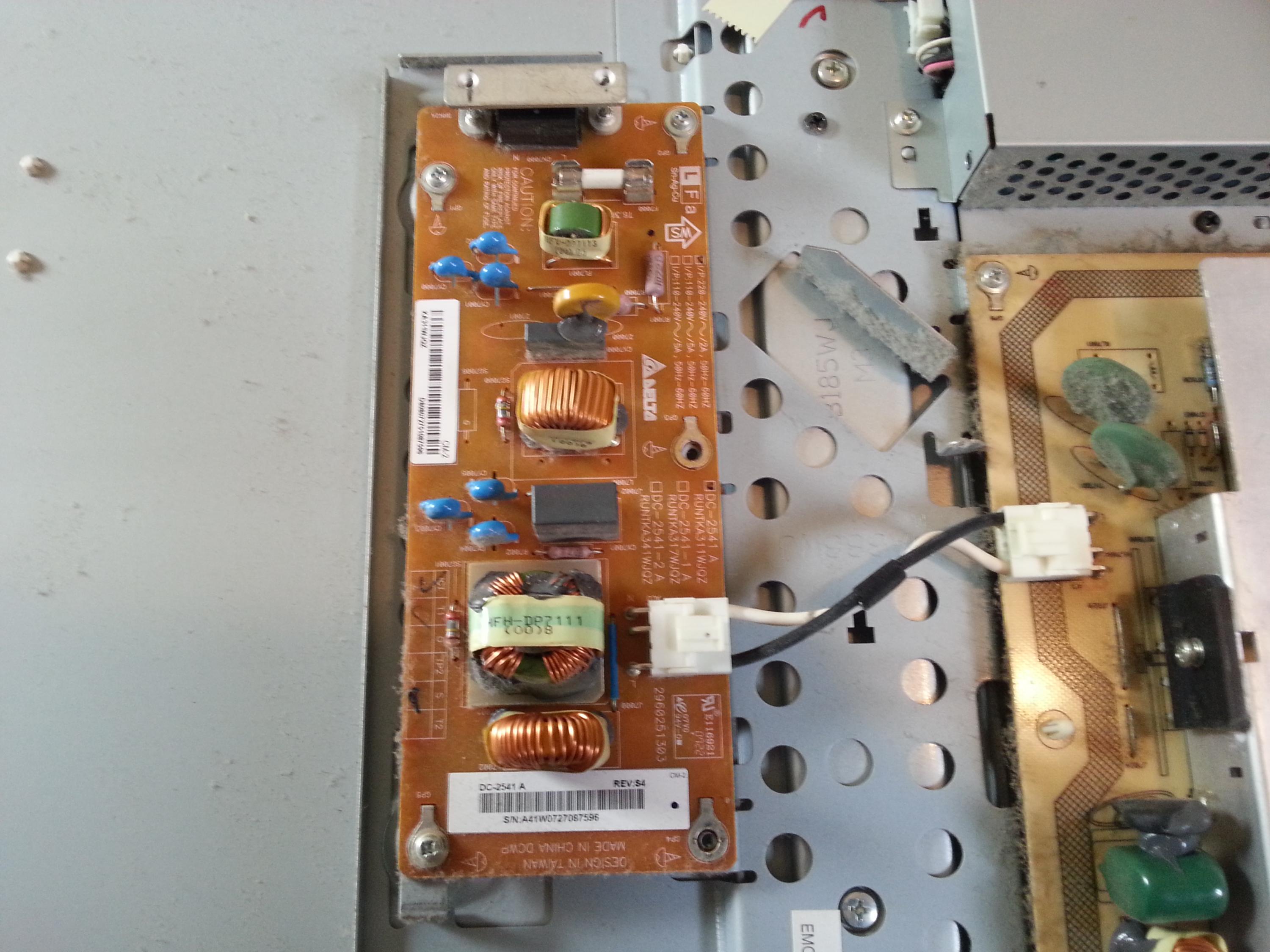

      here are a couple pictures could you point out what caps you mean please
        Re: sharp aquos lc-52xl2e wont power on
        i took the main board out to look at the back as no access to the bigest caps from the front

          The main Filter cap/s would be the large ones under the metallic shield in pin #1.

            What you need to do first is to report the DC Voltage readings of the connectors on the cold side, you MUST report in the format that shows the pin name and follow by the Voltage reading in TV off mode and when TV is turned on.
                https://www.badcaps.net/forum/attach...0&d=1509540477
                See that wide white hatched line in the middle of the board?
                The right side is the HOT DEADLY SIDE that you do not want to make any contact with your body, the left side is the cold side.

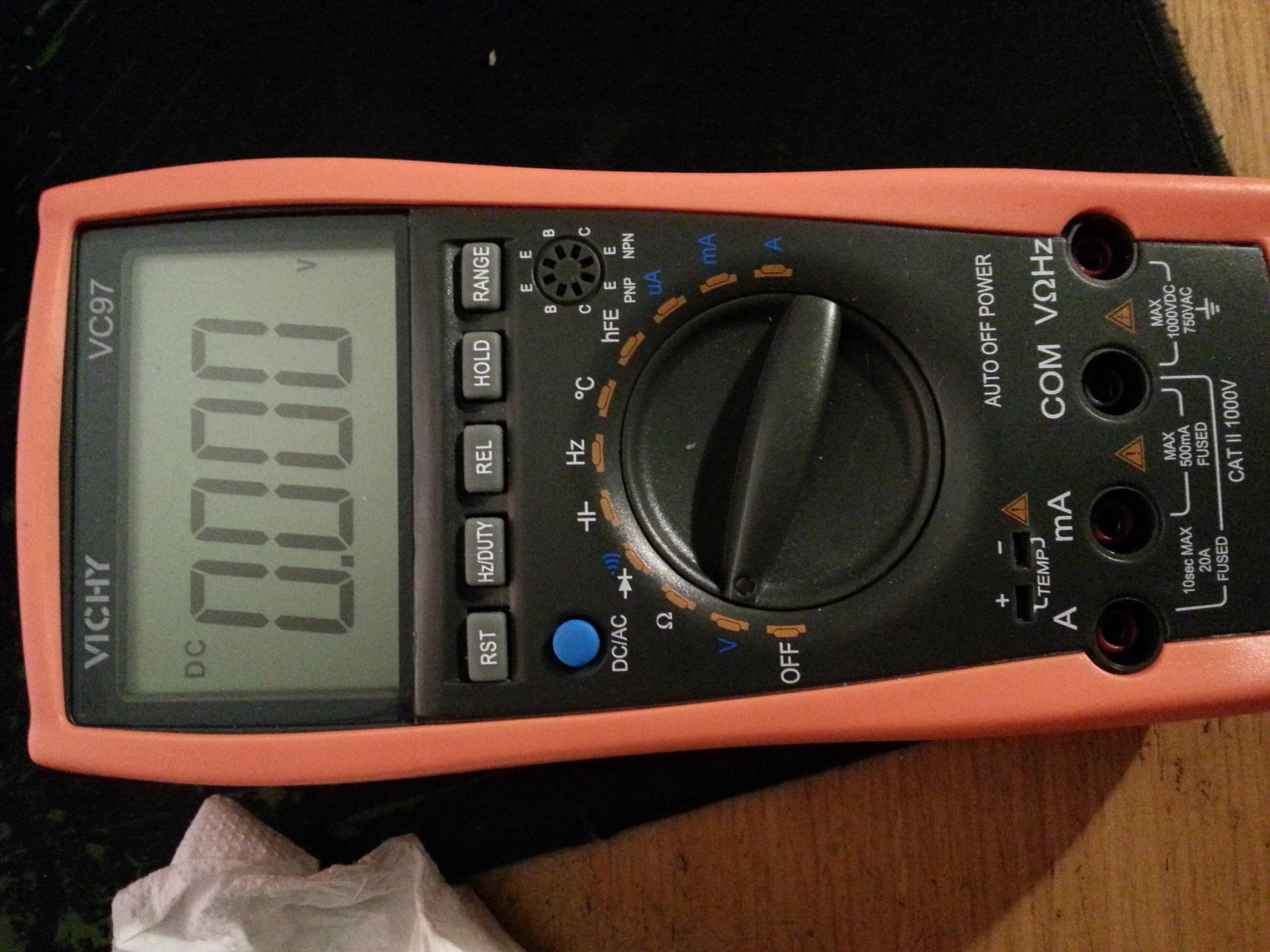

                                  Are you sure your meter has DCV scale setting for '0.000' DCV scale. Why would the meter have '0.000'V scale??
                                  Typical scale is 200mV, 2V, 20V, 200V, etc,
                                  You are getting 'OL' showing on the meter because it went over the scale for the meter to display.
                                  Show us the pictures of your meter.
                                  Just run the power supply board by itself and then check the 5V standby.
                                    heres the meter and the setting i used
                                      OK, your meter can be set to Auto range or manually set to the range you want by using the range switch.
                                      So set range to 00.00 and then measure the STBY 5V without power supply board connected to the main board.
                                      You have 5V STANDBY, otherwise you will not have any LED indicator.
                                      I just look at the user manual, you do not have it set to AUTO, you are in the 3.999V scale that is why 5V is showing 'OL'.
                                      '3) The default range is Auto range, and "AUTO" is displayed. Pressing RANGE key
                                      switch to manual range, 400mV/4V/40V/400V/1000V can be selected.'
                                      'Display: 3 3/4digit LCD with a max readings of 3999'
