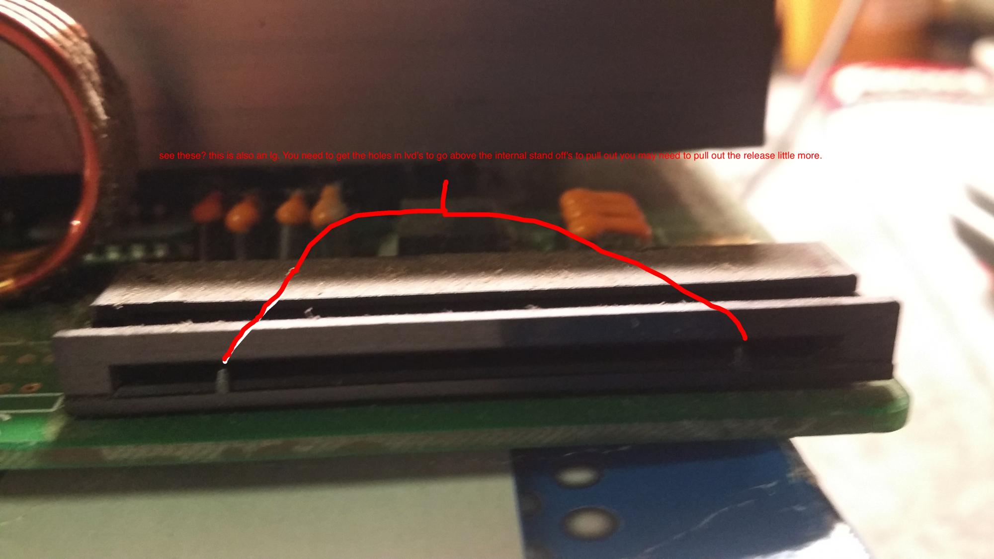

                Is there a trick to removing the ZSUS screen cables? The YSUS flipped up and they popped right out. This connector has pulls out but it seems like too much force is needed to disconnect those screen cables? I definitely do not want to damage these.

                  Re: LG 60PB5600 Turning Off
                  z sus usually have a pull out clip rather than lift up. once clip is pulled out till it stops you have to very very careful removing them as sometimes the 2 holes in lvd snags on the 2 little standoff inside connector this can be done by lifting up carefully on lvd as you pull at same time with little wiggle. But don't force.

                      I will have to try to find a youtube video. These cables are a real pain in the butt. You can feel them move in and out as they are loose once the connector is pulled out but they will not pop out.

                        That is because the 2 holes in lvd is snagging on standoff inside connector you have to lift lvd up and pull and very slight wiggle at same time but don't force it either. it can be tricky.
                        but not much wiggle if you wiggle too much it can rip the lvd from glass then it's game over.

                            some are to be lifted up some are to be downwards depends on where the internal standoff are inside connector. my bad.

                              I saw the video but the tech in the video has no issues with the cables. They seem to pop right out and mine will not. I have tried gently pushing down and pulling up to no avail. Anyways, I just bought a new ZSUS off of Ebay. Hopefully, I will have these cables figured out before it arrives...lol.

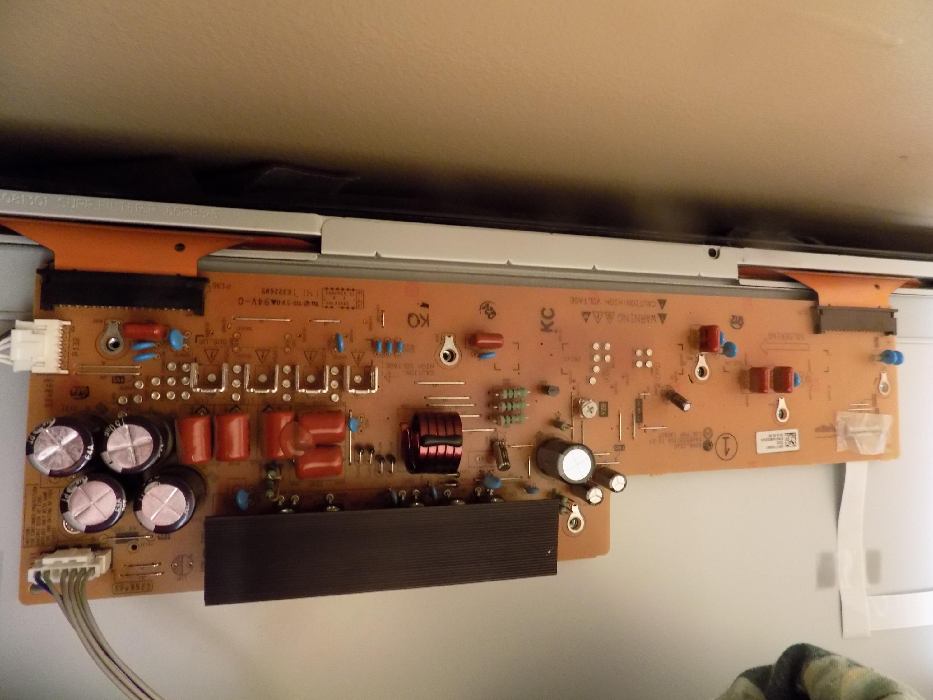

                                    Here is some pics. All I can say is that the video that shopjimmy did made it look like a breeze just like it was when I removed the YSUS cables. My experience with these ribbon cables are quite different...lol.

                                      Here is a photo of my lg and it should be the exact same way as yours and even same color connector. instructions in photo may need to zoom it.

                                        Finally got around to getting the new ZSUS board in(Thanks for the pic it was helpful) and building a dim bulb tester as suggested.
                                        The TV still will not stay on. With the power running through the Dim Bulb Tester(DBT) the sound will come on with no picture as before- if the YSUS is disconnected from the ZSUS. Once I connect the YSUS the bulb(100W) glows brightly flickers and then a clicking noise from the power board and this cycle continues.
                                        I built the dim bulb from the specs at http://doktorsewage.com/tools-of-the...-bulb-limiter/ if that is of any importance.
