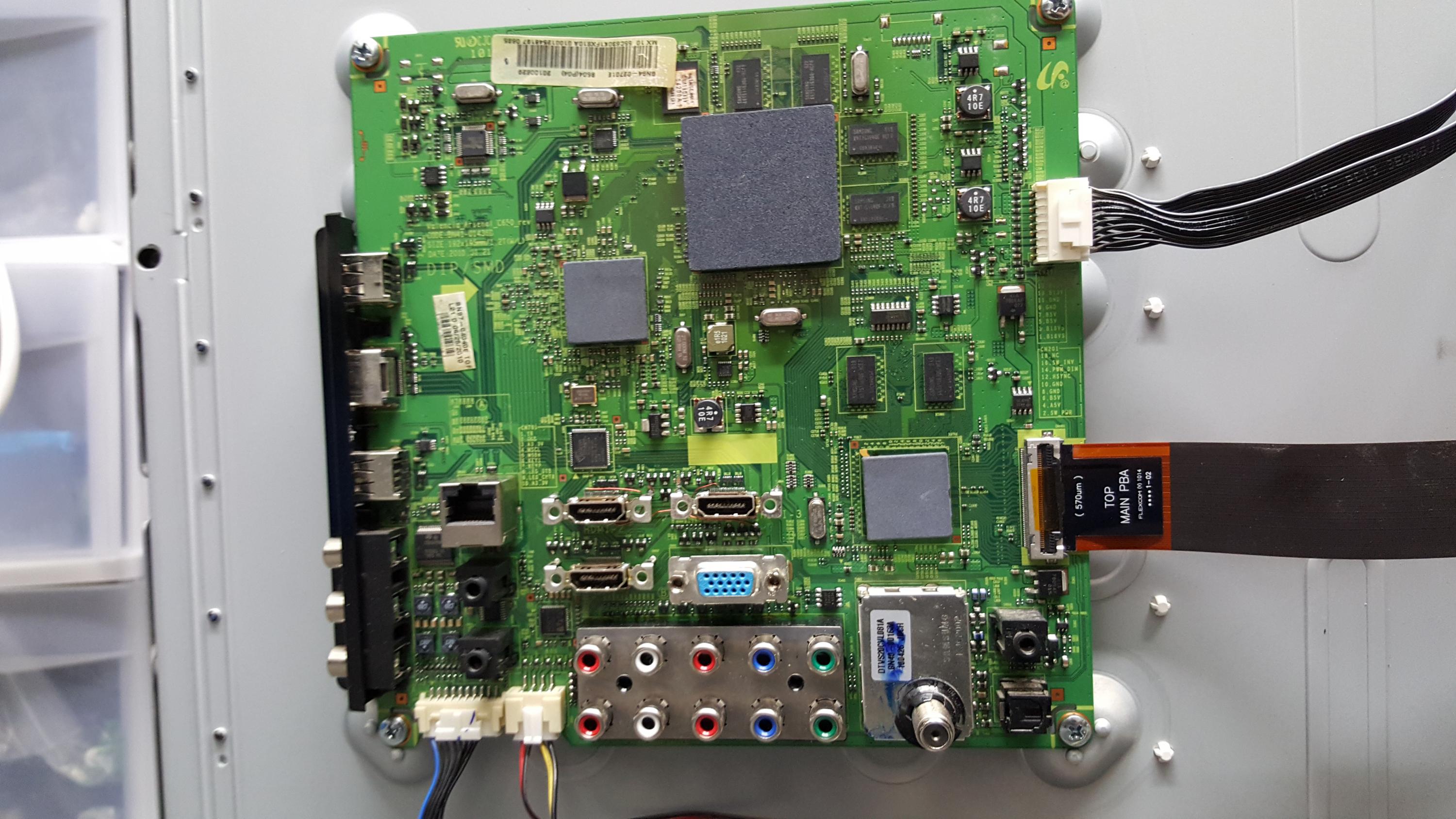

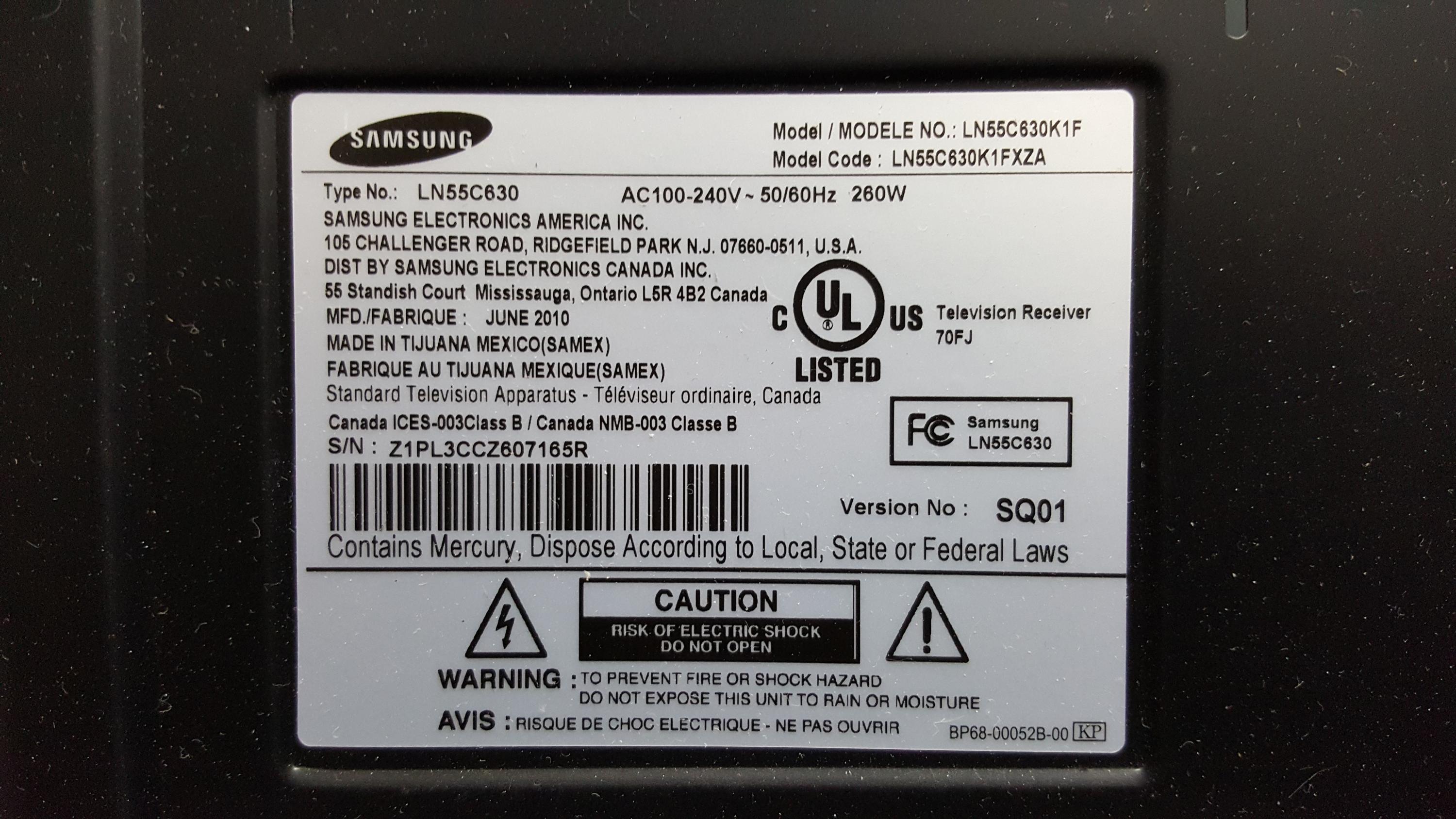

    I have this TV where the HDMI ports ripped off the board. There are so many damaged traces and pads I don't think it will last. I also had to use the old ports.
    I cannot find a board with the same part numbers anywhere. Is it possible to use a similar board and swap some chips out to get it working with this TV?
    The board has 2 stickers with numbers
    BN97-04040E
    BN94-02701E
    Board Code BN41-0143B
    Closest I can find is board from a LN40C630K1F
    thanks

    If the connectors all match up, then it should work. Samsung has used an auto LVDS setup on their main boards for quite some time and for the most part, the boards are interchangeable between LCD screen sizes and manufactures. Again, compare the connectors. Sometimes the locations & types vary with TV model even though the board is basically the same.

          I will order the board and give it a shot.
