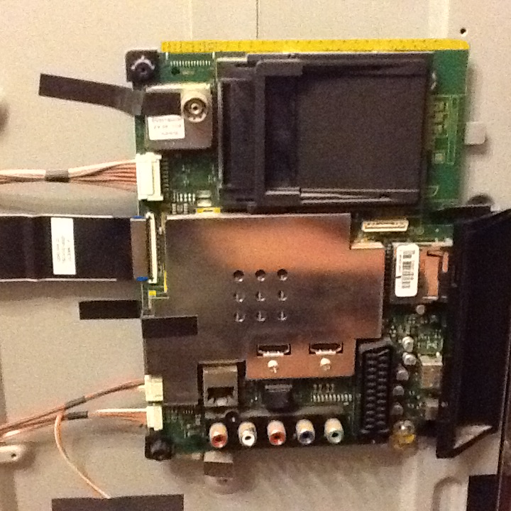

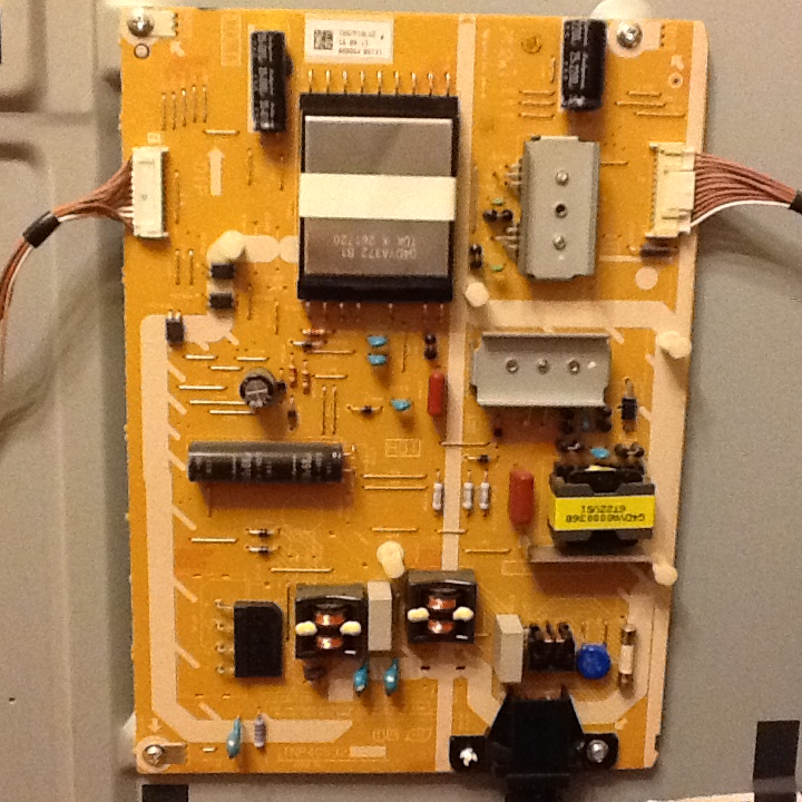

    Hi guys have a Pana with a 14 blink error code, ppl are saying it's either the power board or possibly the A board. Anyone had any luck narrowing it down as there quite expensive boards. Many thanks.
  • Norman1
    • Jun 2017
    • 77
    • Uk
    Re: Panasonic txl39em5b
    Pics
            Are all the voltages present on the power supply?
              Just an update if anyone's interested, replaced the power board, main board and t con, still giving a 14 blink error code. It's not looking good
                Can you post the voltages you have on the power supply boards alongside their names as a good starting point for people to offer help.
