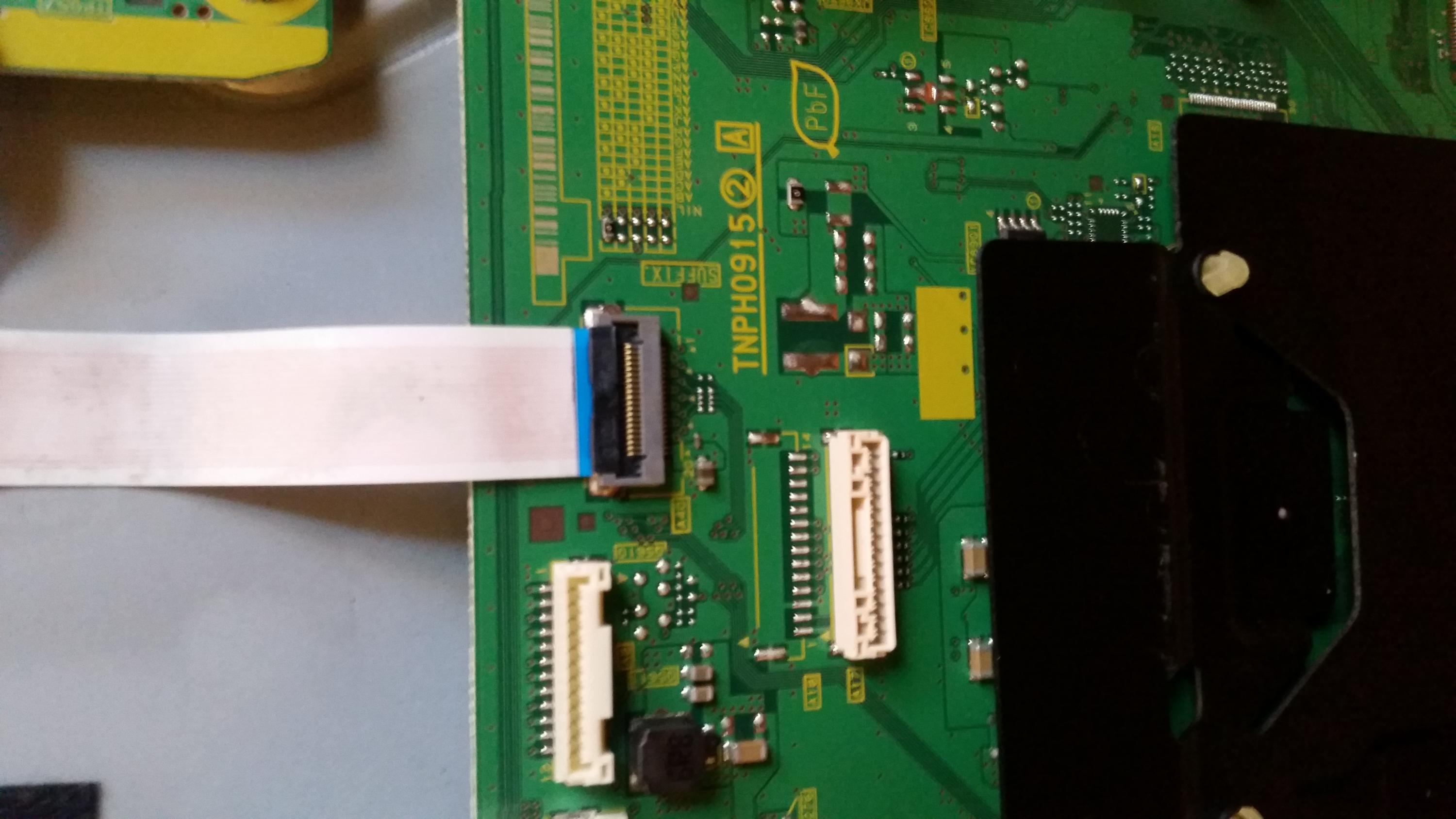

                Here are the 2 only noticeable differences I could find.

                  A8 is a fan connector.
                  Some set variants, like VT30, have fans; if A8 is present on your new board, it is expecting fans.
                  It is possible to jumper the connector A8 to disable the fan detection, but requires soldering wires to the board.

                    Ok, I see. But, if it the main board was working properly, wouldn't I now see a 11 Blink code like stated above? Would the TV turn on for a bit?
                    Right now, I plug the TV in and then I hear the first relay click, 2 seconds and the relay click again and 14 Blink Code.

                      Try this.
                      TV off.
                      Disconect, sc2, sc20, ss11, p35, and at the A board(use your original A-board)disconnect the 3 white flex ribbons.
                      Now turn the TV on, observe, turn off and report.
                      DO NOT reconnect sc2, ss11 or p35 immedaitely, there will be residual voltage. P35 goes to the panel C boards and a spike there can destroy the panel.
