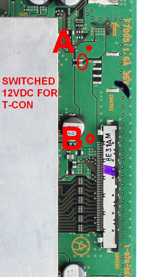

        Put all the boards back in place, turn the TV on, black probe on the chassis, red probe on point 'A' to see what you have then move red probe to point 'B' to see what you have.

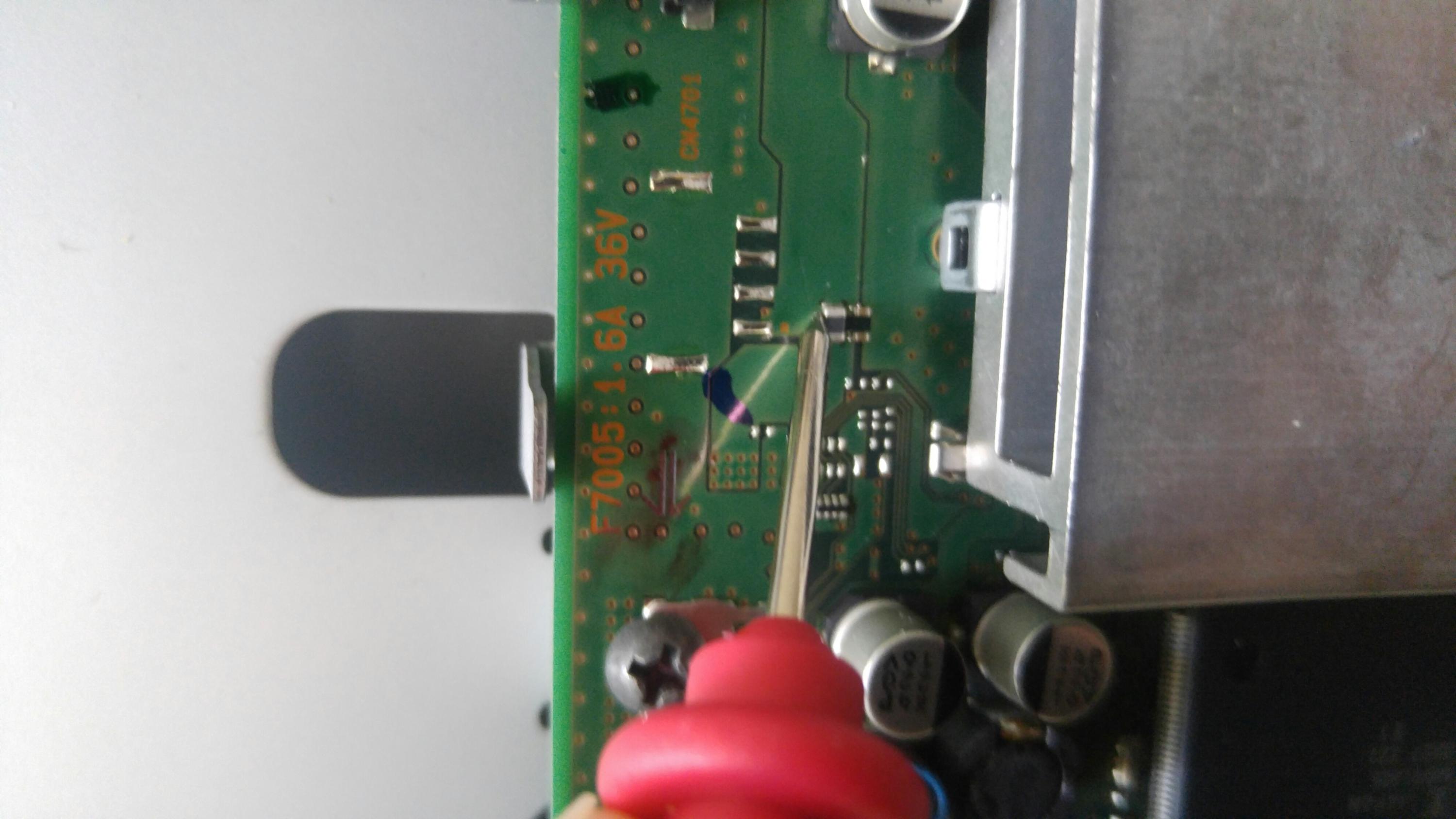

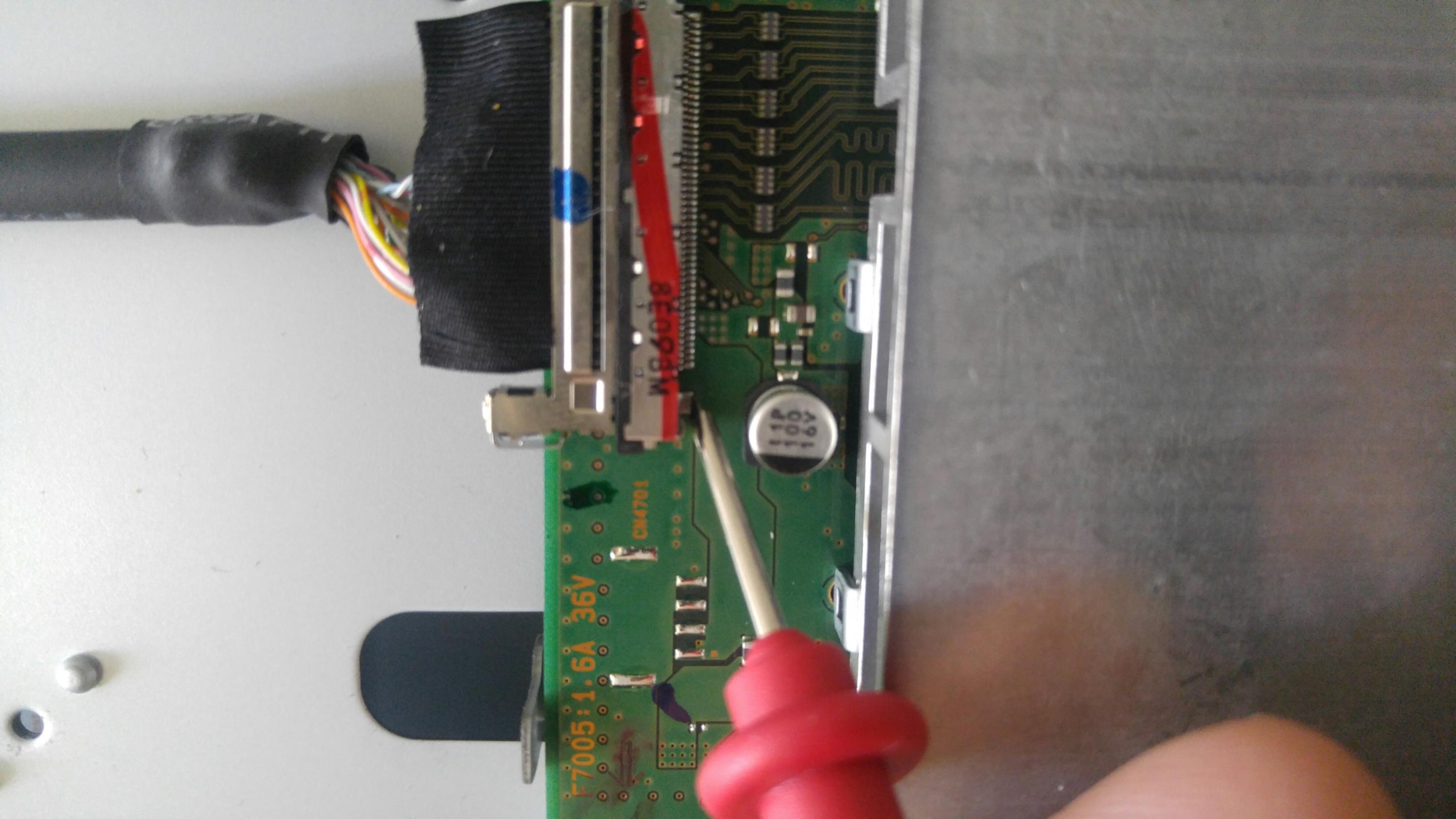

            BudM, I took readings at the two points ( A & B) you suggested, please see photos to insure I had the correct spot for the test probe. I have 0 volts at both A and B

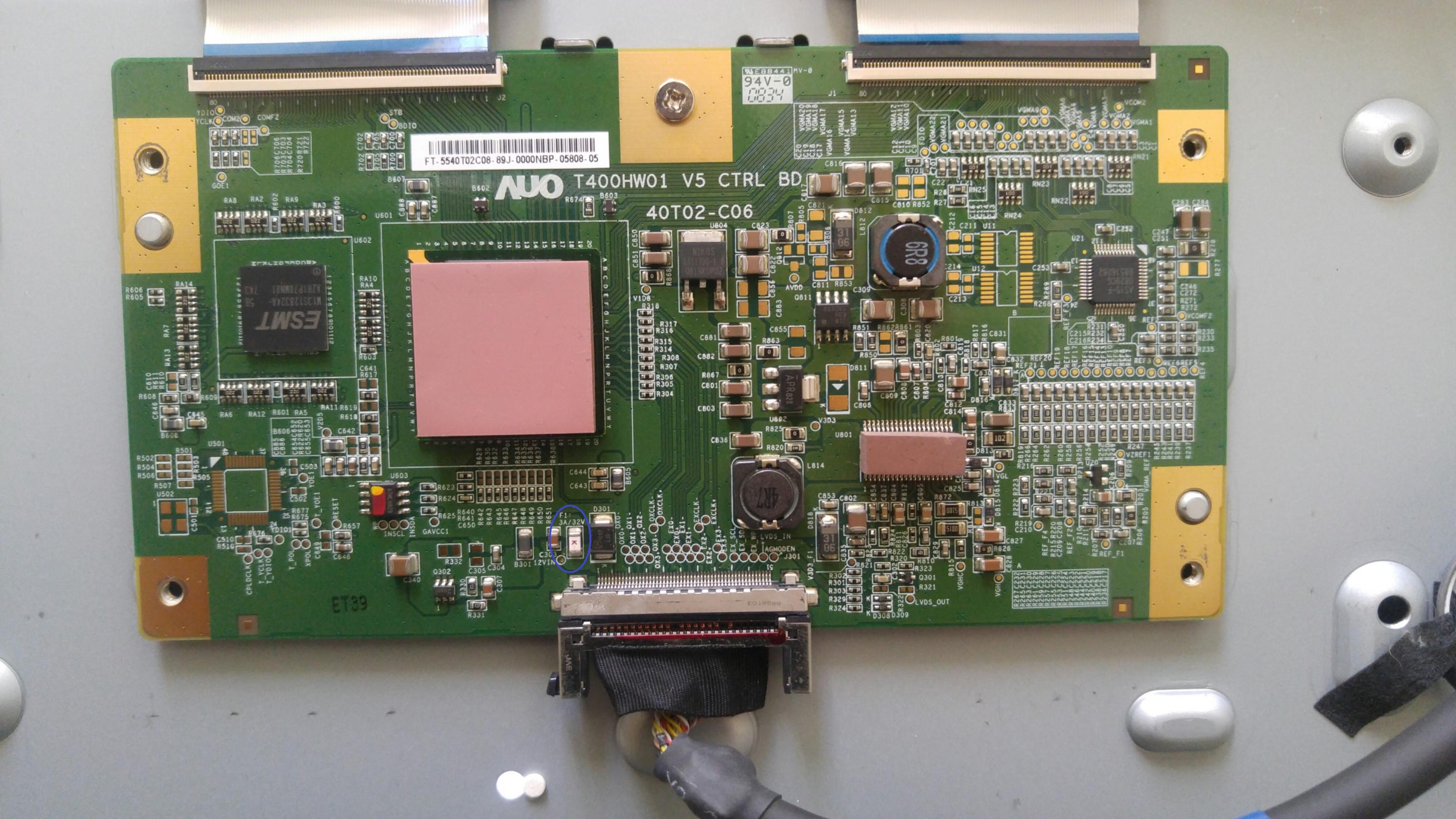

            Budwich, Sorry for the confusion I no longer have a picture or a menu (at the start I did, but now is just a backlight glow, not sure what failed). I have attached a photo of the installed TCON board. I took readings at C303 and both sides of the white fuse with the K on it.

                      But OP indicates 0 Volt in post 25.
                      https://www.badcaps.net/forum/attach...4&d=1520444306

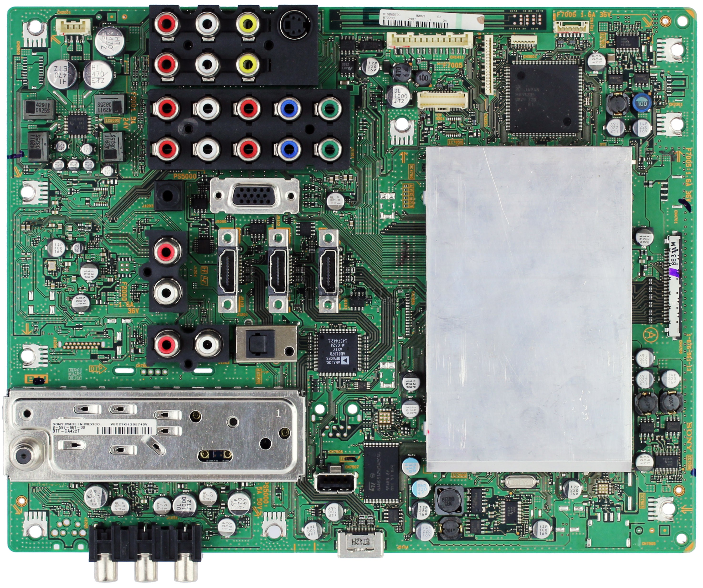

                      It looks to me that the main board has printing errors, it shows two F7005: one is near the white connector, one is near the LVDS connector that I shown.
                      How about all those fuses on the bottom side of the main board, did you test them?
                      Sony A-1641-933-A (1-876-561-13) BU Board for KDL-40V4100

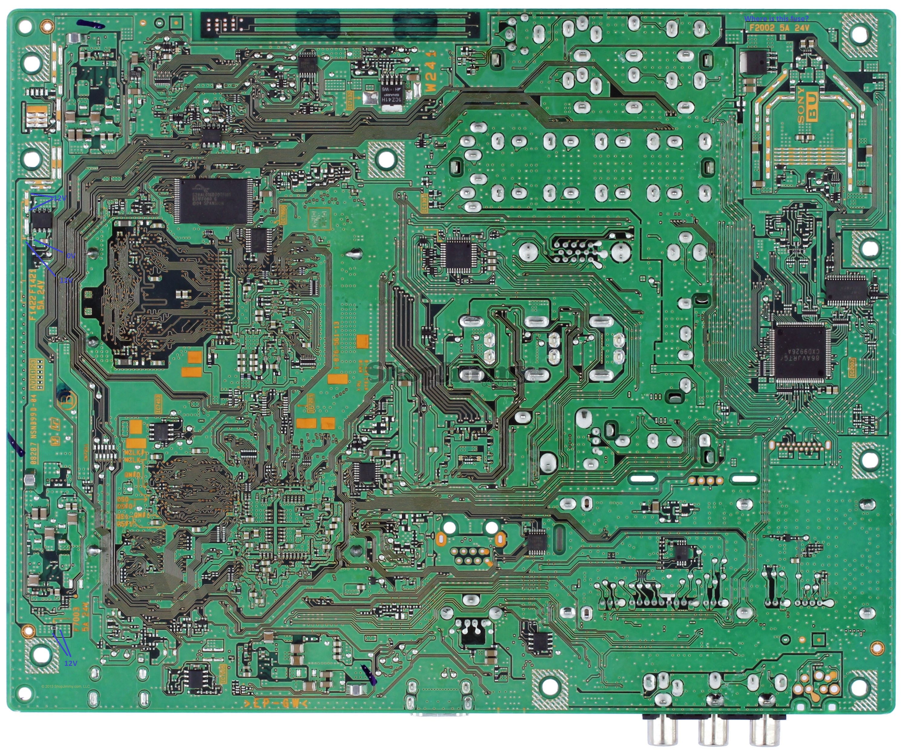

                        Check especially F1422 and the 8 pin mosfet near it on the under side.
                        • DoubleDD
                          • Sep 2017
                          • 17
                          #32
                          Re: Sony KDL40V4100-Dark Picture
                          Looks like we may be close. On the back side of the power board I am getting 12V on the outer side of F1422 5A 24V fuse and 0V on the side closer to the center of the board. I think I will try replacing the old fuse with a PICO II fuse rated at 5A 125V, I believe this was recommended by BUDM in a different post several years back for another Sony with similar issues. I couldn't find an exact replacement for the 5A 24V fuse (Sony 1-576-933-21 FUSE MICRO (1608) FUSE (5A 24V) ) so any recommendation on replacement fuse is welcomed.
                          I have 12V on both sides of what I think was F1421 (see attachment for where I tested). I have 12V on both sides of F7003 on bottom left. I can't figure out where F2002 5A 24V fuse is or where the test points are, the fuse marking is on the top right of attachment.
