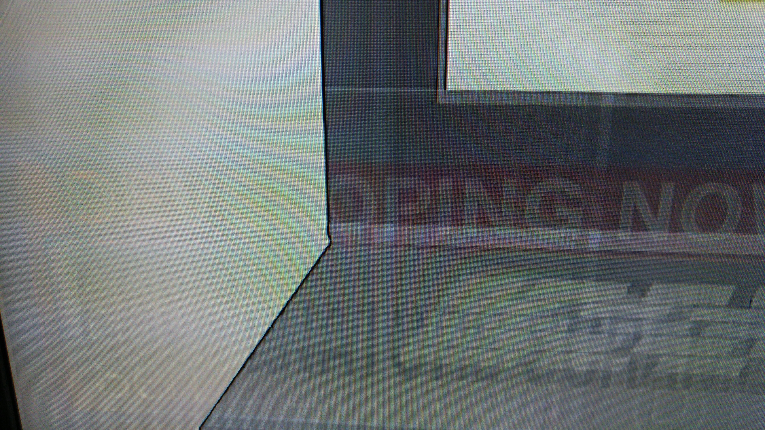

    Sony KDL40V4100-Dark Picture
    I have a Sony KDL40V4100- Model T400HW01 - Sept 2008 manufacture, serial number 8200XXX that has just started displaying the picture very dark with red toning, meaning skin tones are rendered in abnormal reddish tint. The problem is throughout the entire screen, it does not exhibit and vertical or horizontal lines. The picture remains fairly sharp and shoes only a small amount of ghosting depending if the previous content was a chart or lettering. The menu appears normal other than the dark hue, the lamps appear to be on throughout. The whites will sometimes start whiter and then dim. I am trying to determine if this is a failure of the TCON board, the BU board or a panel failure. I obviously don't want to start hanging parts on an older LCD television but if I can keep it going that is my goal. I have checked for bulging capacitors and loose connections but have found none. Hoping someone else has seen this and can advise the best repair course. I have attached photos showing the screen, as you can see Wolf Blitzer is very red on my screen.

    Re: Sony KDL40V4100-Dark Picture
    Just a note the picture on the screen is in normal upright position, attachment posting from phone shifted photos d180 degrees
      Looks like a bad T-CON Bd to me
          Yeah, I would say it's the AS15 on the tcon going bad looking at the photos. Measuring the voltages as per post #4 will confirm this.

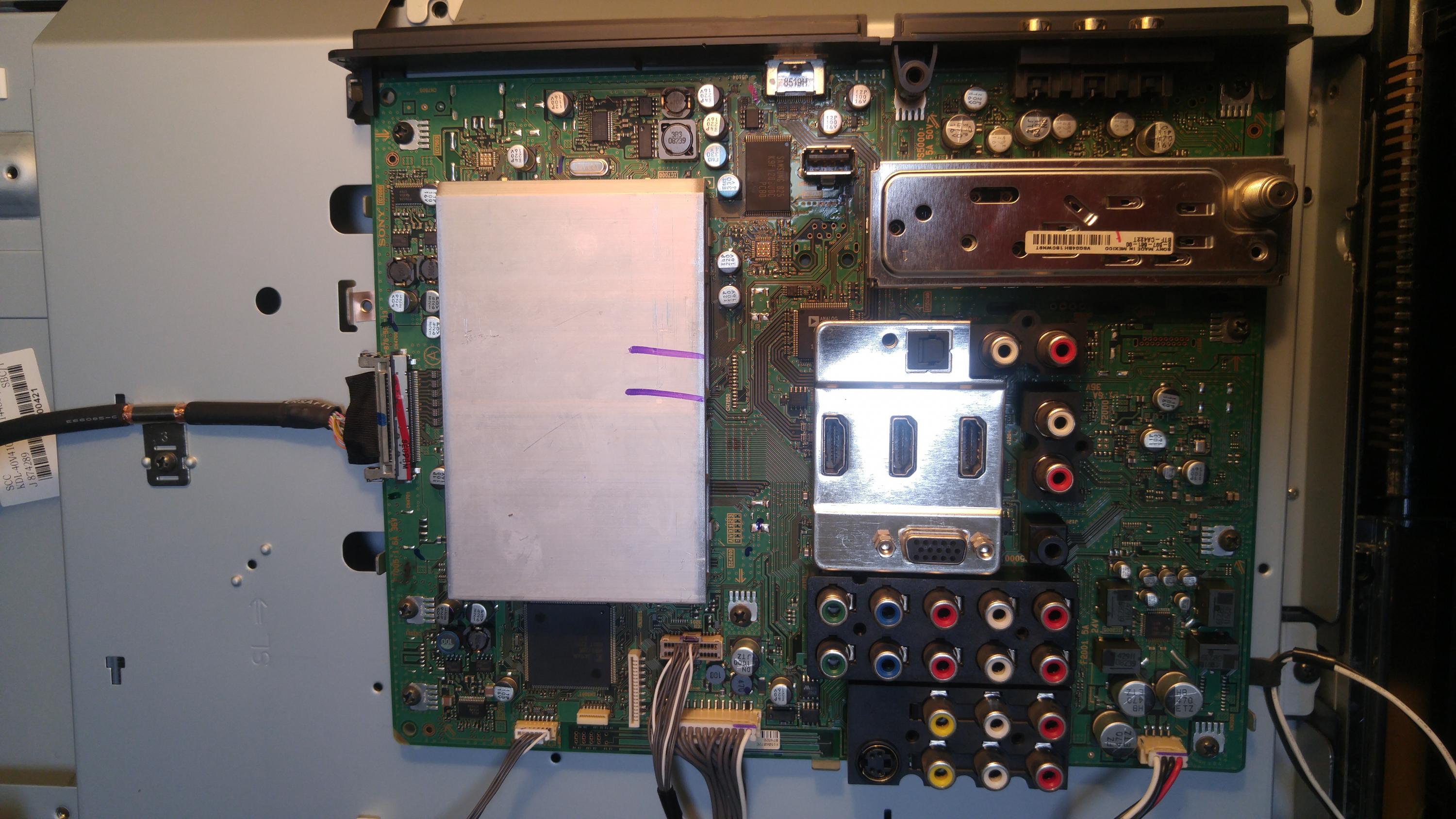

                          Check on the fuse
                          I have marked it for you
                          You should Have 12v
                          either side.
                          IF there is no 12V
                          I think you have blown a fuse on the main board
                          Will need pics of the main board.
                          Have had this happen when re fitting t cons on theses type on sony..
                                        I have marked the areas on the pic
                                        check the fuses in this area
                                        i cant make out from the pic which one is the fuse
                                        but you have 2 in that area
                                        please check those.
                                        Also when the tcon is connected do you have 12v on that fuse on the tcon ?
