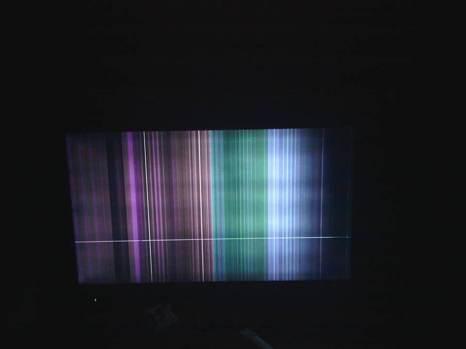

    Hey guys i have a 47inch lg smart tv which i bought in 2012 its been running fine but now its gone into a problem basically when i turn on the tv no picture comes (back light works) but i can hear sound coming from channels it also shows horizontal flickering lines, so i opened the tv and searched for bad capacitors but there are no bad capacitors. Power supply is fine so i guess the problem lies in t-con board,main board and tv panel.So panel itself has never been damaged or came contact with water so i think its fine but i guess t-con board has problem but iam not sure about it, i also gave my tv to some repairmen but in my country they all work on trail and error bases, so they just told me that tv panel has fault but i highly doubt it. Iam posting pictures of my problem then you will have a better idea, by the way i removed one of two lcd wires from t-con and then tv shows half side full white i dont know what that means.Please help me guys as this is the only tv i have and i cant afford a new one. Thanks

    Most likely the mainboard. Remove the heatsink and use a heat gun on low for about 45 sec. on the chip. Should turn on, opinions differ as to how long it will last. Ive done 30 or so and nobody has called about one. Fist one was early last year.

      Yeah i used a hair dryer to heat the chip for about 6-7 mins but that didn't work either. should i try it again?

          Not with a hair dryer. It's not hot enough, you're looking to melt the solder balls under the chip.

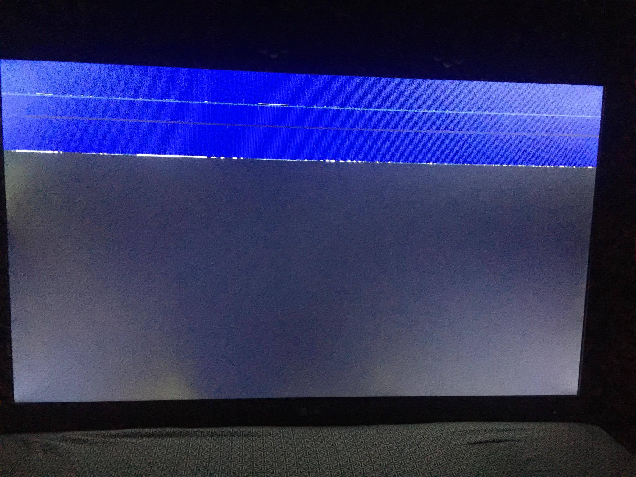

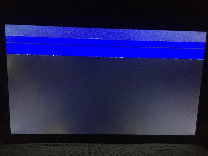

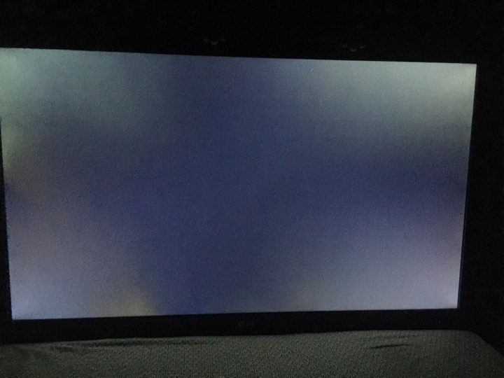

                                  Re: LG Smart Tv No picture but has flickering horizontal lines.PLEASE HELP
                                  https://www.badcaps.net/forum/attach...1&d=1505242909
                                  Are those dark clouds like on the screen always like that in one place and they do not move?
                                  That cloud looks like bad screen to me. From my experience, T-CON cannot cause horizontal lines.

                                    no this is backlight bleed when any picture comes they just go away this is just backlight or you can say blacks of tv but these lines do move when new input is selected sometimes whole screen goes gray.

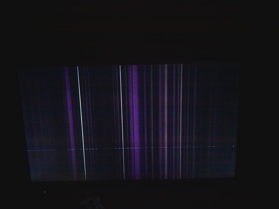

                                        have a look at these pictures this happened when i was playing my blu-ray player,could this be related to TCON?
