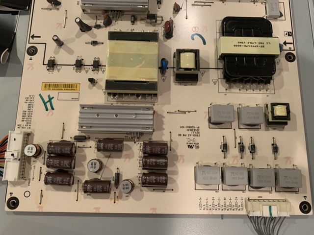

Ok just went ahead and ordered the whole power board. $30 and hopefully done with it.

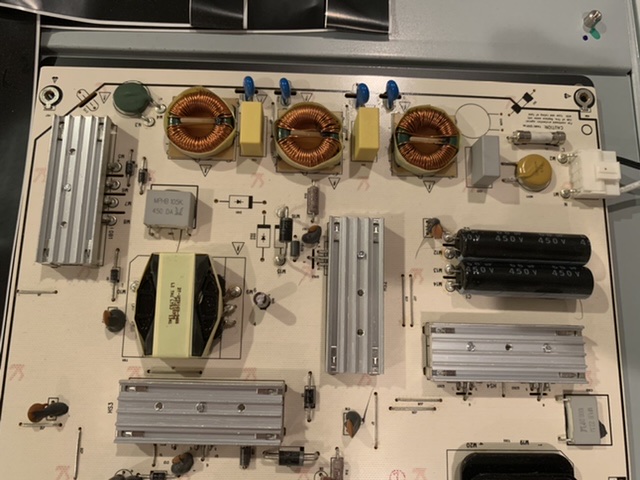

What dv voltage do you get across the terminals of 450v capacitor. Picture 4
I have the same issue that this forum is about. However I have no voltage on the 450V caps. Thoughts?

03-29-2020, 03:42 PM
Re: Vizio E601i-A3 Won't Power On
You need to show us good clear pictures of YOUR board.
is the main AC fuse OK?

03-30-2020, 08:40 PM
What DC Voltage do you get when measure between the two legs of the mail filter caps (black long caps (2) laying on the side in the hot side)?
Be careful not to touch anything in the hot side with your hands/body.
