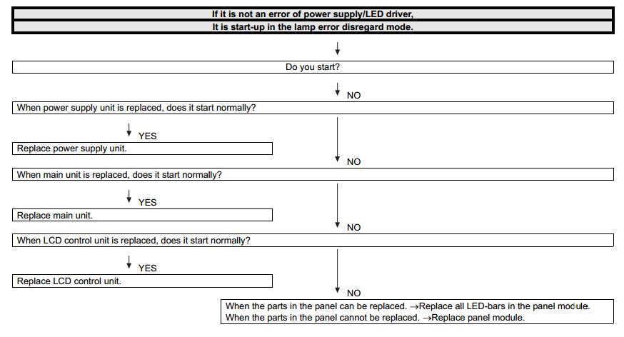

                So at least the main board is not completed locked since the PS-ON is still responding. I I will have to study the code and the service manual more in details to find out what is going on since the communication error does not seem the match the missing command signals.
                  Re: Sharp Aquos LC-60LE640U Won't turn on
                  Did you have a chance to look into this? I think in the manual that it states if there is no error lights then you should replace power supply then main board then LCD Control Unit. Page 6-4 of the manual I have.
