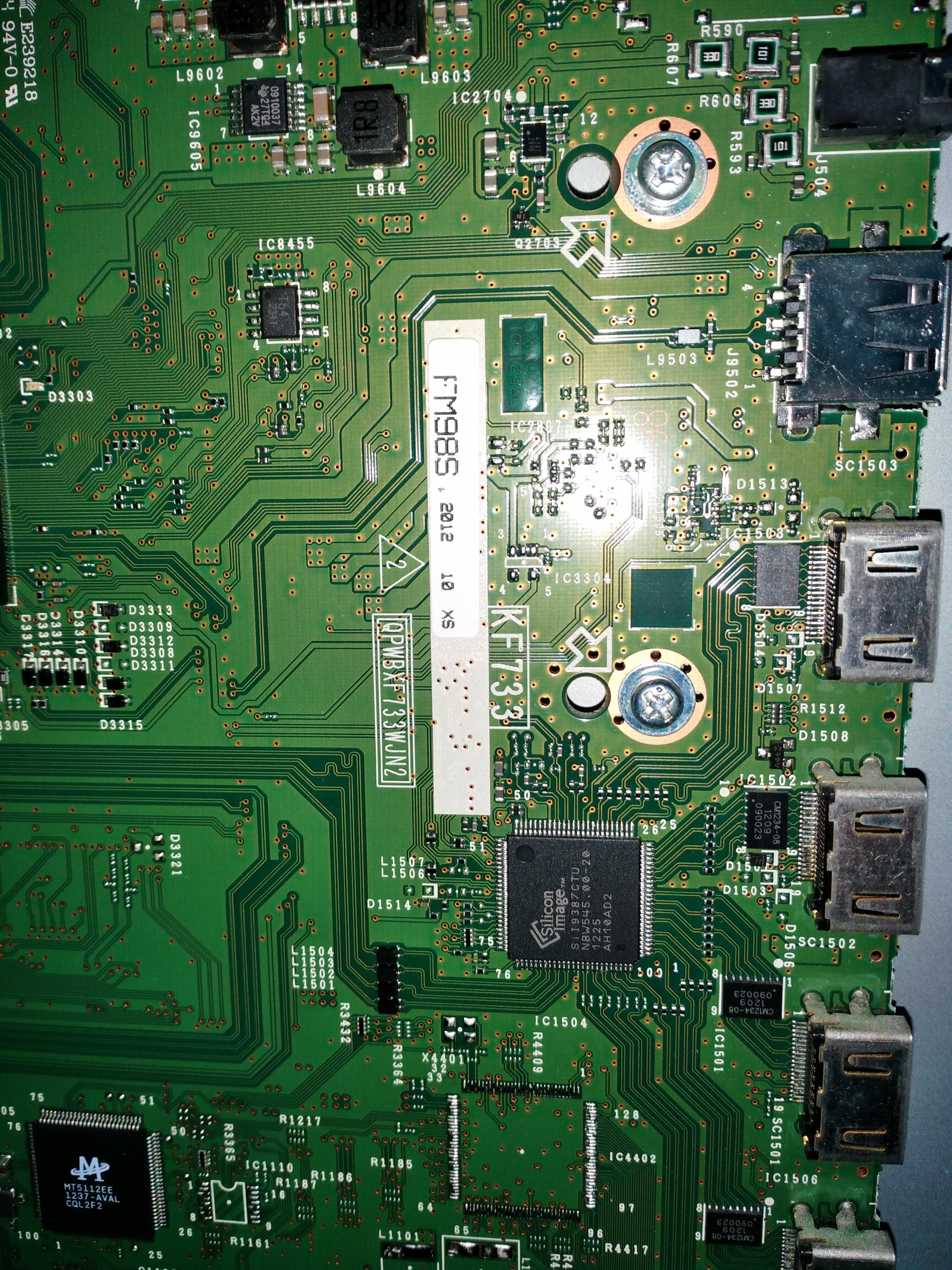

                    I received the replacement main board today.
                    It did fix the error code but the TV back light is not coming on.
                    The power button works normally. And if I leave it on for a while (10 min?) it will shut itself off.
                    Also, the main board has a green LED that flashes slowly.
                    Is this repair worth pursuing further?
                    Could the power supply be the problem now?

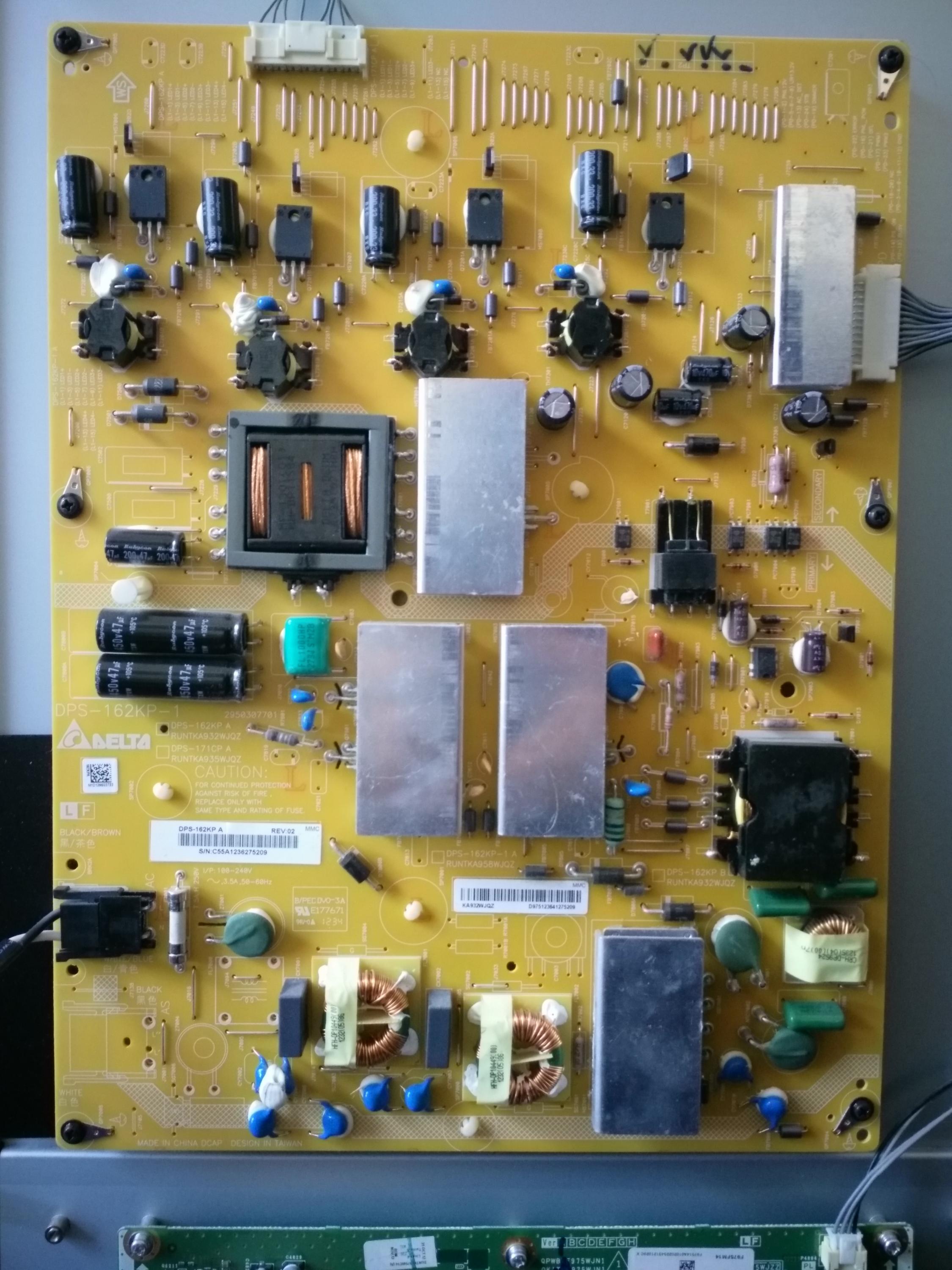

                        As far as testing the caps, are you referring to the 2 horizontal ones labeled 450v47uf? What DCV would I expect to see? I would just put the negative and positive leads each on one of the cap's legs? Sorry if that's a dumb question. I'm an amateur at this type of work.

                            Also, I tested the 2 450v47uf caps (with the + and - leads on each leg) and they both showed 404v dc

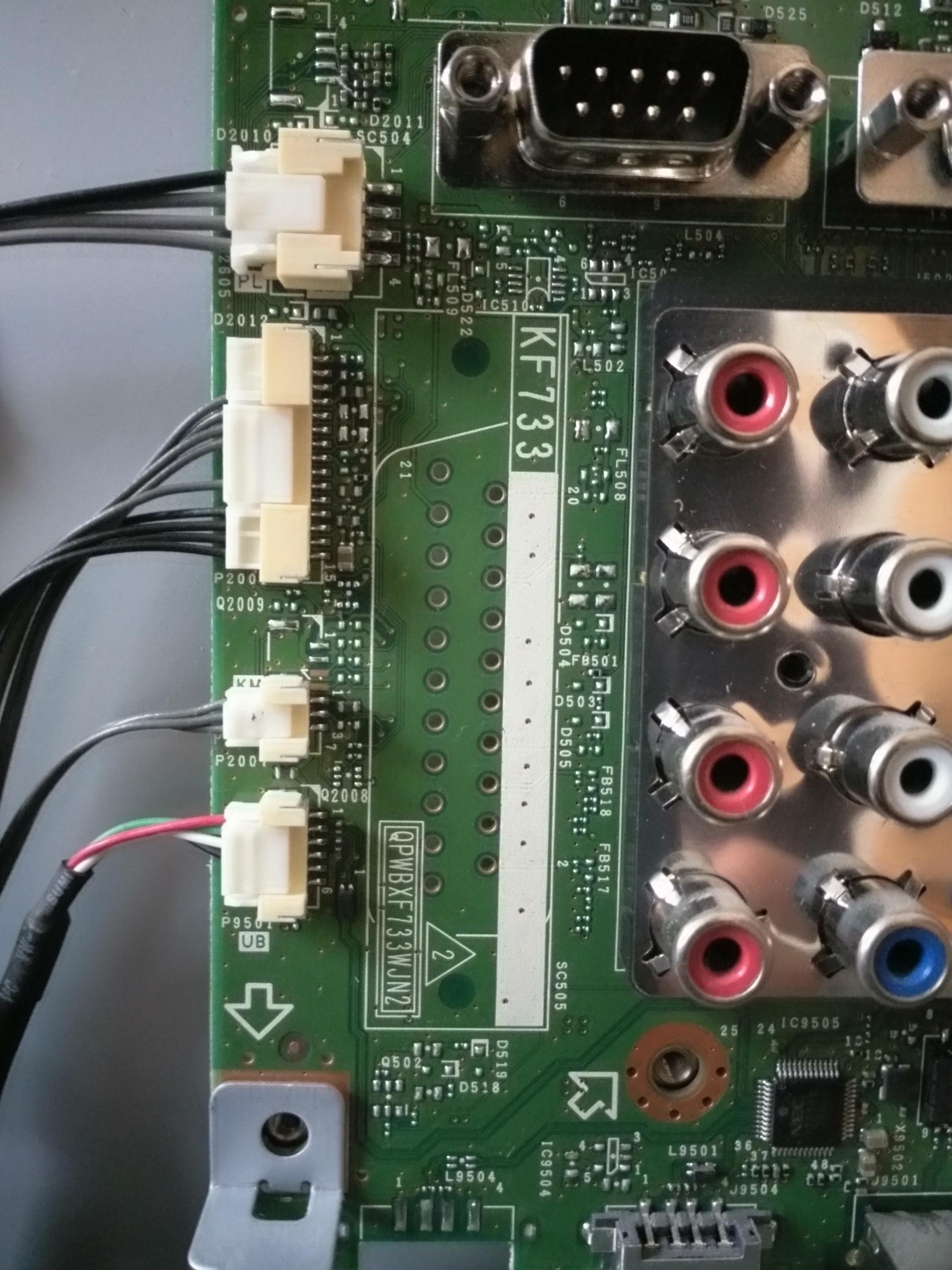

                                  Not sure about testing the power supply to mainboard connector. There are 24 leads on this connector. The bottom ones look like they'll be very difficult to get to. Can this be done while the connector is disconnected?
                                  Are these the relevant wires? Not sure why the bottom 3 aren't numbered.
                                  Thanks again for the replies.

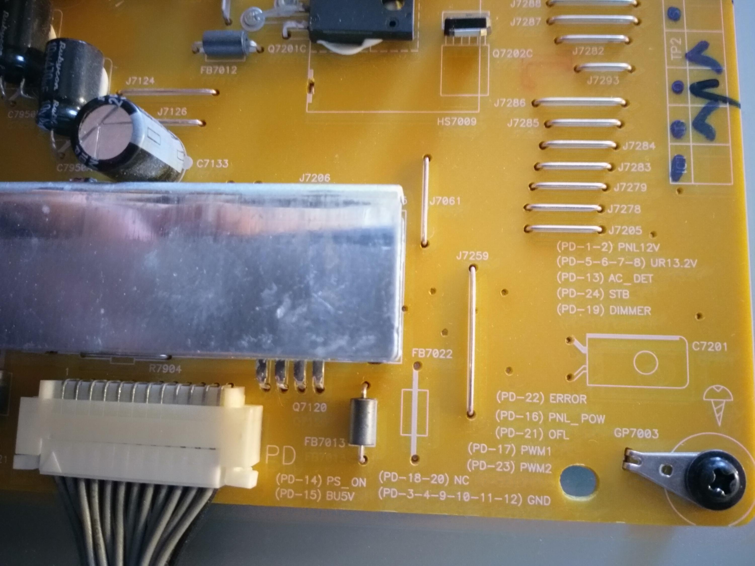

                                  • StodgyWaif
                                    • Apr 2014
                                    • 40
                                    Re: Sharp Aquos LC-60LE640U Won't turn on
                                    Originally posted by dskall
                                    Need voltages from connector that goes from power supply board to main board. Will need pin#- PIN DESCRIPTION -Pin voltage in standby-Pin voltage when pushing power button and picture of connector on power supply board.
                                    Format:
                                    Pin# - Pin Description - Pin Voltage standby - Pin voltage power on
                                    1 - XXXXXXX - XXv - XXXv
                                    2 - XXXXXXX - XXXv - XXXv
                                    3 - XXXXXXX - XXXv - XXXv
                                    4 - etc.
                                    Sorry, I just don't know all of the info requested.
                                    I have included a picture of the order in which I tested the pins. I used a needle inserted into the back of each port on the connector and put the ground lead on one of the screws of the cold side of the power supply.
                                    Pin# - Standby - Power On
                                    01 - 11.97 - 11.98
                                    02 - 00.00 - 00.00
                                    03 - 13.05 - 13.07
                                    04 - 13.05 - 13.08
                                    05 - 00.00 - 00.00
                                    06 - 00.00 - 00.00
                                    07 - 02.84 - 02.84
                                    08 - 03.28 - 03.29
                                    09 - 03.28 - 01.45
                                    10 - 03.28 - 01.45
                                    11 - 00.00 - 00.00
                                    12 - 03.26 - 00.00
                                    13 - 11.99 - 11.98
                                    14 - 00.00 - 00.00
                                    15 - 13.05 - 13.07
                                    16 - 13.05 - 13.08
                                    17 - 00.00 - 00.00
                                    18 - 00.00 - 00.00
                                    19 - 03.29 - 03.29
                                    20 - 05.02 - 05.03
                                    21 - 00.00 - 00.00
                                    22 - 00.57 - 00.00
                                    23 - 00.86 - 01.45
                                    24 - 00.00 - 00.00
                                      No pin names on the power supply board side as requested to tell us what those pins are?
                                      • StodgyWaif
                                        • Apr 2014
                                        • 40

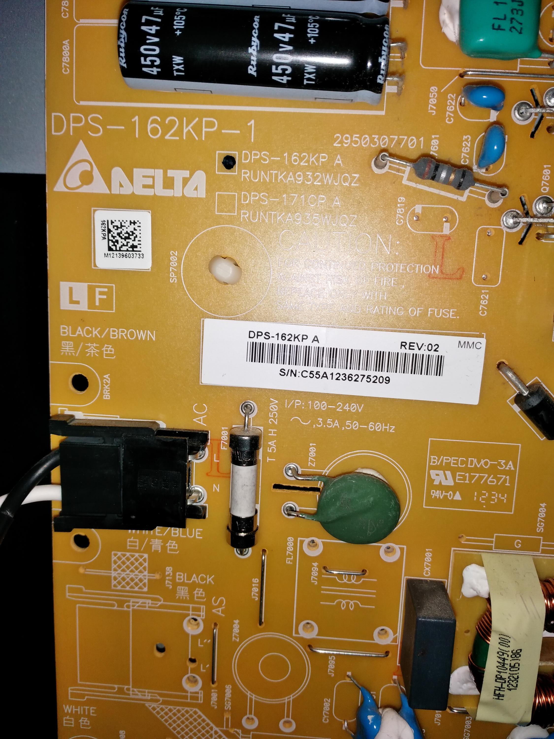

                                        Sorry about that. Here is a picture of the printing on the PSU. I don't think these correlate to the order that I tested them in. If you can tell me how the pins are numbered on the connector I can correct my table of values.
