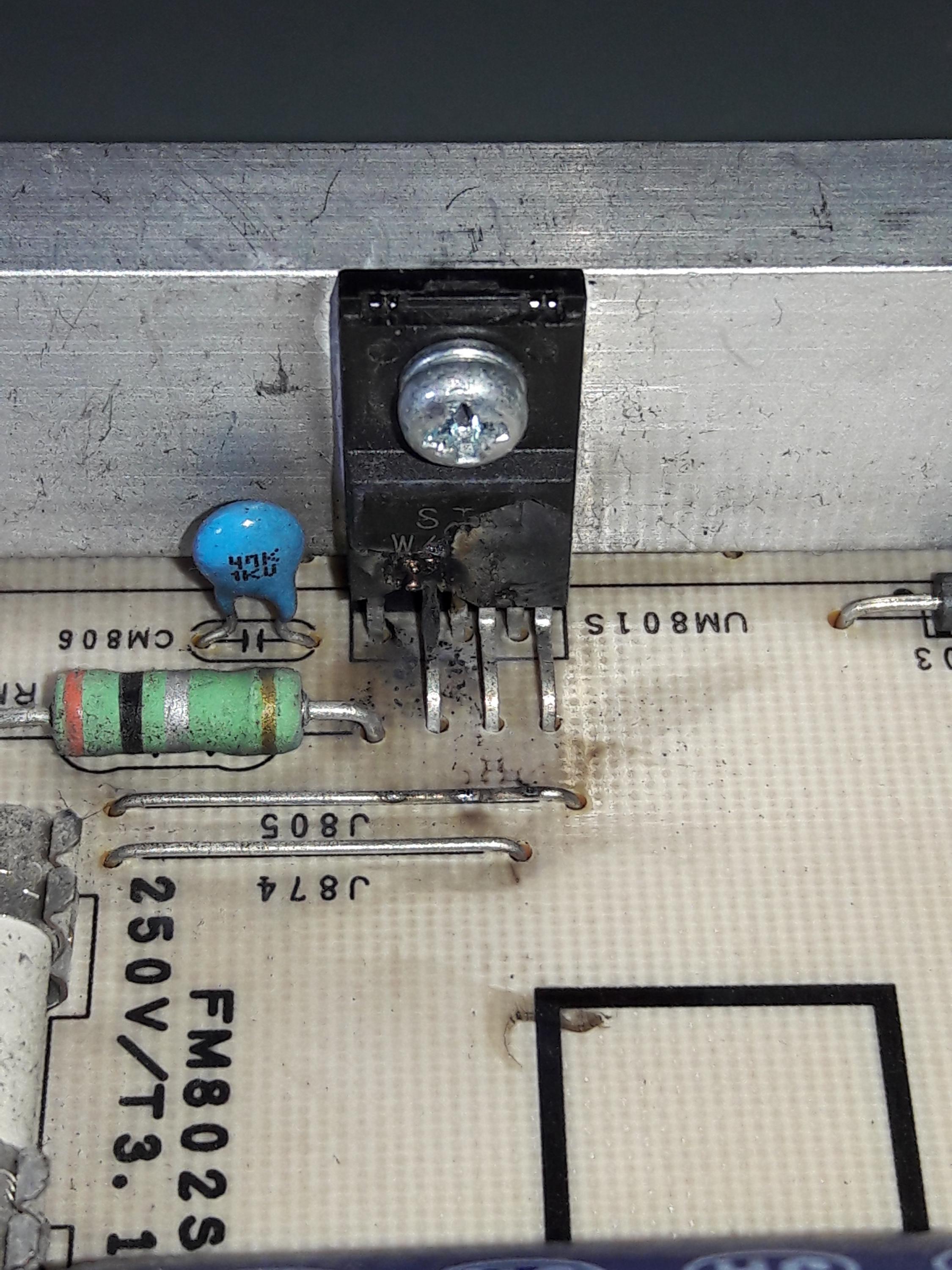

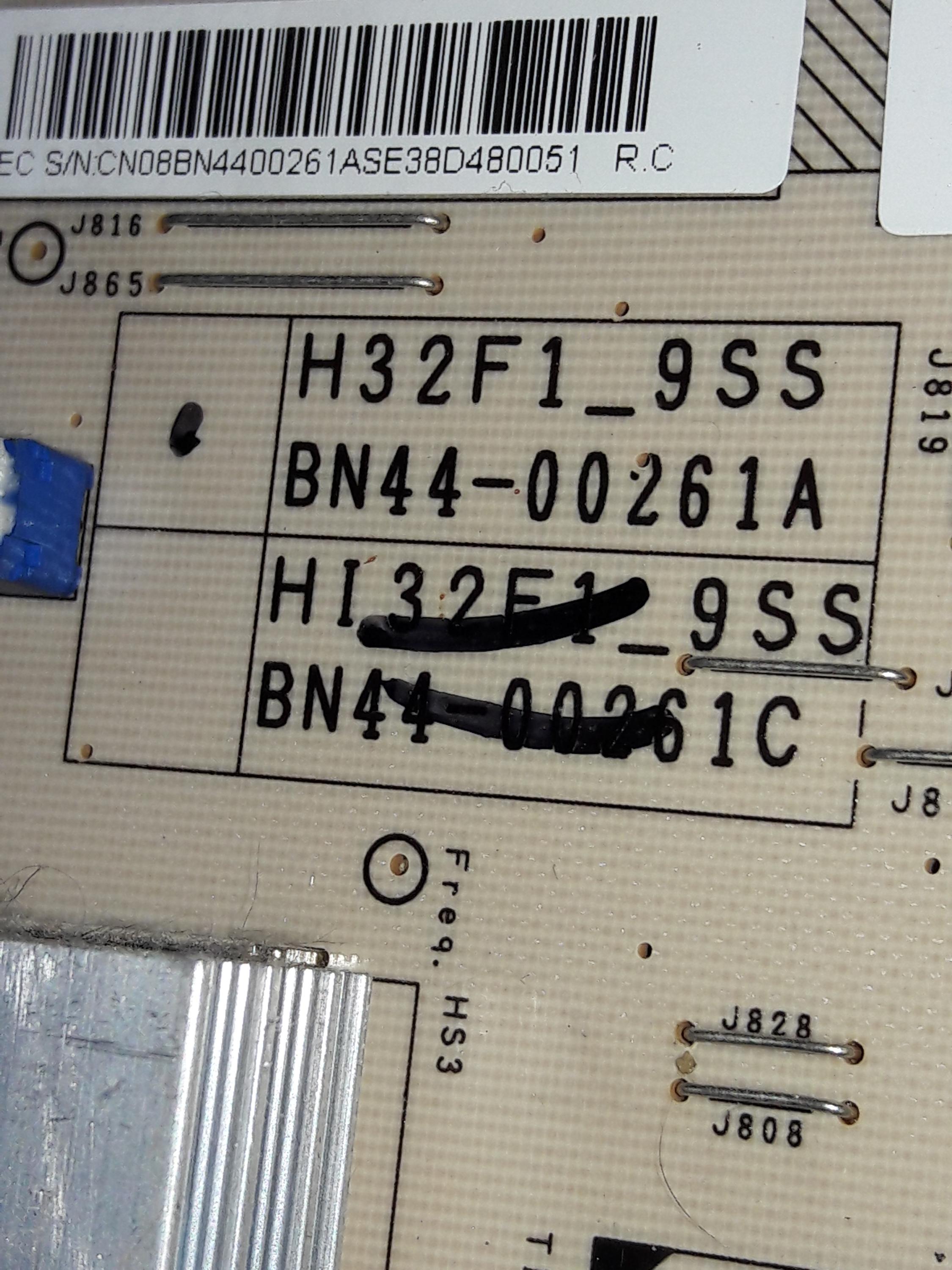

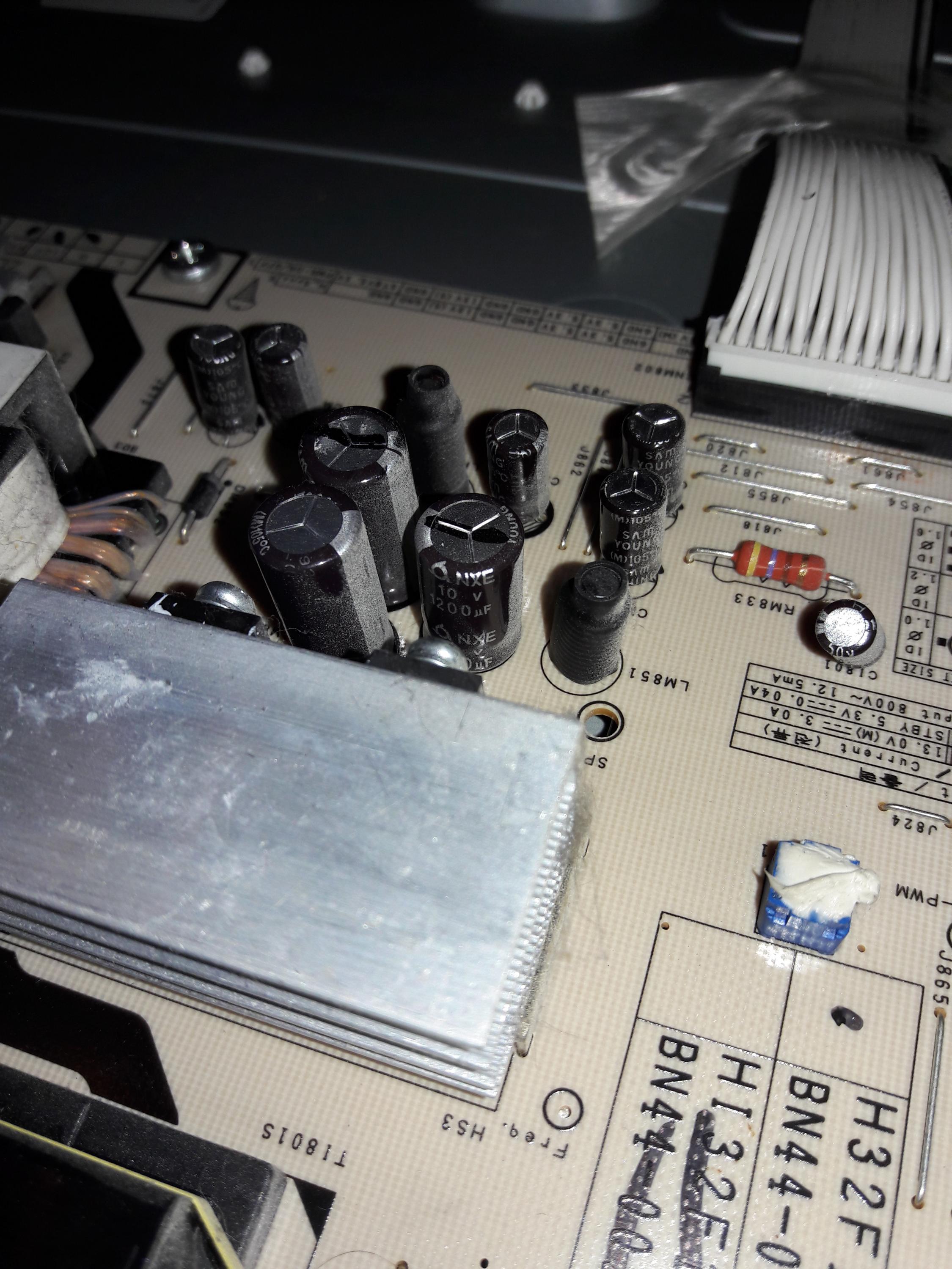

    Hi everyone

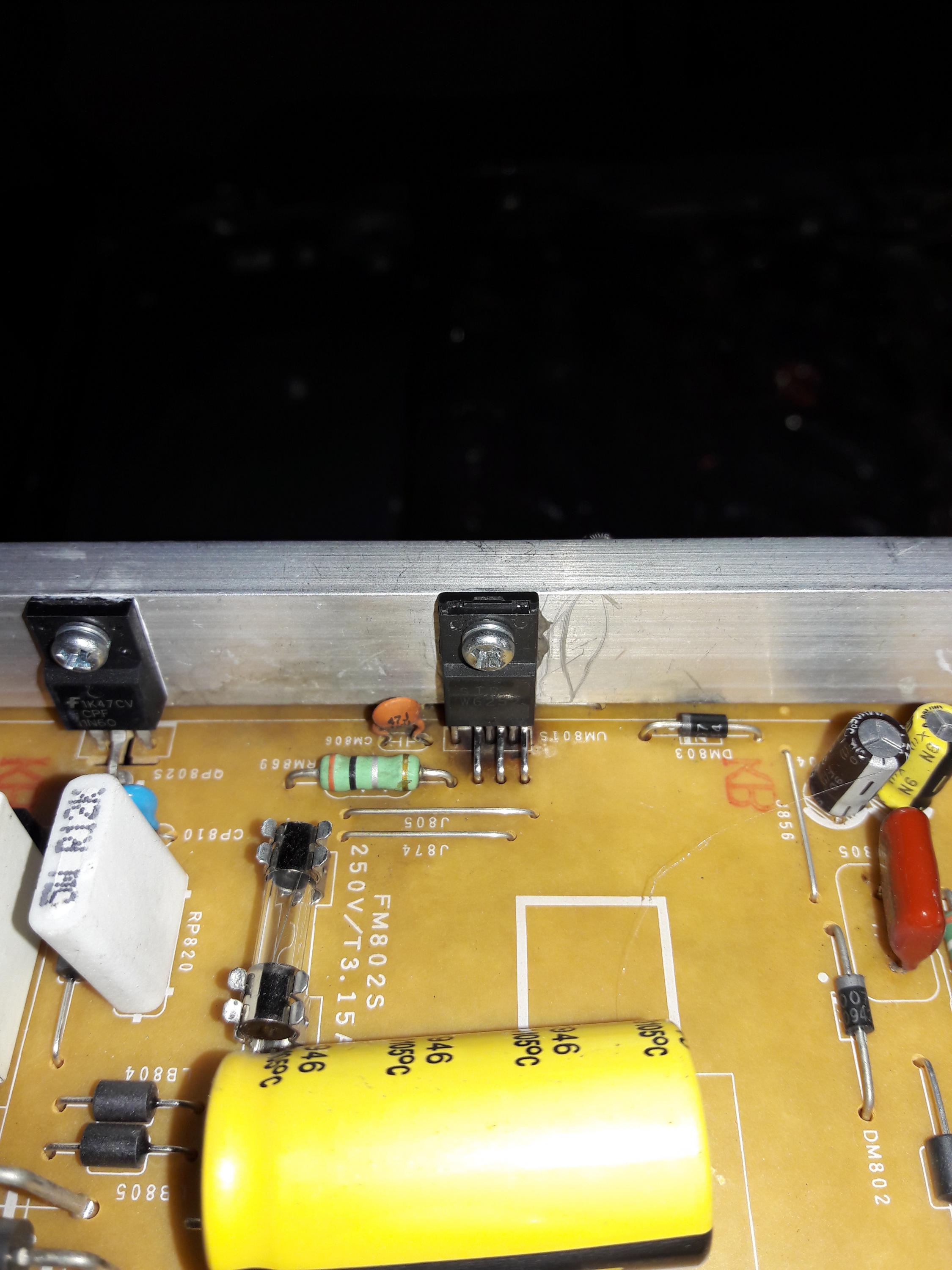

    I just recently acquired a nice little Samsung LN32B550K1F 32" LCD TV that wouldn't power on.
    Looking at the power supply/inverter board BN44-00261A , it appears that the component at location UM801S is completely destroyed.
    It seems that similar inverter/power boards have that same IC pop on it. Shop Jimmy has a video about installing a kit for a BN44-00264B. I was able to locate a schematic and it appears that component is a STR-W6252 , althought I have no idea what it does. I thought it was a MOSFET but it has too many legs.
    The only thing I was able to find about this IC was in another thread:
    https://www.badcaps.net/forum/showpo...86&postcount=6
    Originally posted by tom66
    Ah, we had a power board like this on badcaps before, giving similar problems.
    Try checking ZD803 and ZD804 for shorts.
    If they are OK, replace UM801S (STR-W6252) and CM808.
    I cannot seem to find a CM808. There is a component right next to UM801S which looks like a ceramic cap? CM806. ZD803 and ZD804, are those zener diodes? Can those be tested in circuit?
    The board for this TV is $60-$90 otherwise I would just swap the board.

    Re: Samsun LN32B550K1F with BN44-00261A burnt out IC

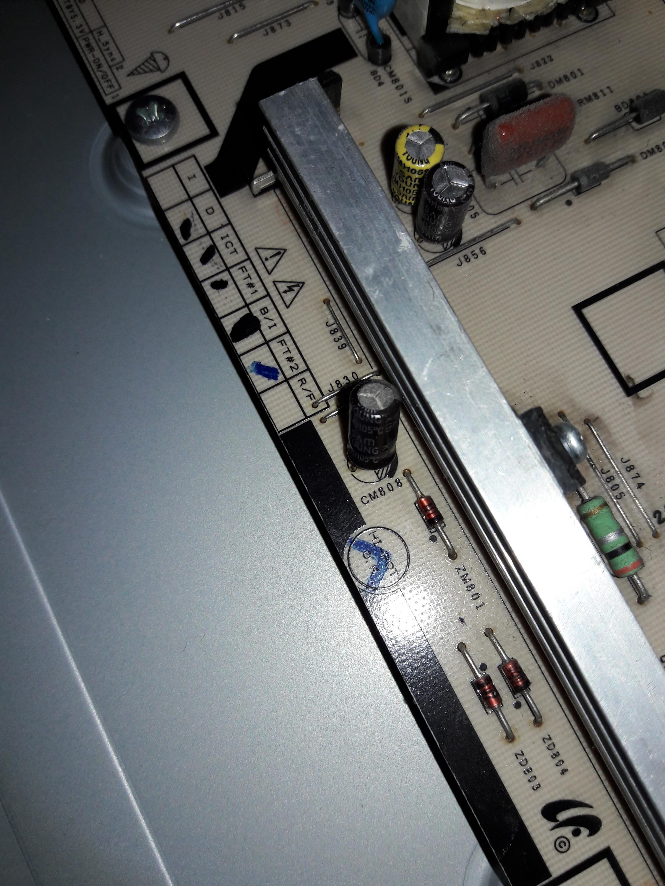

    STR-W6252 is a MOSFET and PWM controller in a single package.
    I quickly test most components in circuit and if there is and dubious readings I remove and test again.
    Yes they are zener diodes.
    What's the cap the other side of the heatsink ?

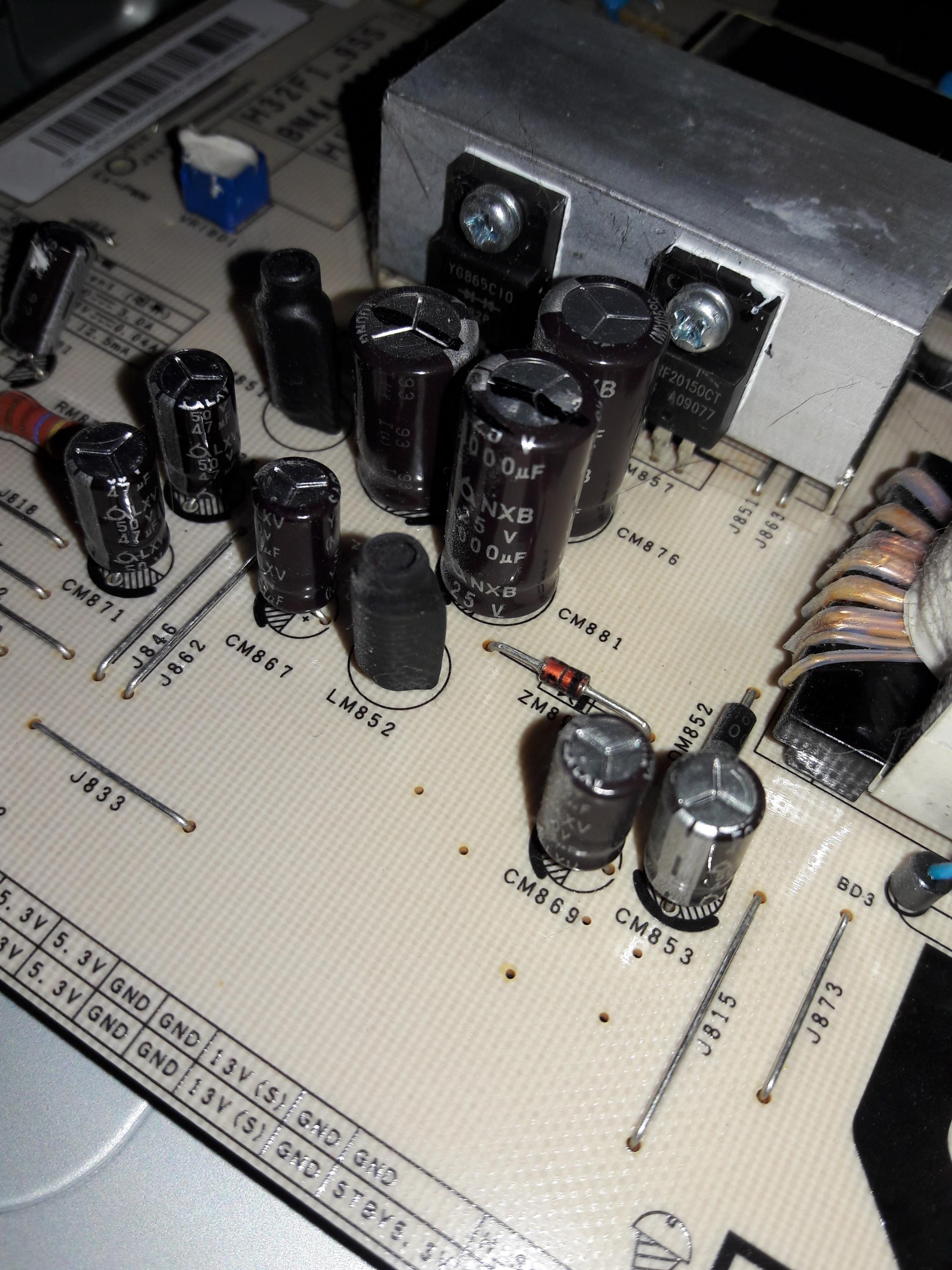

      It's the CM808 that I couldn't find. It's a Sam Young too. It looks like the 2 Zener Diodes are there too. Can I test the ZDs in circuit? I think diodes are continuous in one direction but not in the other?
      Edit: The other caps "look" ok, but if I do get the parts for this thing, those NXB caps are going too.
      Thanks for the help!
        You're welcome.
        I remember doing the same board or similar a while back.
        Diodes test with diode mode on your multimeter, leads one way then the other.
        There are a couple of threads on here with that board, maybe worth checking to see which caps they replaced.

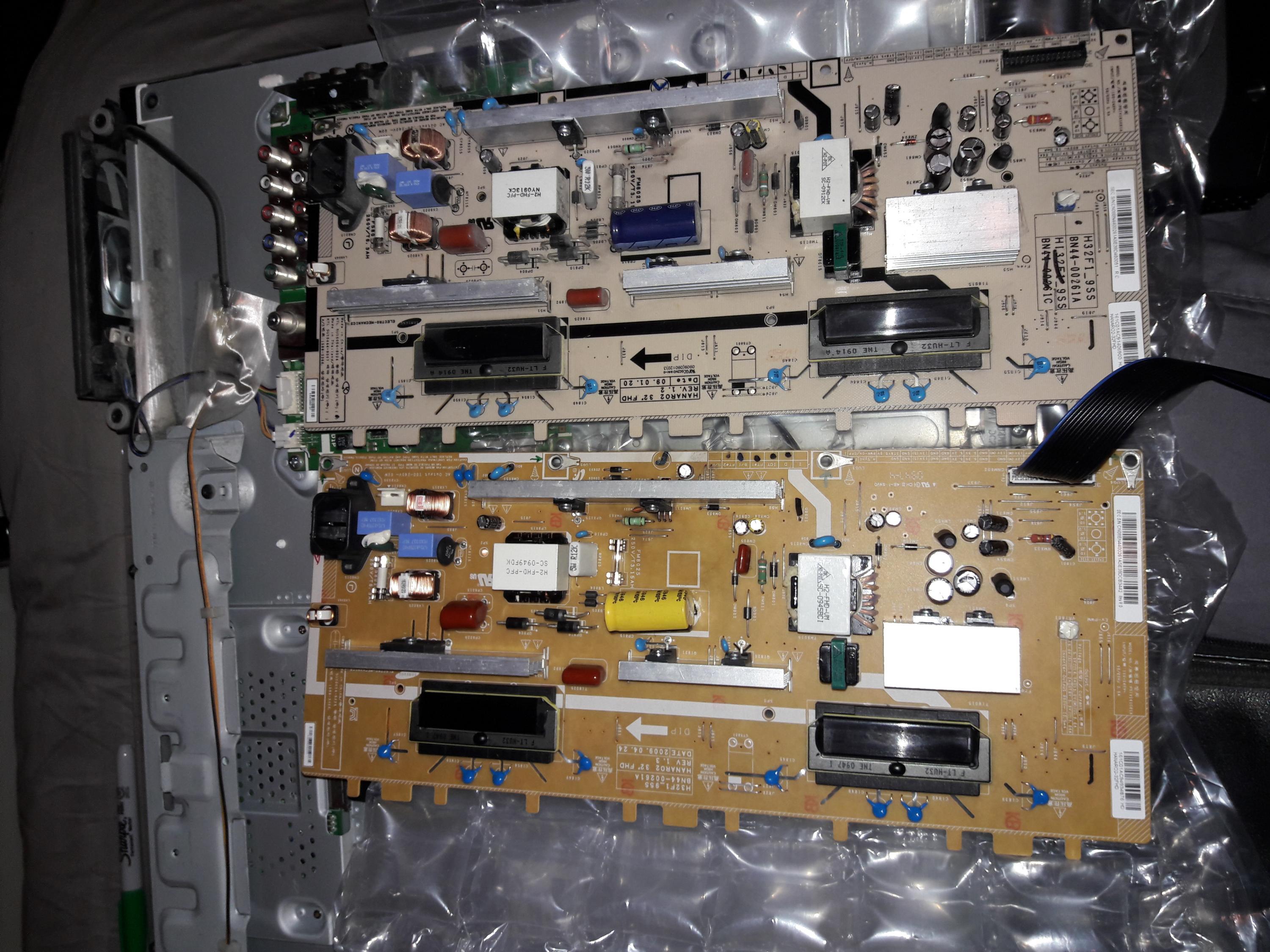

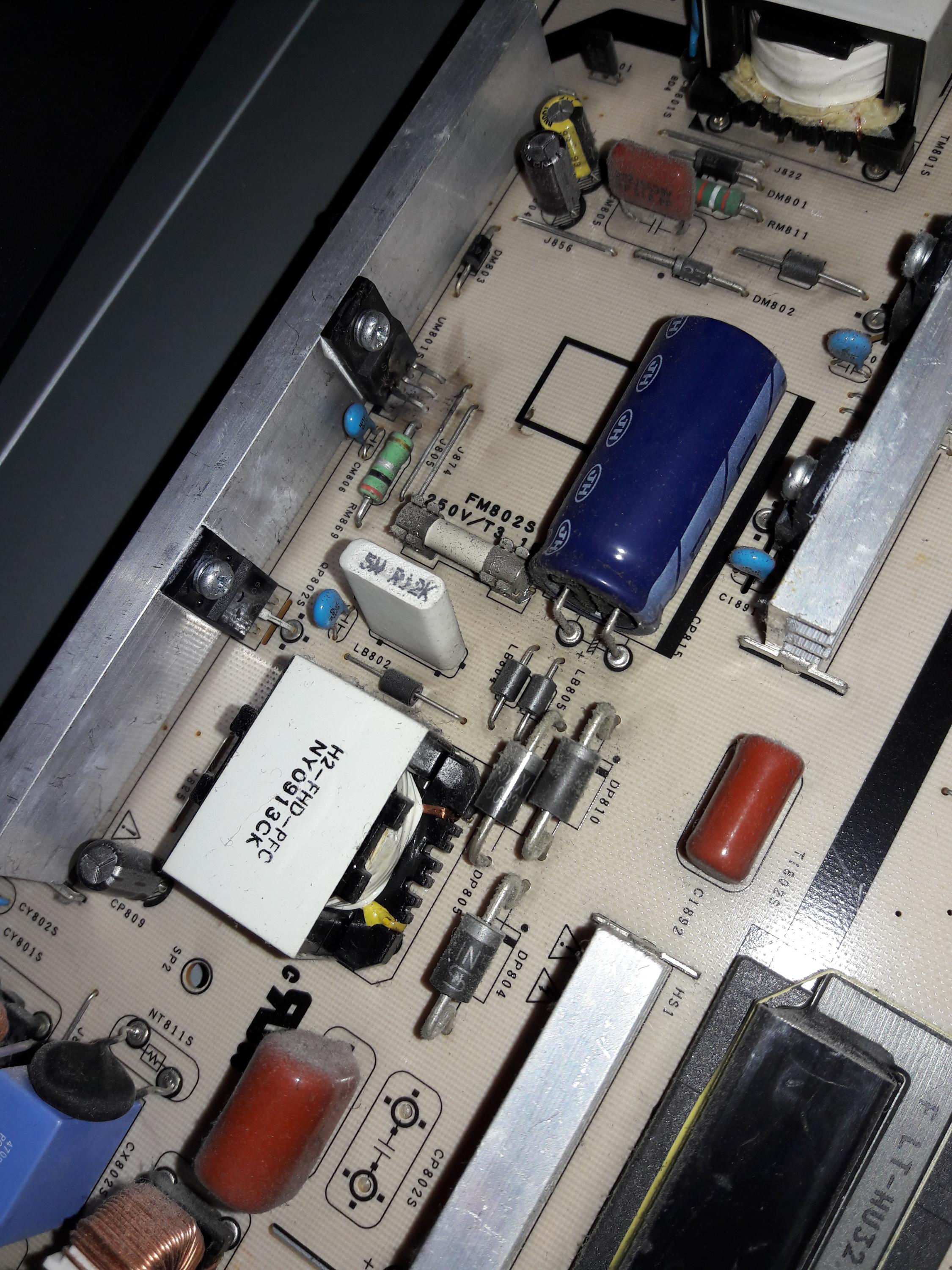

          So I ordered a replacement power board on Ebay and it took ages to get here. It is the same part number but a different revision. The cable going from the power board to the main board on my TV is has two rows of wires in going to the connectors. The replacement board only has a single row. I reused the existing connectors from my TV. I checked both boards and they have the same pin out at the connector.
          I installed the board, and the red standby light is lit up. When I press power on the remote, the standby led in the front blinks and I hear a chime from the speakers as it boots up. No picture, no backlight, only a red glow from the led on the main board. I took a flashlight and shined it on the screen and nothing. I pressed the menu button and there are no graphics or words anywhere.

                        This power supply does use 10k pull up resistors from 5 volts for power on/off & inverter on/off so with the main board plug disconected, measure the voltage at CNM802 pin (1) and pin (23) to see if it is being pulled up
                        You measured 13 volts on cnm802 pins 7,8,19,21,22 which seems to indicate that part of power supply is on.

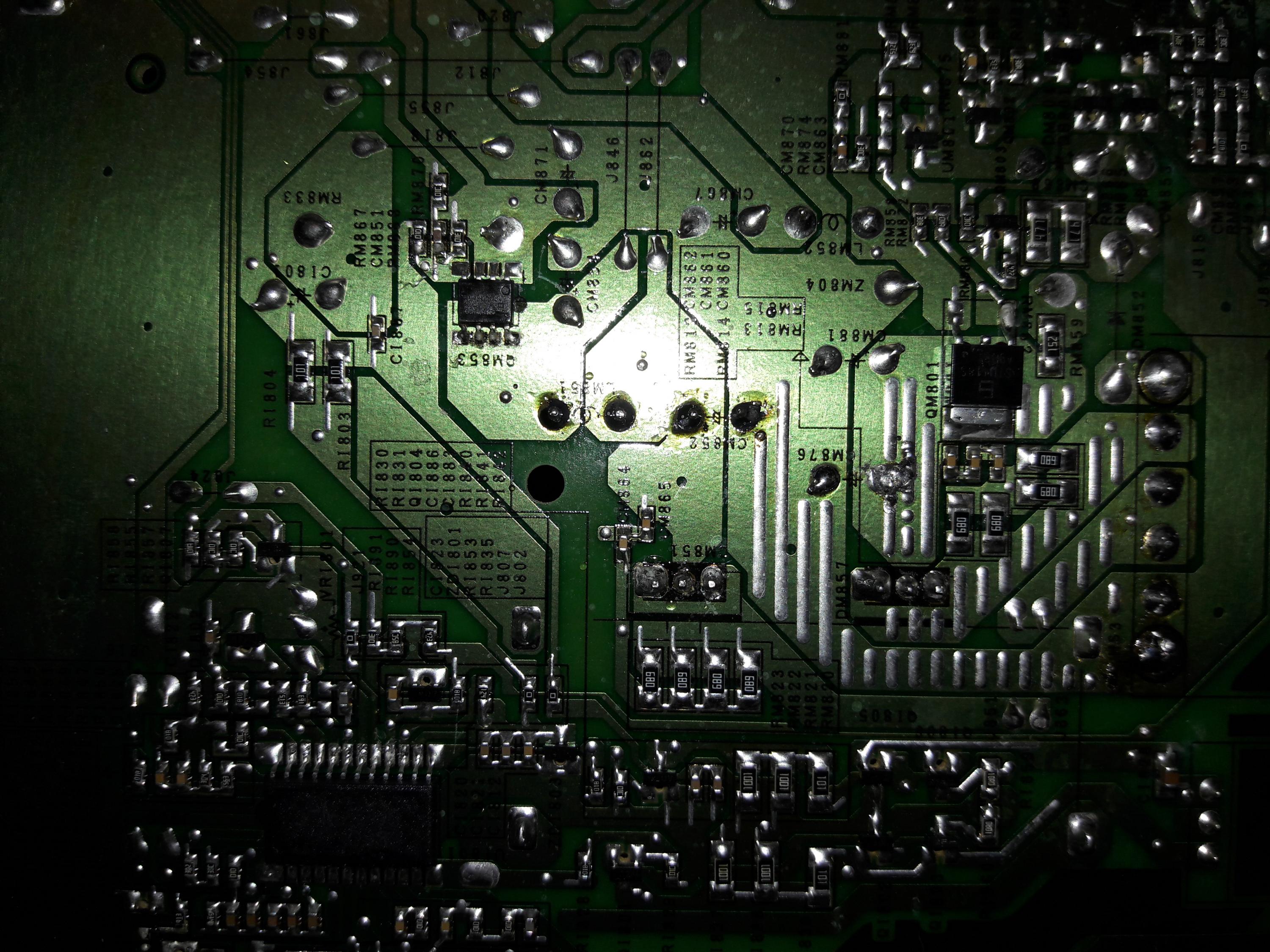

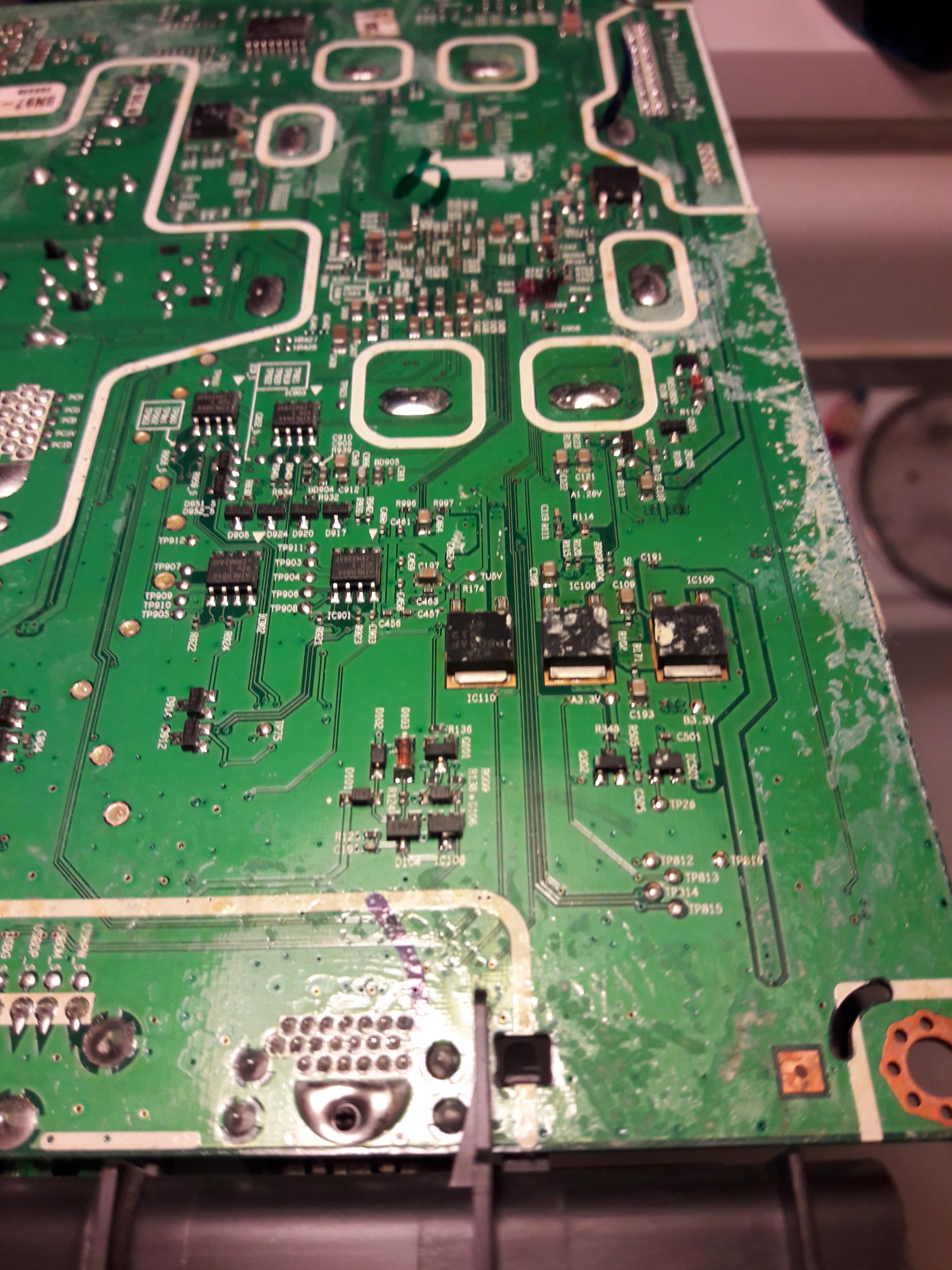

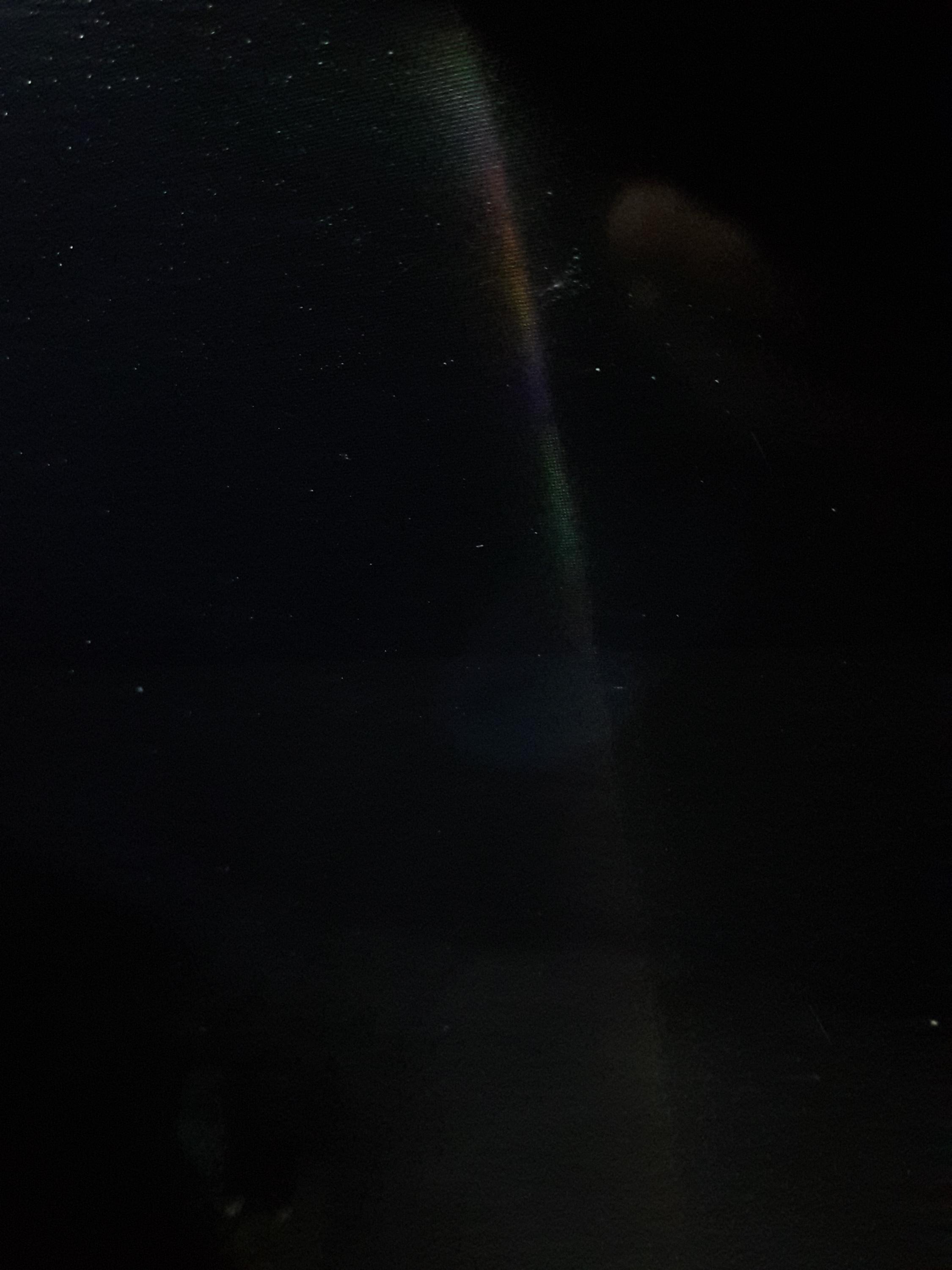

                          I turned the set on, again chimes but no video, no visible backlights. But this time when I shined a flashlight on the screen, there was a visible divide between the two sides of the screen right down the middle. Half the screen was black, and half a slightly greyish tint. Ever so slight, I almost missed it. I plugged in the ribbon cable and removed the cable on the other side of the T-CONN and the same thing but on opposite sides now.
                          I've included a picture but I don't know if you can see it, it's really faint. There are no visible wires going to the LCD panel from the inverter. I'm not really sure how the backlights get power.

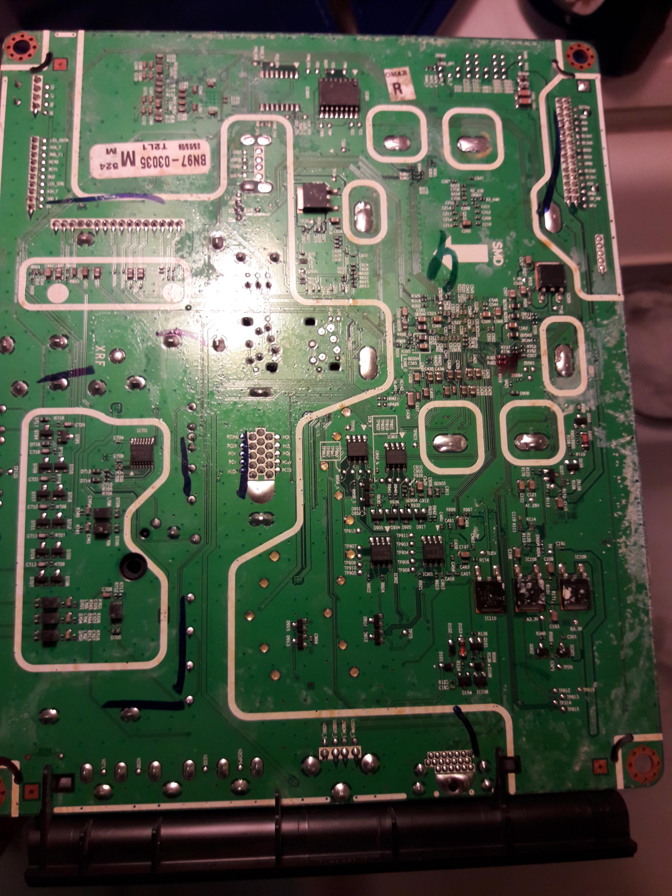

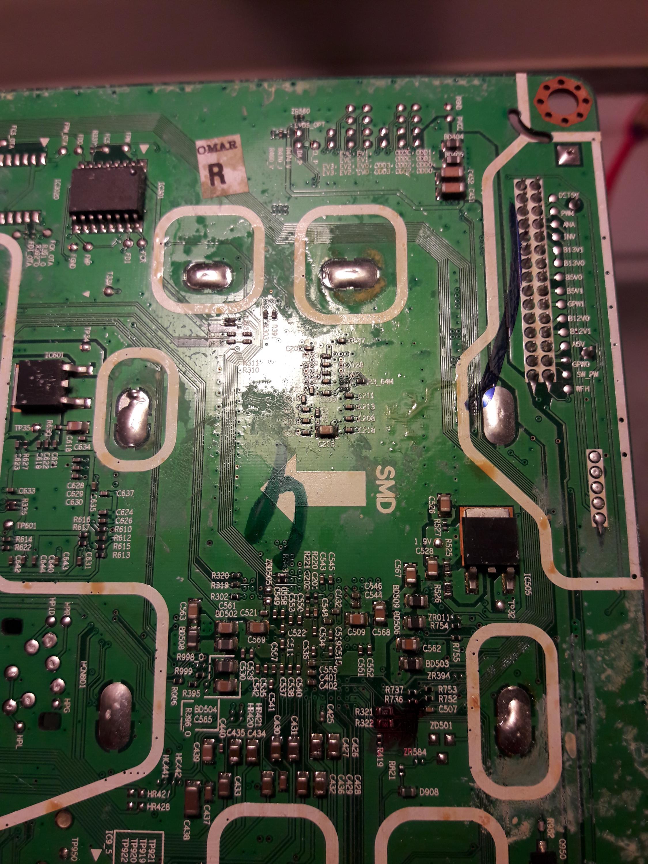

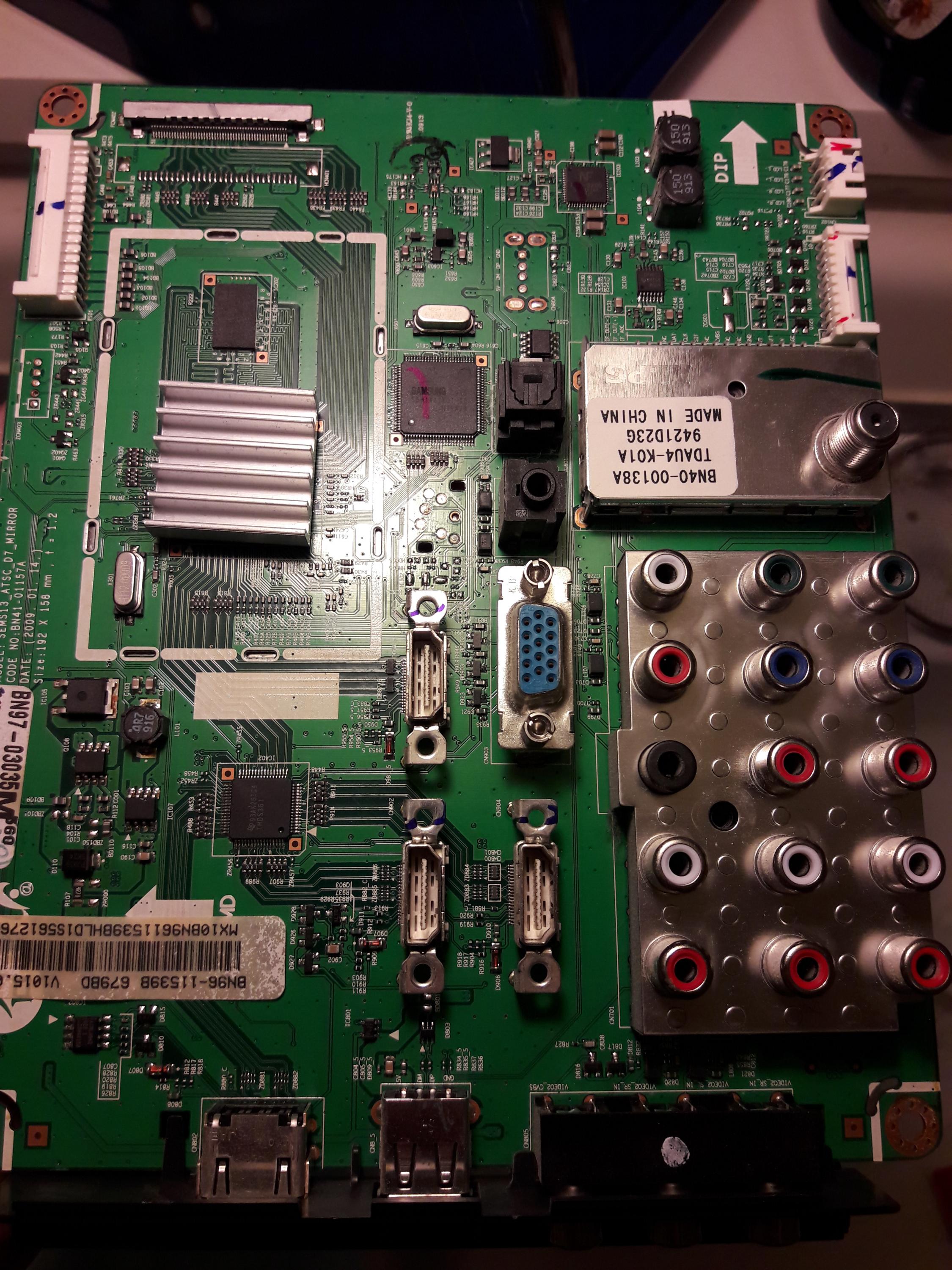

                              I was taking the boards off to take pictures and I flipped the main board over and there's a whole mess of corrosion on the back.
                                No clean flux.
