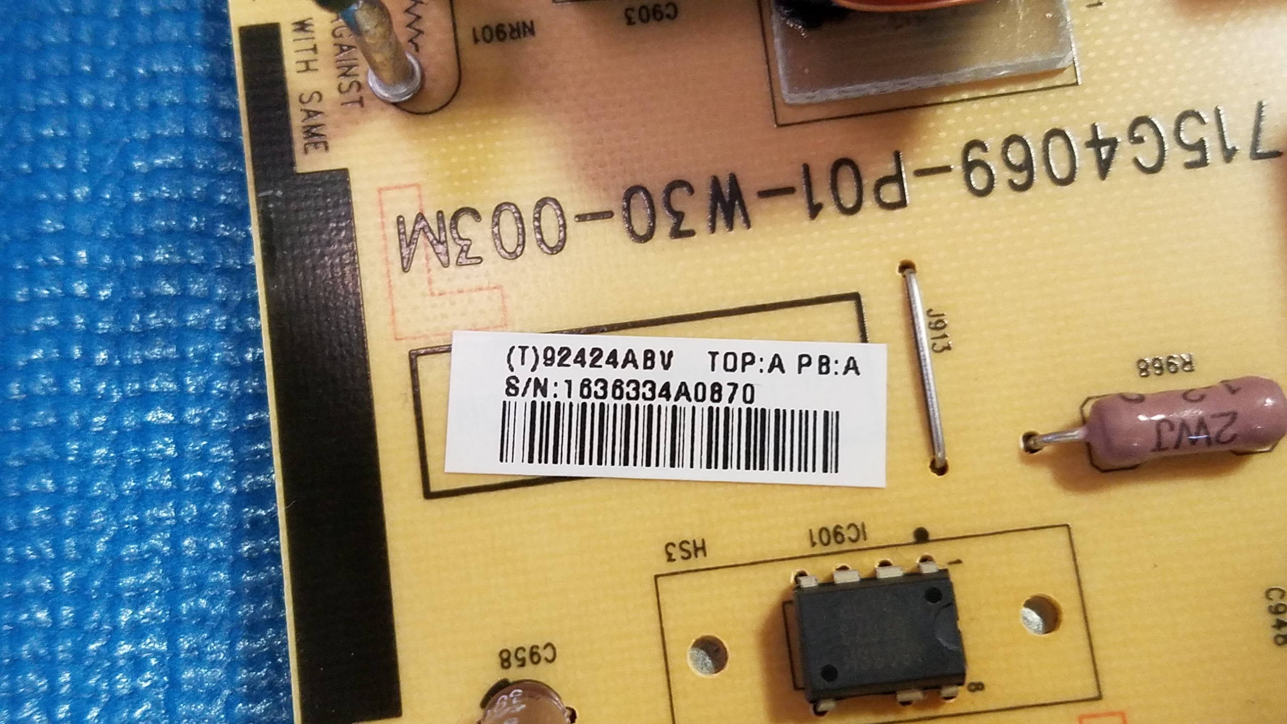

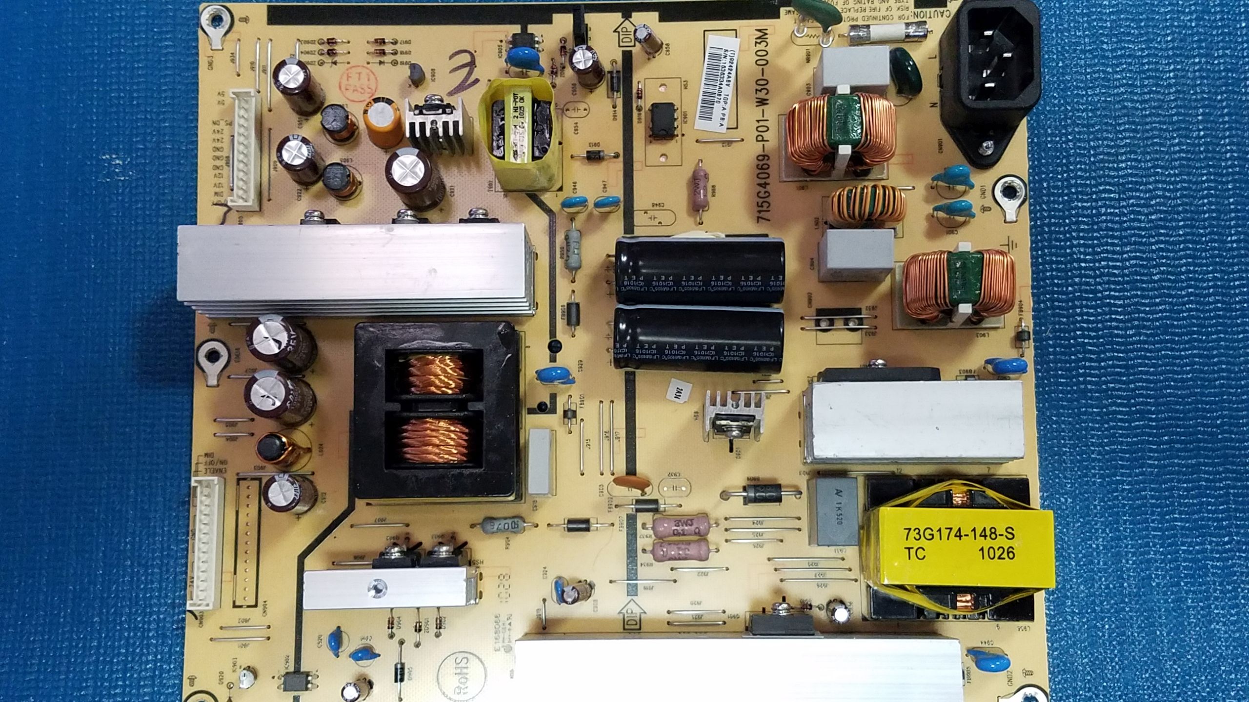

    I did a job for someone and she gave me a Vizio E470VA. She said lightning had struck and the TV no longer worked. Before throwing it away, I decided to test it and see what I could find.
    When the set is plugged in, the word Vizio below the screen lights up. It will then go off again. I can turn the set on with the remote, but I can see the entire screen flashing. It will go light and immediately dark. The flashing is very rhythmic and alternates about every second. I did an extensive search and could find no similar conditions. Also, while the screen is flashing, the Vizio logo below the screen does a very similar type of alternating between light and dim.
    I pulled the PSU and tested it today. I got proper voltage on each of the pins, but they fluctuated a bit. I also noticed a faint clicking around the lower corner of the board. That clicking has the exact same rhythm as the flashing I described before. I'm attaching two pics of the board, in the hopes that someone might be able to help me figure out where the clicking is coming from and whether I should replace the entire board. If I can replace a component, I would rather do that.
    Thanks!
    Gary
    Edit: I also uploaded a pic of the sticker on the board. The center pic is of the corner of the board where the faint clicking is coming from.

    Re: Old Vizio E470VA, new problem
    https://www.badcaps.net/forum/attach...2&d=1503435331
    We need to know what the DCV for all those pins of the two white connectors on the left side of the board. Make sure to put down the pin name first and follow by the Voltage reading for each pin, take the two sets of readings: one set when the TV is plugged in another set when the power switch is activated.
        Test it out of the set,5vsb to pson and read the voltage.
          you need everything hooked up as normal. we need to see if you have command signals.

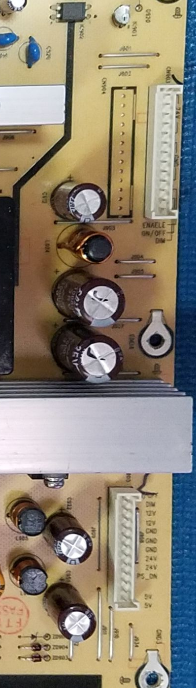

            I took the measurements both ways. With the PSU installed and on the bench, with the PS_ON jumpered. For the purpose of this post, I flipped the image and cropped it to highlight the connectors.
            The upper connector is labeled: CN903
            I will list the pins and the voltages obtained beside each one, while the board is installed and the power on.
            24v - 24.32-24.34v fluctuating.
            24v - 24.32v
            24v - 24.32v
            24v - 24.32v
            24v - 24.32v
            Gnd
            Gnd
            Gnd
            Gnd
            Gnd
            ENAELE - Unused
            On/Off - 0.11v
            Din - 3.37v
            The lower connector is labeled CN905.
            Same as above.. Board installed, power on.
            On/Off - 0v
            Dim - 0v
            12v - 11.89v
            12v - 11.89v
            Gnd
            Gnd
            Gnd
            24v - 24.32v
            24v - 24.33v
            PS_ON - 4.75v
            5v - 5.2v
            5v - 5.2v
            With the board on the bench, I got the following voltages:
            Connector CN903
            24v - 23.02-24.03v
            24v - 23.61-24.03v
            24v - 23.51-24.06v
            24v - 23.8-24.02v
            24v - 23.4 - 24.03v
            Gnd
            Gnd
            Gnd
            Gnd
            Gnd
            ENAELE - Unused
            On/Off - 0v
            Dim - 0v
            Connector CN905:
            On/off - 0v
            Dim - 0v
            12v - 12.02-12.04v
            12v - 12.02-12.08v
            Gnd
            Gnd
            Gnd
            24v - 23.8-24.09v
            24v - 23.4-24.02v
            PS_ON - 0v
            5v - 5.2v
            5v - 5.2v
            With the board on the bench, the fluctuating voltages corresponded to the clicking heard on the board. Could this be due to the lack of a load? If these voltages all look good, should I suspect the inverter, or the main board next?
            Thanks for the help!
            Gary

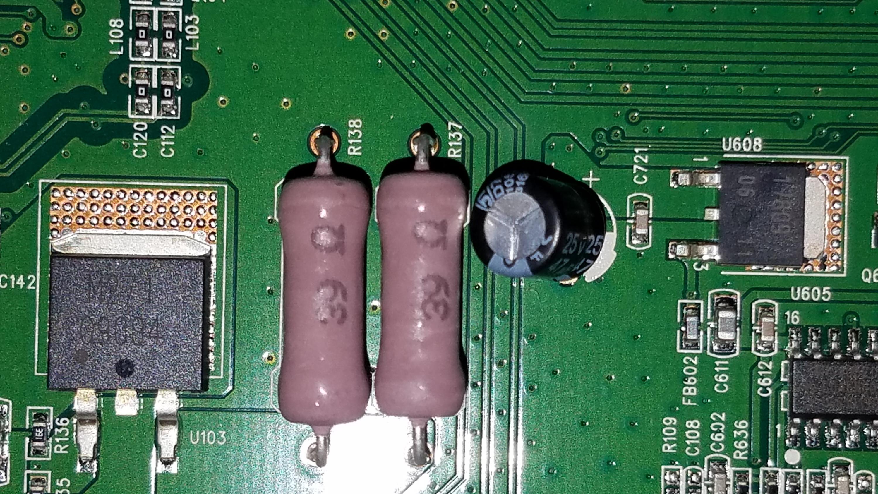

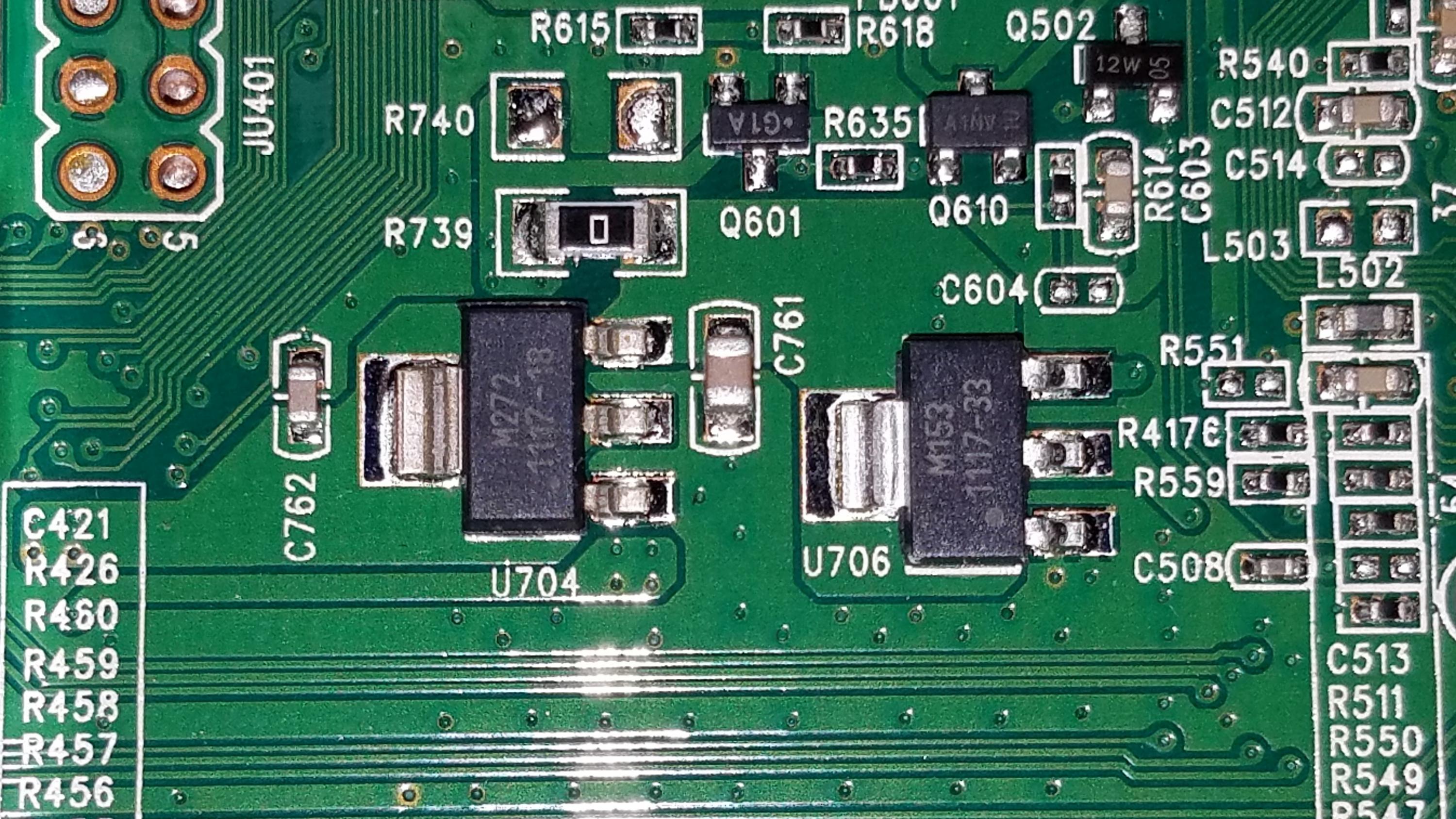

                      I finally got to test the voltages on the ICs and here's what I got.. I checked each terminal twice, to be sure. I also attached two pictures of the ICs in question. I only found four on the board.
                      U103
                      M271
                      G9084
                      3.80
                      5.04
                      9.57
                      U608
                      17089
                      06 11
                      11.87
                      0.7
                      9.02
                      U704
                      M272
                      1117-18
                      0.8
                      1.794
                      3.301
                      U706M-153
                      1117-33
                      0.8
                      3.3
                      5.14
                      Hopefully, one of you guys will be able to decode all this and help me out.
                      Thanks for looking!
                      Gary
                        Readings on U704 and U706M look fine. Unsure on the other two, i'm too sleepy and inebriated to look them up, wait for assistance from other members
                          Guess I didn't hit enter hard enough..
                          U706M-153
                          1117-33
                          0.8
                          3.3
                          5.14
                          Should read:
                          U706
                          M-153
                          1117-33
                          0.8
                          3.3
                          5.14
                            i don't know what u608 is, but all of the other ldo's are good.
                                found the data sheet, and the output is good.
                                  So if all four mainboard ICs are showing good, where should I look next? What would cause the On/Off of CN903 to read 0.11v?
                                  Thanks,
                                  Gary
                                  • attainteddragon
                                    • Apr 2013
                                    • 764
                                    • australia
                                    it could be a bad cap, bad solder joint under the bga processor, or potentially any other surface mounted device.
                                    you know for sure that you have a main board issue, so you can replace it, or you could trace back from the bl/on signal pin and try to find what may of failed. main boards are not easy.
