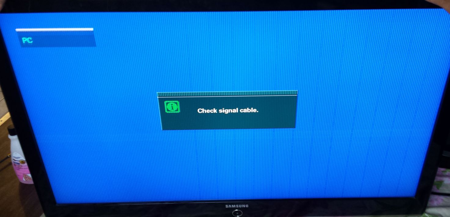

    Hi
    I got this LCD and it powers up properly, but as you can see in the picture and the video attached, it's got vertical lines across all the screen and some flickering.
    I took the tv apart checked and cleaned up all the LVDS cable, all the ribbons, but no result.
    i also did quick voltage check and i didn't see any abnormalities ...
    i'm not sure if the problem is coming from the Tcon or the mainboard.
    did someone had this problem before?any of your input will be much appreciated.
    https://youtu.be/qWxvKlYfpRg
    thanks

      I would try t-con

        Thanks dskall.I removed the tcon board, wiped all the ribbons surfaces.no result.

            I had access to service menu, but i couldn't find a test pattern.
            I think the problem is coming from the mainboard, because i've found some high ESR electrolytic caps, replaced 5 of them, i still got the same problem ( maybe the picture is slightly better).Now, i have to desolder the can to have access to other some capacitors.
            i'm quite sure there a lot of bad caps in the mainboard, because the first time i took it apart i found a lot of sticky liquid in the bottom of it.

                  Isn't vertical stripes "always" the panel that is failing? What happens when you squeeze in the top side of the bezel? Or apply a little pressure on the tabs.....

                        Re: Samsung LN-T4661FX vertical lines??
                        Looking at video there are some clues in that lines do not appear to traverse menu panel and they increase in intensity from left to right with a slight pulsing. My thoughts are electro interference by say capacitor discharging to earth. And a wild one - is correct a.c. cord being used.
                        • kgavionics
                          • Apr 2017
                          • 152
                          Thanks maxvalutech for your input.Regarding the AC cord i use correct one( with earth pin)
                          can that capacitor be in the power supply or mainboard?As said earlier i've replaced a dozen of electrolytic caps on the mainboard with no luck.
                          yesterday, i disconnected the LVDS cable from the tcon board, powered on the tv, all i've got is black screen, but with some flickering, maybe due to that cap you're talking about.
                          now the big question, how can i find this bad cap?

                            Try moving around the LVDS connector while the TV is playing something on screen and see if that makes a change. If that does not, try pressing on the one of the heat sinks on the main board and see if that makes any changes on screen. If it does not go to the next heat sink until you have tried all three. I am thinking either bad LVDS or bad main board on this one.

                              I'd say bad main, could be BGA issues.

                                Horizontal lines means a bad panel, no vertical lines as far as i know.
                                nothing happens when i touch the LVDS cable neither the ribbons or the circuit heat sinks as Nick's Tvs suggested

                                  Horizontal lines are usually board problem.
                                  Vertical lines is t-con or panel on a LCD/LED tv. I would apply some pressure on the tabs and see what happens because i had the SAME problem on a Philips lcd which turned out to be a bad panel. ( tab bonding problem ).
                                  Can you squeeze the bezel and see if something changes?

                                    Lines can also be a BGA issue with the processor on the mainboard.
                                    I've reballed both LG and Samsung mainboards.
