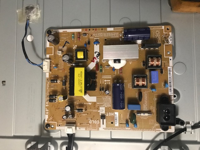

    Hi guys hope i can get some help here with this samsung tv
    I wasnt getting any voltage output and no standby light so replaced the power supply board and now i get standbt voltage on the pins and wn remove the connector from mainboard to power supply back light comes on but wn i plug back connector the standby voltage goes to 0 backlight goes off and black screen wn i test the main board side no voltage coming in
    What do you think can be the prob?

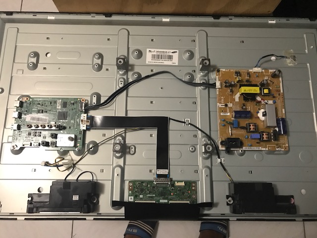

    Re: samsung un40eh5000f
    I'd guess the mainboard has a short and pulls down the standby voltage.
    Plug the tv in for a few minutes, then unplug. touch a few of the components on the main board. See if anything is too hot to touch.
    • stevemaho
      • Jan 2015
      • 23
      • usa
      Ok did that but nothing gets got but i trace the connections and it goes to a 17-33z voltage regulato0r so gonna remove see if voltage reaches to that point

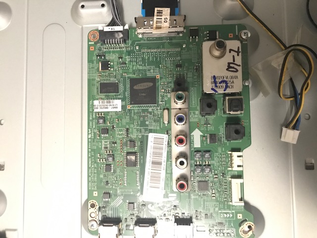

        Ok just replaces the mainboard now the board does not draw the 5.3v away so thats good and the mainboard gets power tested a couple points but still no standby light or anything
        Any help will be appreciated

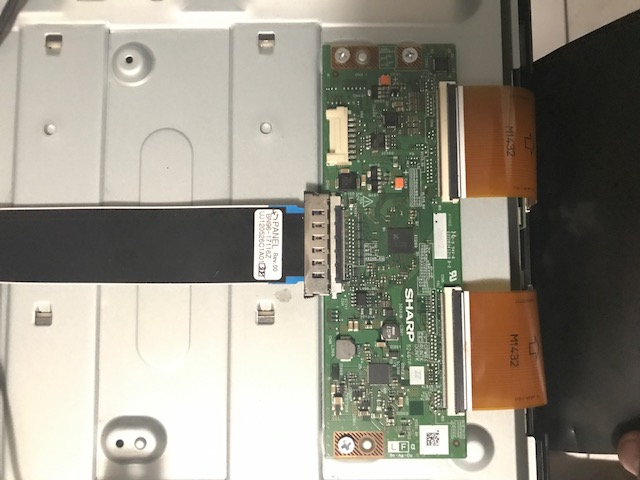

            Cables are fine mainboard getting power now than with old main board tested on main board and i get the 5v stanby but i guess might be tcon board now need to be replaces
            • diif
              • Feb 2014
              • 6978
              • England
              Measure voltage both sides of the fuse on the tcon.
              • stevemaho
                • Jan 2015
                • 23
                • usa
                ok no voltahge o the fuse on tcon
                • CapLeaker
                  Leaking Member
                  • Dec 2014
                  • 8112
                  Post a high resolution pic of your main board.
                  • diif
                    • Feb 2014
                    • 6978
                    • England
                    You measured both sides ? Is there continuity across the fuse ?

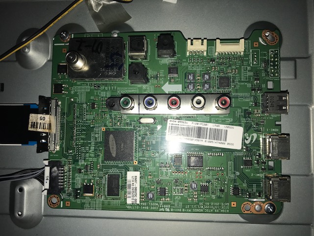

                      Fuse is good have continuity but seems like no voltage coming across from mainboard to tcon but this is a new board i just bought off ebay and was told it was tested and working fine
                      Thanks in advance guys
                        Regardless to the T-CON board, do you get the backlights to come on?
                        It sounds like defective new main board to me if ALL the power supplies Voltages are OK.
                        "Ok just replaces the mainboard now the board does not draw the 5.3v away so that's good and the mainboard gets power tested a couple points but still no standby light or anything"
                        The key point is that you are not even getting the Standby light with the replacement main board.
                        • stevemaho
                          • Jan 2015
                          • 23
                          • usa
                          BUT in this case the STAND BY light comes on only when tcon gets power correct?
                          So the replacement board has an issue most likely cause the tcon not getting and voltage from mainboard not even by the fuse?
                          And what are the chances that the ribbon cable from mainboard to tcon is bad?
                          Anything else to chk or just return board to seller?

                              Ok wn i press power button on remote no lights come on in front and no power drop on the standby pin 5v and no power on fuse on tcon board either.
                              This model has no power button the side its a touch model and all the pins on smp are correct the 13v and the 5v all are correct on the pins and wn i remove cable from mainboard to smp backlight comes on fine
                                Sounds like your supposedly good replacement board is no good and we already know that the power supply board is good.
                                • CapLeaker
                                  Leaking Member
                                  • Dec 2014
                                  • 8112
                                  Sounds like your main board is bad. You can try to reflow the main IC on the main board. If that is a replacement board, send it back. It's bad.
                                  • dick_barton
                                    • Aug 2015
                                    • 6642
                                    • Wales
                                    What voltages do you have on Power ON/OFF Pin 14 of CNM803 and also on BLU On/Off Pin 6 of CNM803 when you in standby and when you try to come out of standby.
                                    • stevemaho
                                      • Jan 2015
                                      • 23
                                      • usa
                                      Which ic u referring to to relow?
                                      And on pin 14 5.3v and pin 6 12.52v when i hit power button on remote voltage doesn't change
