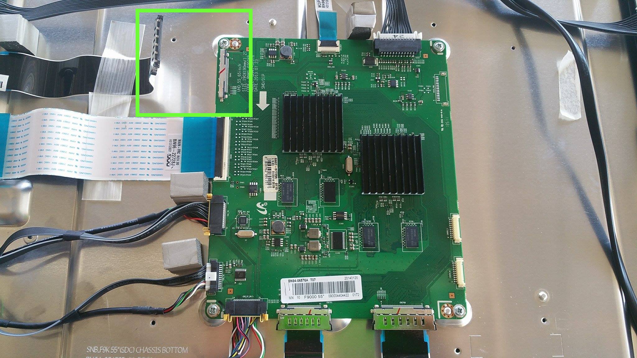

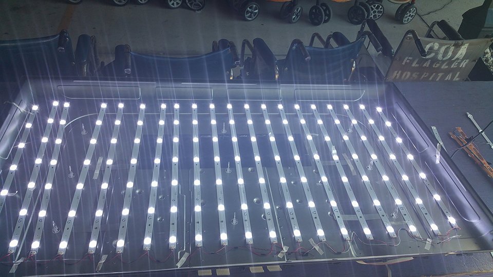

                          WORST DAY EVER....
                          Got a nice 65" RCA LED in.. Upon power up, I see a quick flash of the LEDs.. If I am lucky, it's a blown cap on the power PCB... If I am not lucky, it's a bad LED strip....
                          I am not lucky....
                          OK Break it down to the bare LEDs and replace a LED strip.. No biggie.. I can do this.. I just did a 50" LED on Sat.... LGs.... FAMOUS for it...
                          Break it down.. Find a compatible (with a little re-wiring) LED strip...
                          YES!!!!! (see pic)
                          Feeling pretty good about things... Put it all back together... 6" Black Strip down the side.. Turns out I tore one of the tabs that are bonded to the display panel..
                          Oh well, life goes on... THAT ^^^^ leads to this \/\/\/\/\/
                          Got the TCON in for the UN55.... install it..
                          Same problem.. White screen.. Blue/Green/Yellow gobbledygook... with and without the OC box...
                          Fiddle with the TCON connectors to the display panel..
                          NOW all I get is the backlights on... 'Bout ready to hulk out on this unit when I notice something that might mean something...
                          With the top connector unplugged from the Driver board (see other pic), the backlights come on in 2 seconds...
                          With the top connector from the Driver board is plugged in the Driver board, there is a quick faint flash at 2 secs and then the backlights come on about 30+ secs later..
                          Not sure what it means, but it's something I can point to...
                          And THAT has been my morning so far..
