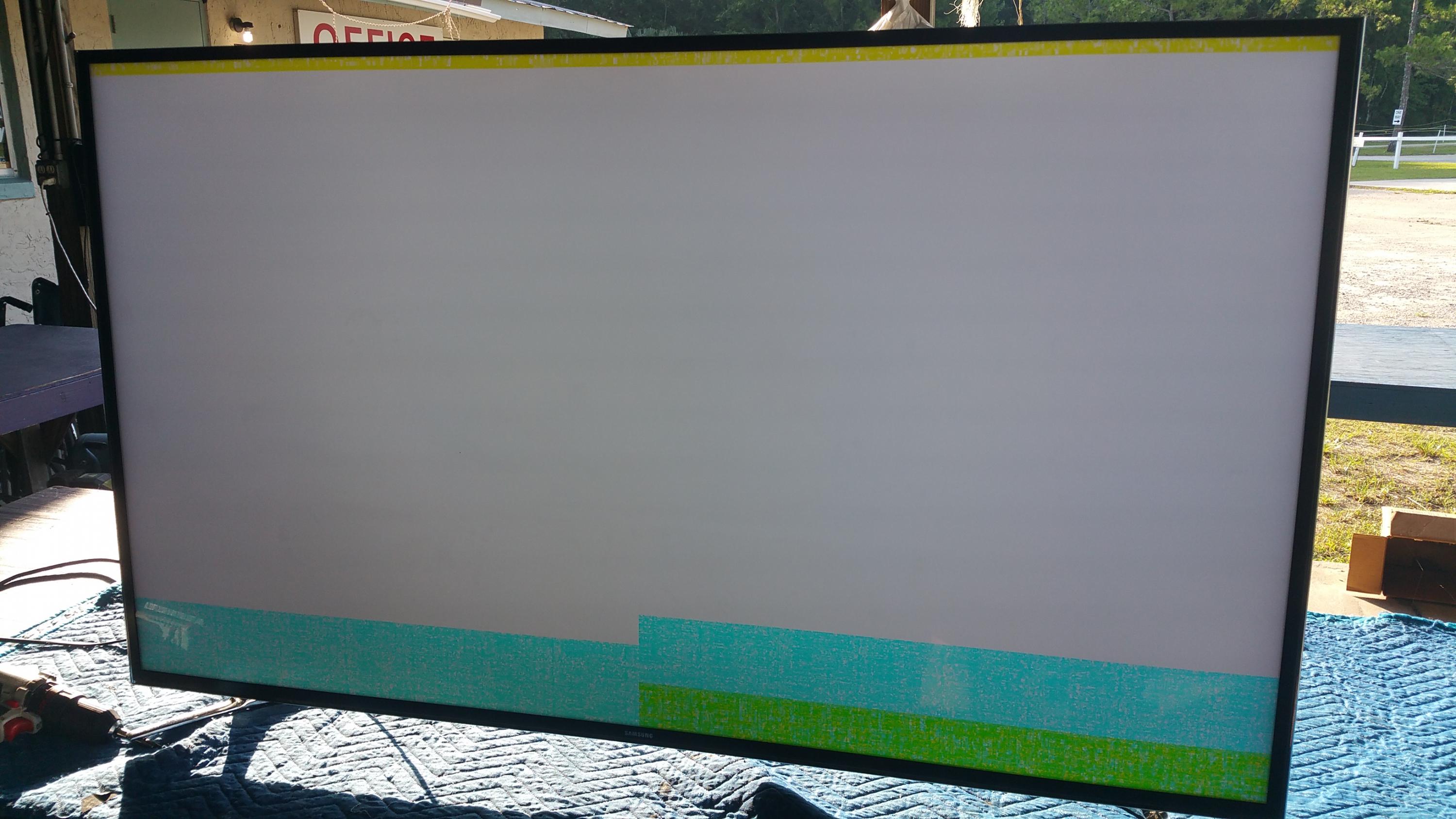

    This is, without a doubt, the BEST TV I have ever been able to get my hands on...
    Unfortunately, it is non-functional, which is why I got it..
    It's got a separate ONE CONNECT box with all the video hookups and is connected to the main video board by a special cable..
    When powered up WITHOUT the OC box, I get a white screen with some green, blue and yellow coloring on the top and bottom edges...
    When I have the OC box hooked up, the TV won't power up at all....

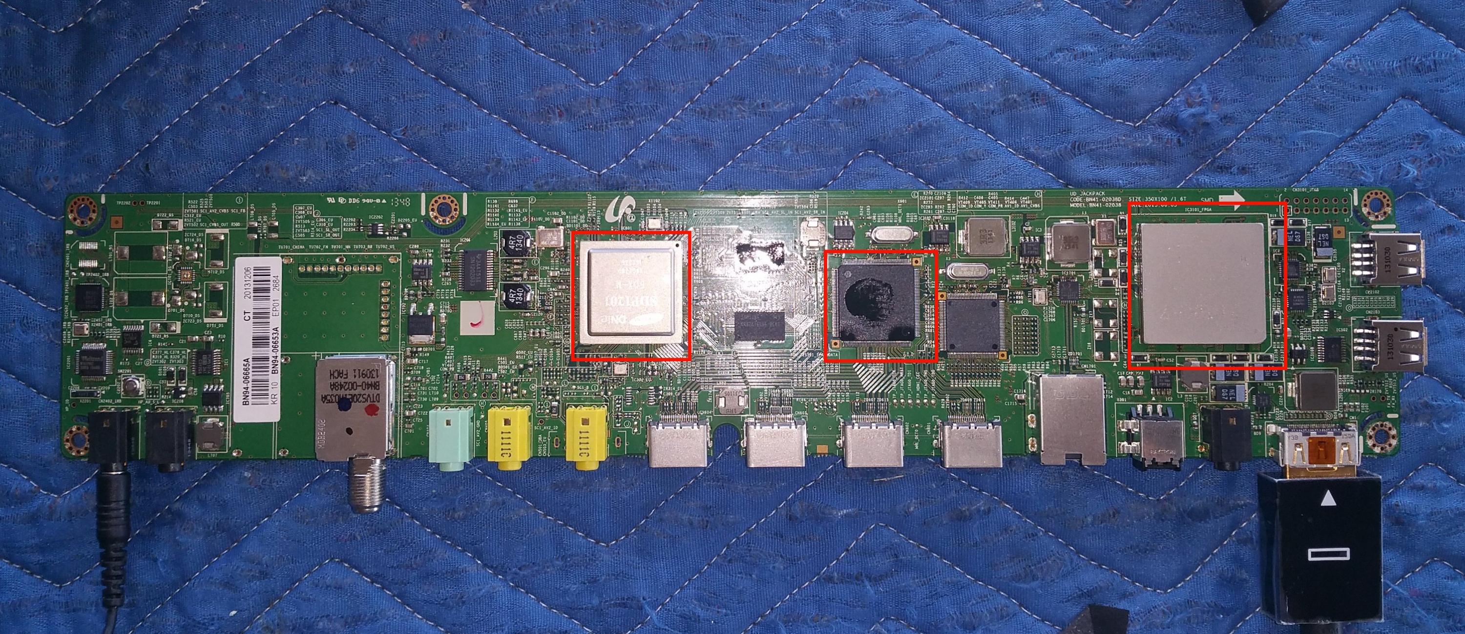

    can you open the OC up and look to see if there are any fusing associated with the box?
    • Michale32086
      • Nov 2011
      • 1453
      Re: OMG SAMSUNG UN55F9000 Ultra HD, SMART, 3D 4K
      Thanx for the reply...

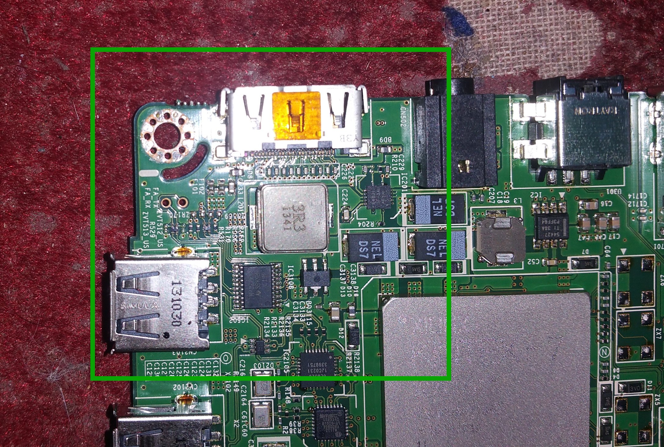

      That's kinda hard to tell, as there is no power jack... I am assuming it is getting power thru the cable to the TV...

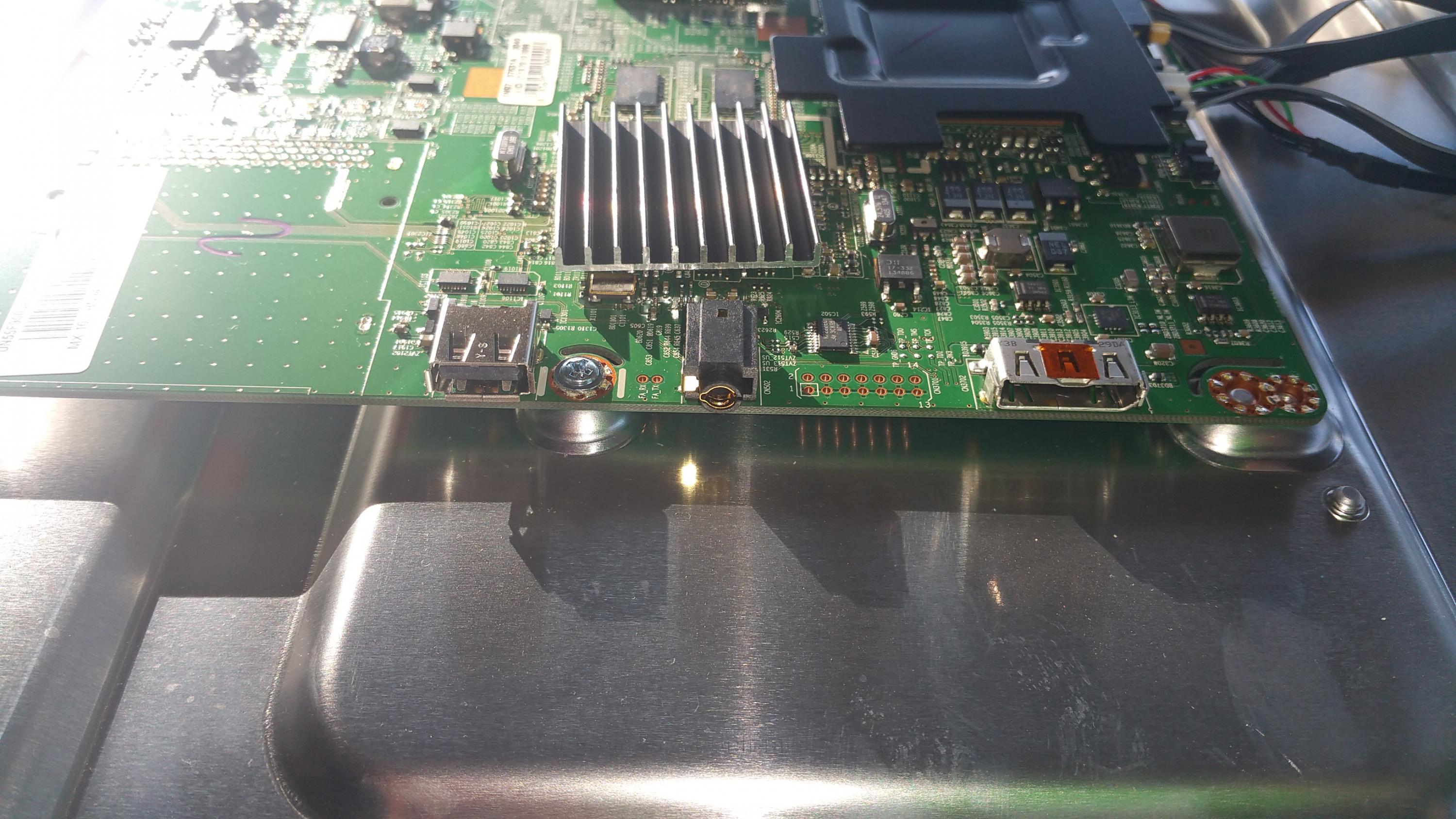

      • Michale32086
        • Nov 2011
        • 1453
        Better picture of the topside of the PCB...
          I see 2 components marked Fxxx and am assuming those are fuses..
          They check out with full continuity...

            OK ... BUT ... now that you got it apart, I would think that the next best test would be to plug into the set and see what voltages (if any) appear at those fuses.... maybe. I am not sure if anyone has ever taken a OC apart or has seen a troubleshooting / circuit description for it.
            • Michale32086
              • Nov 2011
              • 1453
              OK, but bear with me.. I am a novice at checking voltages beyond the obvious '+' & '-' silkscreened on the PCB..
              Take the probes and just apply them to each side of the fuse?? Or a probe to fuse and the other probe to GND???
                    A steady 12.1v on both sides of both fuses...

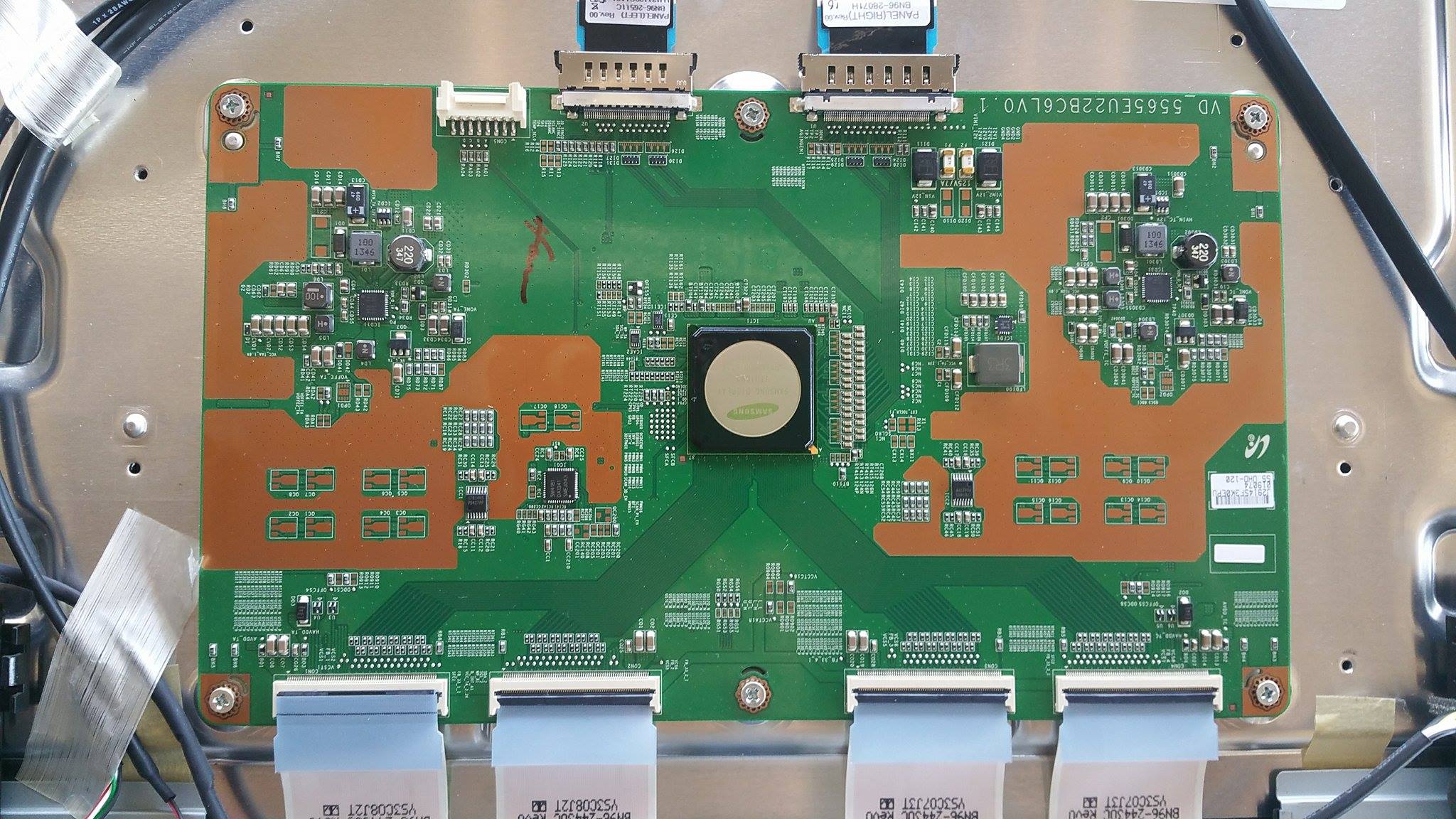

                              The TCON has two fuses which check out..
                              Something interesting.. On a conventional LED if you disconnect one side of the connectors that go into the display panel, you get a white screen where the TCON should be plugged in..
                              This doesn't happen here.. When I unplug one side of the TCON (the 4 cellophane connectors for lack of a better term) I don't get the white screen anymore.. I just get a black screen with the backlights on...
                              I dunno what it means, but it's something different..
                              • Michale32086
                                • Nov 2011
                                • 1453

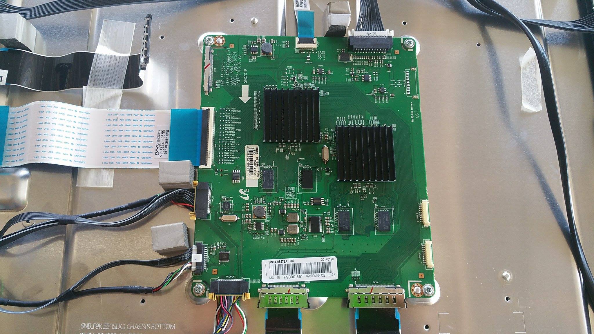

                                OK Something else..
                                Pictured is the TCON board and the board to the right of it.. Driver board??
                                Anyways, when I disconnect any of the connections marked in RED, I just get a black screen at power up..
                                But when I disconnect one or both of the connectors marked in GREEN, I get that white display with the farbled yellow/blue/green characters...
                                Not sure what that means, if anything.. I should also note that the connector marked with the pink line had some bent connections that might have shorted that board it's attached to...
