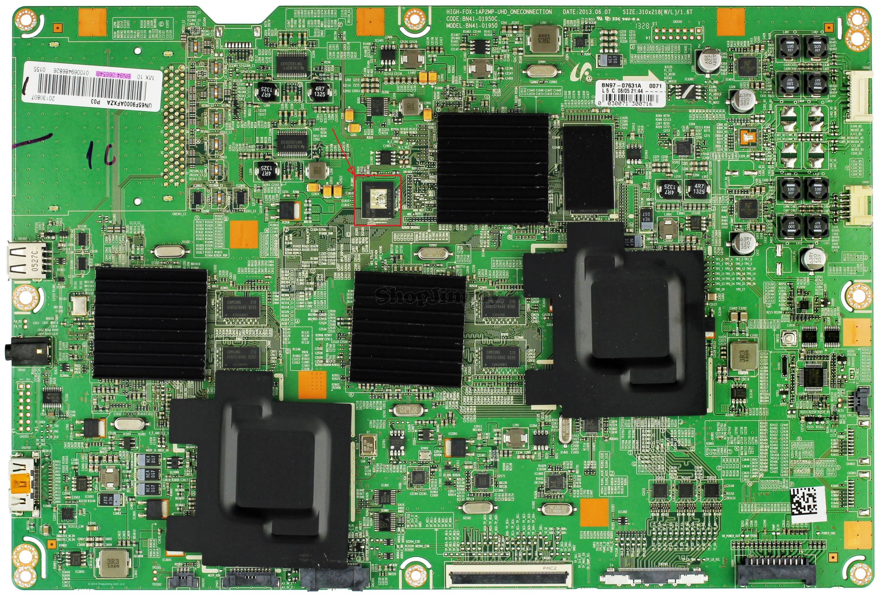

                  Can you please tell me if you are referring to IC1801 as highlighted in my attached image of mainboard BN94-06654B? IC1801 appears to be Samsung eMMC "embedded Multi-Media Controller" with flash memory and a flash memory controller integrated on the same silicon die.
                  How is it possible to extract .BIN image from this eMMC IC? How to connect programmer? and how to reprogram to a new IC?

                        Unspun yes that is the emmc, it needs at least a RT809H or F programmer and there is a guide on how to reprogram it without removing the chip by the board but its hard to find the points:
