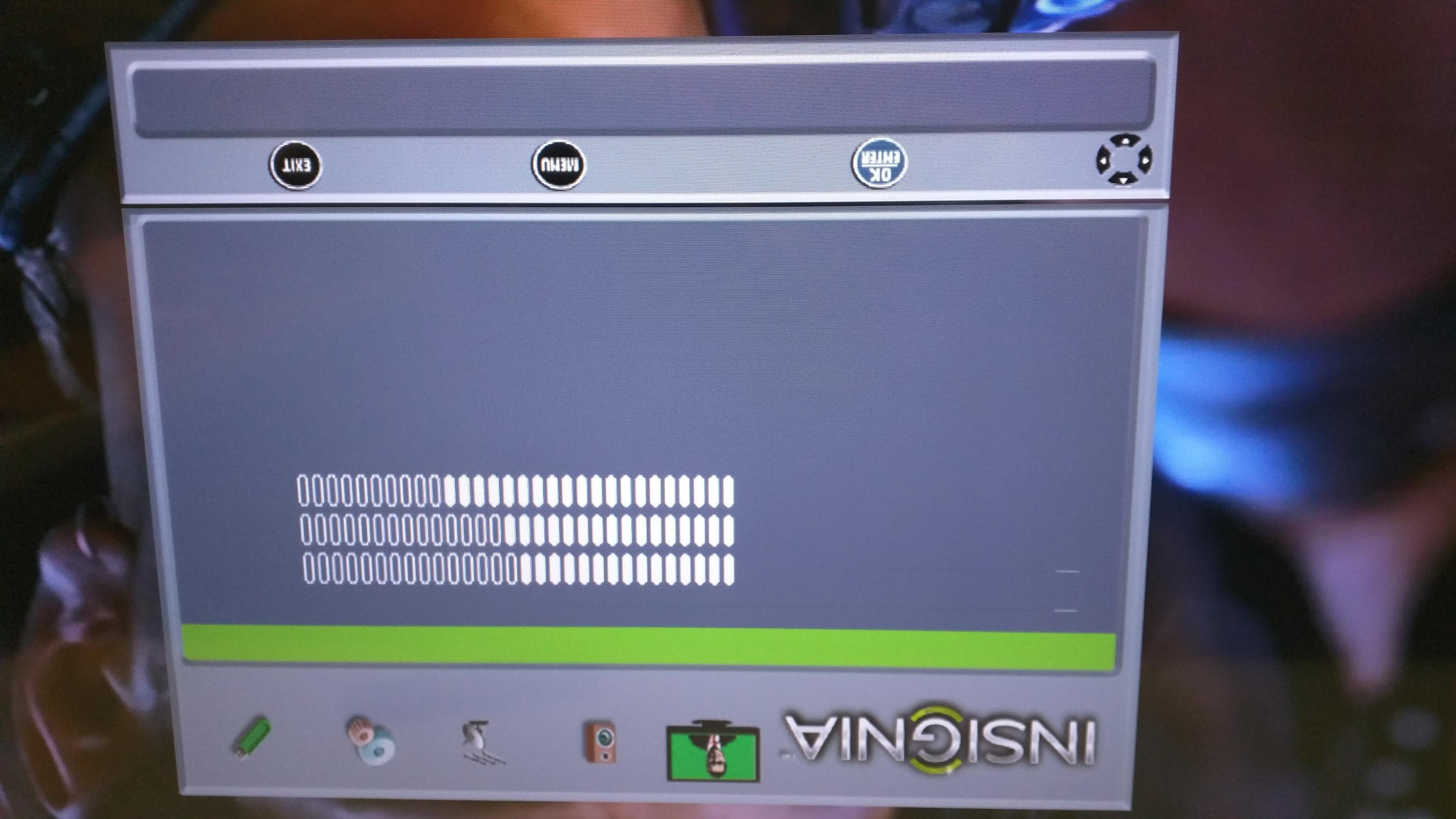

    Re: insignia ns-46e340a13 standby 7 blinks - when on, text missing on menus
    Hi
    can you post some pictures please when the tv is ON.
    next step you have to take the tv apart and check visually if you have some bulging caps on power supply.

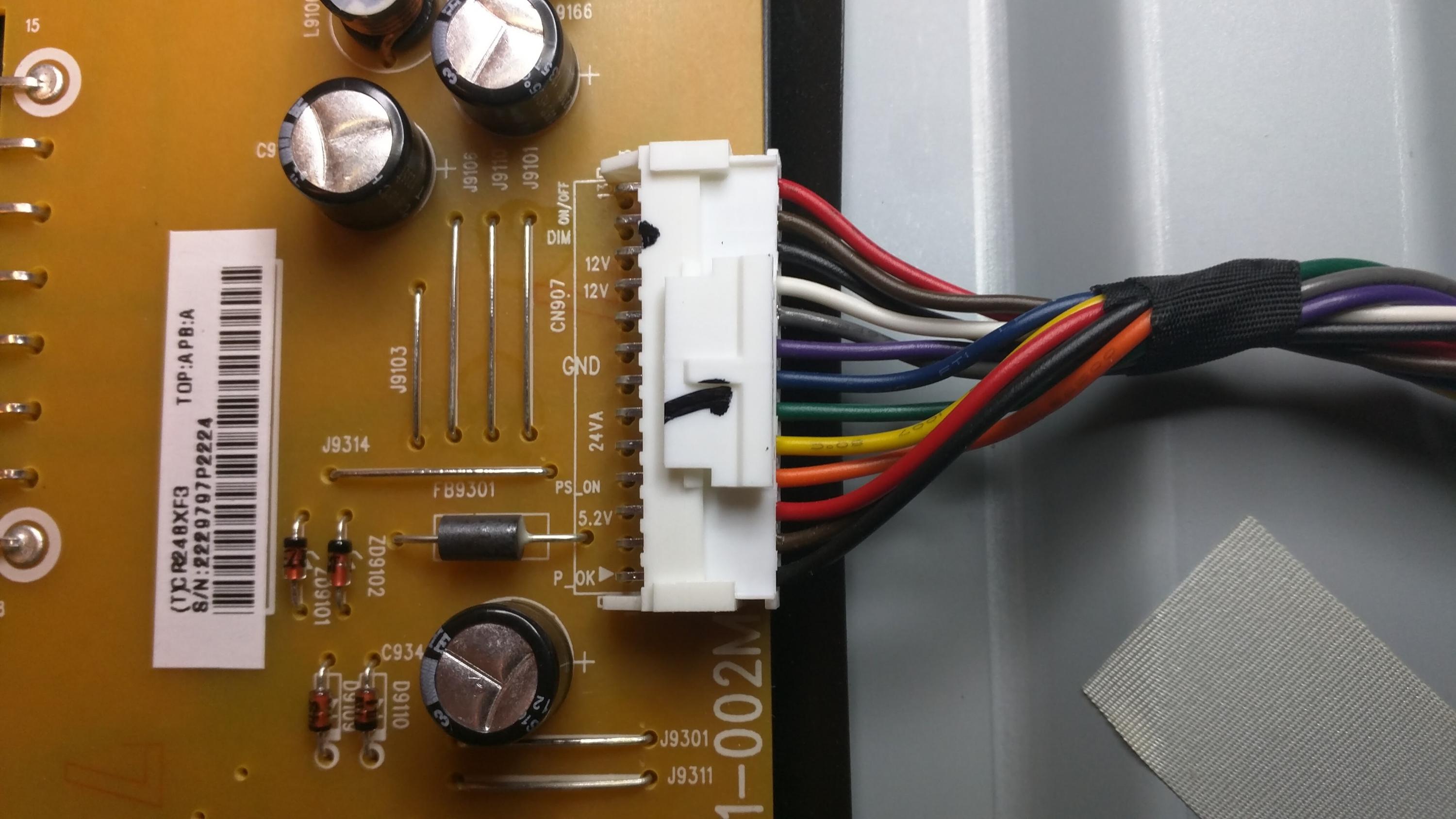

      There are no bulging caps. I have tested the voltages running from the power board to the main boards. CN901.
      1 0v
      2 5.2v
      3 5.2v
      4 5.14v
      5 25.01v
      6 24.97v
      7 0v
      8 0v
      9 0v
      10 12.19v
      11 12.15v
      12 0v
      13 0v
      sorry the tv does not have a base and i was holding tv upside-down.

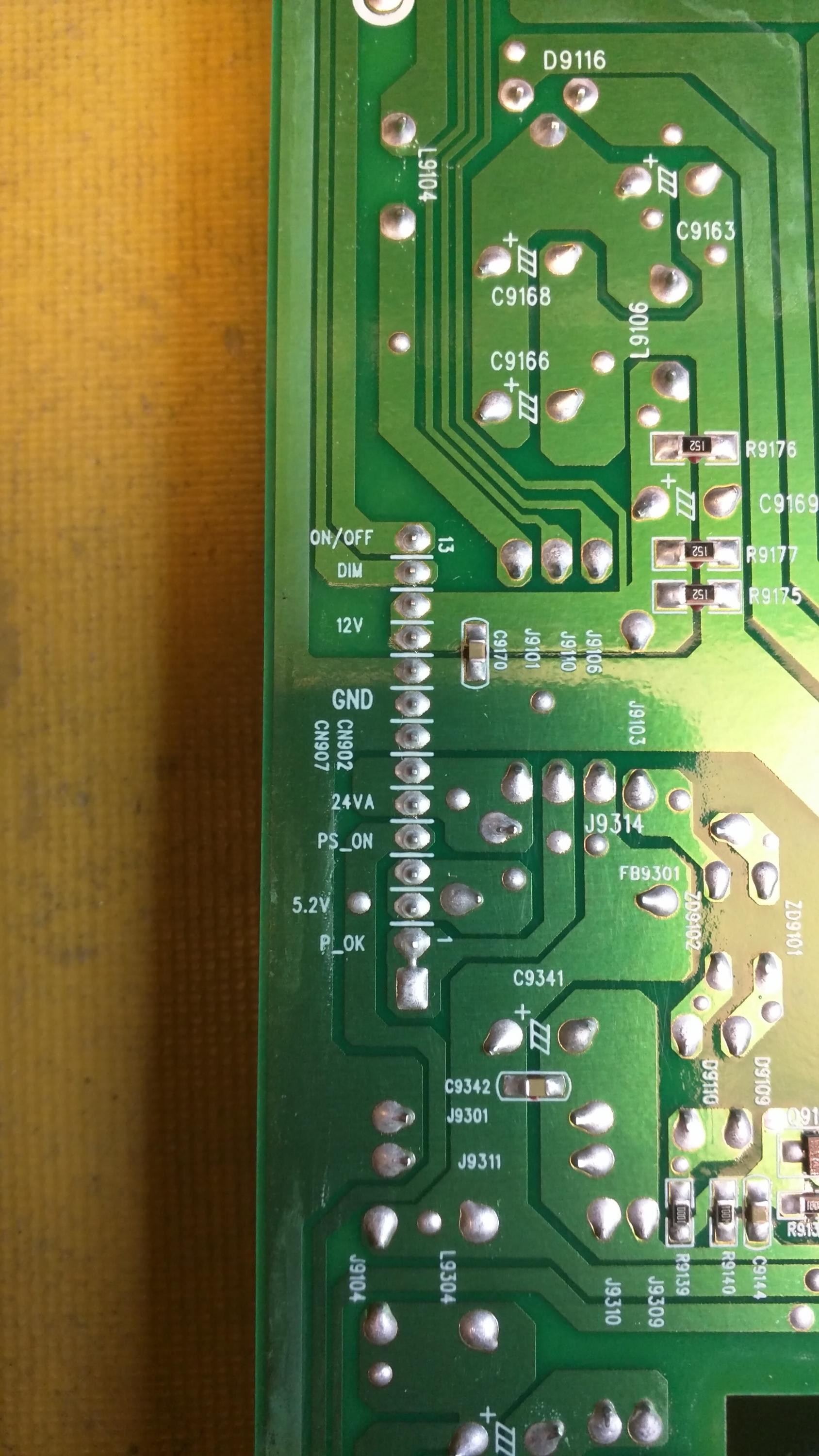

          Voltages mean nothing without pin discription
          • cherokee.warrior
            • May 2017
            • 87
            One of the pictures above is the connector in question. Whats in the picture is all i have. Ive been looking for a service manual with no luck.

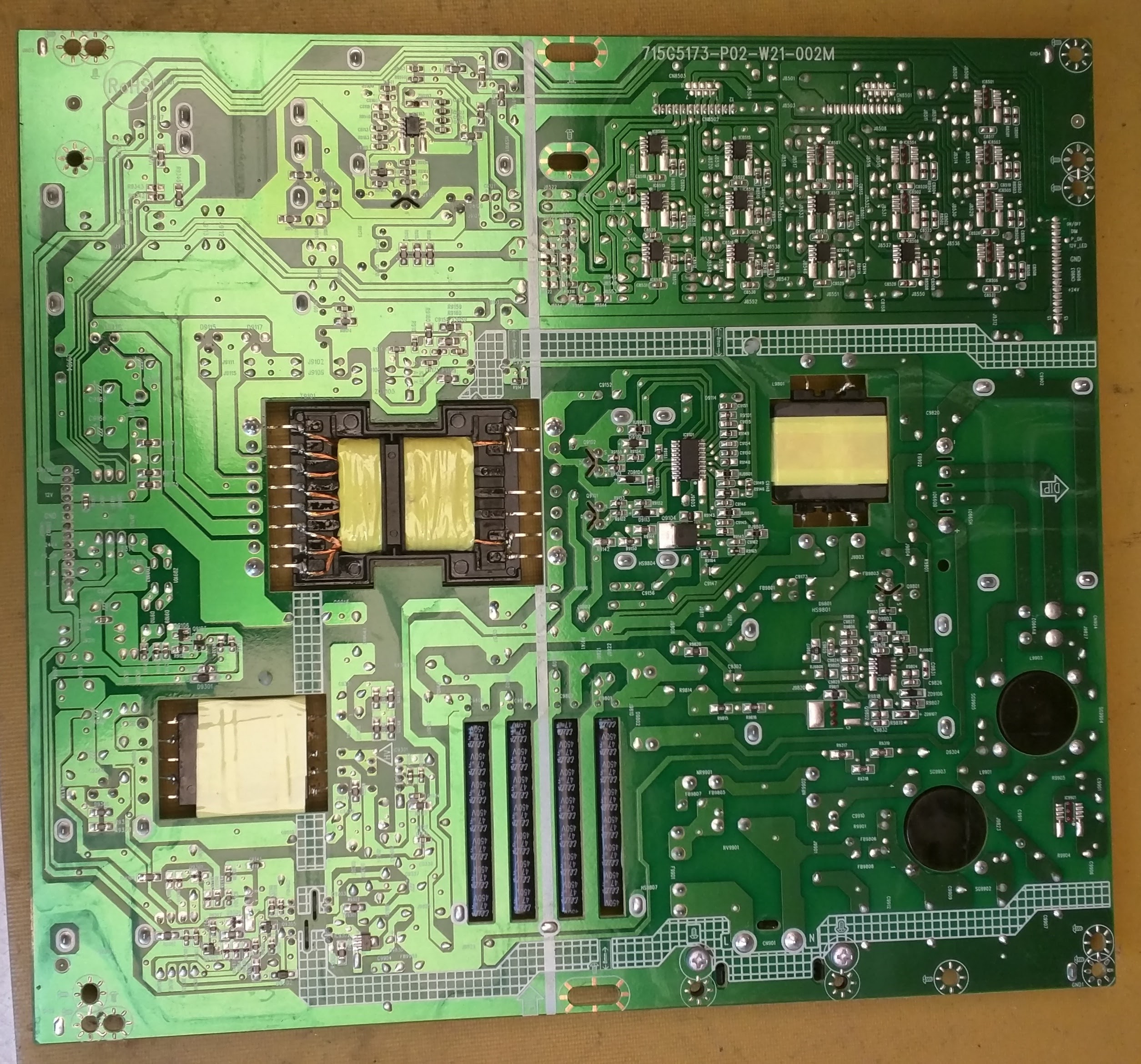

                here is the connector from the under side of the board.
                    You seem to have your ps_on but you lose your backlight signal. With your other problems sounds maybe like eeprom

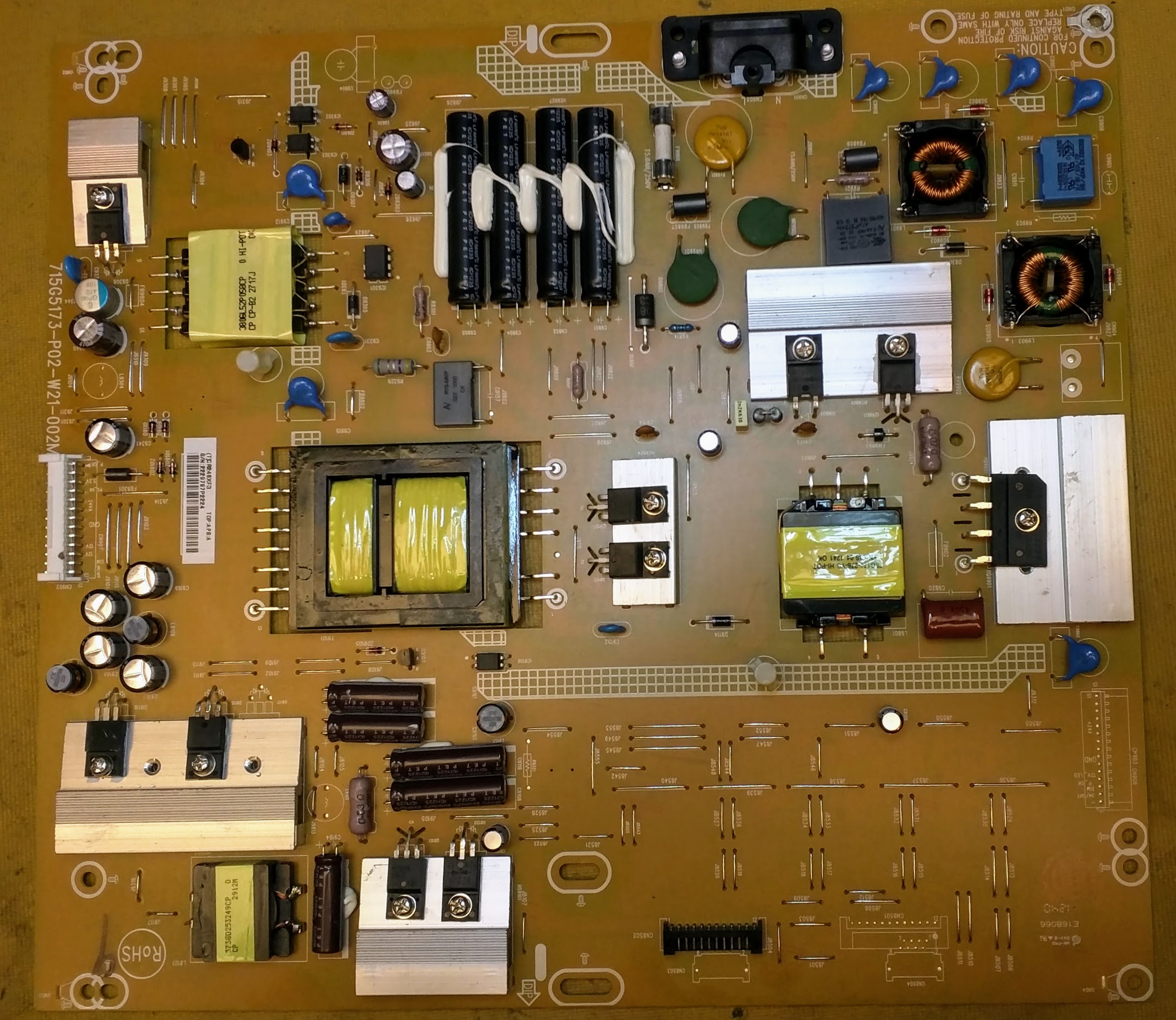

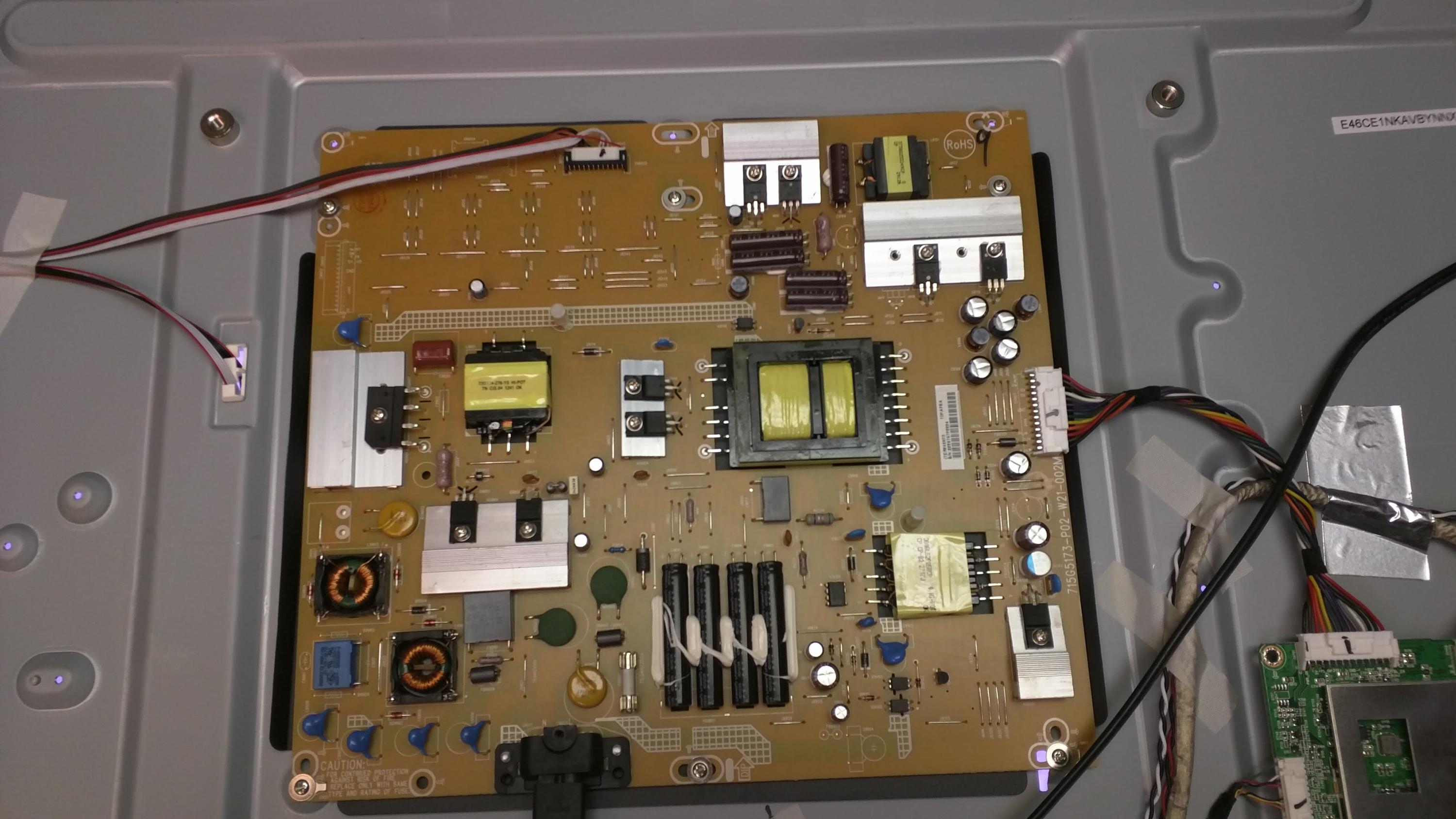

                      I was kind of leaning that way but trying to figure out what is causing it. Here is a picture of the backside of the power board.
                      • cherokee.warrior
                        • May 2017
                        • 87
                        front view of power board.

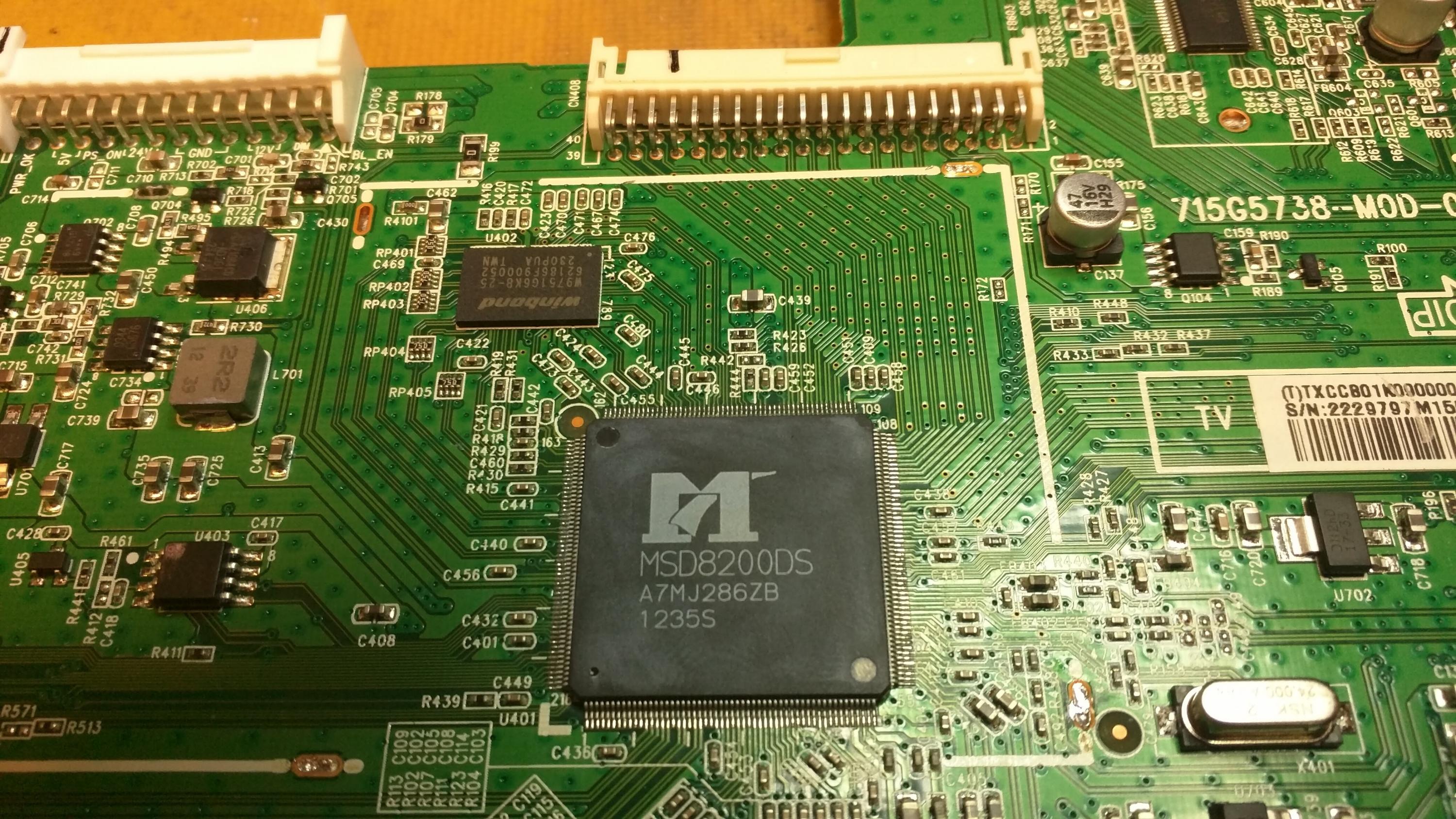

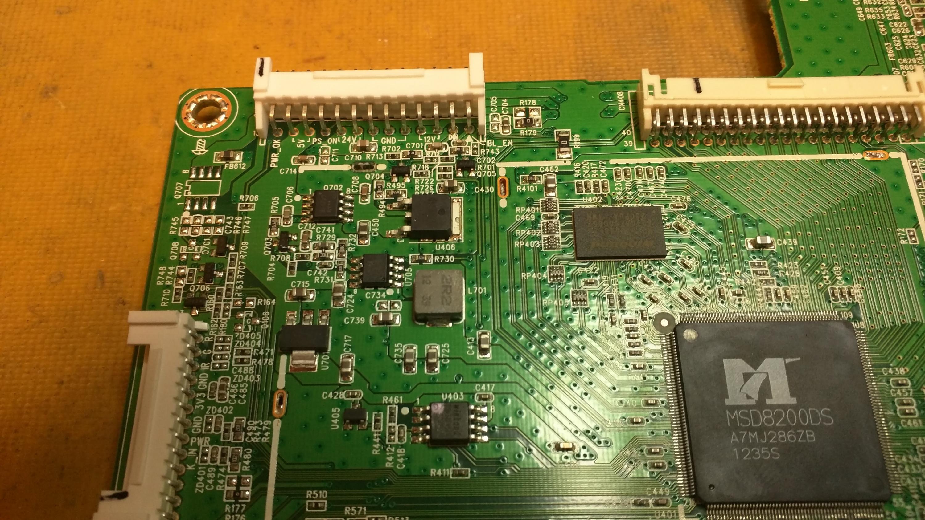

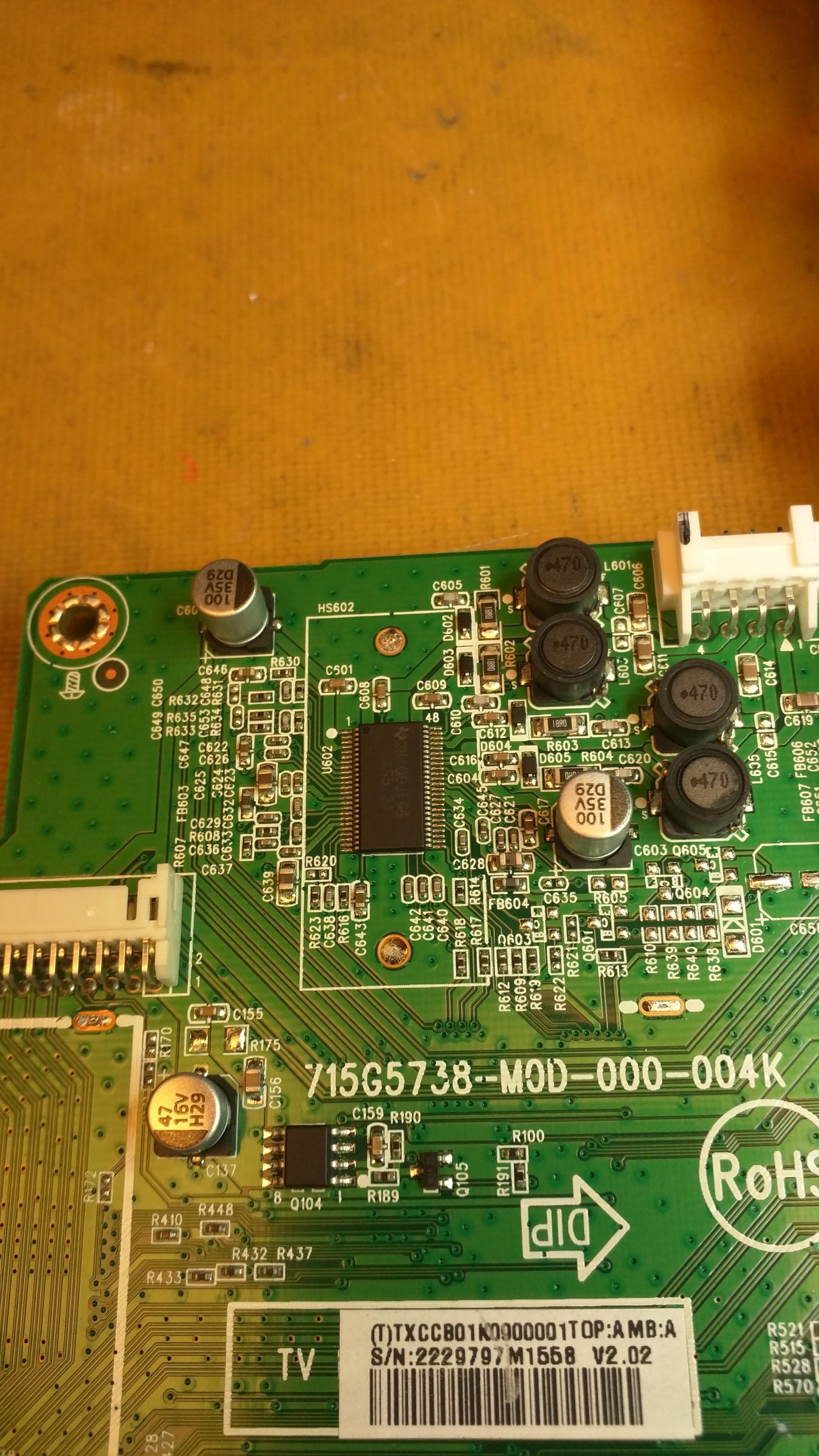

                            On main board U403 is eeprom. Probably under metal shield. You could try freezing it with air duster upside down and see if it comes on.

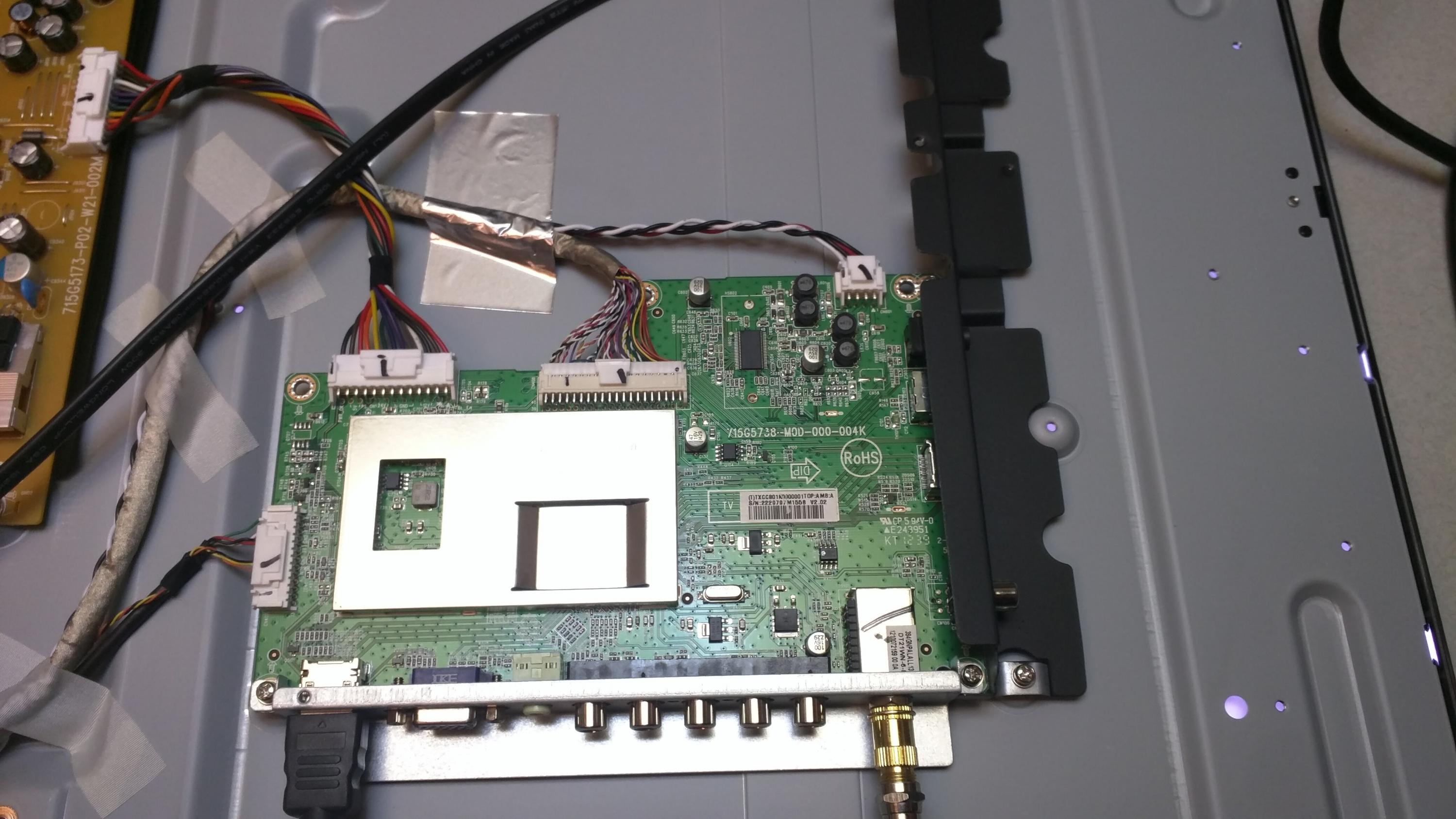

                              you can try heating/cooling the main board to see if the missing signals come back when in fault mode, or force the fault on when it is working.
                                I can not find a u403. here are some pictures of the board with the metal cover removed.
                                  First picture lower left
                                  • dick_barton
                                    • Aug 2015
                                    • 6643
                                    • Wales
                                    U403 as shown. What is the discolouration on the top of the IC
